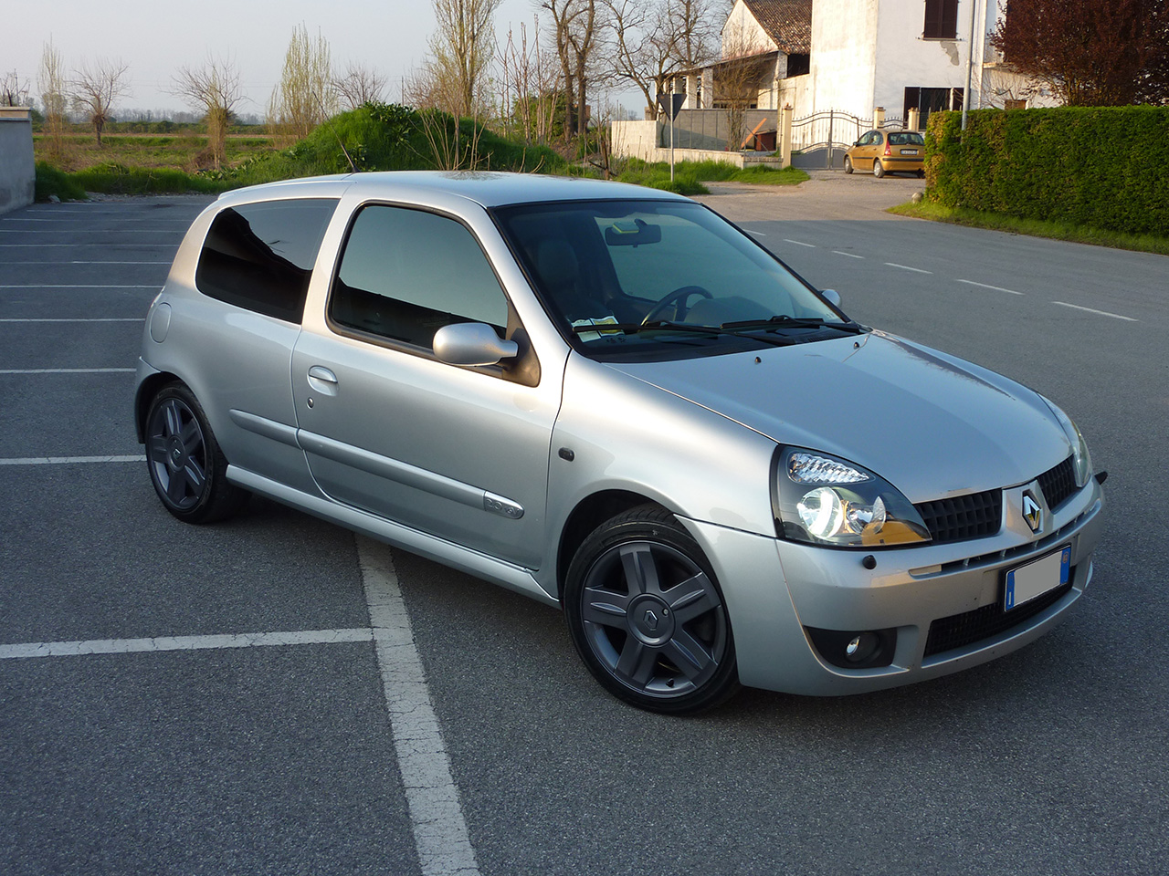

This. Gives the boy racer impression etc. Not many alloys suit the clio imo. For what you'll pay for those (brand new) i assume, you'd get a nice set of 182 alloys or turinis which will suit it so much more

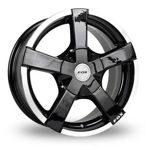

First thing to make sure is that the wheel will fit the cars bolts. You will notice your car has 4 bolts holding the wheel on and that alloy in the first pic has 5 bolts.
I might be wrong but think you will need to find some 4x100 ET 45 wheels ideally (the ET number is less then the wheel will sit further out and make the wheel look wider if that makes sense)

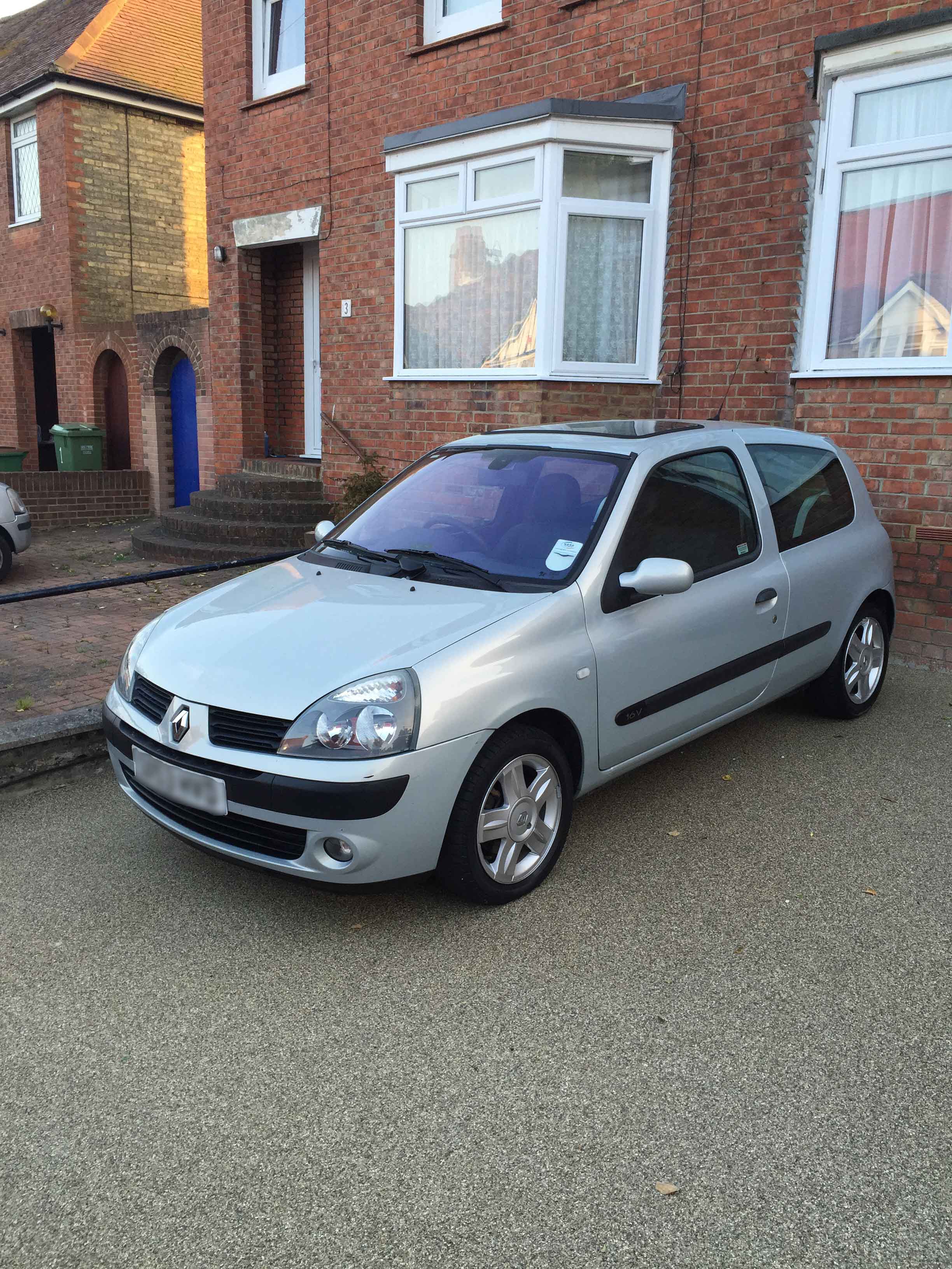

Looks like a nice first car mate. A tad better than my b reg 1.0 fiesta, which you probably won't remember :(

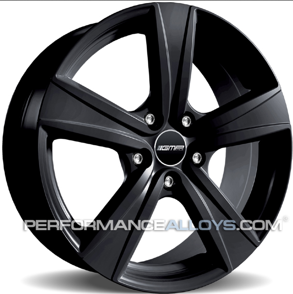

So something like these? These will fit like a glove, no hassle or anything?

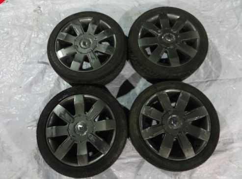

With 195/45/16s you should have no issues, the alloys you currently have are the 15'' version of the 172 alloys, desireable in their own right, plus tyres are cheaper, id be sticking with them personally and putting the cash towards upgrading consumables

You just need to make sure they fit the car.
Four stud - wheel bolts
Bore size- the middle bit needs to be the same as the ones you take off. For example on mine the centre bore is 60.1mm. Unsure what yours will be, someone will know or just google it.
If you got aftermarket wheels like the ones you posted. Aftermarket meaning a wheel not made for the car but will/should fit directly or with spigot rings.
Spigot rings- plastic or metal circular rings that fit inside an aftermarket wheel so it fits your size hub, where the wheel came off.
Example of why you would need spigot rings.
Wheels with a centre bore of say 74.2 will need spigot rings to make the hole smaller to fit your size hole. Do not run aftermarket wheels without the rings mate

Bringing this back round to being on topic. Your car looks good, I would keep it that way. My first was a Clio, left it standard, didn't even have alloys. I just used my money and saved up for my next car. 1st cars are 1st cars, save up and move on to something better.

Your car looks tidy as it mate . I'm not a fan of those alloys either , stick to the oem look .

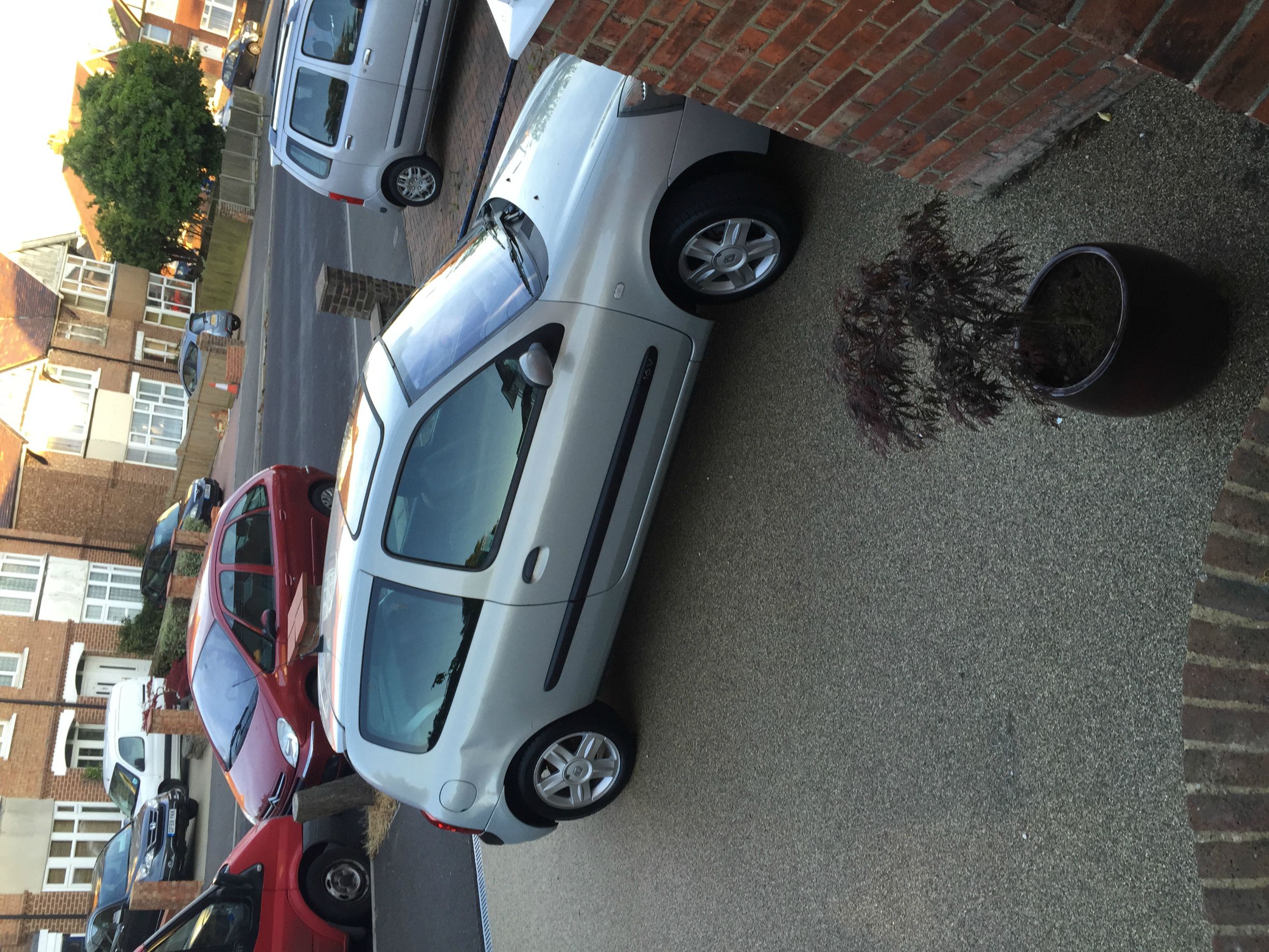

The car is great except from this dent, anyone know if it can be fixed and how much it would be?
Shame about the dent . Google PDR or paintless dent removal in your area . Typically a PDR guy would charge about £40 a dent , might be a little more for that . You'll only know if you ring one and ask .
