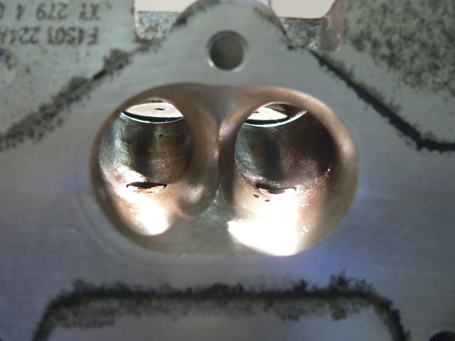

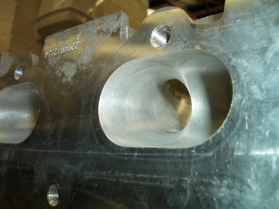

The biggest areas for gains are the inlet manifold (which is rubbish) and the cam profiles. With matched inlets and CAT428's you can see IRO 190bhp, maybe a touch over. Finding 10bhp more than that though with the standard inlet manifold and you'll be struggling.
Ben at AW has a great setup on the way that is being prototyped on my Cup and a Cup race car in the UAE, it maintains the standard DBW throttle butterfly and standard ECU, is a straight bolt on and with 428's will see 100bhp/tonne easily.
