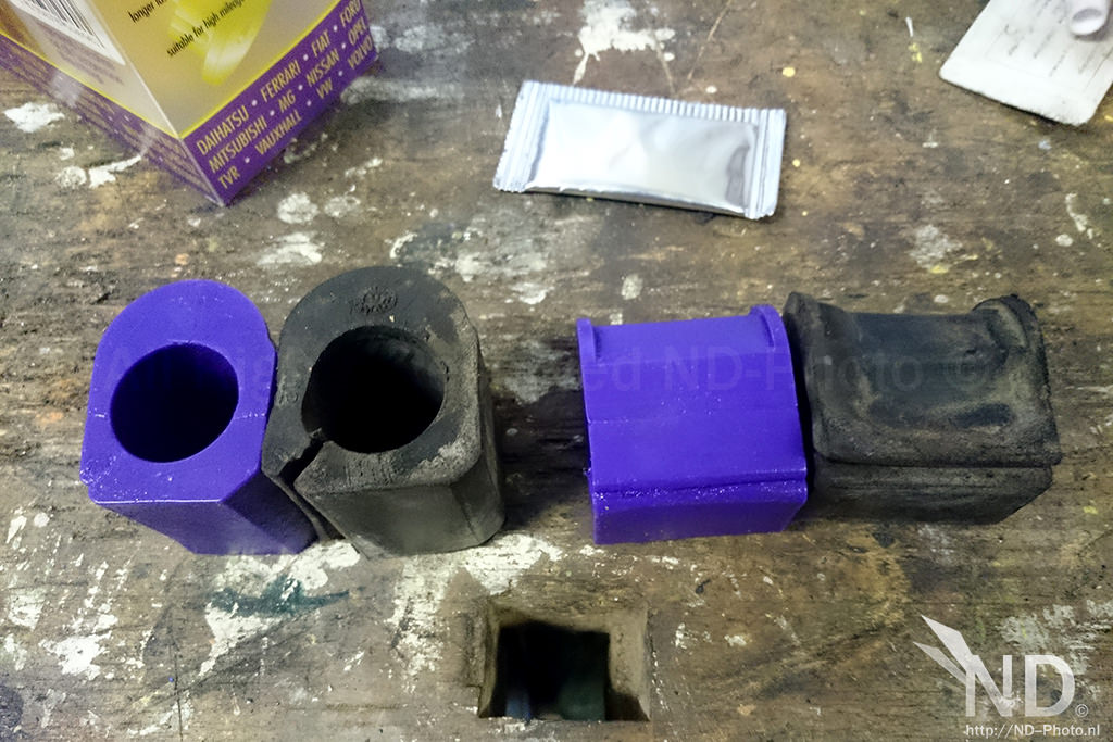

I installed the Powerflex ones (only inner are Powerflex) and so far I cant fault them. My OE ones were shot as well.
That is how they looked
Worn Bushing by Andy Ramdin, on Flickr
And the new ones (25mm ARB on mine)
Powerflex vs OEM ARB bushings by Andy Ramdin, on Flickr

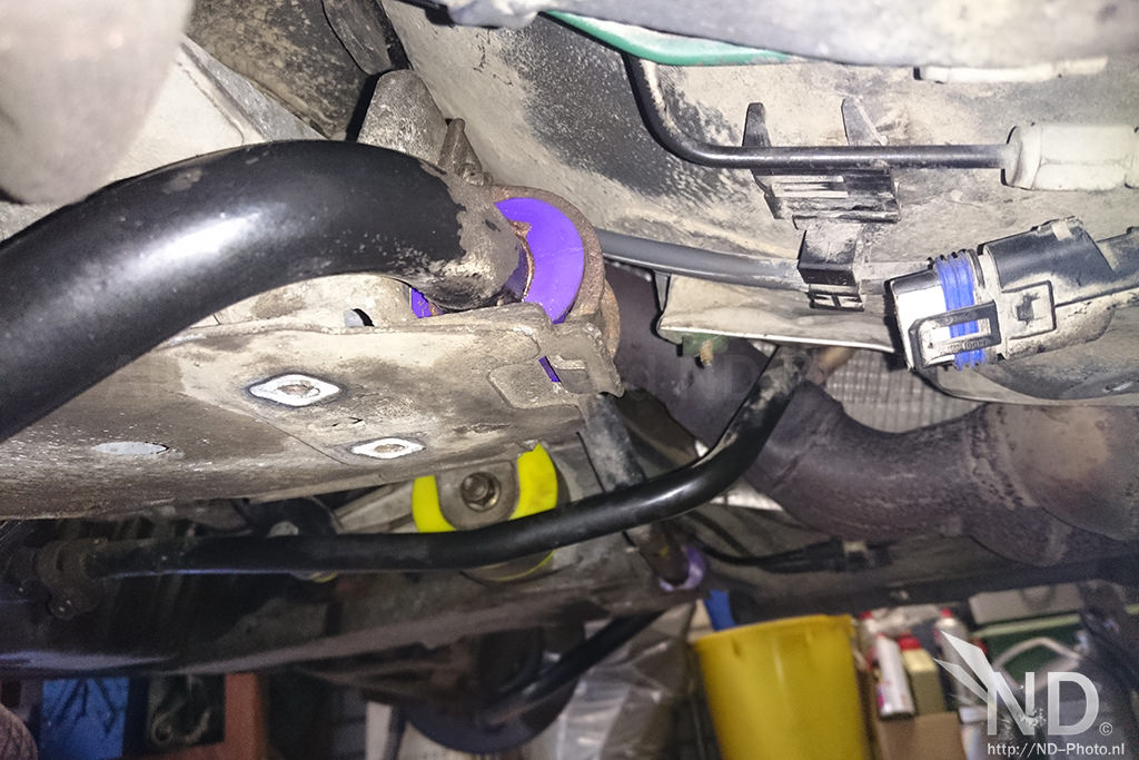

And installed (they were a bugger to replace I reckon, quite fiddly)
Powerflexed ARB by Andy Ramdin, on Flickr

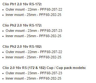

Is there any easy way to tell what ARB your Clio will have fitted as stock, or is it just a case of scrabbling around under the car with a caliper to take a measurement??
  Clio II 172 RS Ph1
I would measure it. I made that mistake to be honest. Ordered 24 or 23mm bushings first, so effectively I had to do it twice...

I dropped the subframe on mine to change all the bushes as these are a c**k to do.
Dicky Belly 3
They're an absolute piece of piss with a crowbar.
I struggled for hours trying with mole grips/mini g-clamps.
Brought out the punisher and got it done instantly. It's all about the levereage.
  Clio II 172 RS Ph1
I made the hole in the subframe (for the bolts) just a mm or 2 larger. When tightening it, it returns to normal position.
