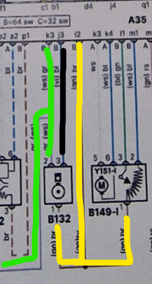

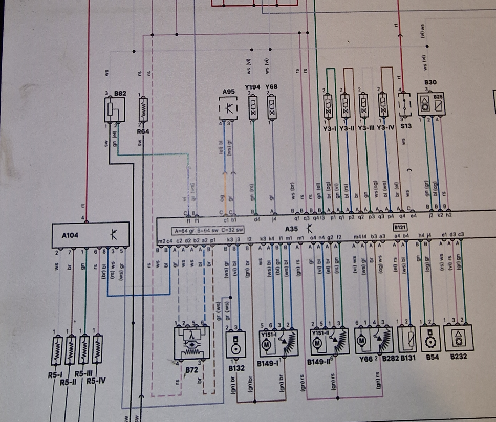

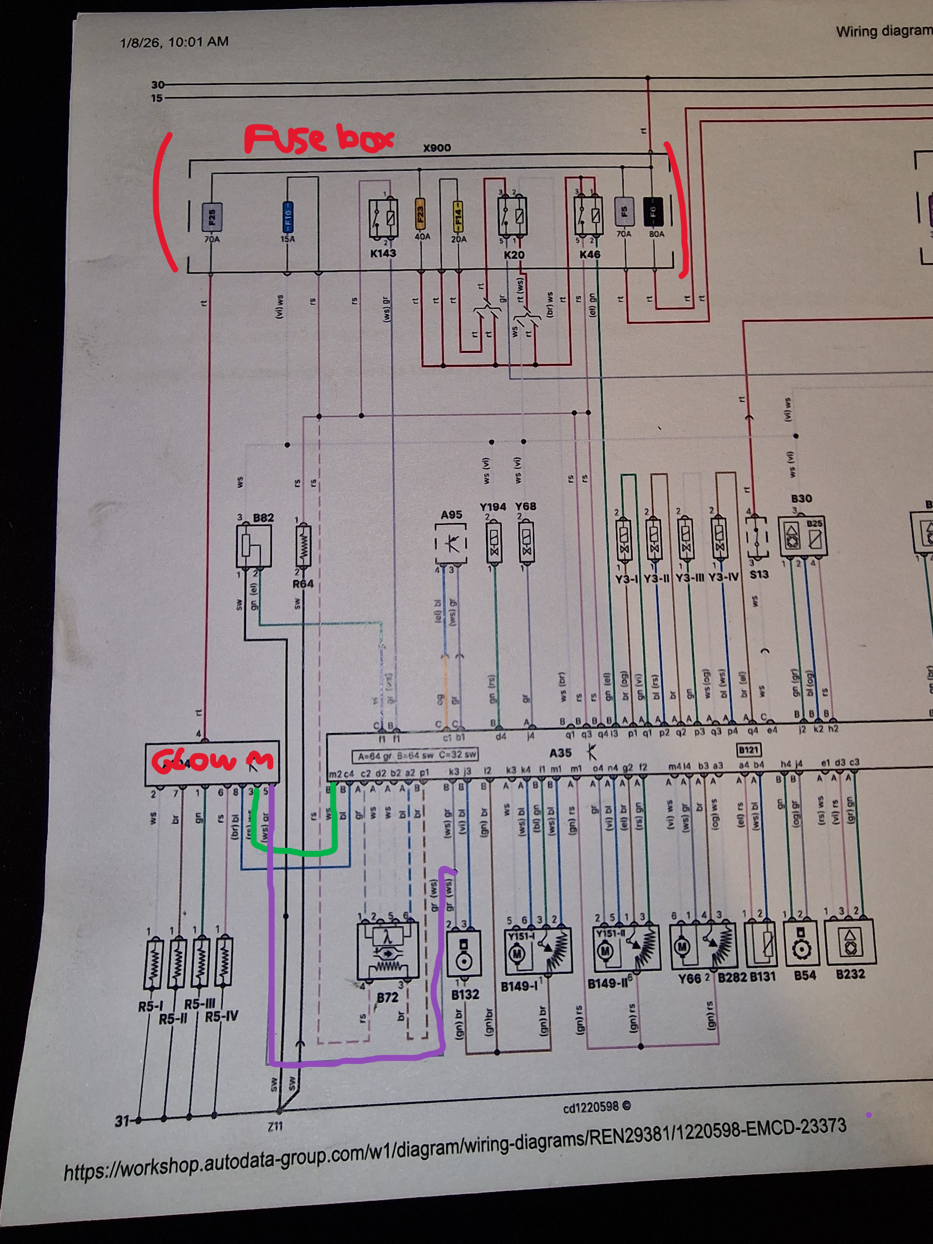

I will show the wiring diagram so you can see the circuit which i've annotated but will also include a blank version too at the bottom.

4 - The purple wire below goes to the camshaft position sensor, this looks to be a switched earth as its not currently an earth when probing it? This has confused me. Why would it have a switched earth AND a signal wire? Is this normal in auto electrics? I load tested that wire too, from the ECU to the glow plug module and not breaks in the wire but this one has me baffled a bit. This wire is proper thick coming out the module too, but then goes to a really thin ecu wire???? Thats not earthed as standard? To me that doesn't make sense but does stack up with the wiring diagram.
4 - Checked the earth from engine block to chassis, loaded up and all okay (check condition of ground)

What is the function of pin k3 on the ecu. The pin which is connected to both camshaft position sensor and the glow plug module? Is this supposed to be the signal line from the cam sensor or is this sensor 5v/gnd?
The Cam sensor likely is a hall effect and has 3 pins. Signal (square wave), power (5v), GND. It could be that the glow plug module looks at this square wave out of the sensor as a way to know the engine is running. This would also explain why you don't see power or gnd on that wire.
Do you have an oscilloscope to probe pins 8 and 3 on the module? EDIT* just read about your picoscope. From what I read the module needs a wake up signal from the ecu, I would guess this comes on pin3?
So according to Chatgpt it's a clean reference ground that's going to the camshaft sensor mate.
The other two wires appear to be a signal wire and then the reference checking wire bud.

Pin 8 = control
Pin 3 = diagnostics
Pin 5 = cylinder sensor
According to official wiring diagram
So that sounds plausible what you just said @Flob about it detecting engine moving.
If that's not getting a signal from camshaft sensor I wonder if that could be related.

Pin 8 = control
Pin 3 = diagnostics
Keep in mind I made that up, its a complete guess.
I would carry on once you have your probes. But I wouldn't rule out the fact that the car might have two issues. The glow plugs being one and an injector going bad. With either working fully seems they should still start alright going by Scrooge and Brigsy's messages above.
PS - if my guess is anywhere near correct then its more likely the module uses the signal from the cam sensor to turn off plugs once engine is running. Why it would need to do this when it has a control line from the ecu I don't know - so equally it could be a reference ground. Would be good to see a list of ecu pin functions of you have access to that to confirm that pin k3 is expecting.

Small amount of googling suggests that Black is ground, Green/White is signal and Green brown (Yellow in my screen grab) is a 5V reference
that will be easy to confirm by probing the cam position sensor, should be able to find 5v and gnd then the last one (which I think goes to the glow module) does look to be the 5v square wave signal out of the hall effect cam sensor.

But remember the supply is from a 70A fuse, so the return (ground/earth) needs to be able to carry 70A, this isn't going to be a pissy wire going back to the ecu.

That's what's confusing mate. Because according to the wiring diagram, it goes directly to the pin 2 on cam sensor if you look up at my wiring diagram. This wire is f**king tiny thin as you've expect.
The wire then goes to the ecu from there
What doesn't make sense is how thick that wire is coming out of the glow plug module. I can't get my head around how its going from there to two tiddly little wires to cam sensor and ecu. There is a splice denoted in the other wiring diagram I have but to me it doesn't make sense.
Not sure what you said is correct though mate as the 70a will be feeding glow plugs, which is then earthed through the engine block and back to the battery with a thick earth cable?
