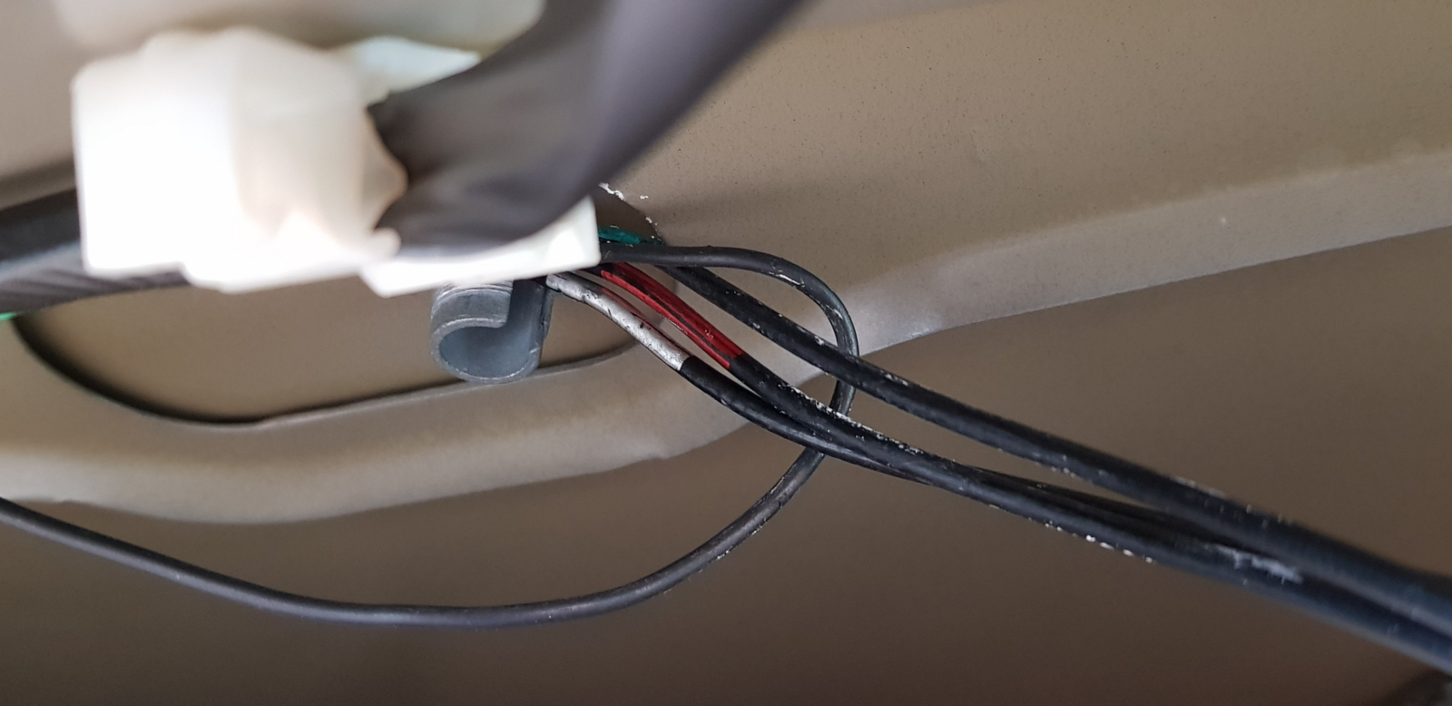

Hi all,
Recently removed a factory satnav system from my 182. Because of this I'm now left without any signal for my radio as I presume it was getting it through the nav box.

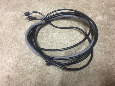

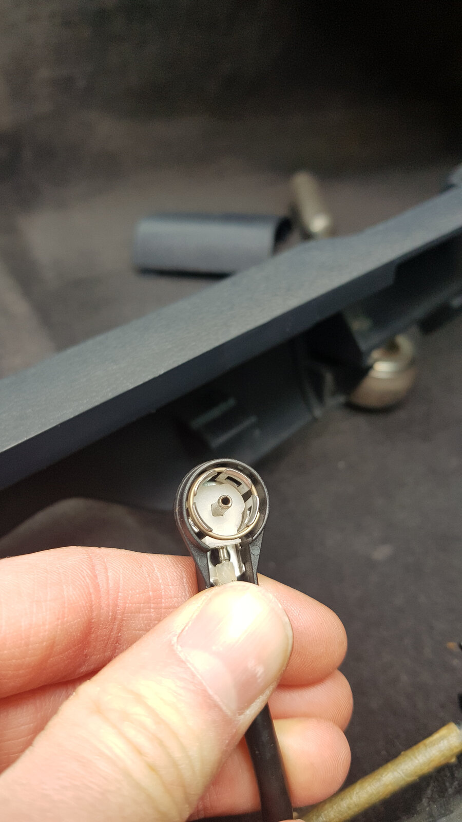

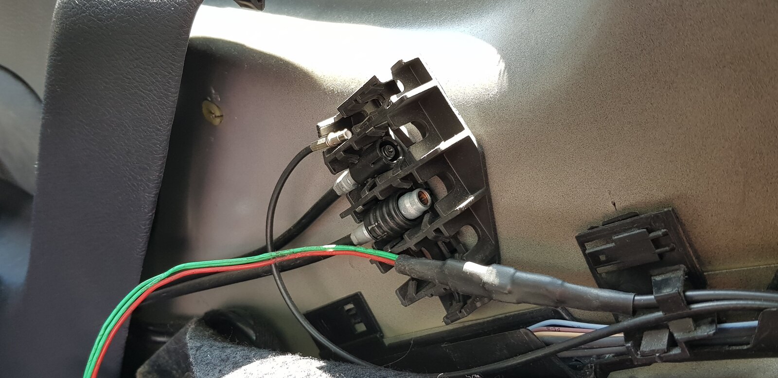

I have these 2 connectors (top was going into box from aerial, bottom going into box from radio). I presume I need a female DIN to female ISO to join but I'm struggling to find this? I want to avoid using loads of connectors really to join them!

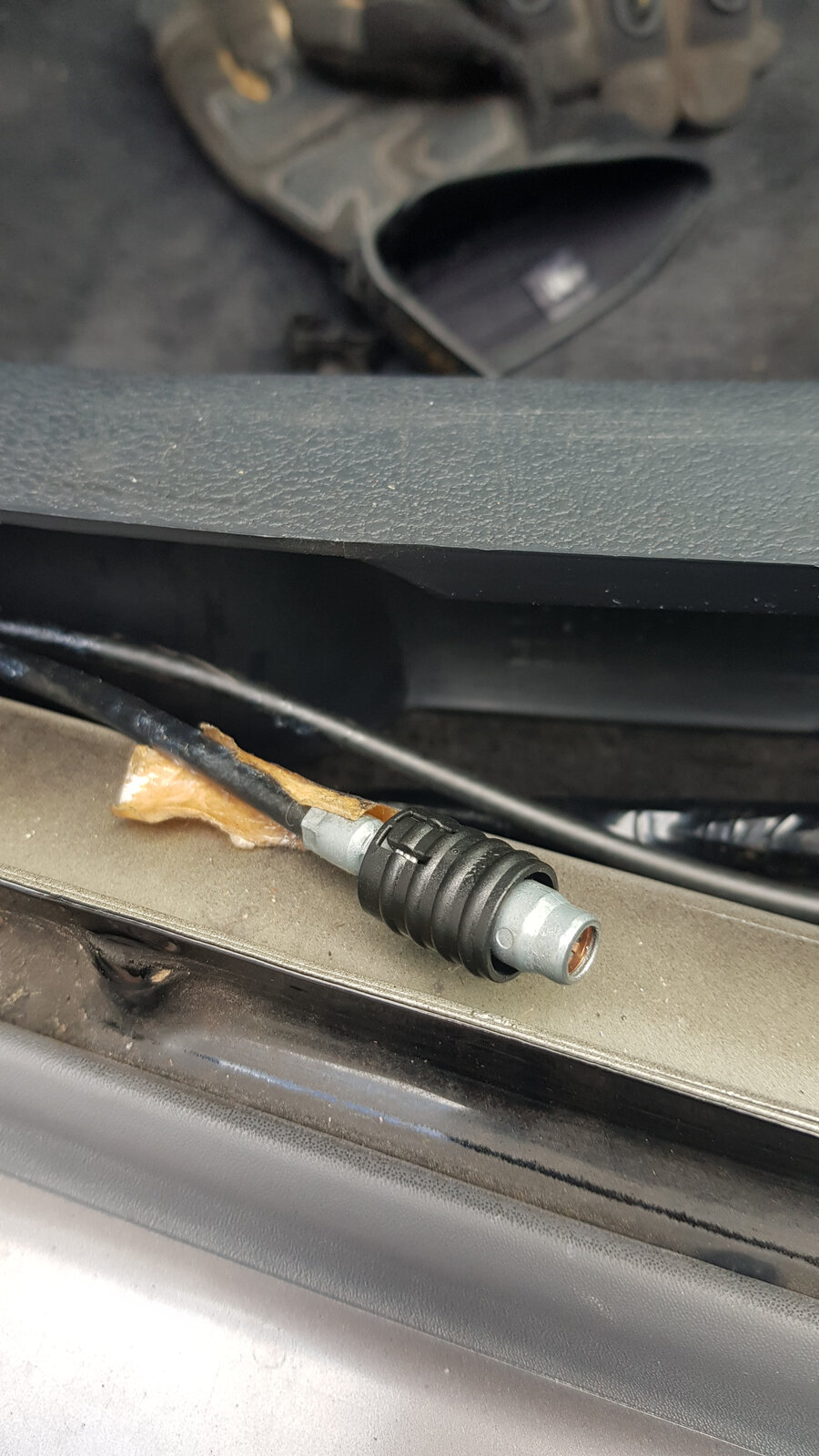

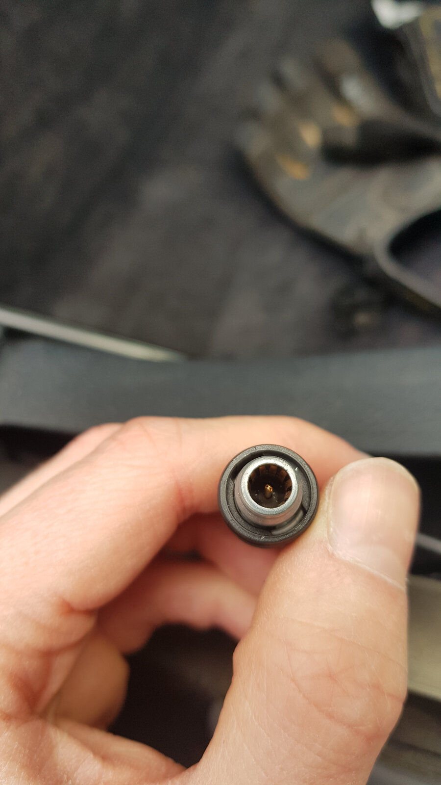

I also have a third cable from my aerial that I found disconnected in the sill trim, any idea what this is for? Is it to use instead of the above to connect to the radio if removing the nav? No idea what the connector is.

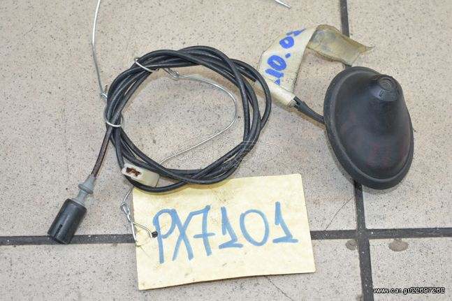

The aerial has 3 cables coming out of it as in the photo below.
Not many of these cars have genuine satnav (42 iirc) so finding information on them is hard.
Thanks in advance!

That's just a normal aerial connector mate
Probably got the same loom across all of the range

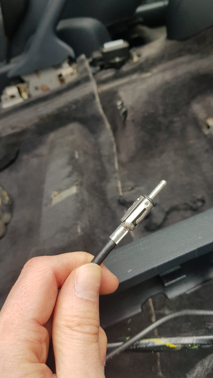

Which? i have the standard DIN male cable from the radio, then the ISO male from the aerial.
Is the one that was disconnected the standard?

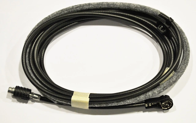

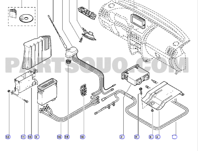

Found this on the interwebs.
I might be getting somewhere now. The connector at the very bottom looks identical to the one from the standard aerial. So you're probably right, buy the full length cable and just connect as normal.
Louis
I Park Like a C**t

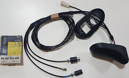

8200077690 appears to be the cable I need.
Wonder if the length is tucked away somewhere else or it's a different (Shorter) cable in the satnav system.

I'm not wanting a new base haha, i reckon if I get a cable like this I can just plug and play and run it down behind the radio.
I could do with a cable like that with the female end so I can plug it into the disconnected one in the sill trim.

I wonder why it has the random disconnected connector in the base. I always thought the GPS was in the base of the aerial (as its longer) but all cables just appear to be standard FM coax. Might need to research more.
