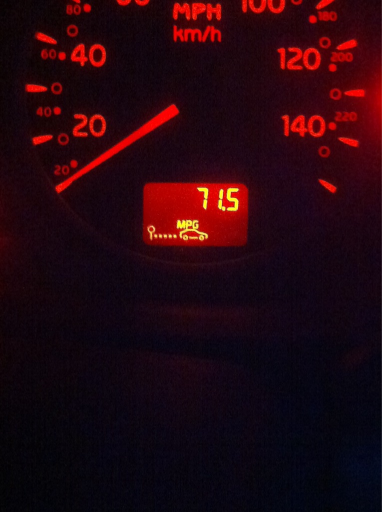

Re: miles, I wouldn't worry. My 80 is on 180k, and runs really well still. I had to stick a clutch in it, but it's good as gold now!
Economy:
Pulls pretty well for a cheapy little daily bus too.
