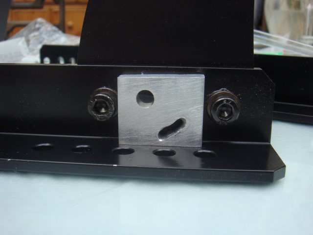

I just drilled a 8mm hole and a slot so the buckle can't move

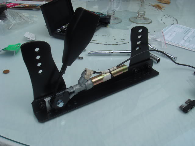

Vincent you really wanna be running 10+mm, Standard is around that, Here's what i did -
Made a custom plate to stop the seat belt pre-tens moving about

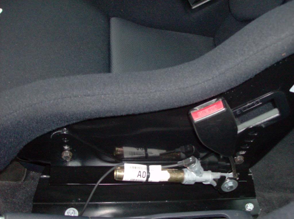

Then bolted it all together, M10 bolt & 2 Nylon nuts to stop it coming off any time soon
The finished piece
