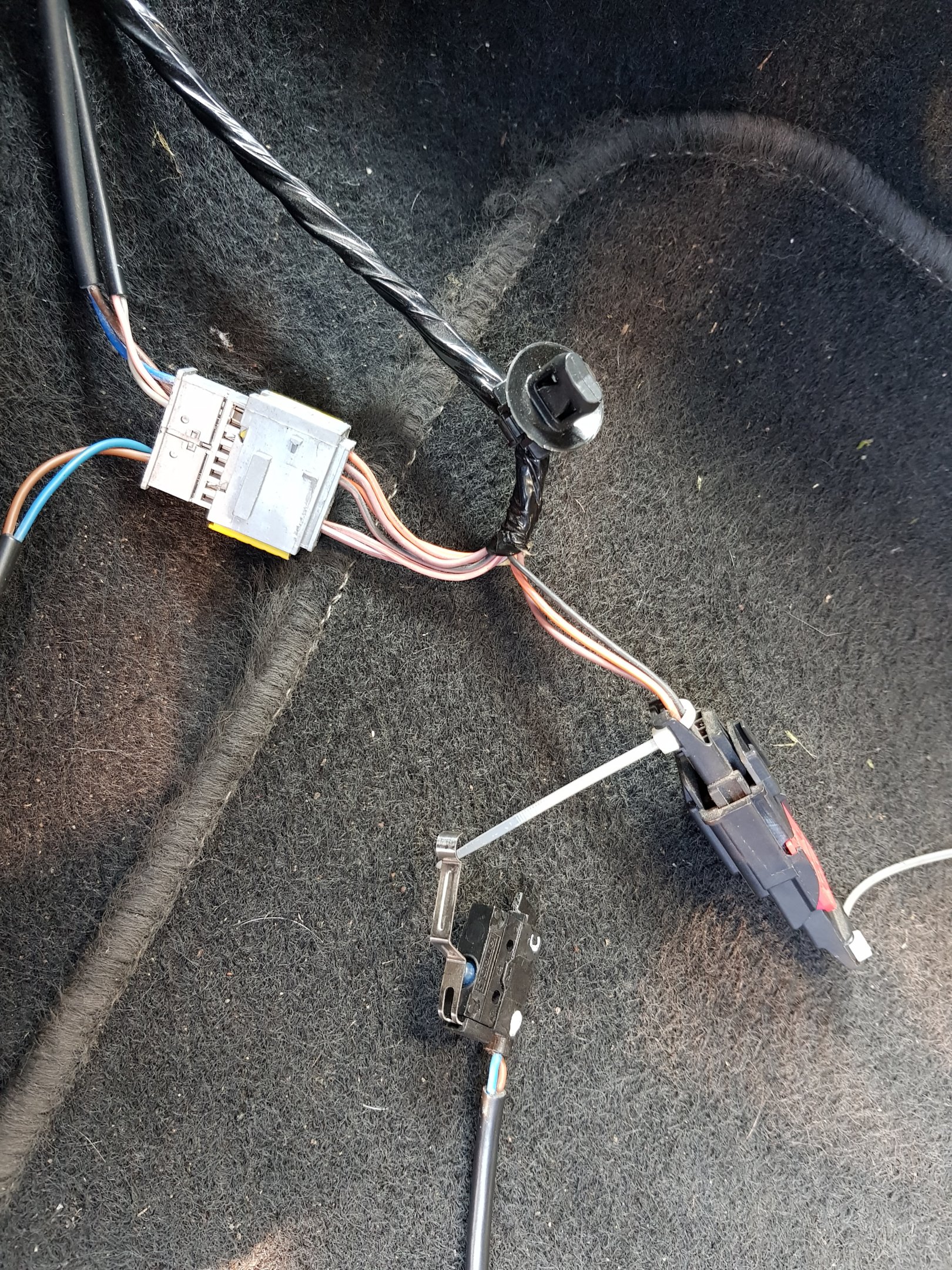

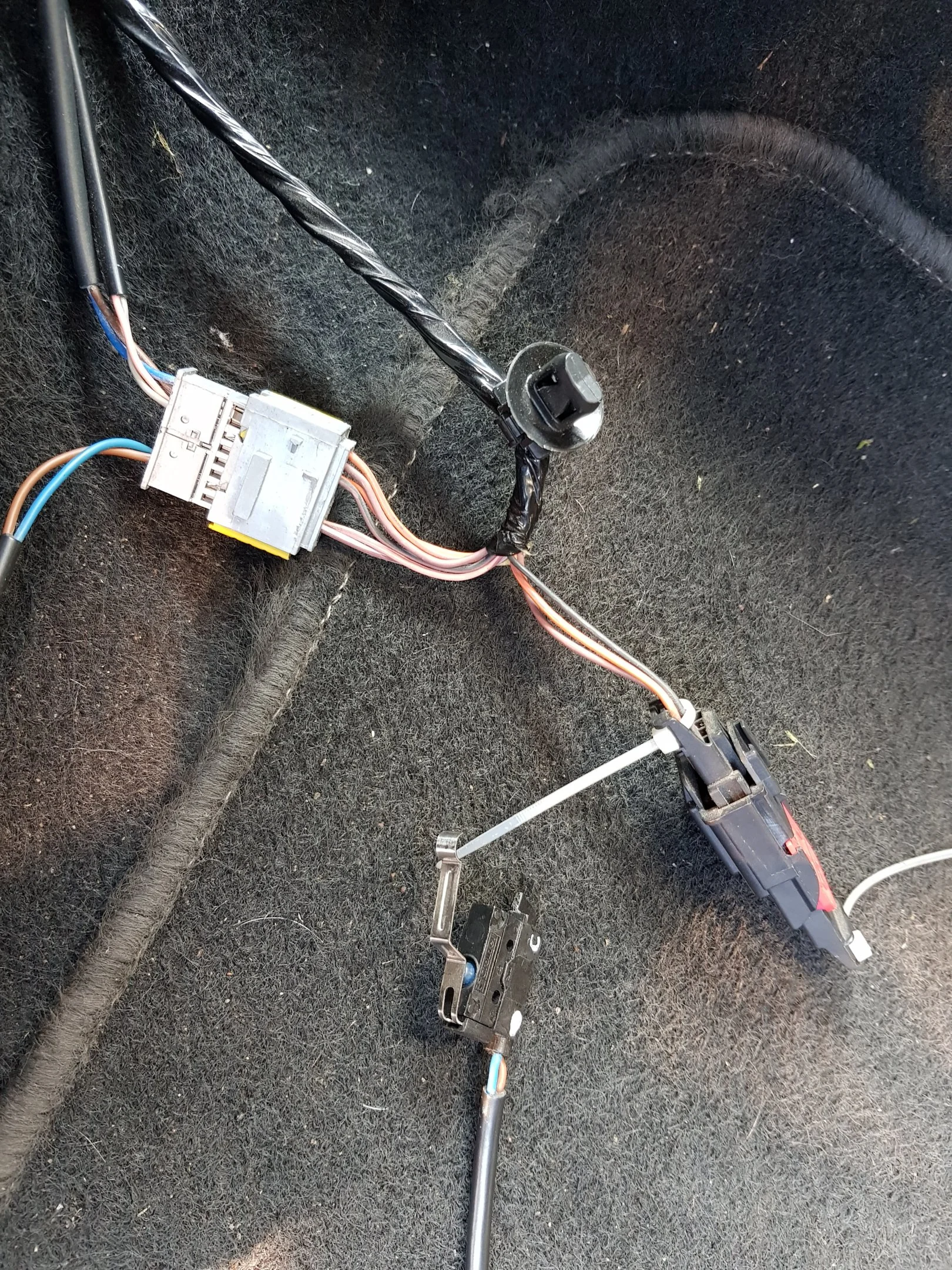

On checking the wiring under the seat, i found a wire not connected to anything. Do i need to do anything with this one (see picture the one with what appears to be a bent metal clip and a button under)?

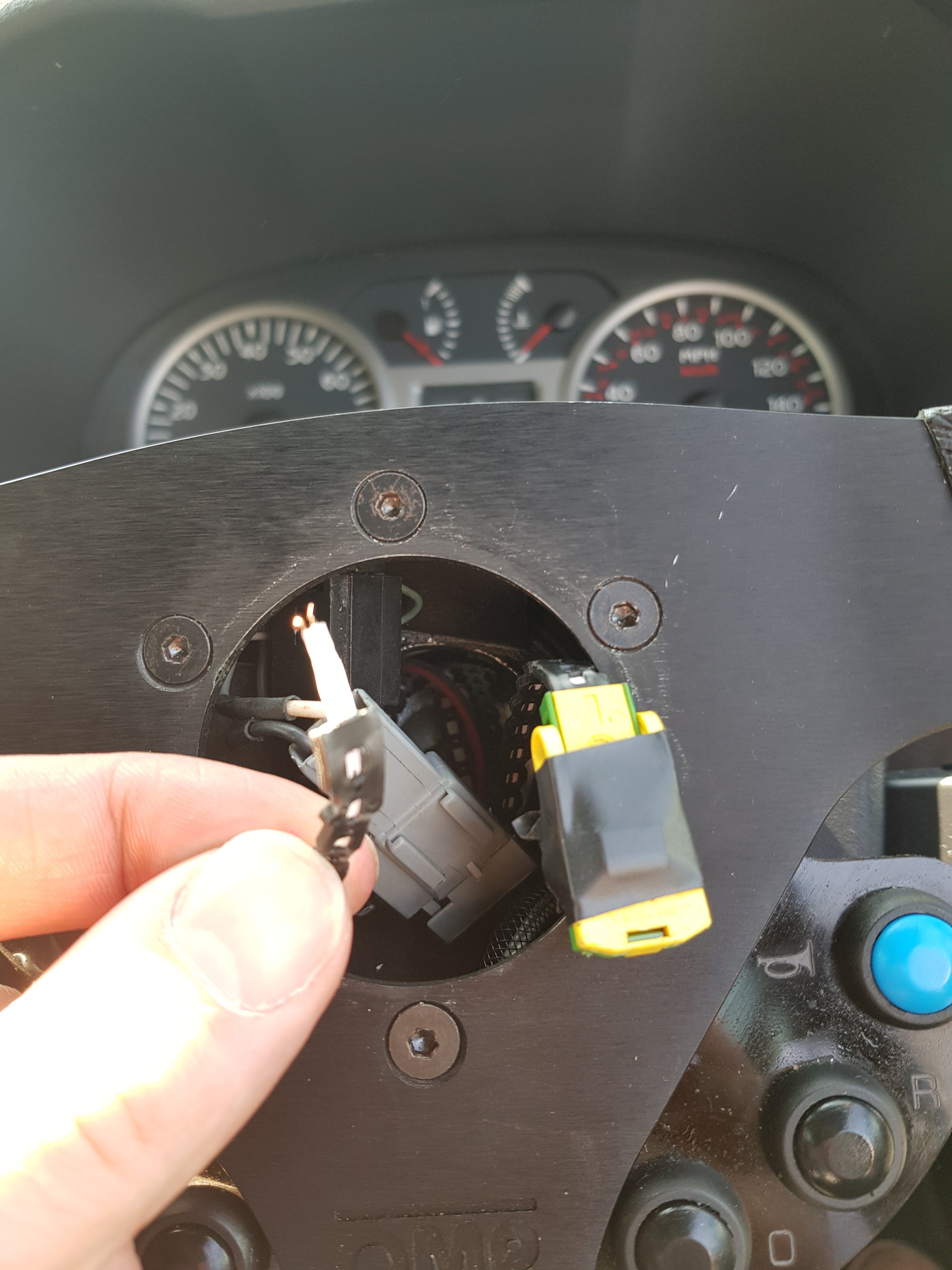

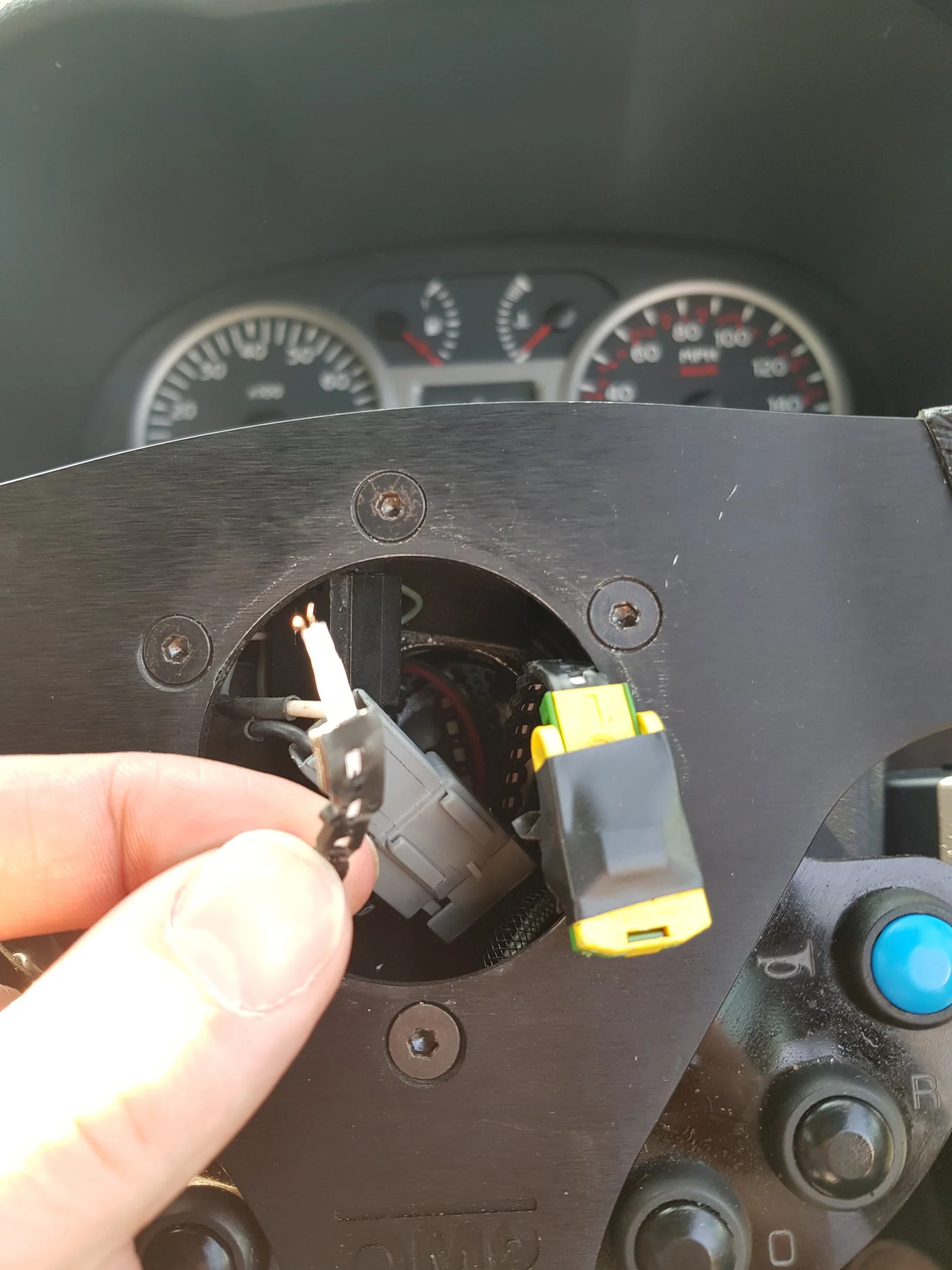

Then the steering wheel looks like it has a resister already, but a second wire looks to be cut. Looking at a guide i believe this also needs to have a resister is this correct?

Cable tie the clip back on the one in the footwell and put a 3.9ohm resistor in the one behind the steering wheel
One of the connectors already has a resistor installed and is taped up, but looking at a guide earlier it looked like two connectors needed resistors and i'm missing the second connector. Can i just use a scotch block on the end of the snipped wire to install a resistor?
What is the footwell wire for with the clip/button?
