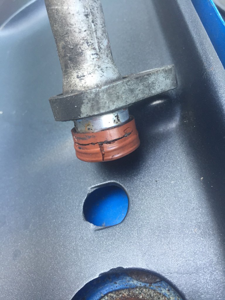

I took my car to get the air con re gassed at halfords a couple of months ago. They didn't test it for leaks first and I only had air con for a day :( I took it somewhere to get checked for leaks and he said it was leaking by the compressor connector. I've just taken the pipe off and the seal is like this -
Do you reckon that would be enough the cause the leak? The seal basically fell apart when I went to take it off. If so, I'll order the new seal from Renault and then take it somewhere different to be re gassed where they'll leak test it first.

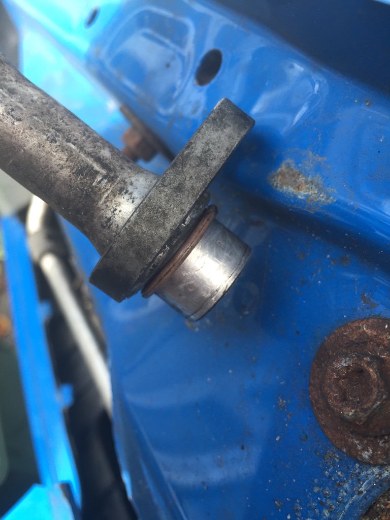

Right I've been into Renault and got the pack of new aircon o rings to sort this pipe out where the leak was. The person in there seems to think that the orange seal thingy that was on the pipe isn't needed, it just needs one of the o rings. Does that sound right?
I put one of the o rings on, but when I put the pipe back in, it doesn't feel very tight? Have I done it right?
  Megane 225 f1
You only need the big orange seal. Before you put the pipe back in smear some new engine oil on the seal. This ensures the seal dosen't get damaged when refitting
  RB 182
The big orange seal is broken so I'm guessing that's why it was leaking. Can't seem to find a replacement though and Renault just had the o rings?
Have you tried renault wolverhampton? They did come as a kit a few years ago.

I don't know what equipment halfords use but some test for leaks with a vacuum not under pressure. This can suck leaking seals together so they pass the leak test. As soon as there is pressure in the system is leaks.

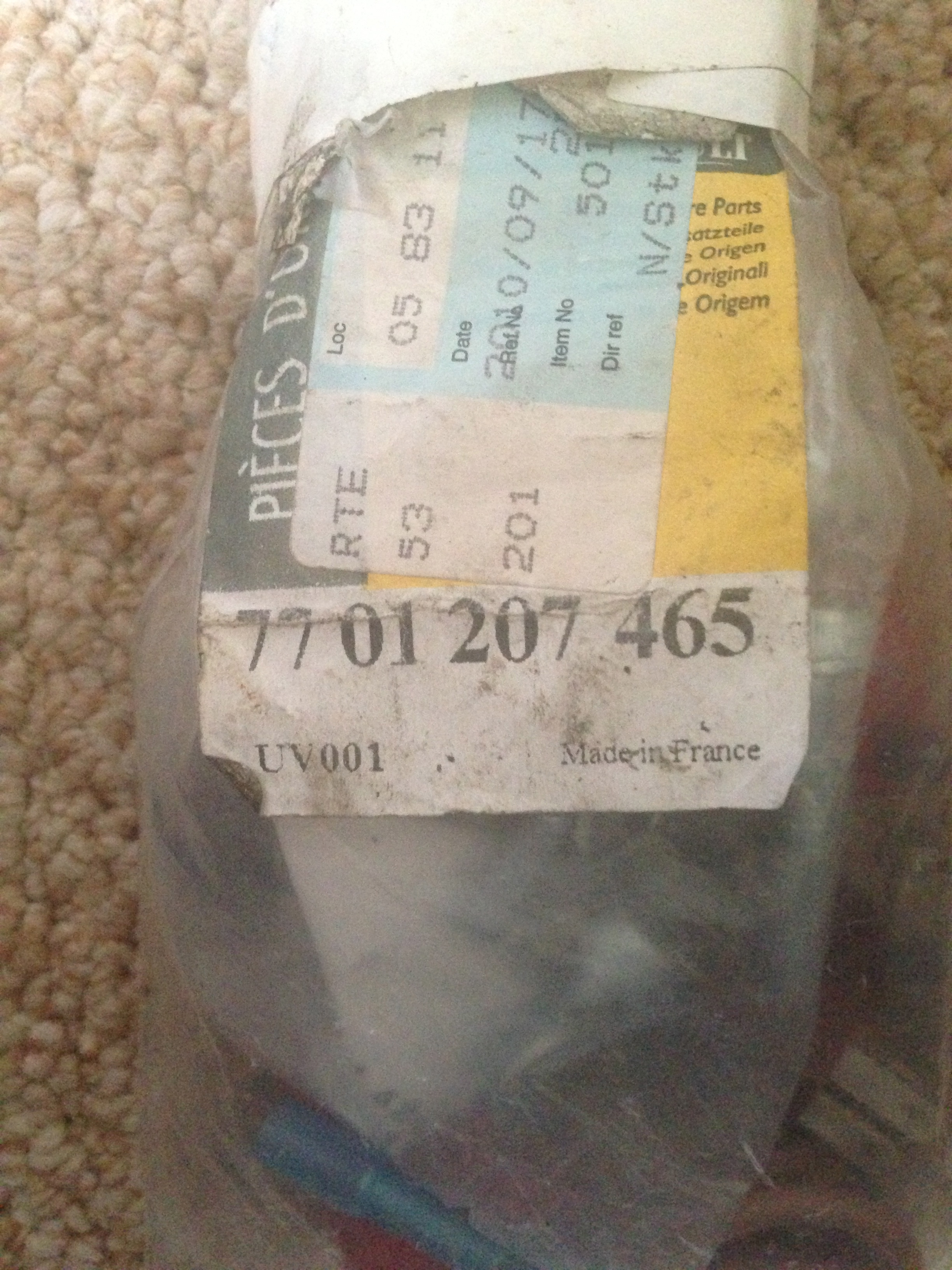

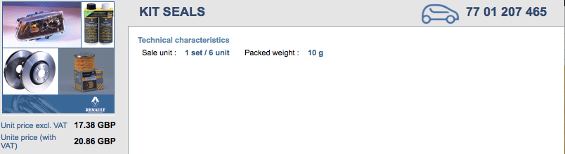

You have to buy 2 seal kit's, one kit contains the O ring's that you already have.
The other kit contains the orange seals that your after.
You end up with far to many seals for what you need.
I replaced all of the seals on my PH1 air conditioning so I have a lot of these seals left.

I managed to get the other kit of brown seals from Renault today with the part number. Does the pipe just need the bigger brown seal on it, or does it need one of the smaller o rings as well? I tried it with both but couldn't get the pipe all the way back in so just used the bigger one.

Pipes have an O ring or the larger seal.
Not both.
