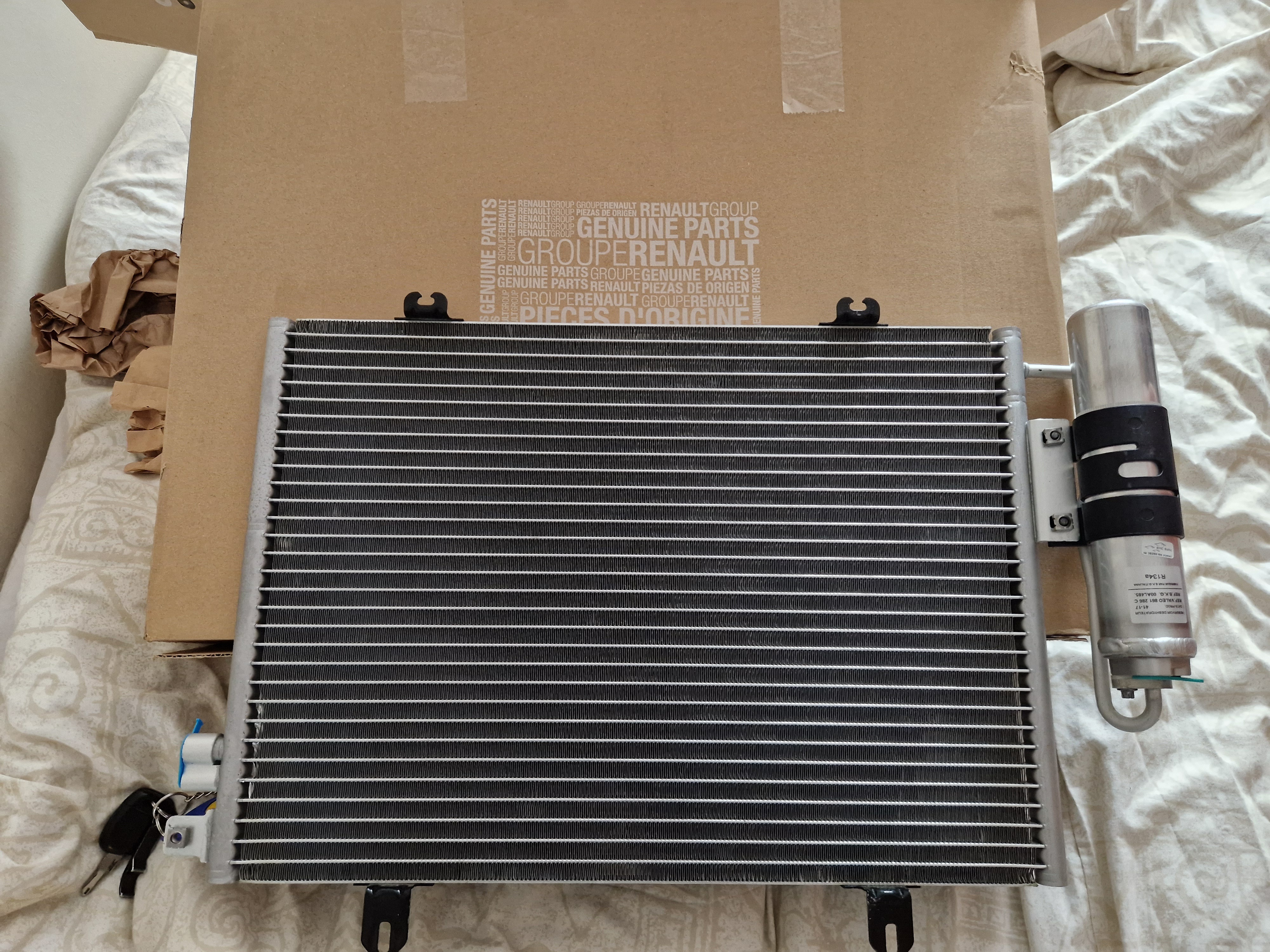

As above id get a condenser for it as they are cheap.

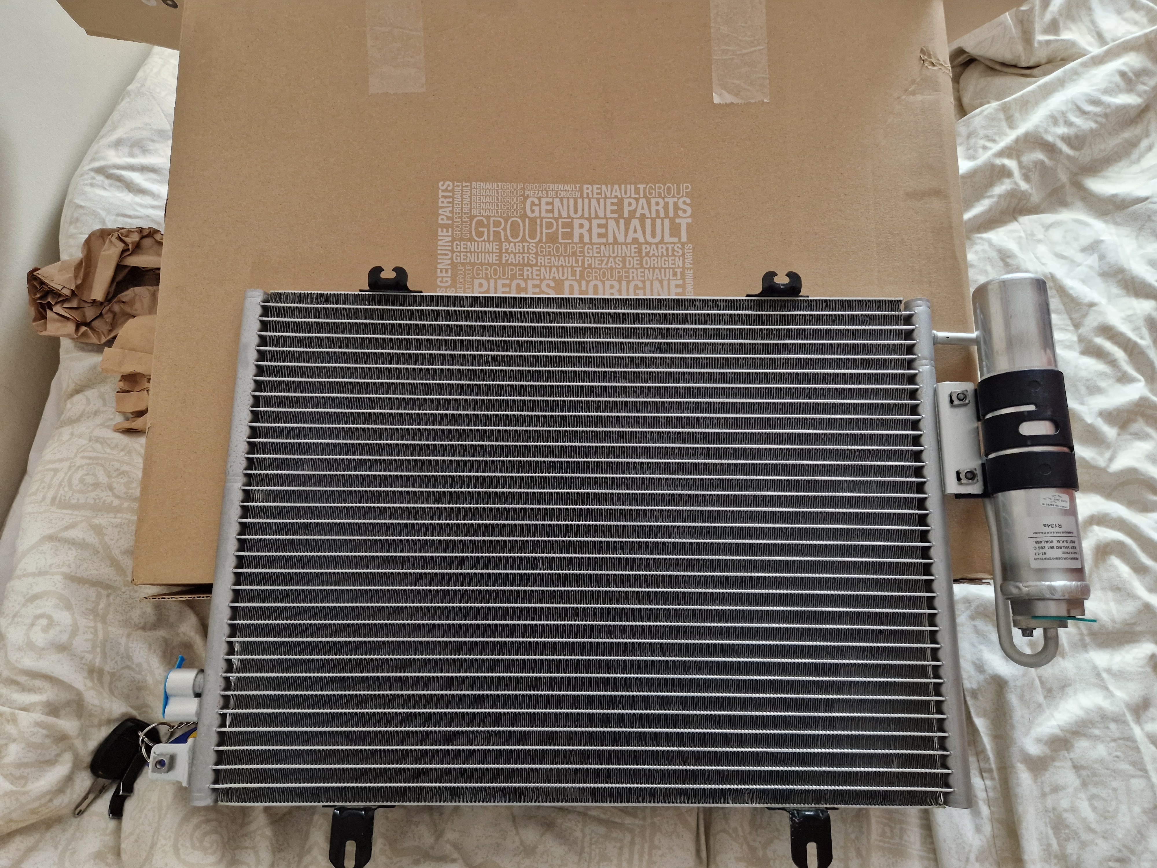

Replace condenser and dryer at the same time which does require bumper to be off.

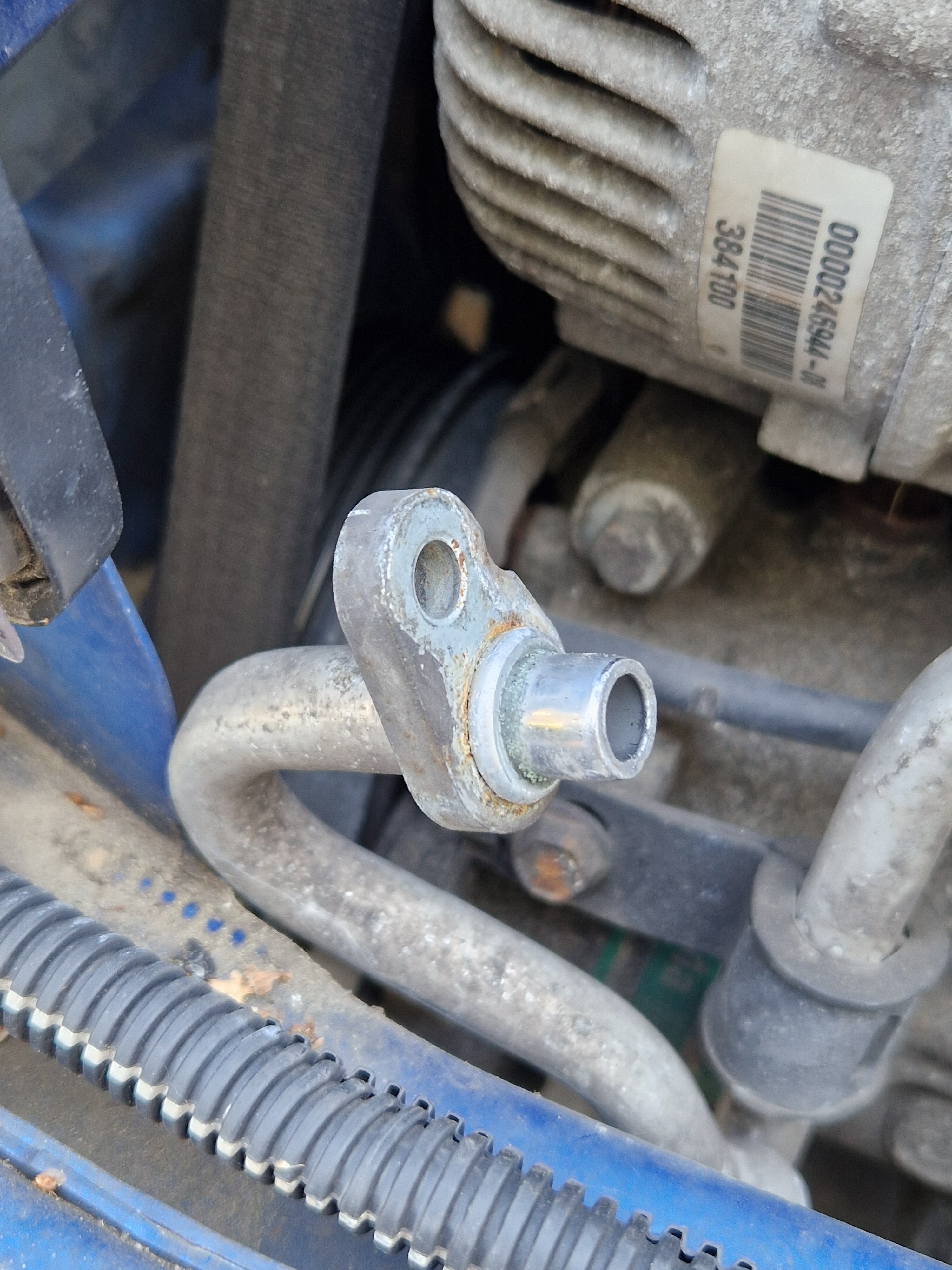

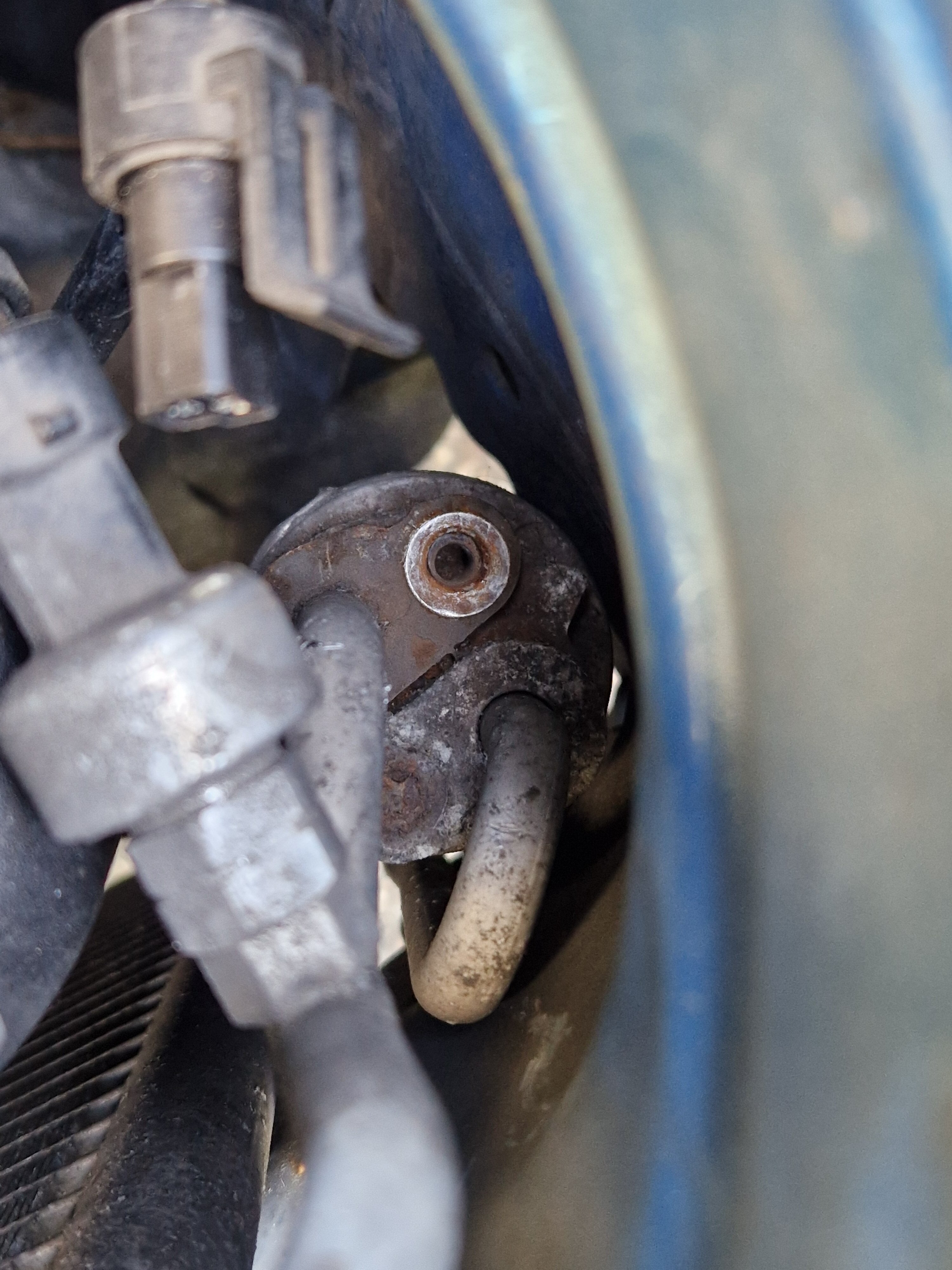

Took this bolt out but the thing won't budge 🤔
I've tried hitting it with my handbag to no avail

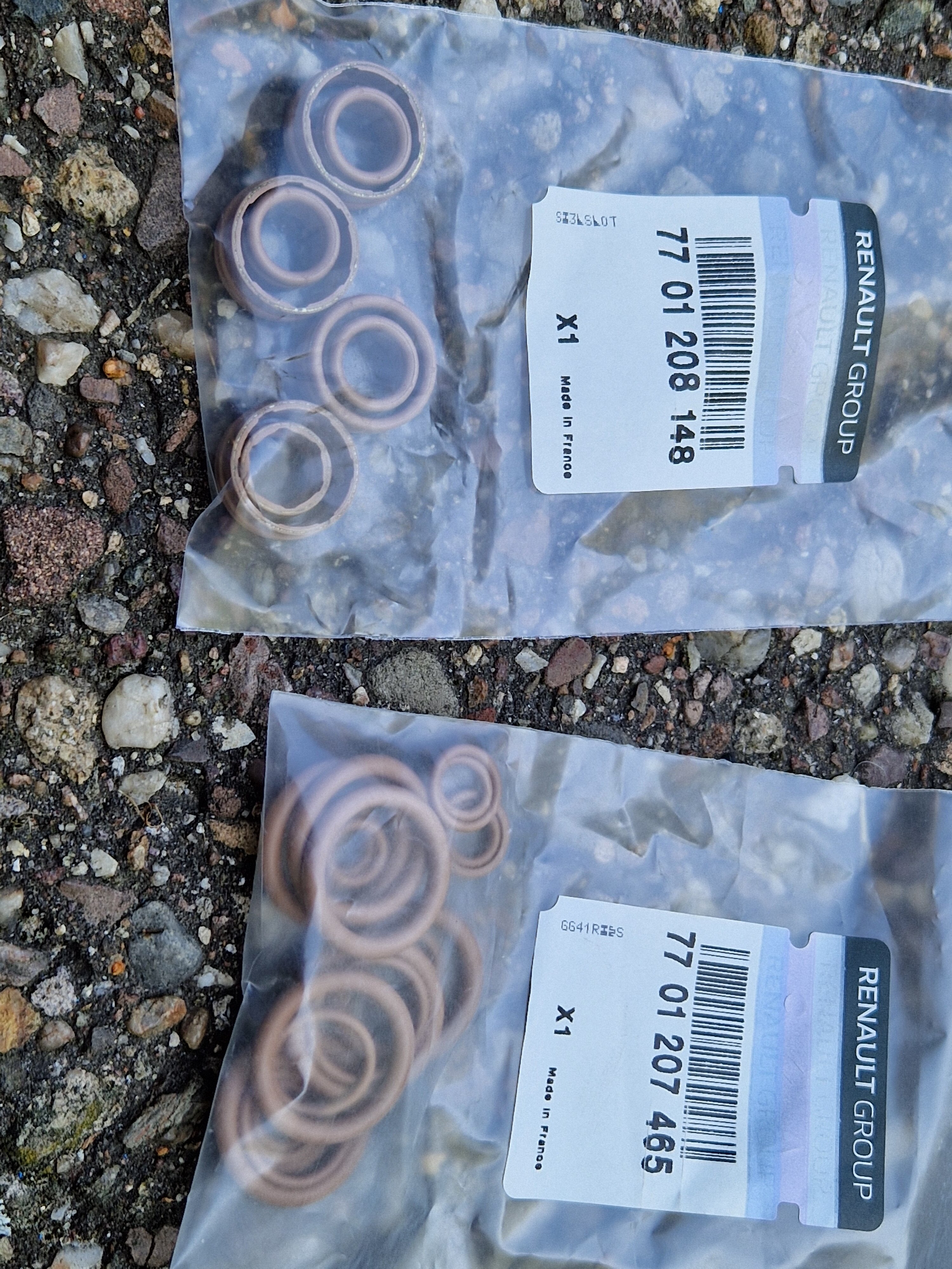

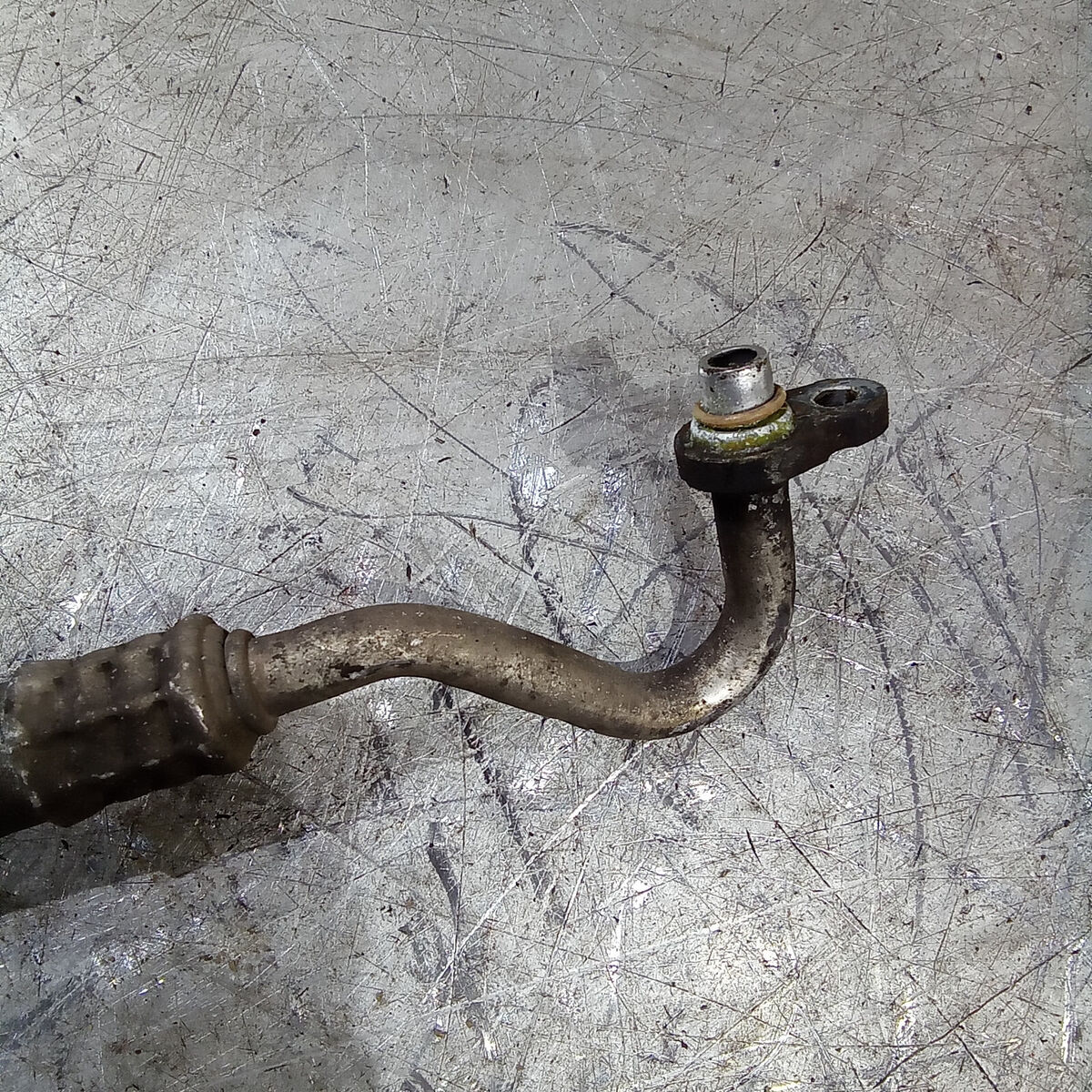

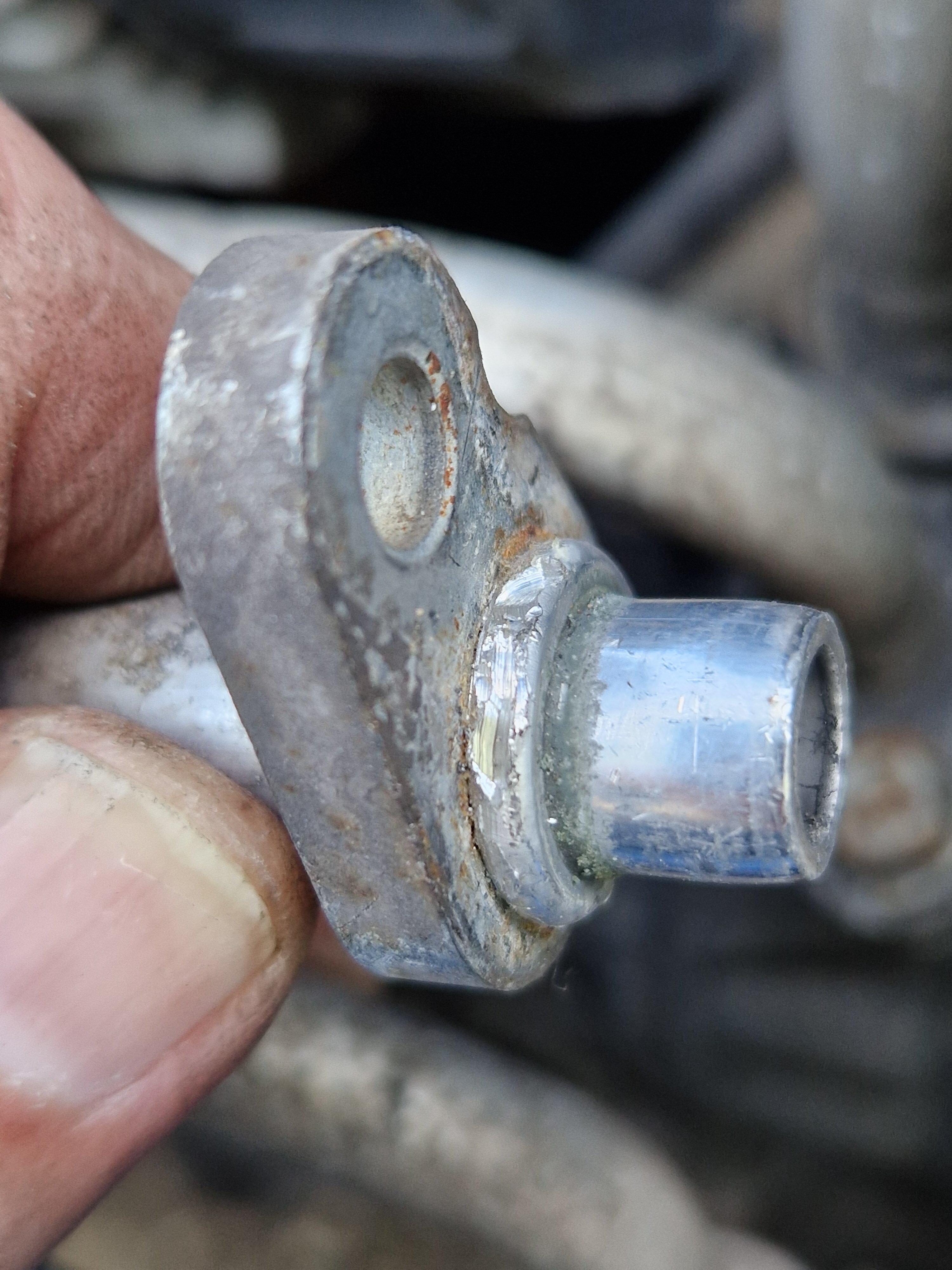

What seals go where then? I've got these ready.

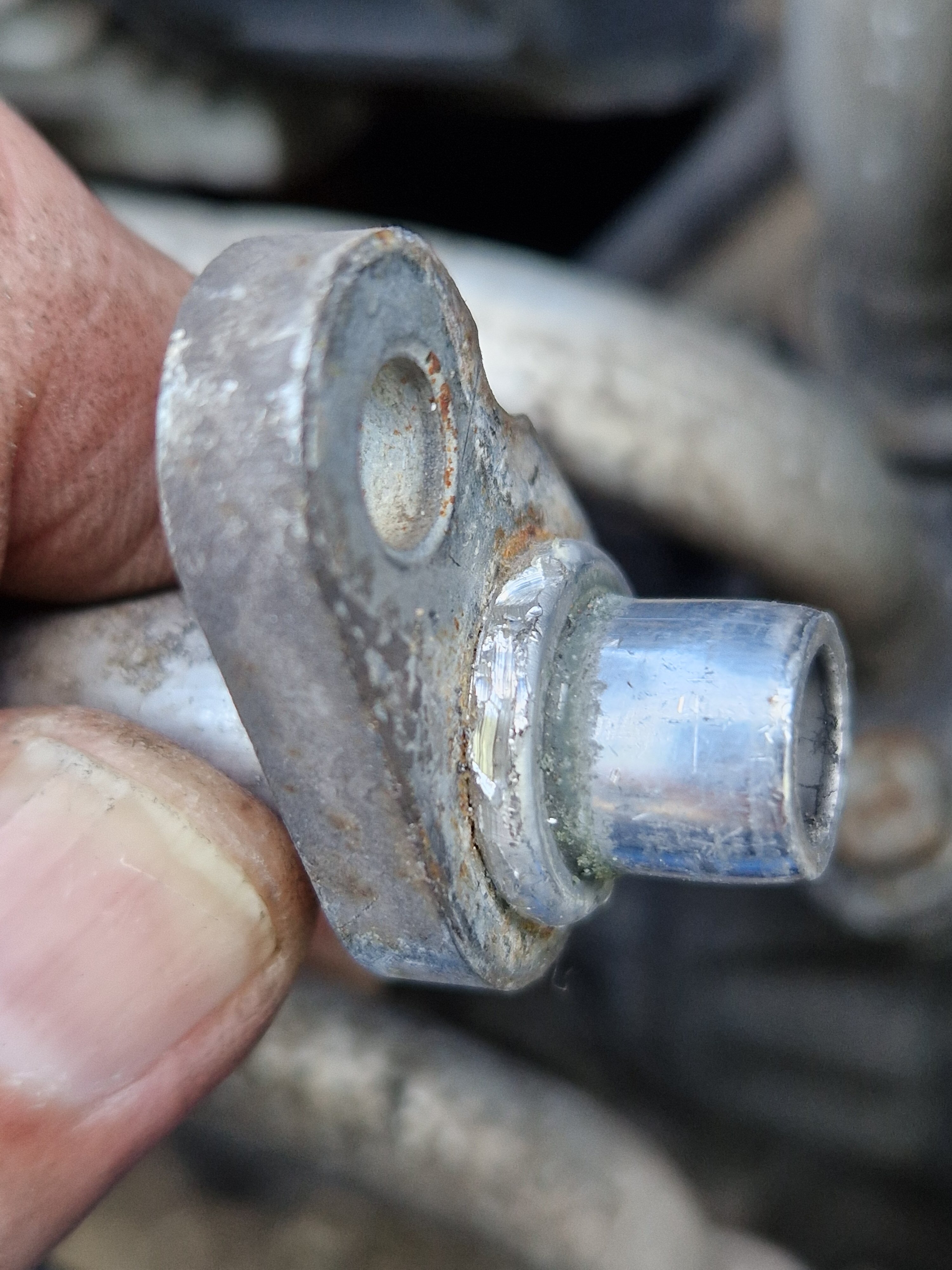

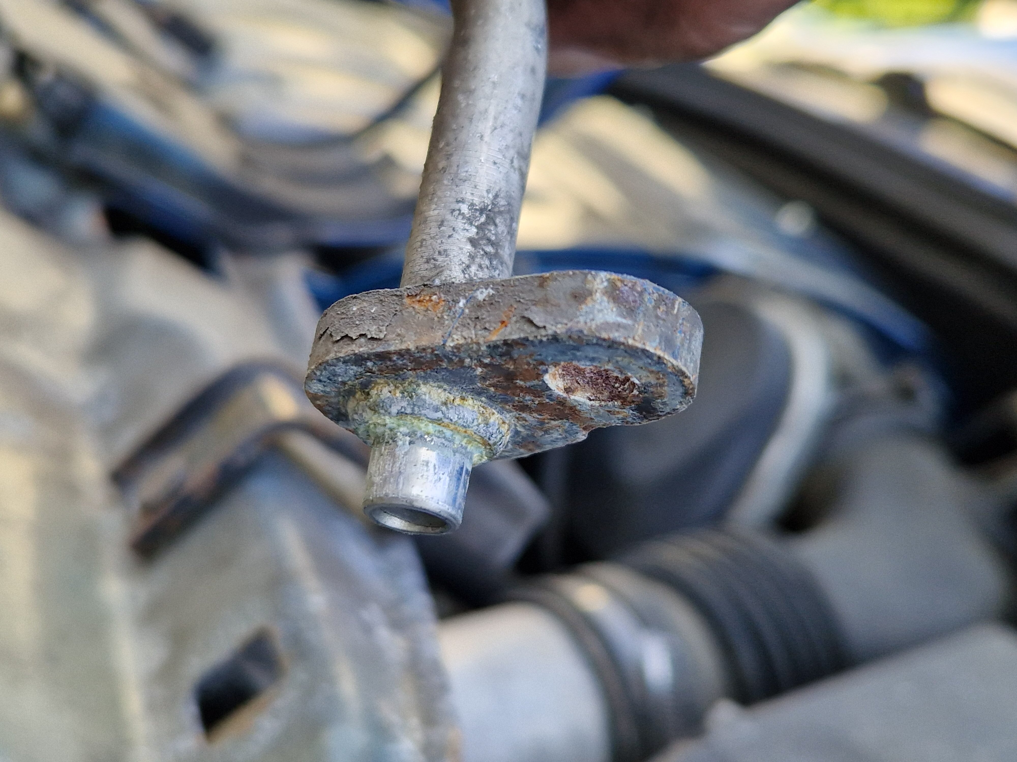

There don't appear to be any seals to replace on the pipes I just disconnected 🤔
The top packet are ones from the AC compressor i think.
The others are for the various pipes.
Those pipe have got seals on, they just look like metal 😂
Have a dig at them and they'll come off.

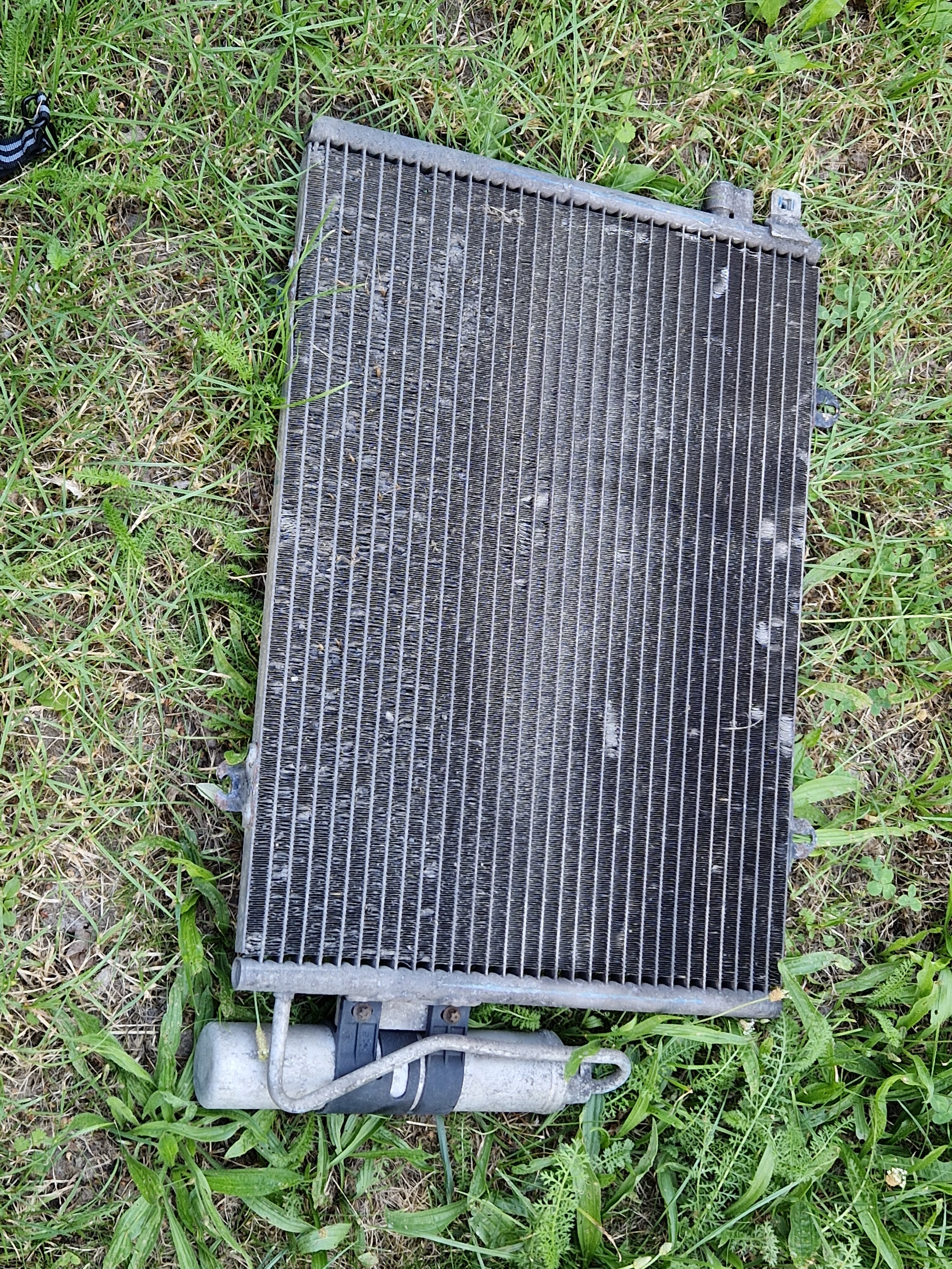

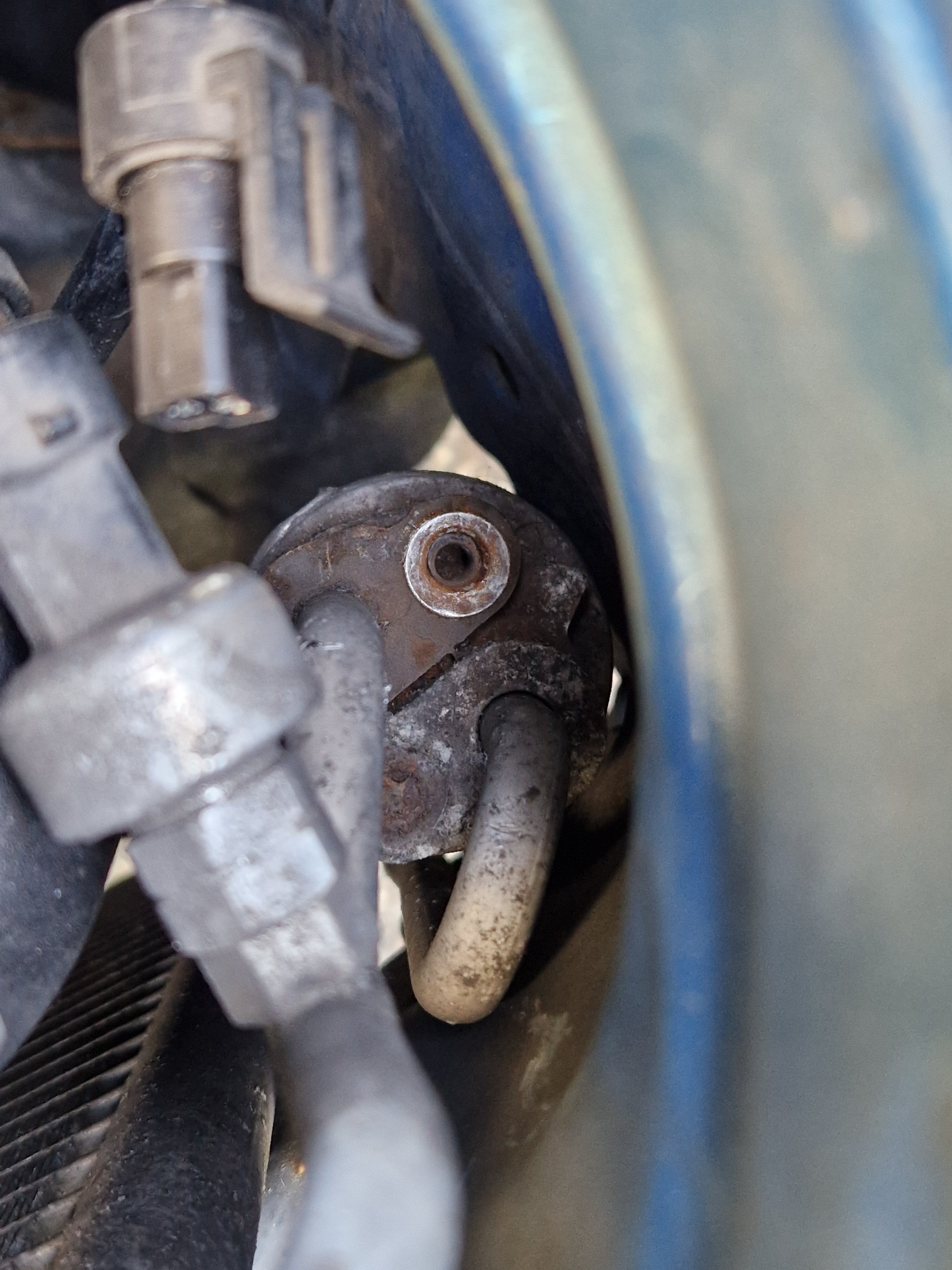

Well the good news is it's all back together. I filed away the evidence of me trying to remove the metal ring with rusty pliers and stuck some o-rings on there, coated in a bit of PAG46 oil. Also replaced the compressor seals while I was there, which were actually still attached which made a nice change. All lubed up and reinstalled.

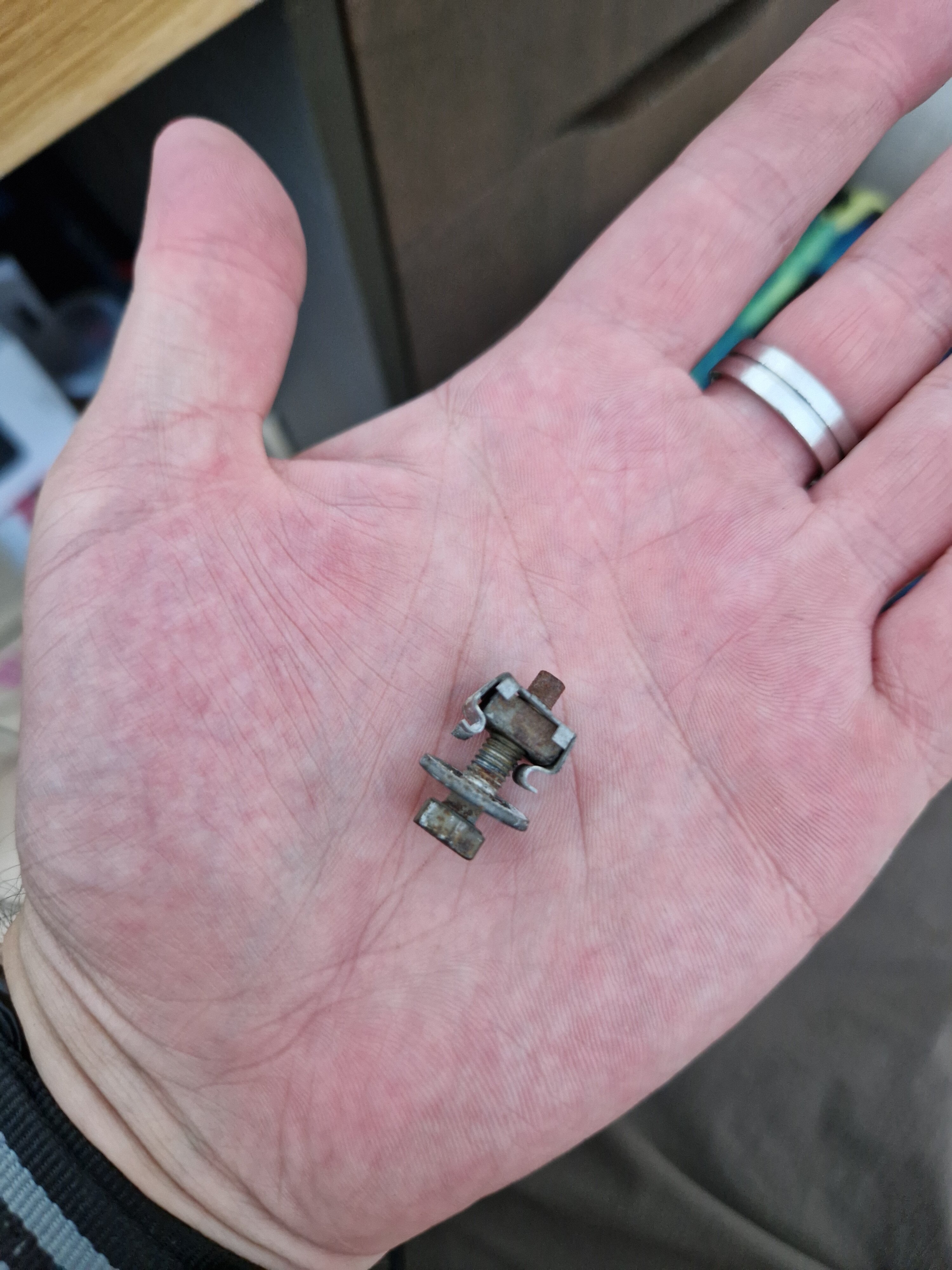

The only casualty was this bolt which fell out when I was loosening one of the bottom brackets, as the radiator had turned to dust at that point. Ah well, 3 bolts is better than none 🤷🏻

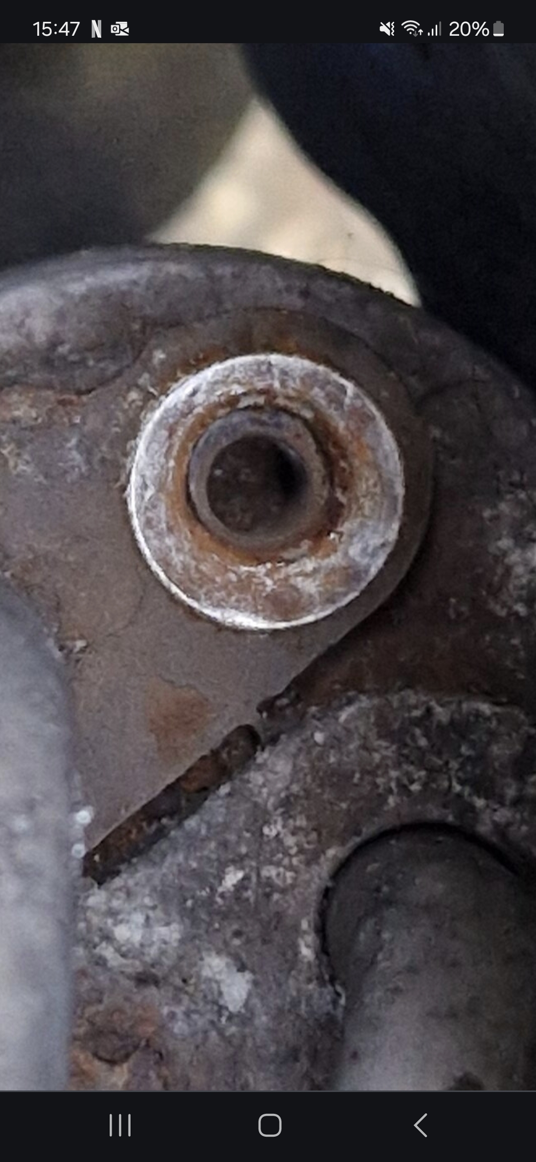

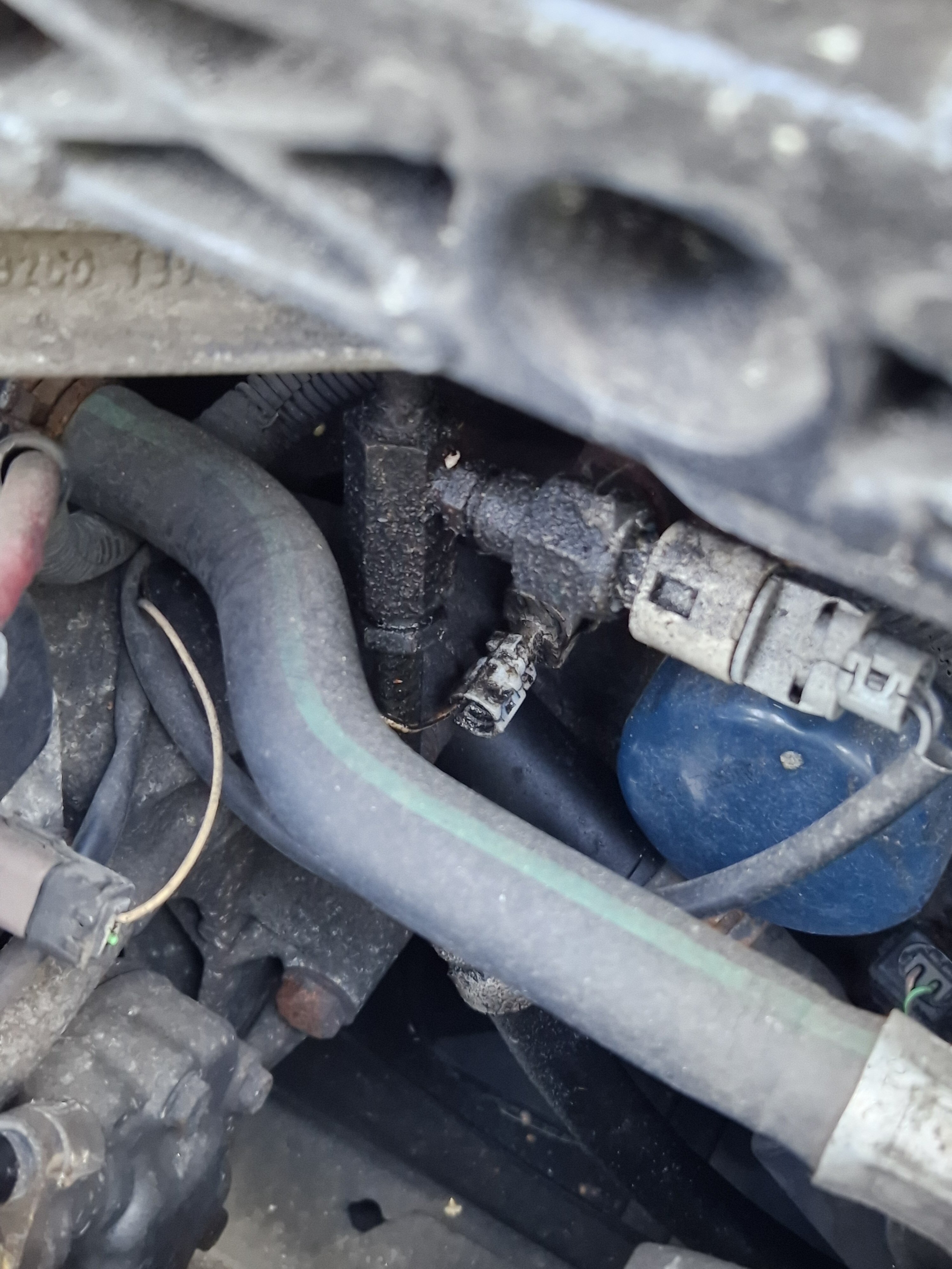

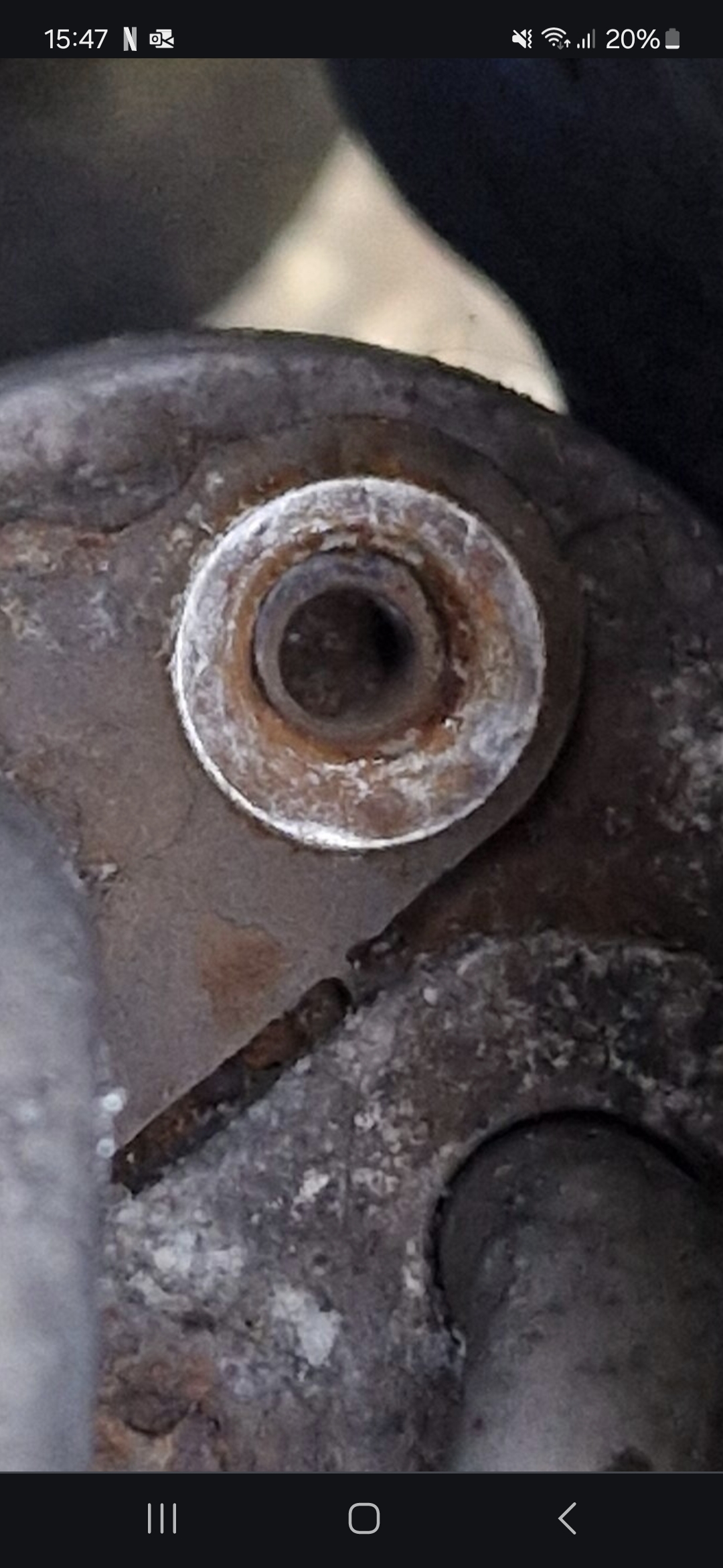

Also found what I think is the cause of my oil leak, or at least one of my oil leaks 🙃 (what is this by the way?)
