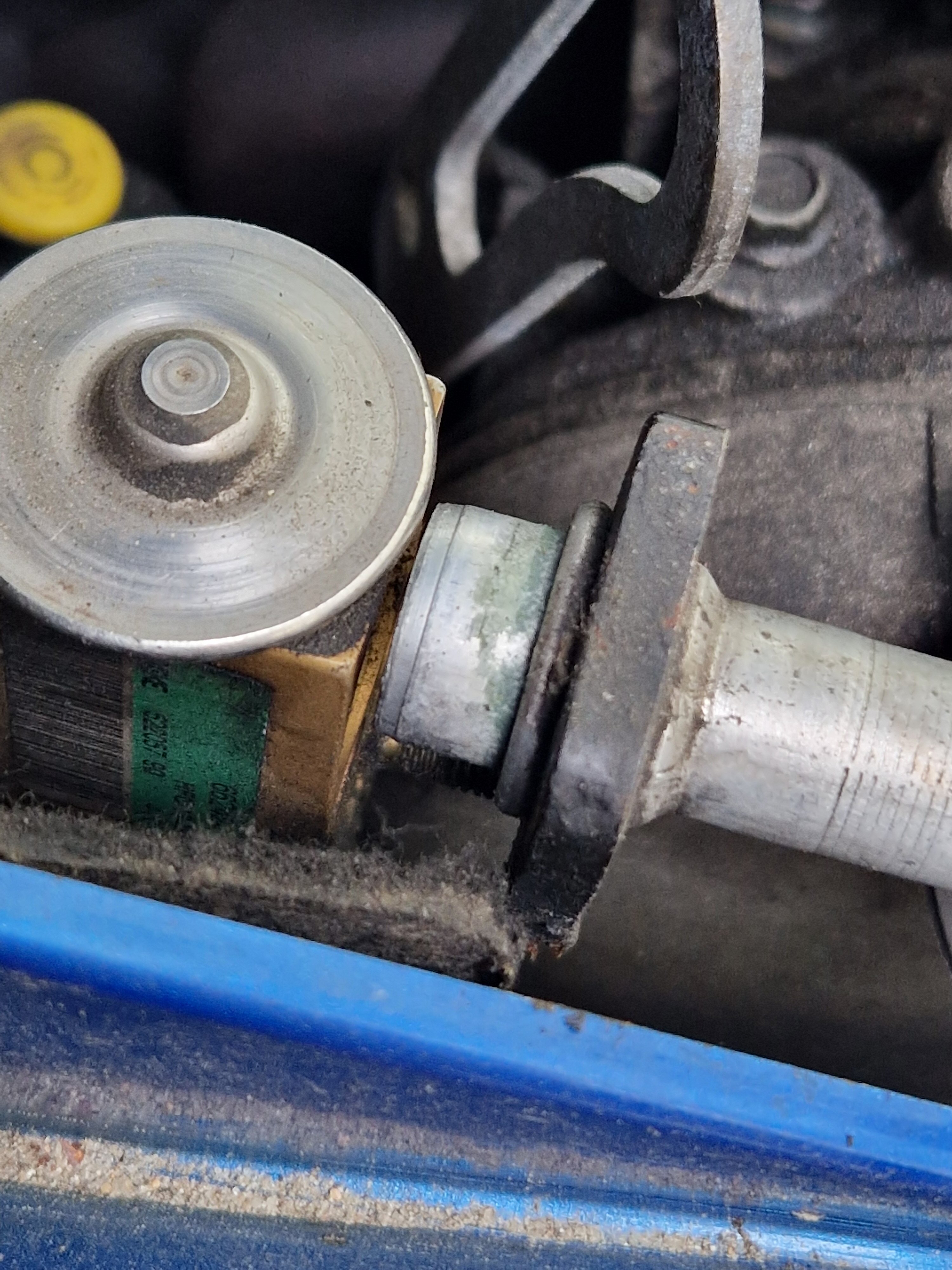

That'd probably do it, big pipe into the bulkhead with no seal. Is it supposed to be an O ring or one of the bigger seals like on the compressor?

Well I fitted an o ring and it seems to have done the job because my system is now full of refrigerant. Unfortunately no cold air is coming out 🙄
Maybe Clios just aren't supposed to have aircon after all 🤣
