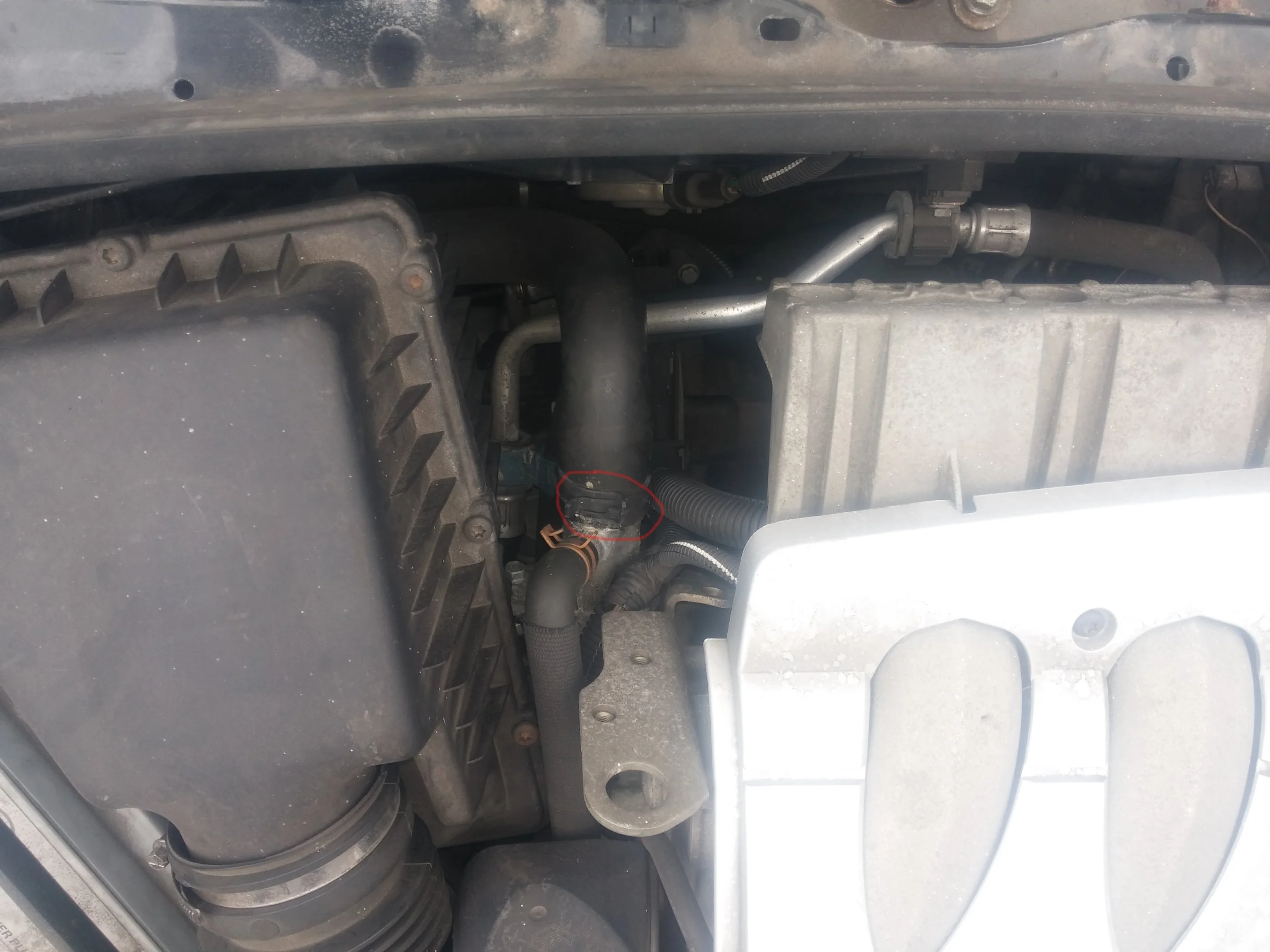

Here's a few issues I found when re fitting the pipe.

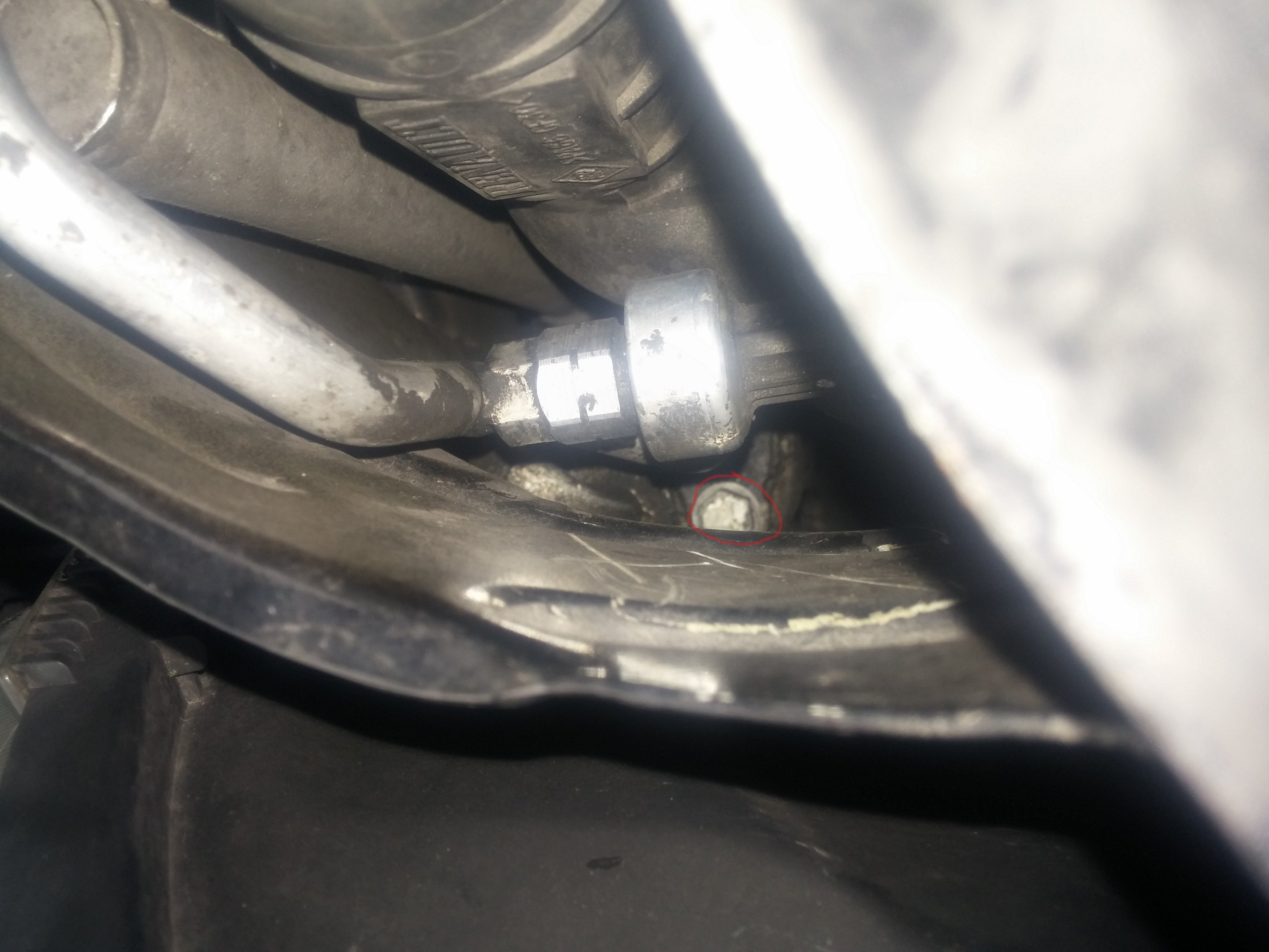

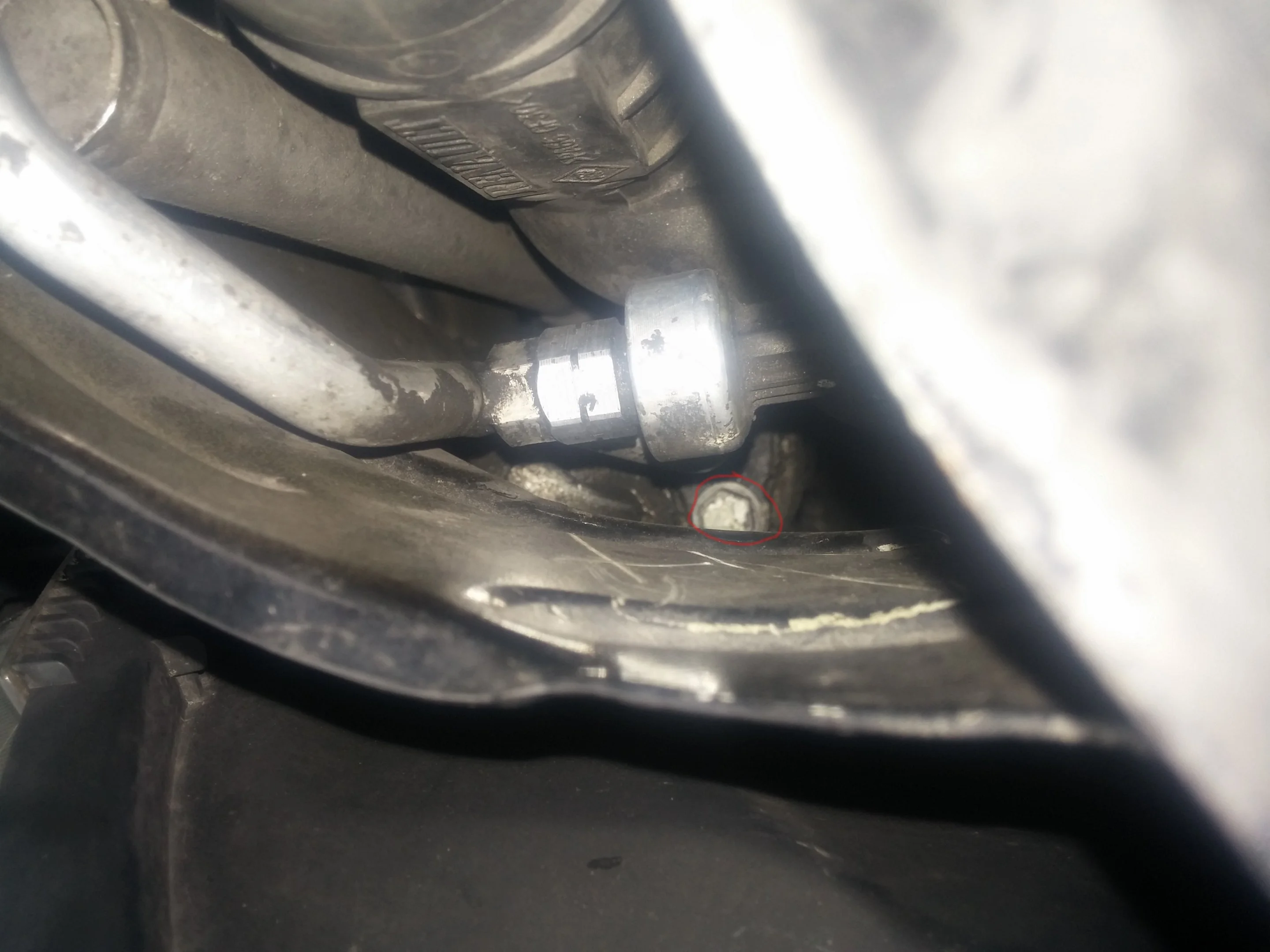

1. Bolt on re fitting just spins ie doesn't seem to completely tighten down, this is the bolt into the dryer from the high pressure pipe that I fitted.

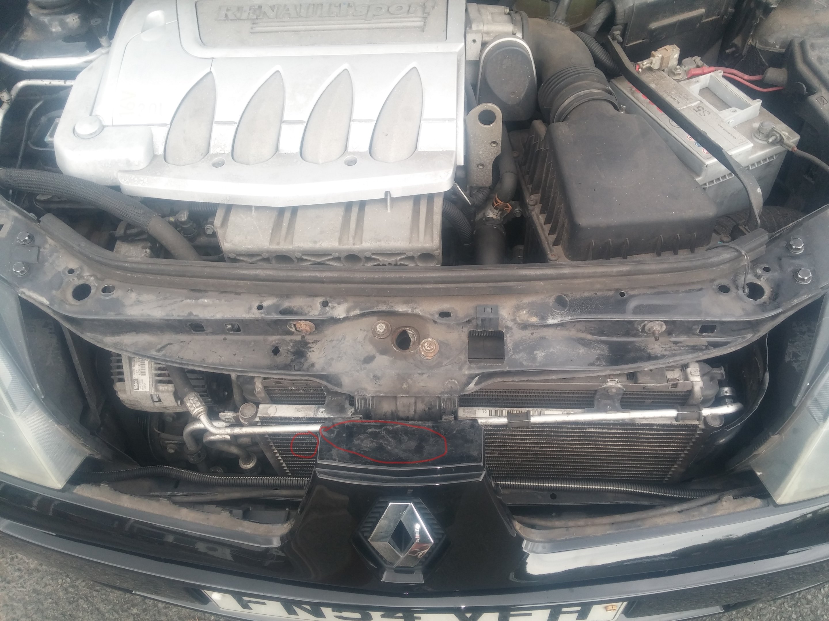

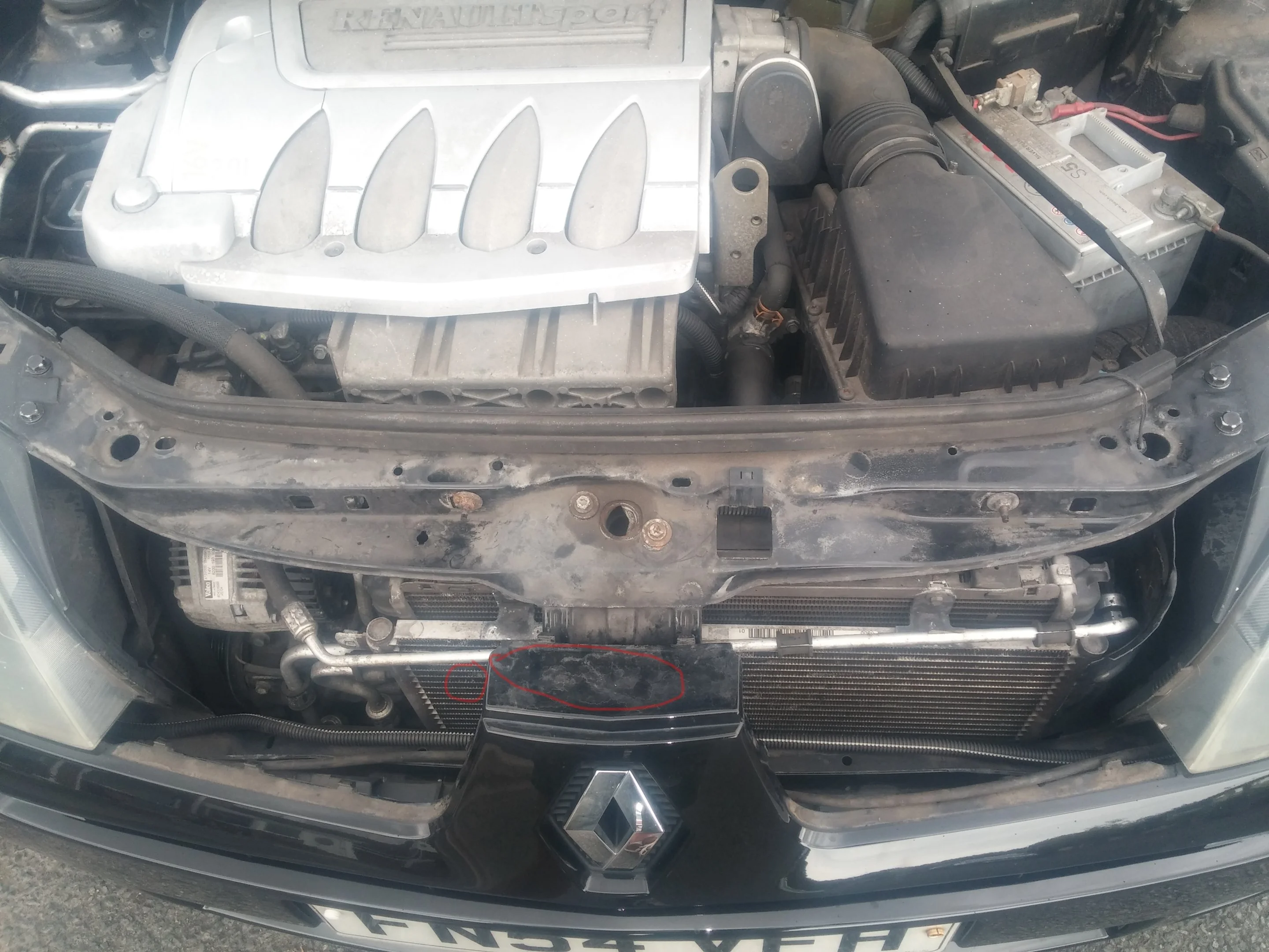

2. I did slightly bend the fins on fitting the pipe but not too drastic I didn't think

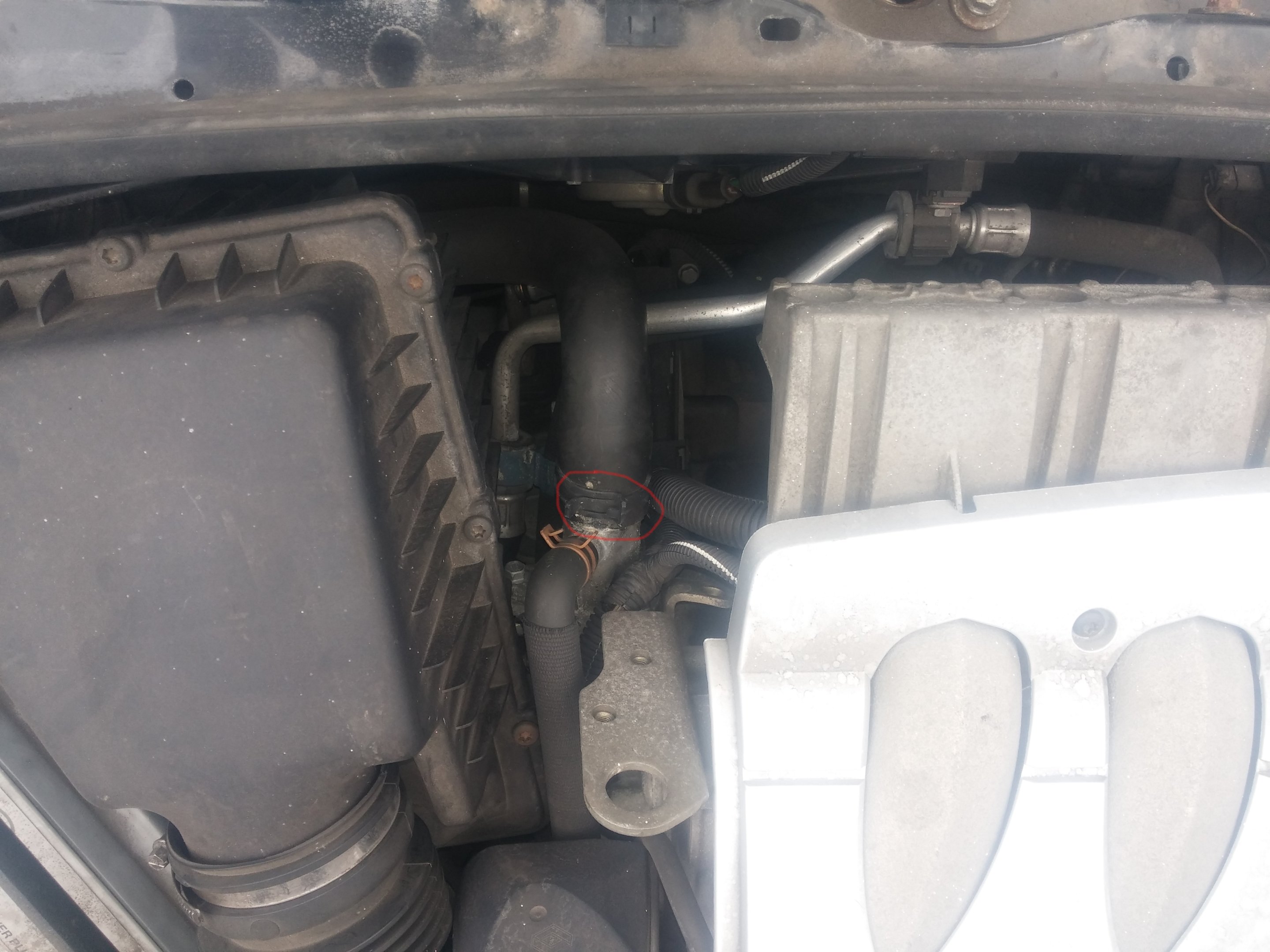

3. I also noticed a slight wetness behind this hose.
Any ideas? very cheesed off seeing as it's the second time it's failed the re gas although I half expected it the first time round - tried to JB weld a pinhole!
I like my A/C hence trying to sort it!
Cheers.
A condenser is not £400! Go to a proper place / air con man, not ATS. As for not knowing where it's leaking, they can put a dye in it & see where it leaks from.

You can get a new one for £50 although not obviously the Valeo one, that's over £100 I've done some digging If it turn out to be that that's shot.
£400 ATS! hahaha, jokers.
I've heard it's pretty easy to fit too although it's bumper off job.

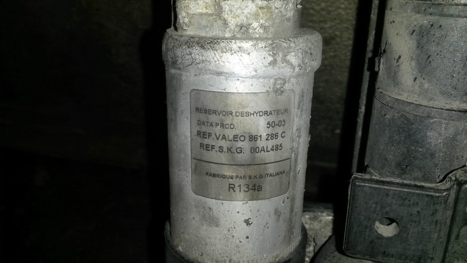

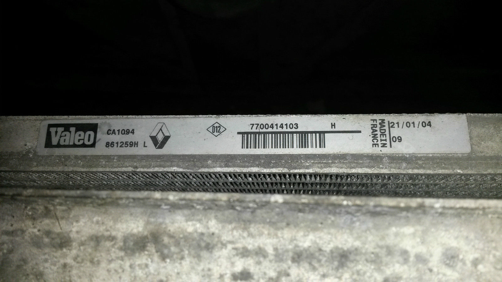

Here is the OE part numbers and Valeo ones to help.
There is also a seal kit that you can buy to replace all the O-RIngs (Picture number 3)
