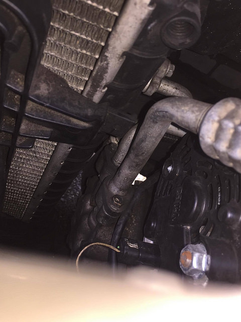

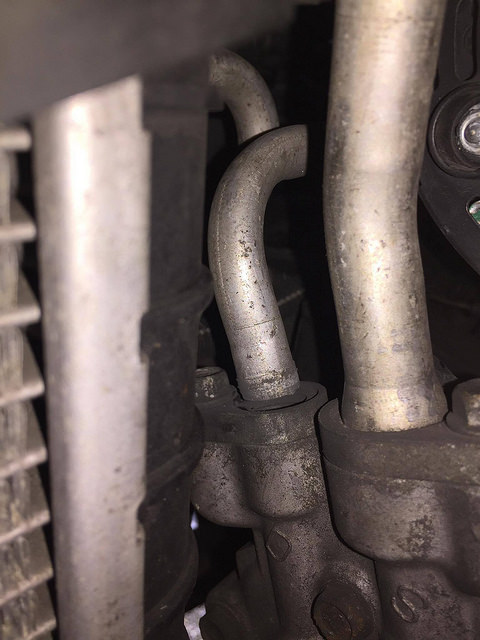

My air con hasn't worked since I got the car, and when it went in for some work at a specialist at the start of the year he mentioned one of the air con pipes being snapped. Thought I'd look into it at some later date, had bigger fish to fry with the car at that point.
A few months back I went to investigate and found the problem (see below pics). Obvious enough what the problem is there, so it's one of the pipes either into or out of the pump (I have no idea what is what with air con systems). When it was at @bloke's place a couple of weeks ago he had a brief look at it and said he thought it was a short one from memory (again, I have no idea, so if anyone can confirm this that'd be ace).
BG 182
by Niall97, on Flickr
The furthest one away of the two in this pic, just included this to give an idea of where it is (see the alternator on the right and radiator infront).
BG 182
Basically just need to know what I need to sort this. Assuming it's just a case of getting that pipe and then re-gassing? I've really missed the air con in this weather, about time I get it sorted.

Small pipe is the high pressure pipe. Larger bore pipe is low pressure. That's as much as I can tell you though mate, so not sure if that's any use?
Cheers mate, I think it may just be a case of buying all of them when some come up anyway really since they're always sold as a complete set of pipes, so I've pretty much answered my own question there haha!
