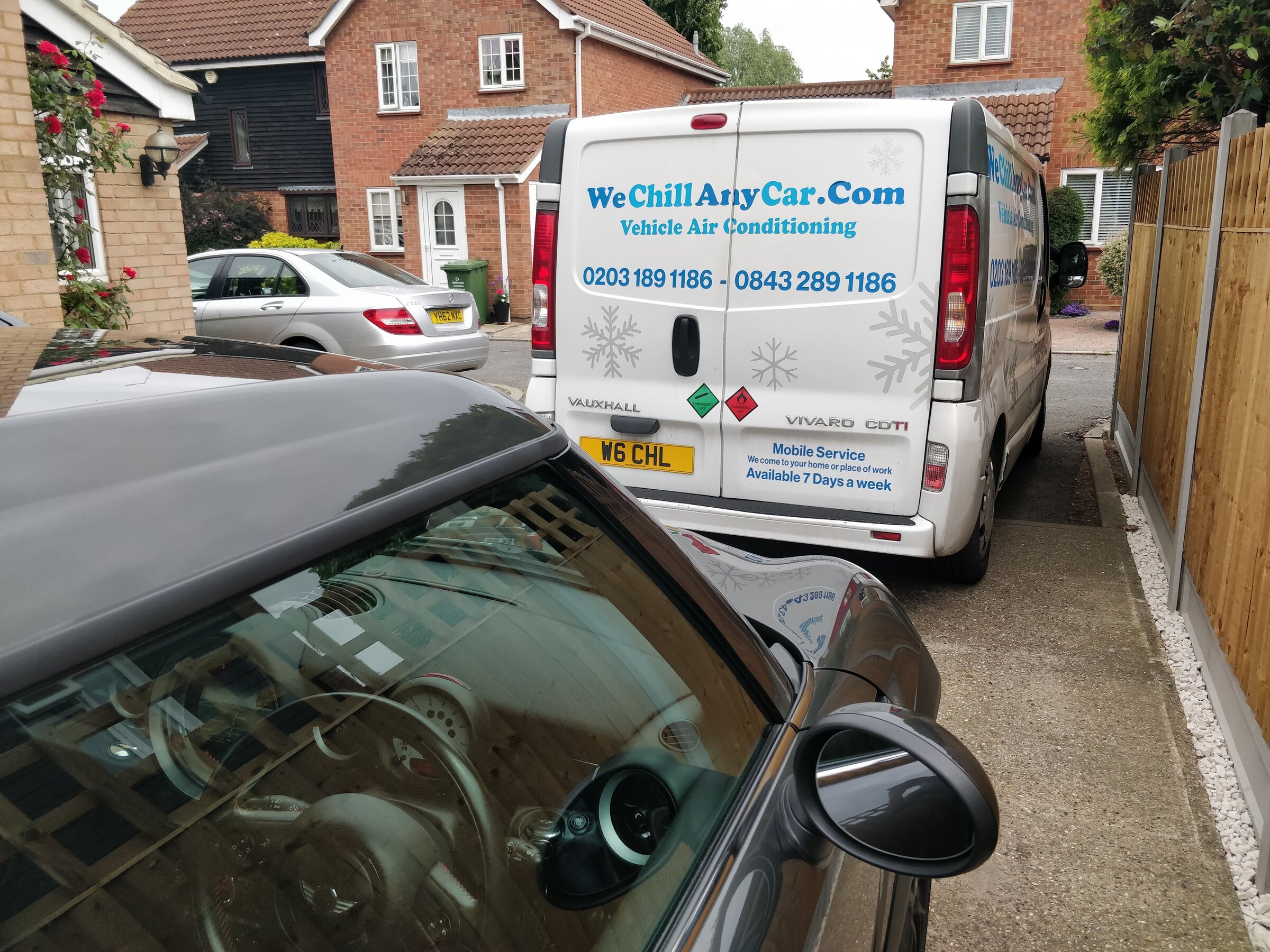

Plenty of companies that come to you to test/fill/repair systems.
For the sake of the £50 they charge to do it, it's not even worth worrying about trying to regas it yourself.
These guys did mine last year..
Used to design full aftermarket systems, before it was mainstream in everyday days - now mostly just do this stuff.
