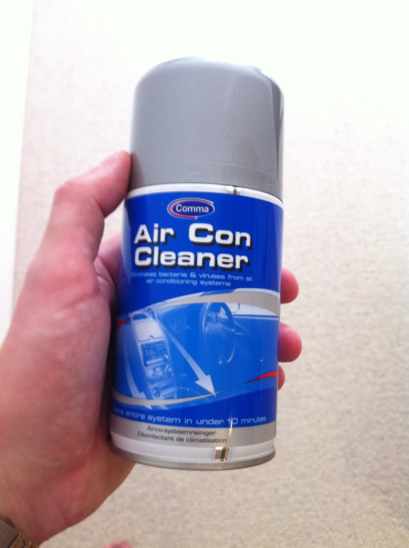

Popped down to halfords and picked some of this up..
Air con on full blast with re-circ on. Can empties it's contents in about 6mins and I left it all on/running with all doors shut for a further 10mins.
Seems to have done the job for now. I'll post back in a few days to update if it's long lasting or not.
That's the jobby. The aircon system gets moisture, which then harbours bacteria. That's what causes the odour. A bit like smelly shoes/feet.
