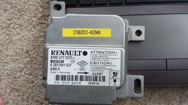

The drivers seatbelt anchor was lower and the CLIP diagnositics ran showed that I will need a new airbag computer as the code could not be removed/reset by the CLIP
Does anyone know where I could get a new one if I have the part code (0 285 001 537) ?
Thanks again guys
They catch loads of people out mate as they don't go with a bang, more like a "pop".
There are people on eBay that can remove the crash data for you for around £25 or you can use a non-crashed computer from another RS which may need CLIP to setup if the configs are slightly different.
Mick
I have one, £25 shipped.

Yeah I hear that - Guess clipping a traffic island was much more costly than I realised!
Okay my plan was to source one on here and then take it back to the guy near me with the CLIP to make sure it all works and the lights all go out.
