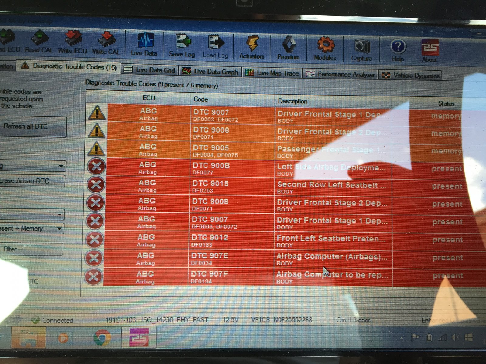

ive been trying to turn of my airbags with a rstuner but having a right ol time of it.
There's two faults I the car at he moment with the airbag computer but I don't know what they mean, does anyone know whether these two faults "dtc 907" might be having something to do with my problems??
See the photo for the example
Cheers for any help
Ps the problem I'm having is can't delete faults or update which sensors are disabled

New airbag ecu time imo as i bet its locked (ecu senses a crash has happend)
Depends you need to match up the numbers post up a pic of air bag ecu ill ask my mate that strips them if he has one that matchs up
Thanks I'll try get one tomorrow, all I can get is this at the moment as I put it back together earlier.
I'm I being dumb or are all phase 2 172 the same??
Ok got an update from Henk at rstuner.
He says that even if the ecu was replaced I will not be able to turn off the light.
From what he says all sensors must have no faults for me to be able to disable the airbags via rstuner. Ie all the hardware must be installed to disable air bags. Seeing that I've thrown away or sold everything does that mean I'm stuffed??

Thats bulls mate as i used rs tuner when my seats where unpluged.
Just what I thought??? Only reason I went for a RStuner is cos I'm a lazy bugger and couldn't be bother to fit resistors or take the bulb out.
On that note has anyone ever just removed the LED? Might be my only option at the moment

SORTED
Got a new air bag ecu of eBay for £15. Plugged in the rstuner and fixed within a minute.
So boll*cks to not being able to remove warnings if the seat/wheel are already removed. I've still got two warnings which I can't remove but there not present so the airbag light goes out as it should.

It's the oposite. If you program the ECU to not have airbags and they're still plugged in you'll get an error.
Yup first time I disengaged all of them and it had a right paddy. I've disengaged only those missing now but there are two code which won't delete from history. Doesn't bother me really now the lights off. Plus I've locked any existing bags just incase I get over ambitious next weekend lol
