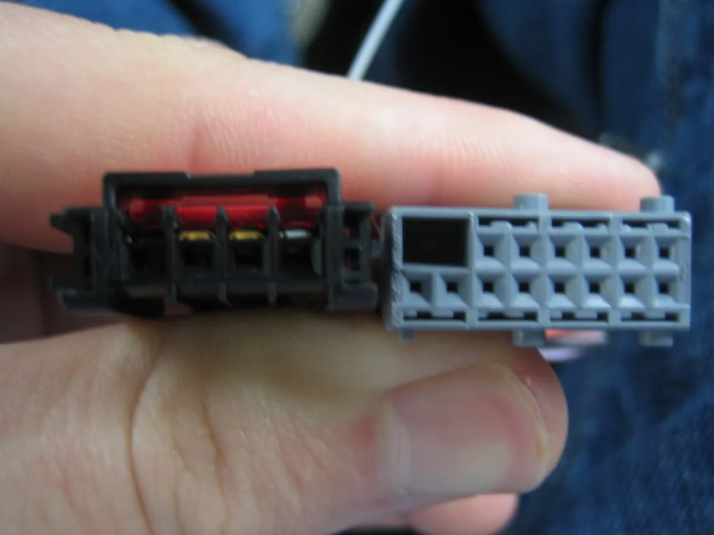

I've got buckets and harnesses in my 182 cup (so no side airbags) and as a result have binned the original seatbelt mounts. I've got 3.3ohm resistors, but I'm still not 100% sure where they need to be connected. It looks like f0xy used to have pics up of where the connections need to be made, but unfortunately they're gone now.
This is what I have left under each seat:
Can anyone tell me where the resistors need to go? Also will I need to disconnect the battery for a while to reset the ecu to clear the faults and the dash warning lights once they're connected?

If you cut line no.7 on the ecu module it will turn the lights off the dash, 2 min job ;), line no.7 is just the negative feeds to the serv & air bag light, worked a treat for my PH1 track ****.. although i am assuming the PH1 & PH2 use the same wiring for the 172/182
