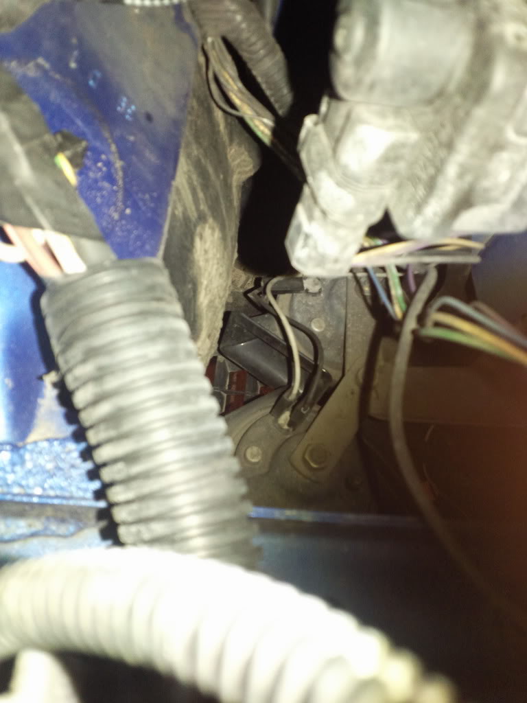

Has anyone got a pic of the acoustic valve fitted????
Unfortunatly there isn't one on here
I spent AGES looking for a pic of it fitted - as I bought one from cliospares then couldn't work out how to fit it LOL :(
Get some pics of your engine bay up and take a pic down below the passenger headlight - and then we can tell you whats missing :)

There ya go what it looks like.
