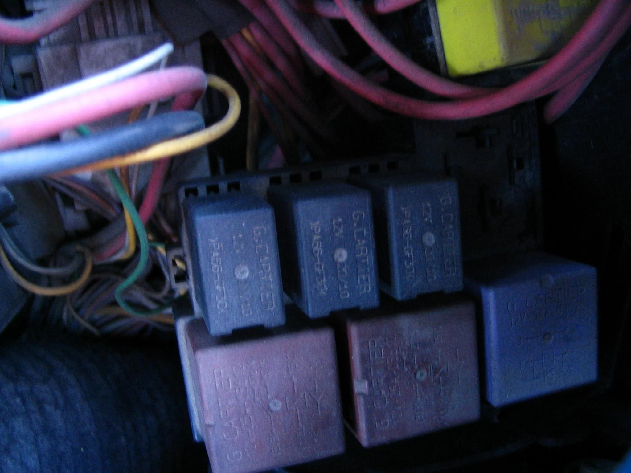

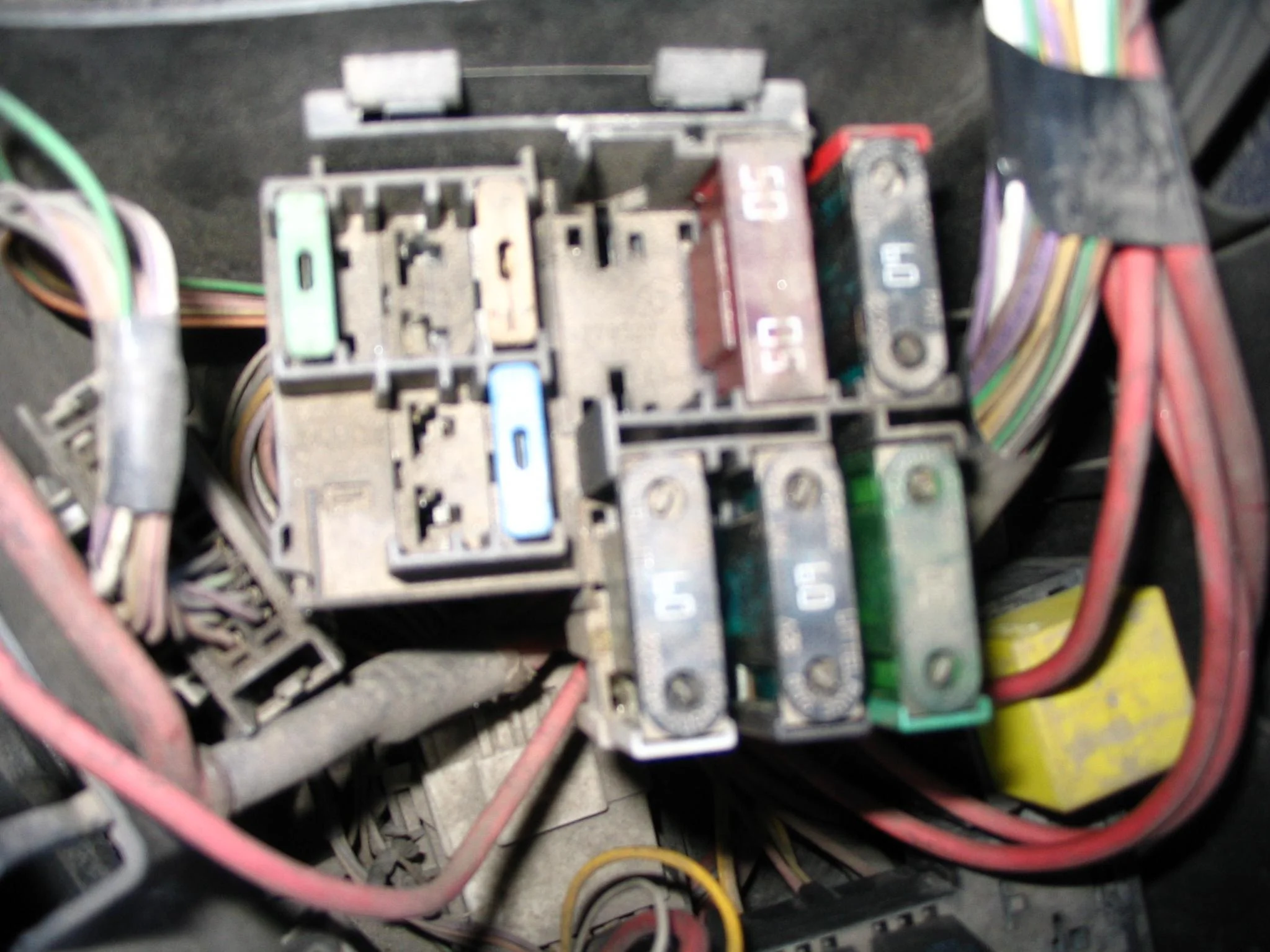

So how could a pushstart have messed up the aircon? Control panel display is lit and reacts to commands, resistor pack is brand new, motor is ok, fuses in the car are ok. Fuses and relays in the engine bay are not checked (dont know which ones are for the aircon and ventilation). So if u could tell me few things to check, just to narrow the search with my electrician tomorrow

That is great if so because the resistor is easiest to replace... I haven't checked the engine bay fuses and relays yet, because I don't know which ones are for the fan and air con.
