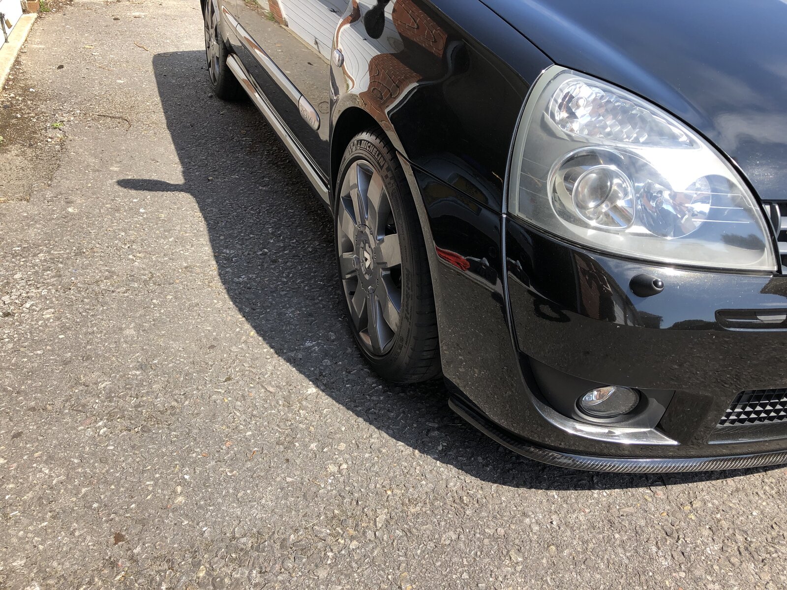

Had a spare day today and fitted 18 mm front hub centric spacers, arches filled better now,I have new rear Brembo discs and pads on order so will fit the rear stub axle spacer kit at the same time next weekend. Also fitted new positive battery terminal cover which was missing when I bought the car. Finally I gave the front grill a coat of C4 which looks much better but maybe a second coat would give a darker look.

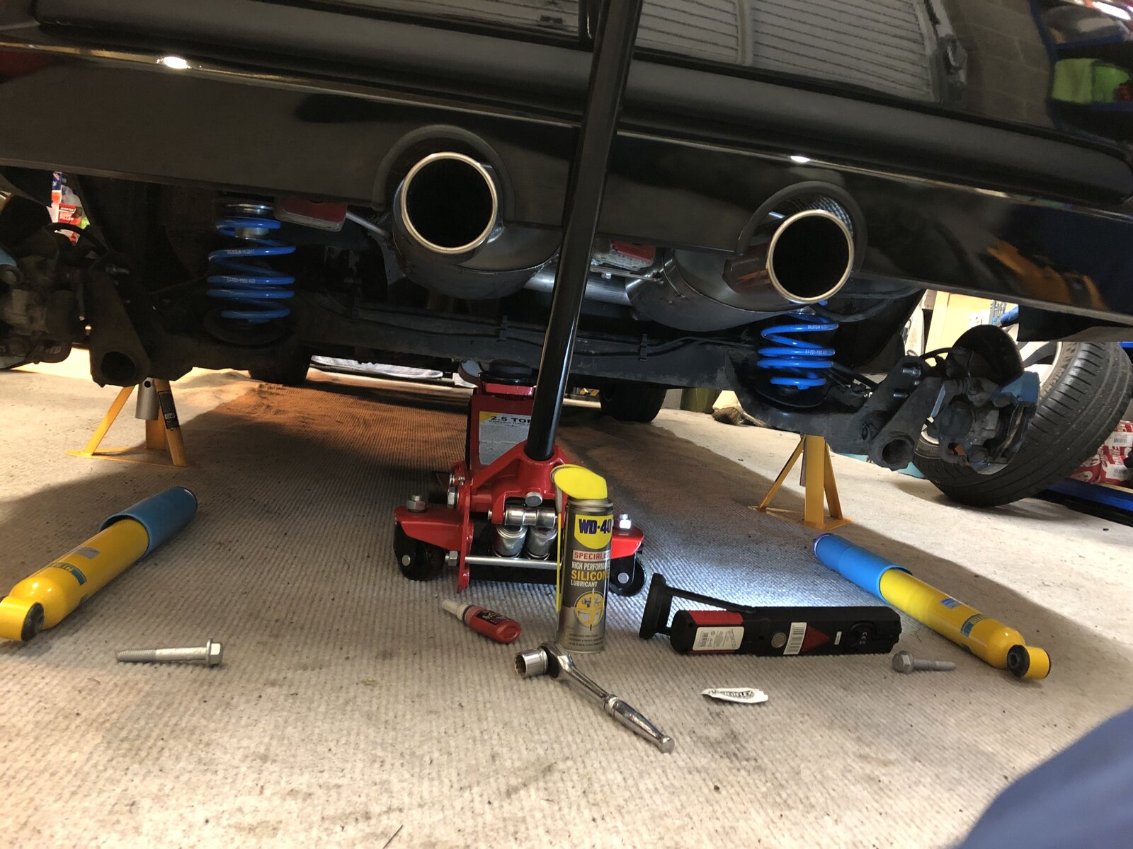

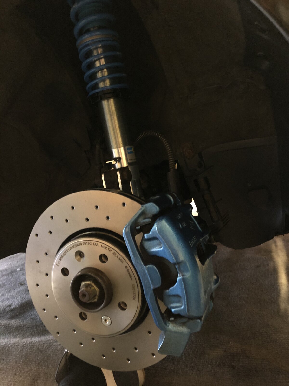

Found some time today to start fitting the new suspension parts I’ve bought over the past couple of months.
B14s rear done today with new bolts and Powerflex bushes.
Front shocks, bushes, new wishbones, track-rod ends, eibach camber bolts, HC discs, pads and a wheel refurb next.

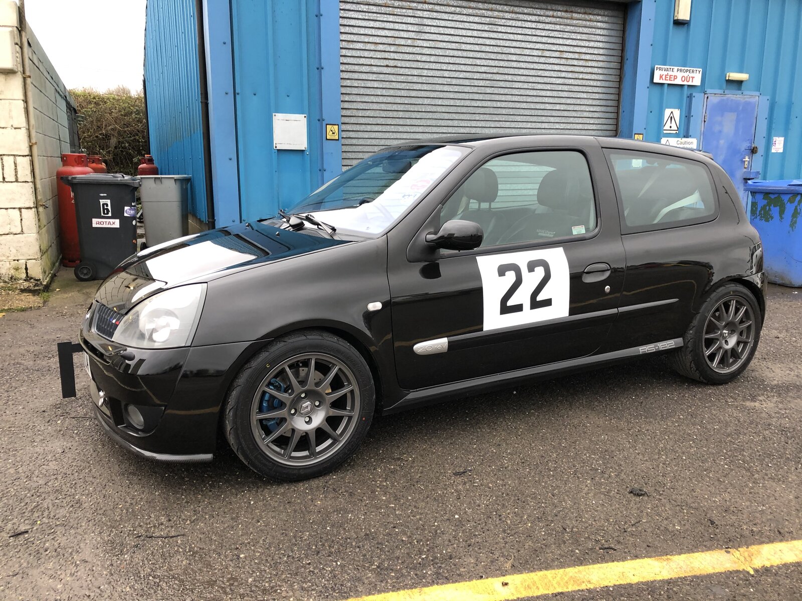

ajracer

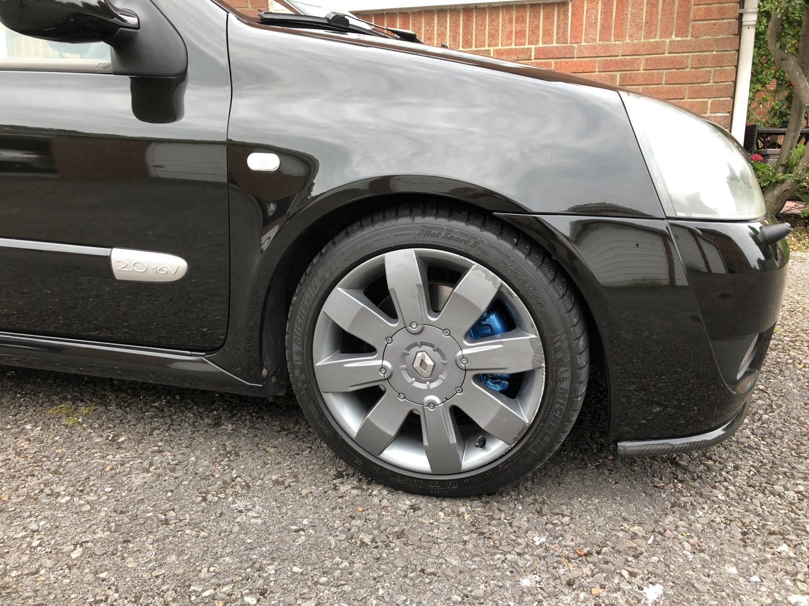

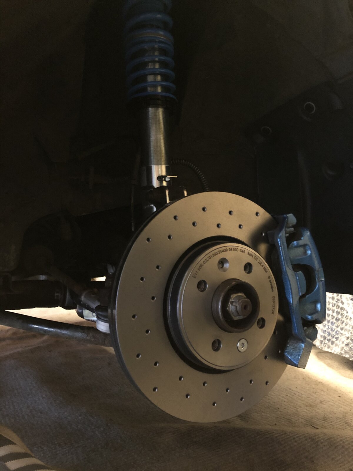

Us builder types get a couple of weeks off over Xmas so I got cracking on the front end refresh on Friday and with a full Hunter alignment booked for Monday 10am,simples!
What I thought would be a days work spread over the weekend tinkering with the old girl didn’t go quite as expected. Both disc retaining screws rounded off so I had to drill them out, track rod ends had to be cut off, lower wishbone pivot bolts and swivel totally seized which took 2 hours with penetrating spray, socket and hammer to free up(no wonder the car was firm over the bumps)!
Finished this afternoon and fitted the new front wheel arch liner and took her out for a shake down. I’m sure the camber and tracking is well out but wow what a difference the new parts and the Bilsteins make.
Well impressed with the refurbished wheels too!
The new year will see some attention to the front end paintwork , a set of wheels and tyres for competition use and maybe 438 cams/remap.
Loving this little car!

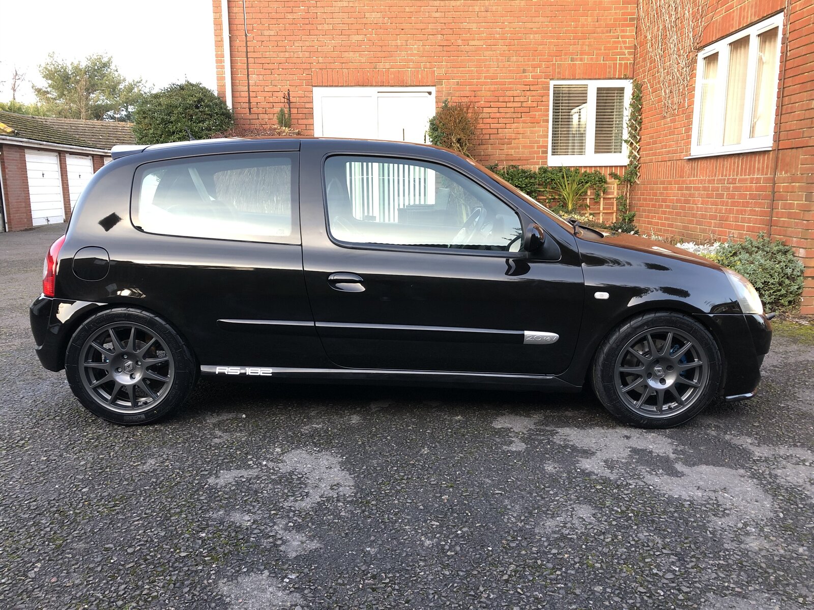

Turinis bought from a well known nice chap on the forum and today fitted with NS-2R rubber. I knew the offset on these wheels is greater and I also have 20mm stub shims.I was hoping to get away without rear arch rubbing.Wrong!
Need to lift the car by 10mm or so.
Love the look though.

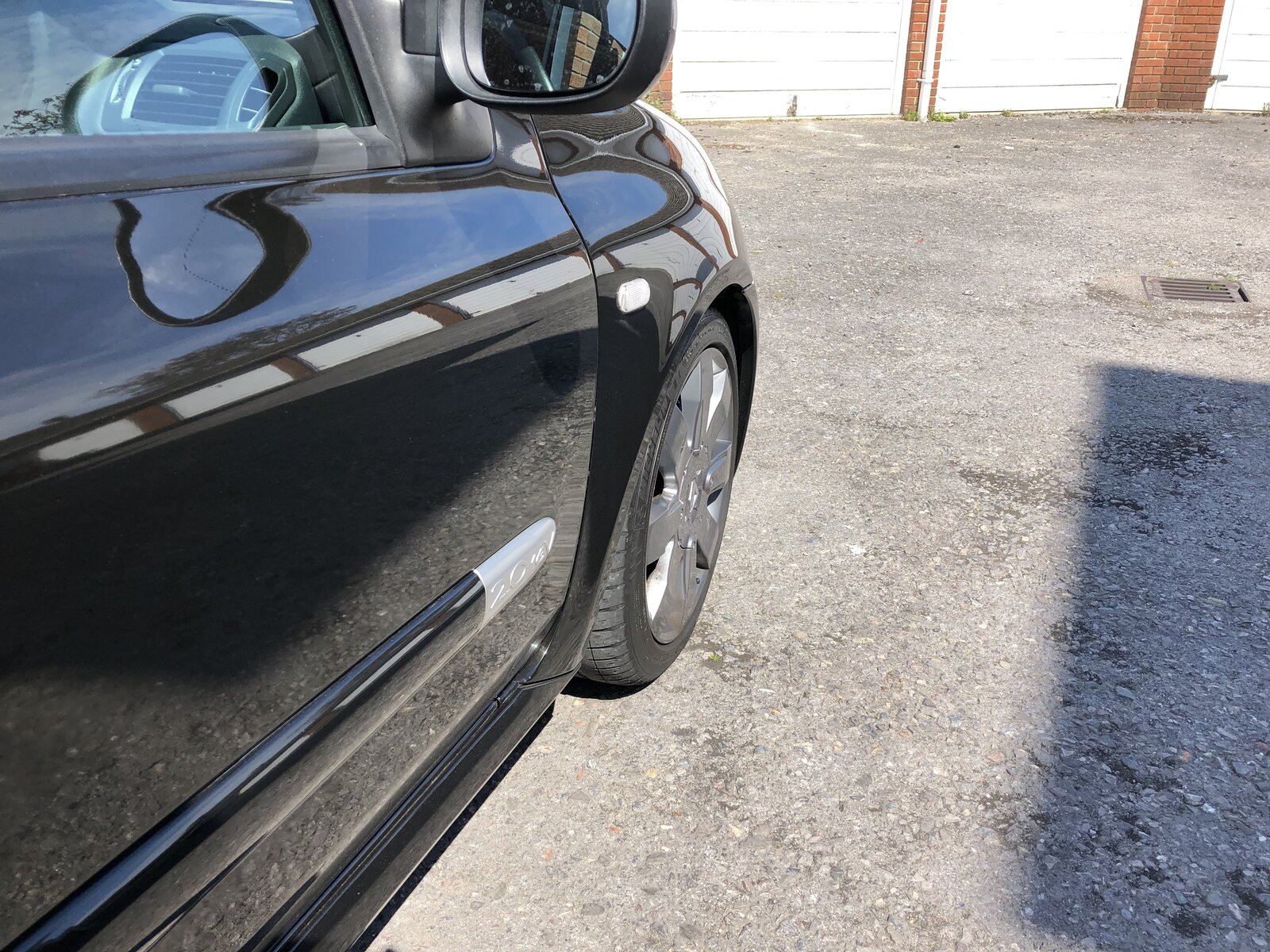

Thought the side decals would look better in anthracite.
She is booked in to have the bumper ,new bonnet and roof painted next week.
Also as a customer who owns a garage owed me a favour and remapped the ECU with Flashmap.
Definitely feels stronger at lower revs and pulls harder at the top end. Racing at Clay Pigeon on the 15th.

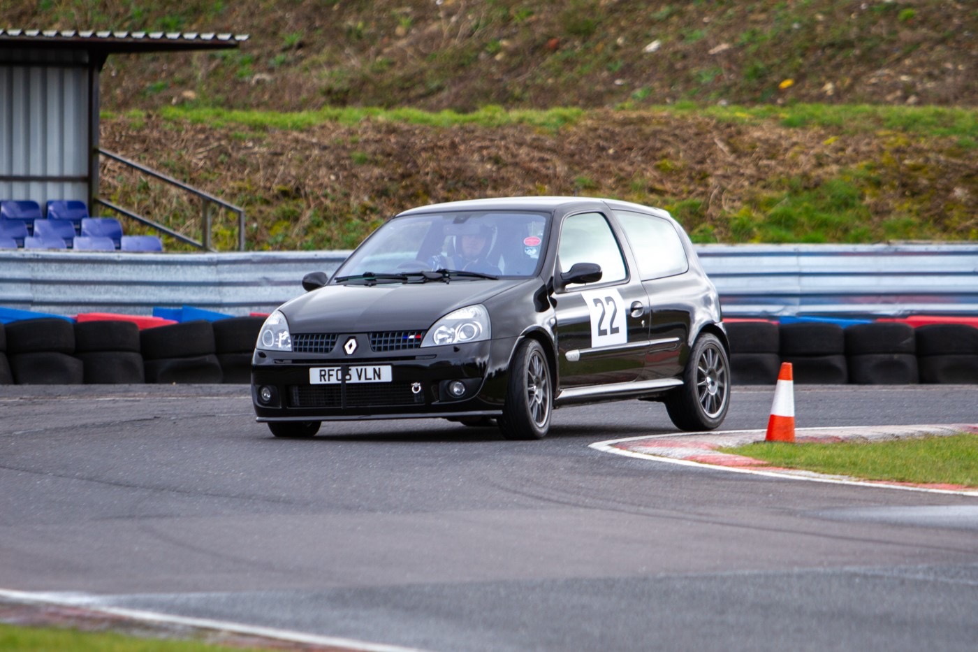

Paintwork to roof, bonnet and front bumper sorted and first sprint this season at Clay pigeon today. Pissed it down all day and was slippery as hell! Took this pic at 8.30am before the rain. After many years of competing in the the charged Zed it was the first time I’ve drifted a front drive car! Got to learn more how to get the best from this little car. Gurston Down test day in two weeks. Hope it still on and dry.
ajracer
Looks like I may be one of the few racers that have done an event this year! Not looking too good for some time.
My mate Matt look these pics which makes me look much faster considering how slippery the track was!

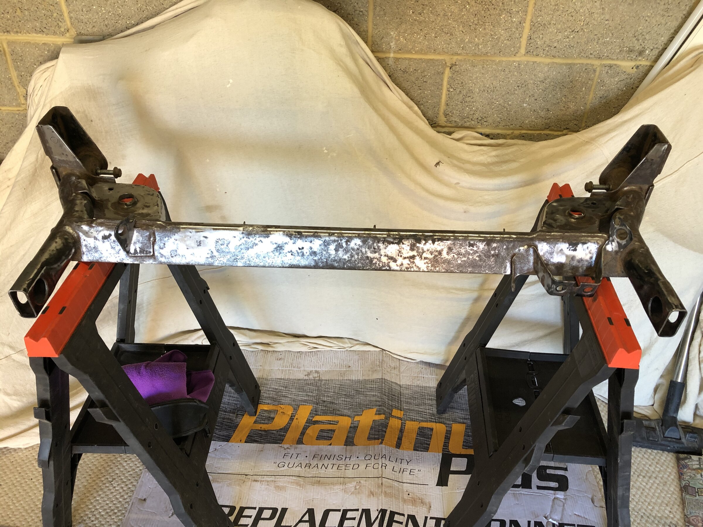

ajracer

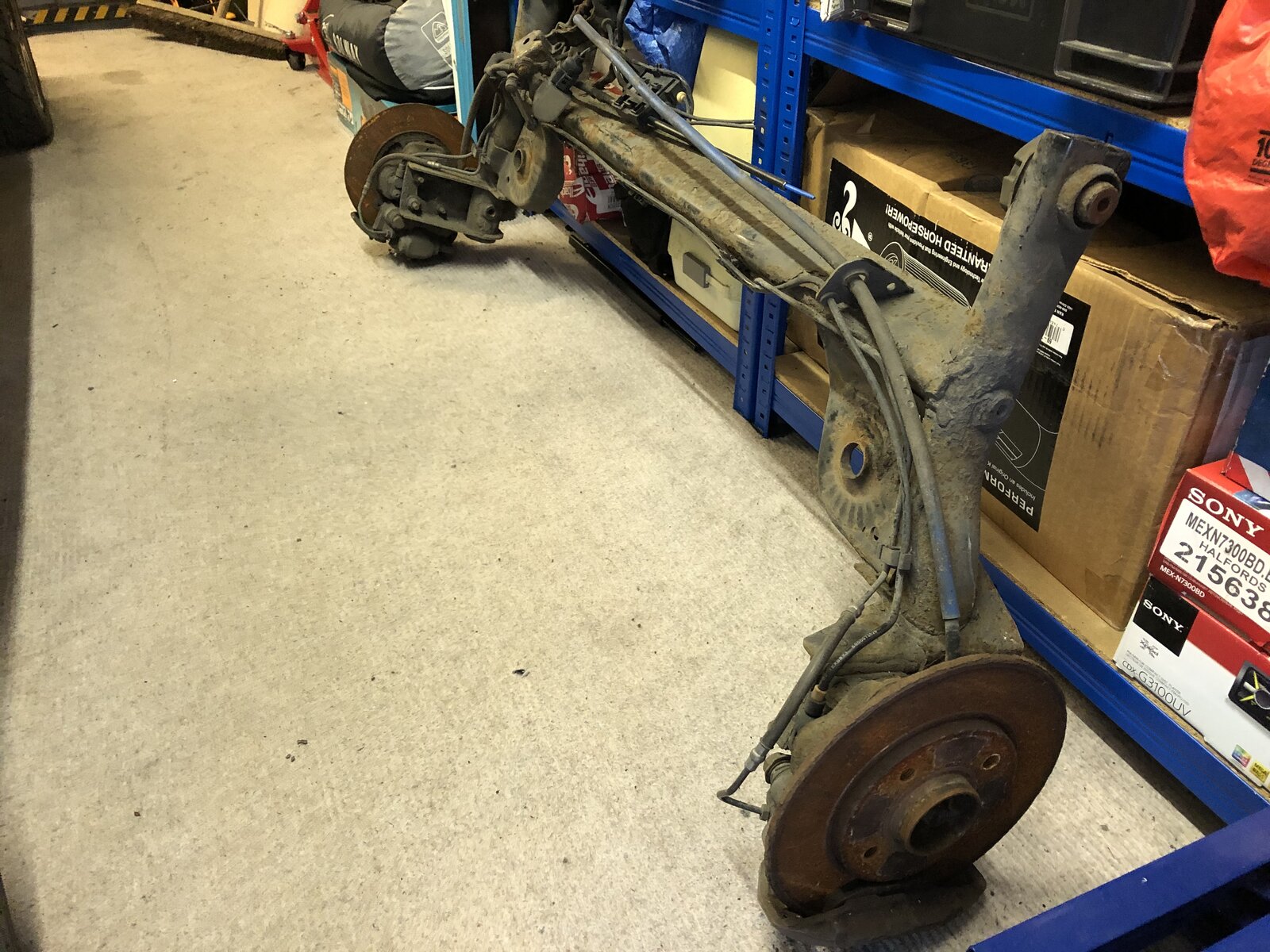

Due to lock down I’m bringing next winters project forward.
I’ve pretty much been through the whole car refreshing parts where necessary but the rear axle/beam is very corroded and I’ve no idea what condition the bushes are in so new powerflex ones were delivered today.
Many thanks to renparts for sending me this in 3 days! Busy weekend on the sandpaper!

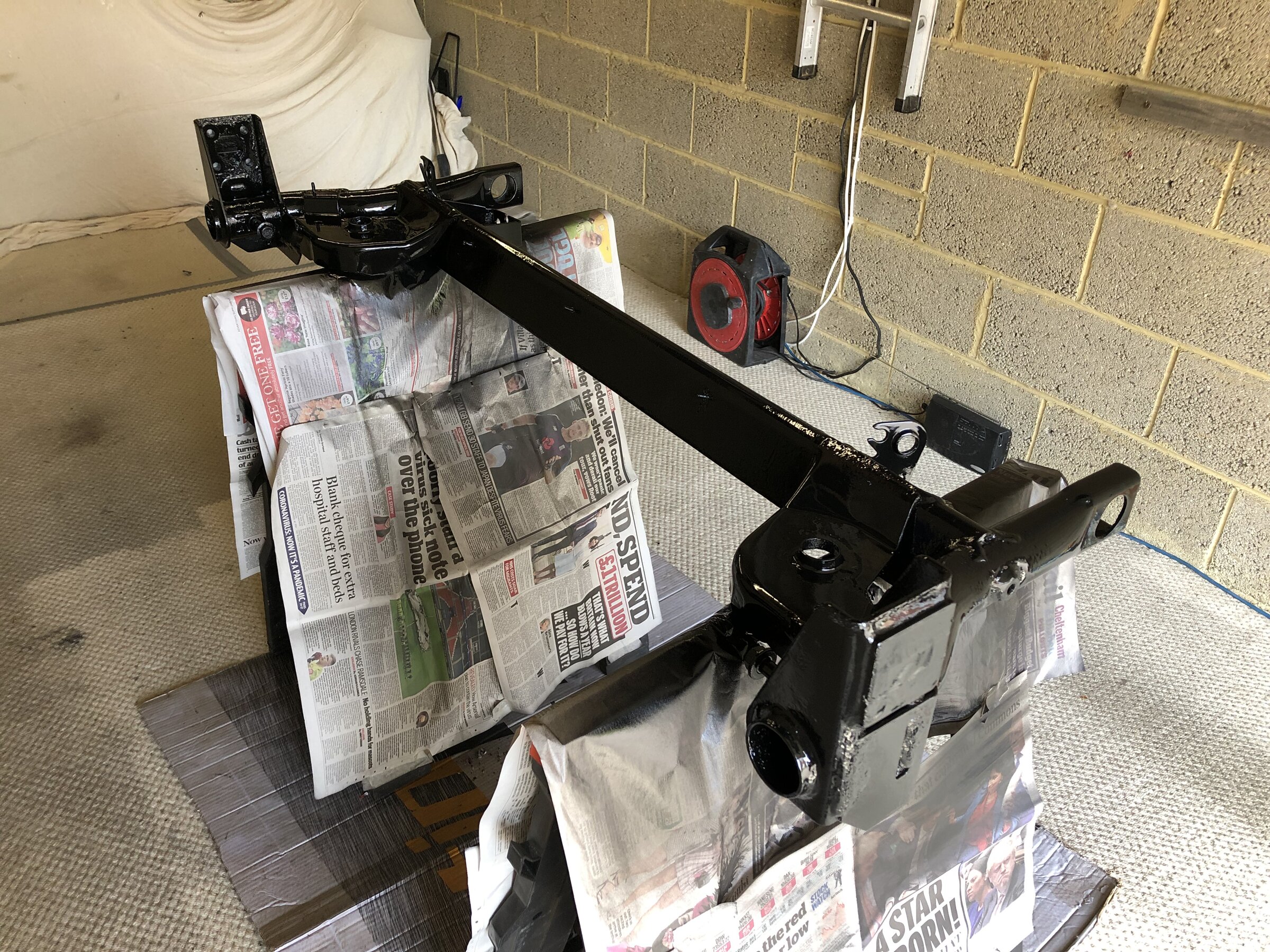

ajracer
I know I could have paid £200 for a professional to shot blast and powder coat it but as I have the time to cover myself in rusty dust and paint I hah a go myself. I was surprised as to how much of the horrendous looking corrosion was actually only surface rust. Still took a couple of afternoons and several Halfords sanding wheels and emery discs to complete.
Three coats of hammerite later it looks ok.
I already have powerflex bushes and spring pads but am struggling to get the solid brake pipes and the rear beam bolts from Renault due to the lock down so fitting is on hold for now.

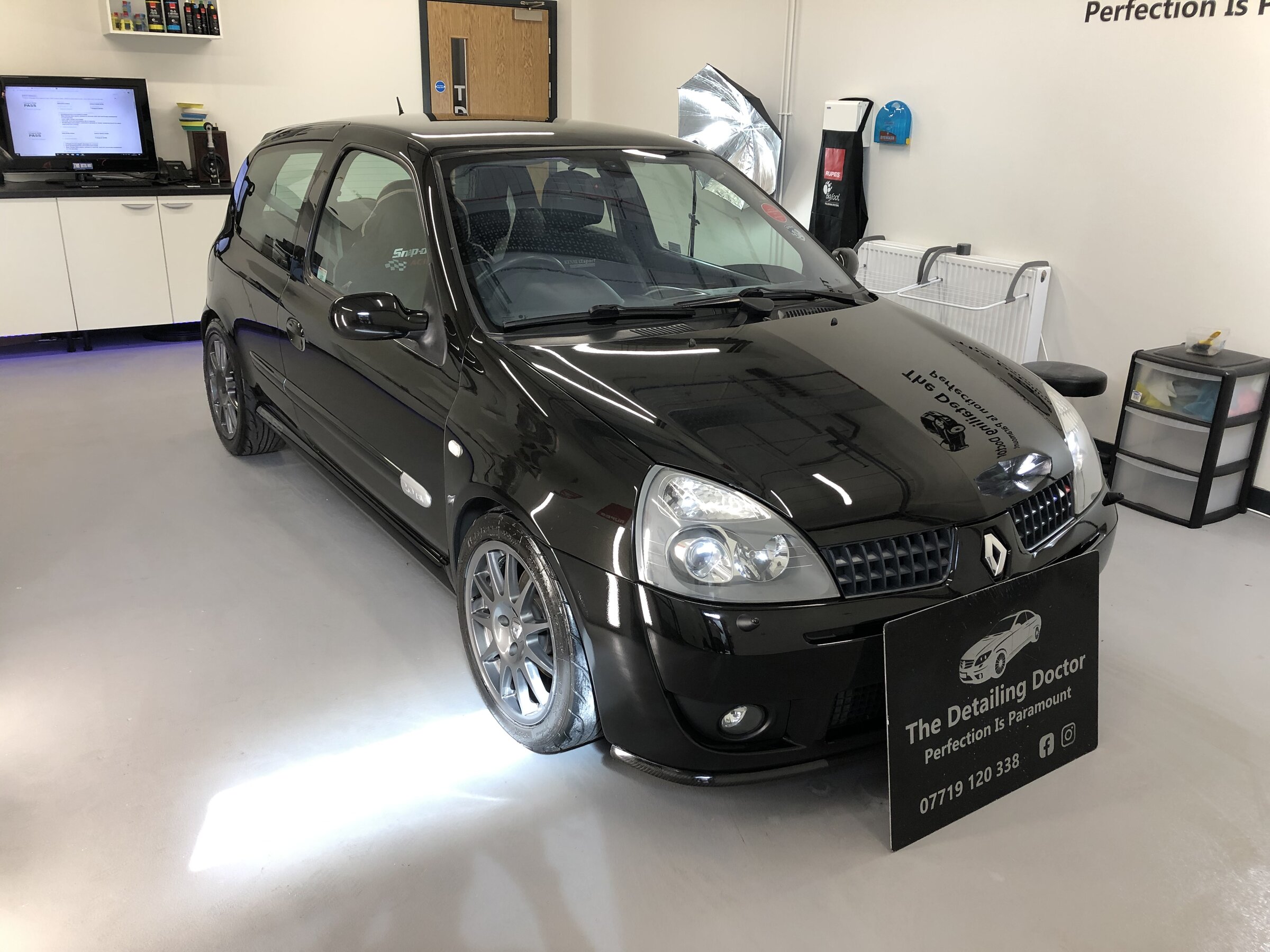

ajracer
Picked her up after work yesterday and was very impressed with the results. I took these pictures in the workshop with all the light coloured floors, walls and bright lights which any clean car would look good.
The sun went down about an hour ago so I reversed her out for a real world photo.
Cover on and see me ever driving the bloody car again as it looks so good. I need help as I bought this car to thrash to death on track!

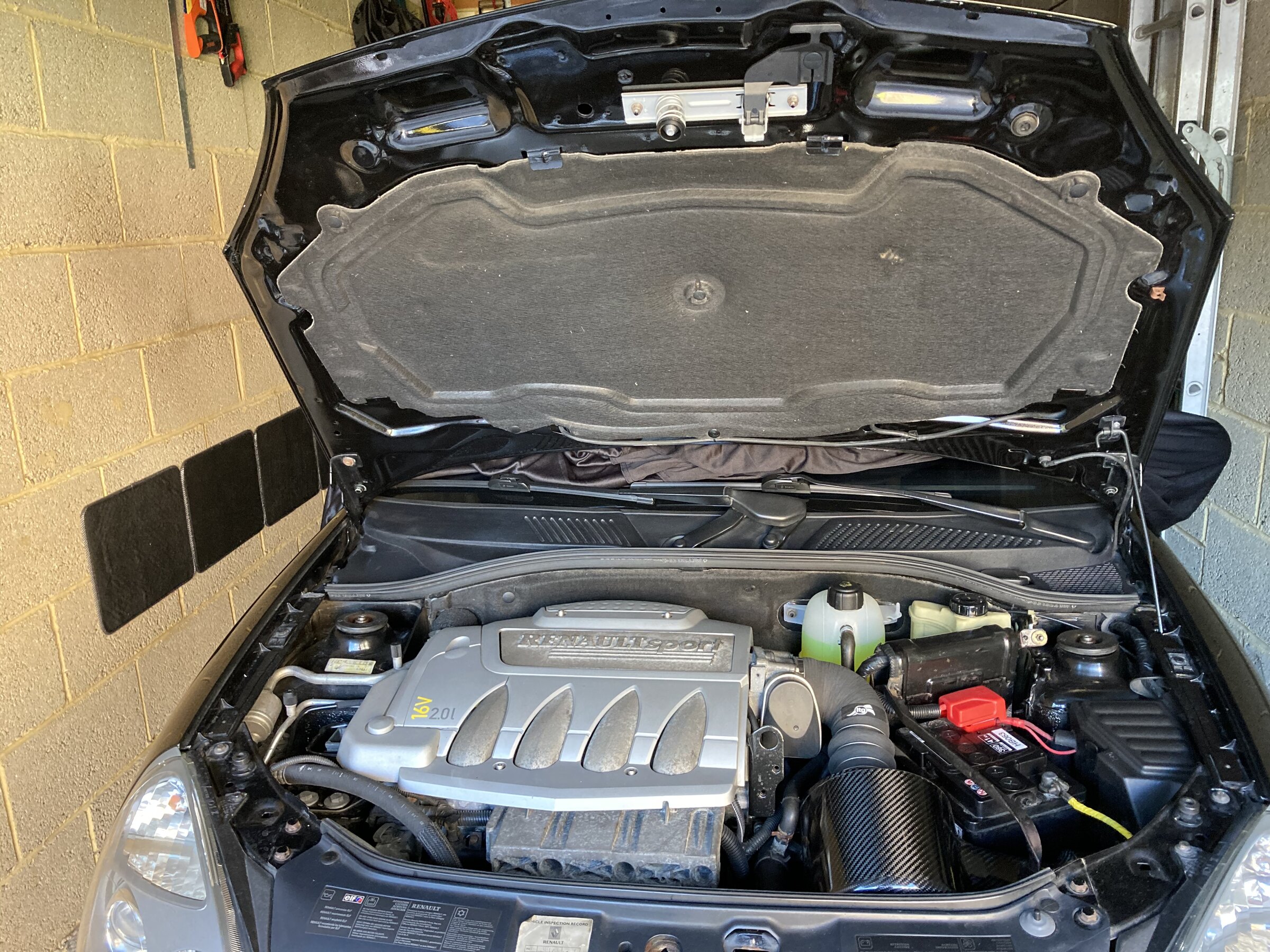

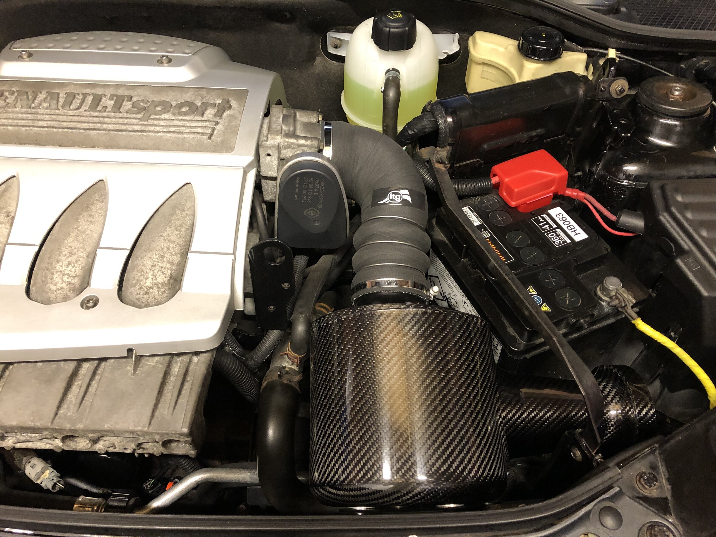

ajracer
After seeing Stefans stunning trophy fitted with the itg maxogen intake I could not resist!
It is by far the best looking induction kit available ,beautifully made and the online instructions are very clear including modifying and disconnecting the vacuum solenoid behind the front bumper.
Took her out for a blast today with my brother in the car and we both felt the motor feels so much more eager low down and also wants to keep on revving beyond 7k.
The induction noise is minimal at usual speeds but when you floor it there is a deep but subtle roar especially in the first two gears.

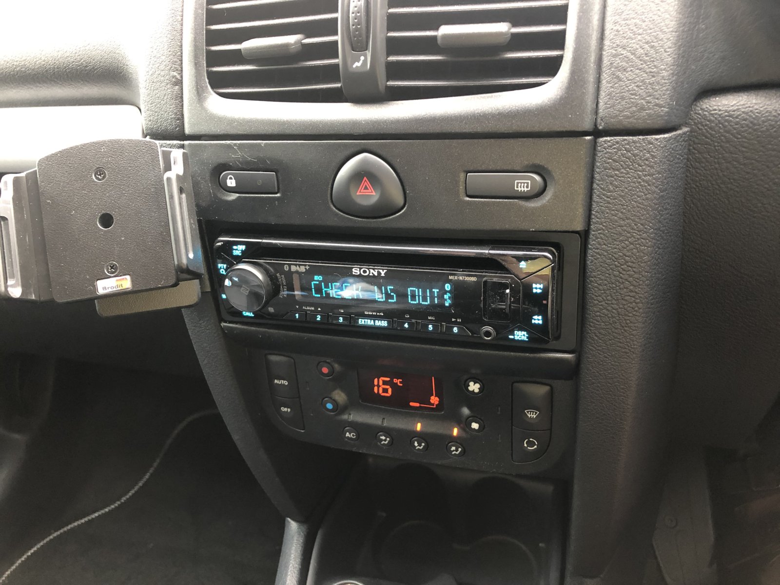

I have an aftermarket Sony head unit which is great with all the usual Bluetooth, CarPlay etc but the stock speakers were never really up to much with a magnet barely bigger than a pound coin!
Fitted 4 of these this morning and I’m well chuffed as the improvement especially in bass is quite startling.

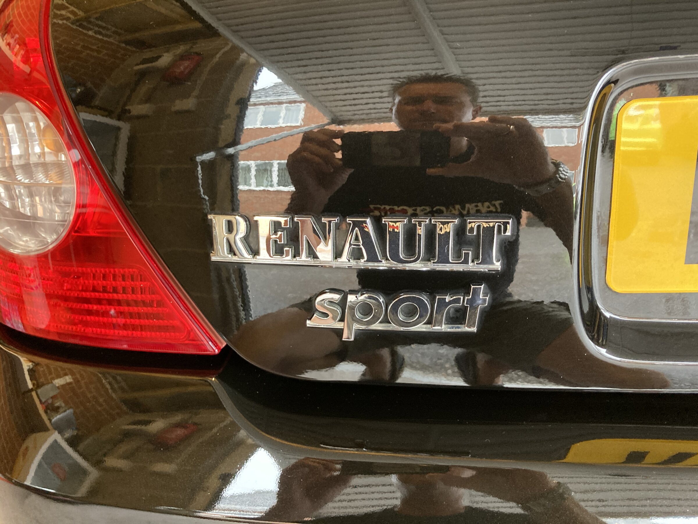

Small update but I’m sure any other members with OCD will sympathise with me on a wonky Renault boot badge! Also will look back fondly on this thread while in sunrise senior living!
Not sure if a vino filled french chap on a Friday afternoon stuck it on in the factory or if the previous owner was Stevie Wonder! Got the old ones off and gave the panel a good polish.
Three bloody expensive chrome plated plastic badges later I’m happy!
