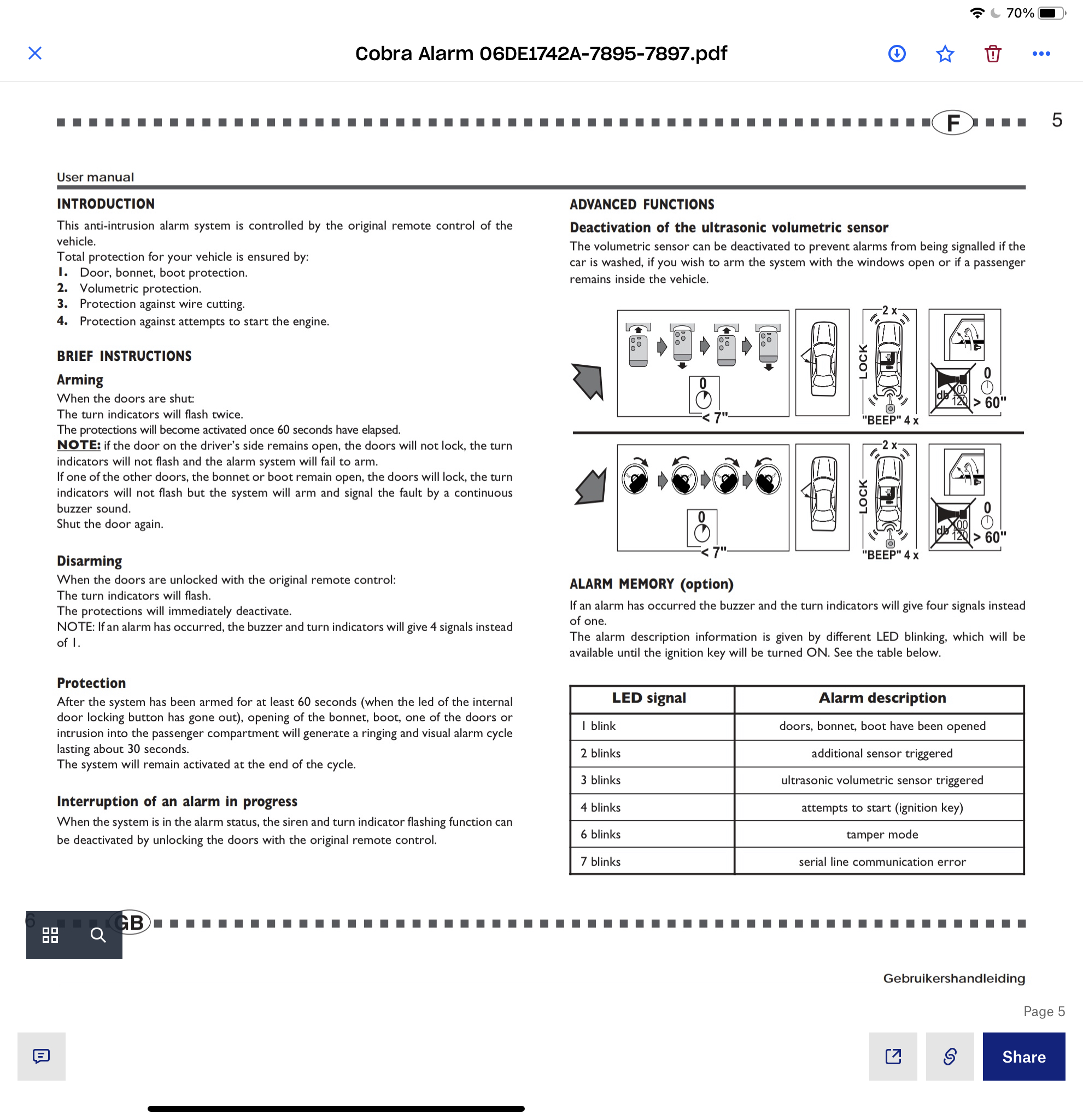

When you manage to turn it off, how many “Beeps” does it give you? That’s a code which will explain what actually triggered it in the first place.
MicKPM
ClioSport Trader
  Clio16v/Zoe Z.E.50
Here’s the section from the manual for you
