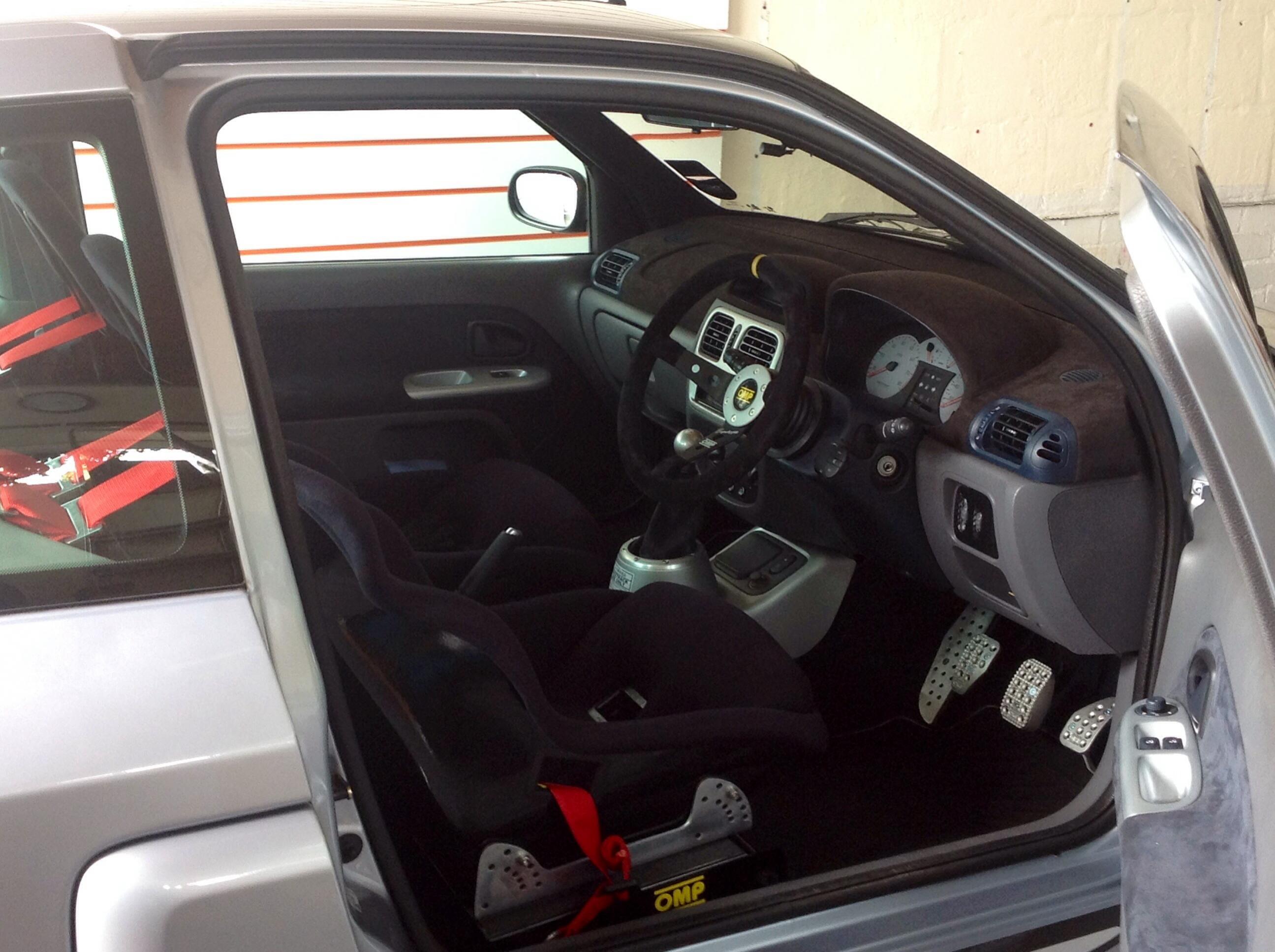

I do this regularly and only use genuine Alcantara....there is different versions with different backing on Alcantara......use contact adhesive etc or you will have lift problems from temperature changes from sun and dash heating.
