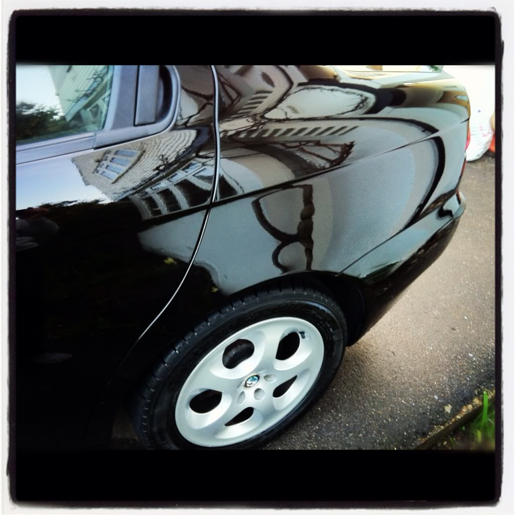

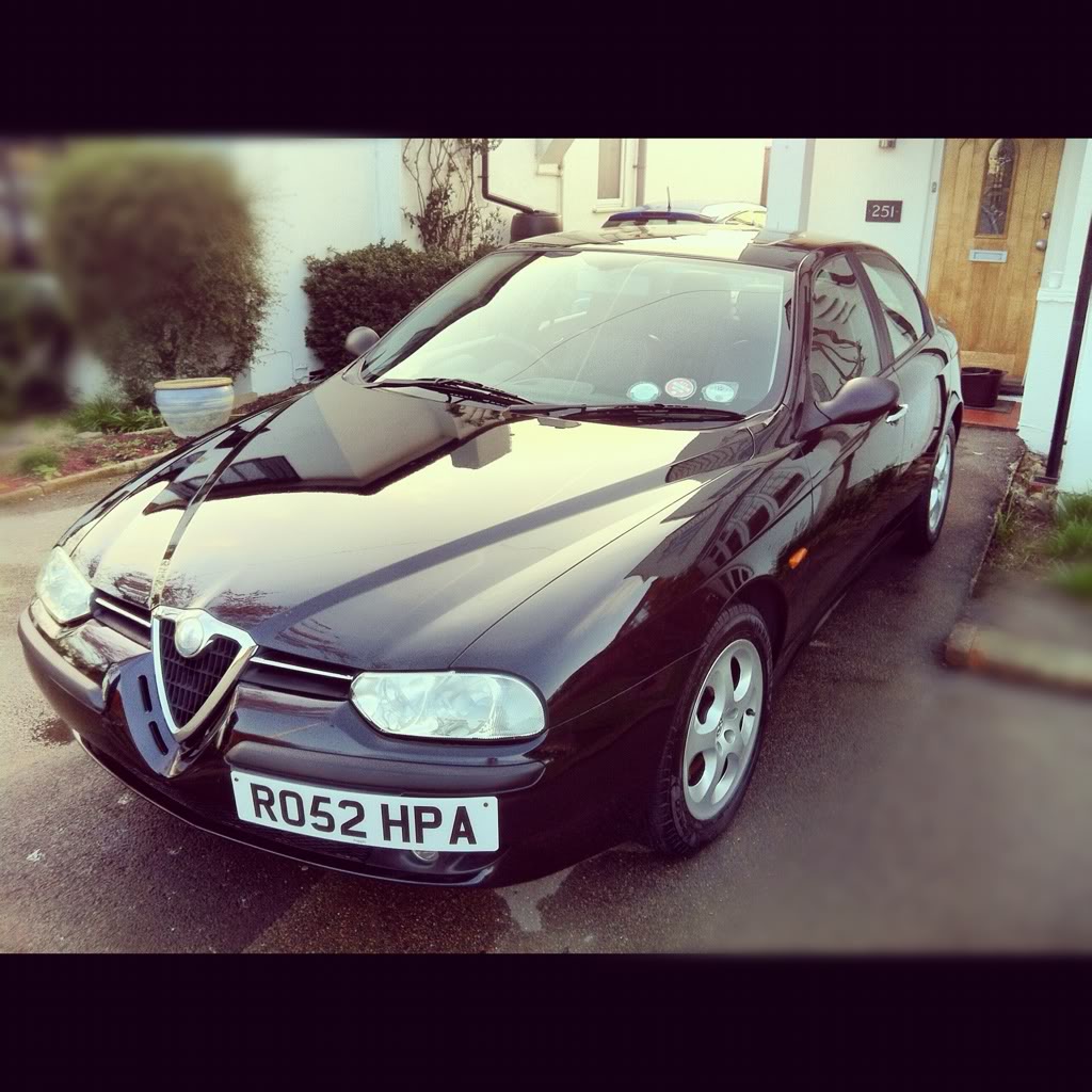

I had yesterday off and was asked by my girlfriends brother to do his Alfa.
The car is coming up to 10 years old and the paintwork wasn't too bad, but it was covered in stone chips and bird poo etching.
Anyway here's what I did ( Sorry no before pics, I started early and completely forgot to take any).
Firstly the wheels were sprayed with Auto Finesse Imperial and left to dwell for a while.
The body work was sprayed with Auto Finesse Citrus Power and again left to dwell.
I went back to the wheels and agitated the dirt with a wheel brush. The tyres then sprayed with Megs APC and agitated.
Car then jet washed and washed using the 2 bucket method, Auto Finesse lather and Megs Lambs wool wash mitt.
Dried and then Clayed.
Rewashed and dried, then I began the polishing stage.
DAS-6 Pro used with Menzerna polish and Chem Guys Hex Logic Pads.
Once I got the desired finish, I then used Prima Amigo Glaze to hide some of the deeper swirls and improve the gloss.
Then Zaino Z2 used as LSP.
Tyres finished with Megs Endurance and trims with Auto Finesse Revive.
Here are te pics.
And a nice sunset pic for you :)

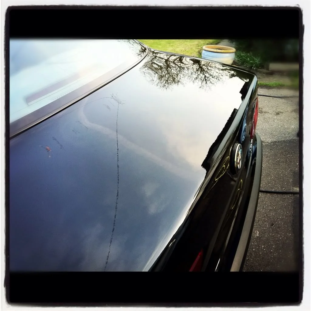

Looks superb. Really should have taken more shots, especially the bonnet. Blacks cars always look like glass when cleaned well.
Great choice in products I must say.
