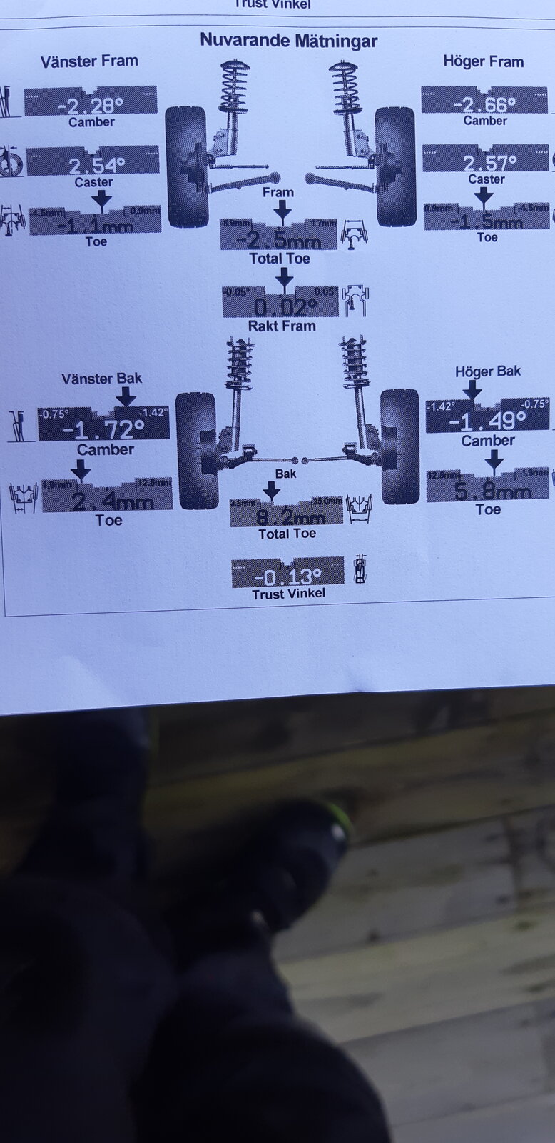

Alignment, what does the experts say?
  Clio 172 ph1
So what does the experts say about this?
We need to do something about the right rear of looks of it!
The car is a endurance racer with nankang NS-2R sitting on BC DS where we have adjusted the caster as much as possible.
  Clio 172 ph1
Bent stub axle? Check its not had shims in the past just fitted wrong
Well we had it down for maintenance and there were no shims from what we noticed.
Does anyone know how much 1 degree will do in mm:s an 16" wheel?
We might order some different sizes but first maybe just fit some washers and then take it to our alignment shop to see the difference.

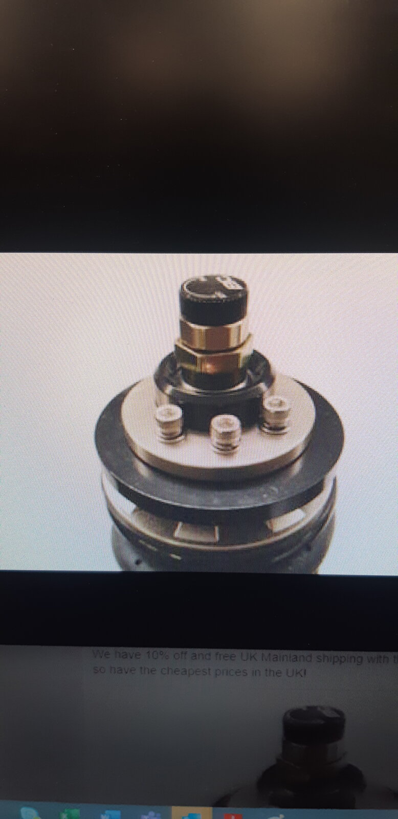

3 degrees won't be a problem, but running more caster will give you extra dynamic camber under cornering.
  Clio 172 ph1
Question is how we should do to get more caster?
Read about moving spindle forward in controlarms. Is there anything else we could do?
Might do that after first race.
This is how we mounted the adjustable tops strut mount, big end towards front of car.
Mr Trailer Man
So you have those 3 bolts facing towards the front? If so, then that is already set to max caster.
Have you got the increased caster lower arms fitted from the later 172 and 182? I see your profile says it's a Ph1.
