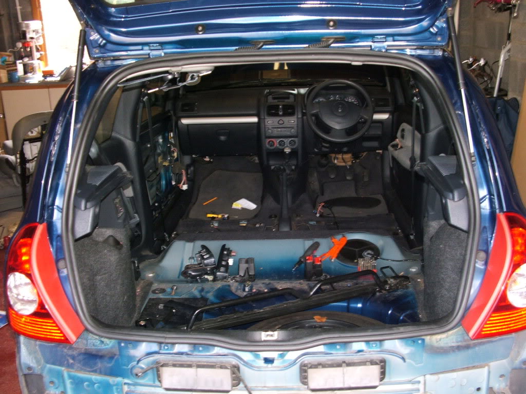

All my seats out. OMFG!

I've still got everything Ive taken out so far, so I'll bring some proper scales from work one evening when I've taken everything out.
What's the definition of full strippage? ;)
  b/g 182, meg tourer
Fine! I'll do it this afternoon!! :)
Are there any bits that I have to take care of not ripping/damaging the carpets or linings?
I will be keeping all the bits I take out just incase I ever want to put it all back in again :)
Also, any advice for the tar? Ive got a heatgun and a chisel - will that do?!
seats are easy. take some care with removing the plastic side mouldings in the rear of the car. front seats need unbolting to remove the carpet, take care not to rip it on sharp edges etc. i would leave the headlining in for now, decide on that at a later date. yeah, a heat gun and chisel/paint scraper will be fine for removing tar. it will be wise to keep all of the nuts and bolts safe for refitting in the future, and take a mental note of how it all went.
you will notice a difference without a doubt, only minor but it is noticable. just take your time stripping it. most of the things that you take out can always be put back in anyway :) mine actually squeaks less since stripping it bare then putting it back together myself.
good luck.

Right Im off to give it a go.
I'll probably start a project thread later on as it's turning into one now :)

Just weighed everything. Everything I took out including jack and isofix bar totals 44kg! That plus sod all fuel really makes a difference.
Out of interest the front passenger Recaro and rails weighed in at 24kg which is more than the rest of the stuff put together! That means that if you want more than 1 seat in your car you should actually lose your passenger seat and keep the rear bench and that means you can still seat 4!
Sadly it is all gonna go back in when I have my new rails for the Recaro.
Henry your point about petrol being lighter than water is a good one! Just looked it up and a litre of petrol weighs 0.72 kgs so 40 litres is 28.8 kilos.
My normal BHP/Tonne is 165, with my weight saving it is now 172. Not masses but the cheapest gain in power to weight I'll ever see. And the lack of weight defo helps with braking and cornering.

Ok, Ive taken the lining out and all the tar except those bits in the rear pillars, which look like a b*****d to get to!
I cant believe how heavy the roof tar is! The only scales in the house at the moment is my Mums cooking scales, which only go up to 2 kilos! This tar is WAY heavier than that!

Just to add to this the standard 182 seats with airbags are circa 32kg, the recaros are more around the 25kg mark, a good fibre-glass bucket weighs in at under 10kg so moving from standard to buckets you can shed upwards of 45kg.
