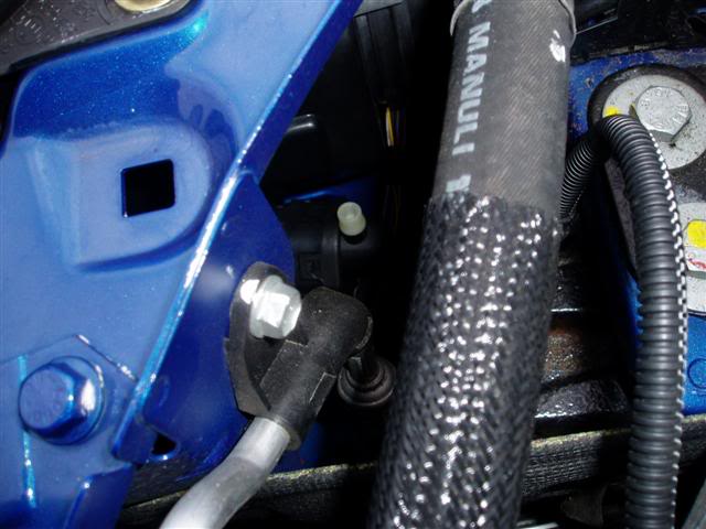

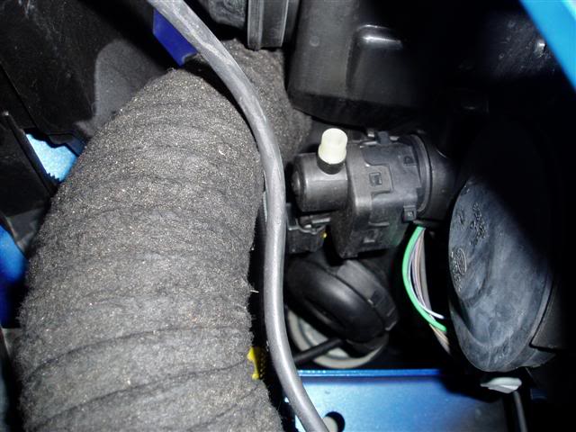

hi i bought brand new xenon 172 headlights today and fitted them , but its a t**t to get to the adjusters on the back with them on the car .. ??

Why are they a tw4t to get to ? Adjust them with the white adjusters using an allen key . Don't quote me on this , it's been some years since i adjusted mine , but i'm pretty sure you have to adjust them with the ignition in the on position , if you don't they re-adjust themselves as soon as you turn the ignition on .

Different in what way ? These are xenons in the pics . And the white adjusters are what i used to adjust mine . These adjusters are for up and down . I think there " might " be 2 more adjusters for side to side adjustment ? I can't remember off the top of my head now .

Easy to do park up in front of a wall or something and use an allen key on the white part to adjust up or down.
