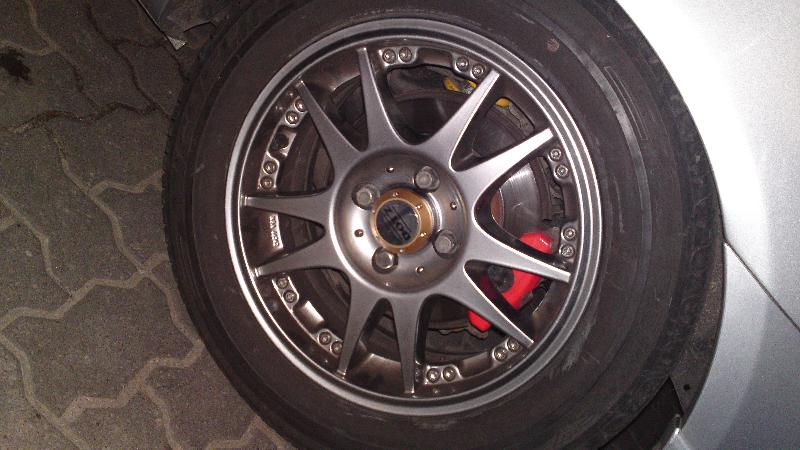

My problem is that they are fake split rims.
How do i deal with it? Do i remove the fake torx bolts before i powder coat them? cover them?
What is the best sollution? Should i assume they bolts are glued there as well?
These are the ones in question
