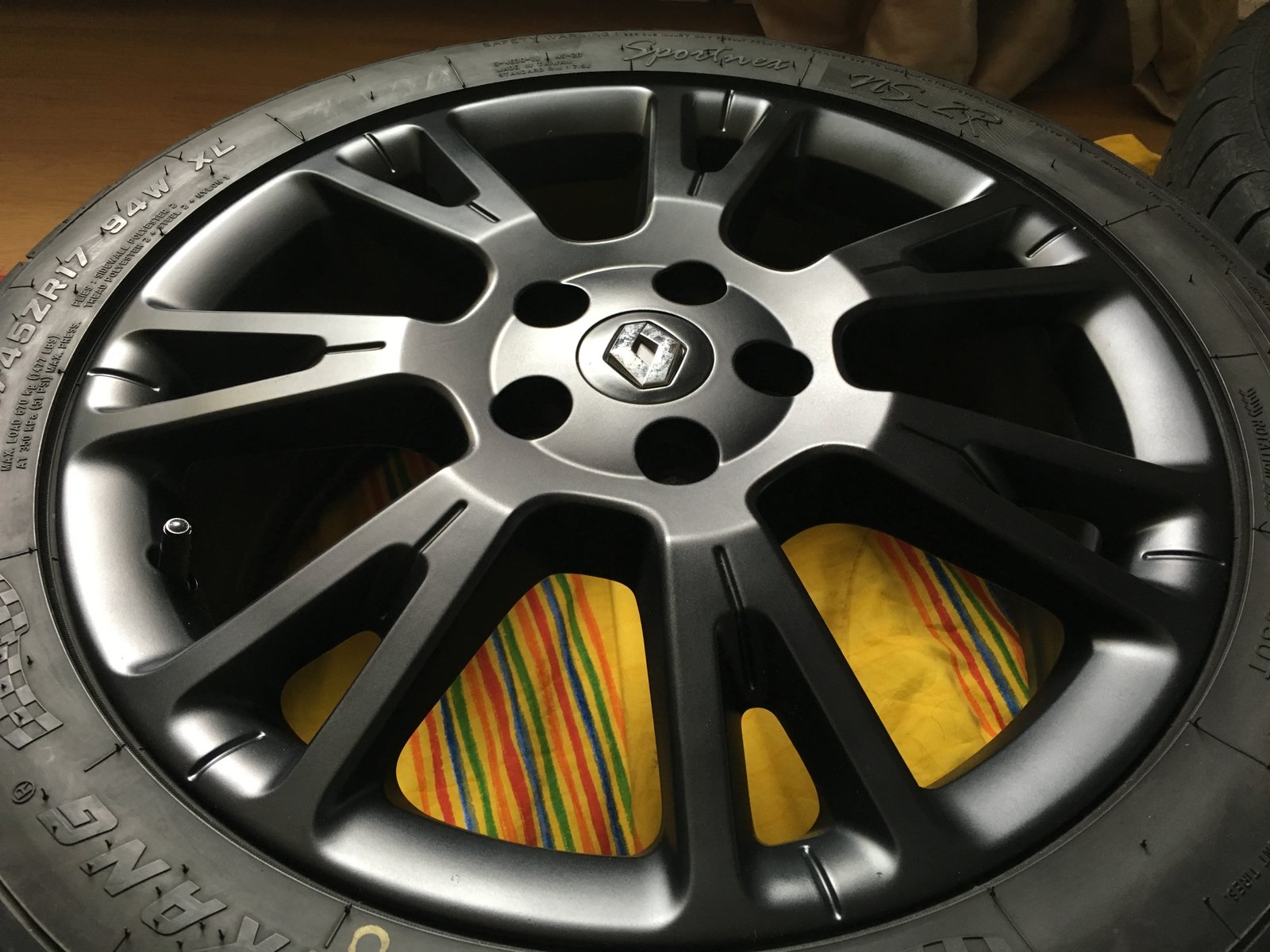

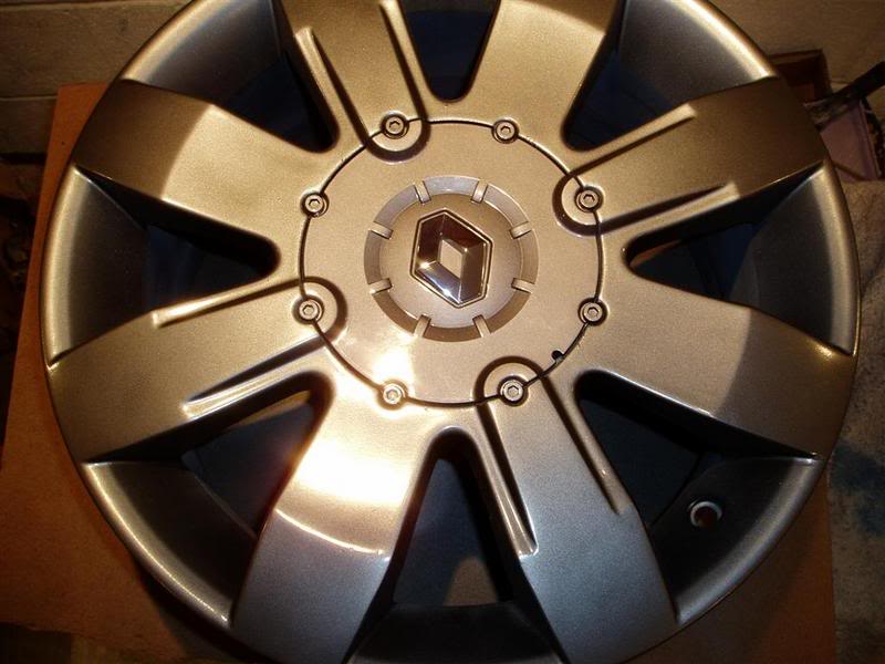

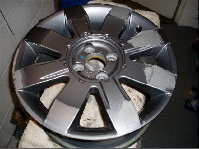

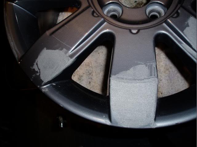

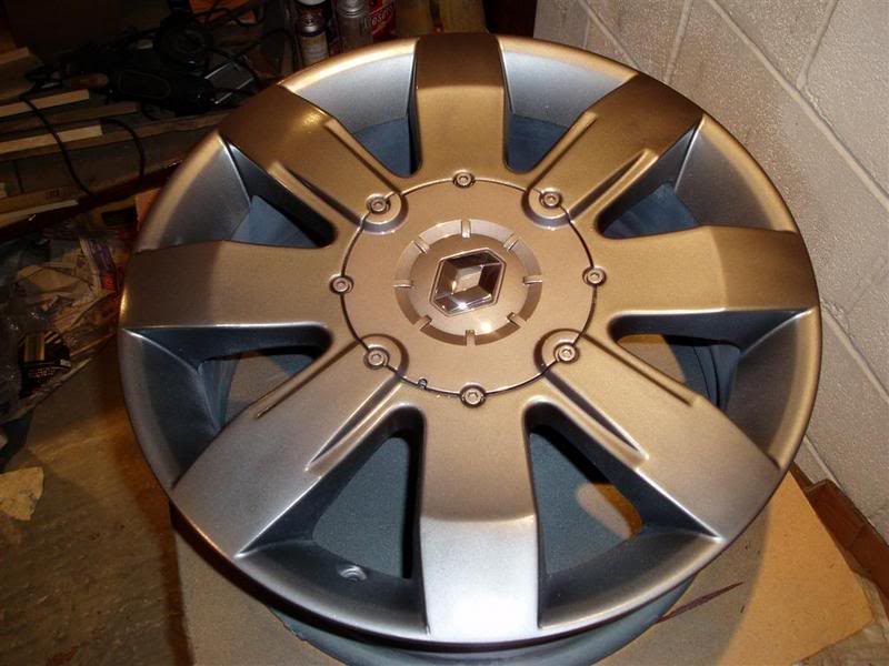

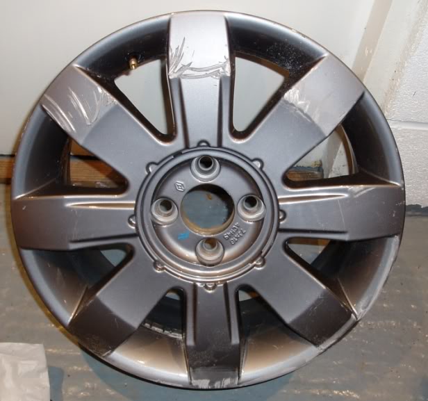

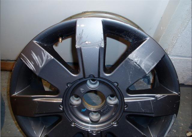

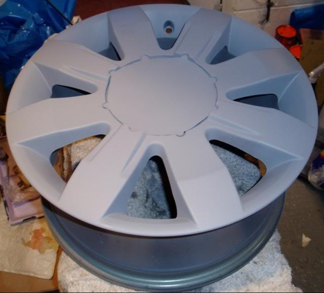

I refurbed a wheel I bought for a spare a few years ago . It was badly scratched and needed a bit of metal filler .
I used Isopon metalik filler
https://www.amazon.co.uk/dp/B006I4ABCY/?tag=cliospnet01-21
And I had my paint mixed at a local motor factors . Since then , the go to place for anthracite paint seems to be Autopaint in St.Helens. The paint code is 205-110.
You need a bit of time , patience . Good preparation i.e keeping the surfaces clean and grease free are important.
https://www.auto-paint.co.uk/autopaint/

Thanks very much for your advice I will look into this :smile: amazing results by the way!
Thanks . Don't forget your car will be off the road for a few days while you do it . Your best bet if you're going down the DIY refurb route is to get a spare with a tyre and do one at a time :wink:
Cheers yeah I was just thinking that - I guess I could just buy a naff old 172/182 wheel from a scrap yard while I do refurb each wheel :) As mine's a 182 as well it didn't come with a spare :(

That's your best bet , get one with a useable tyre then keep swapping them round , that way you can keep your car on the road :smile:
Did you guys lacquer the wheels after? I want my wheels to look as good as that so I'll attempt this soon once I've found a spare wheel at the scrappy

I didn't, they started satin so I finished them satin.
I'll be redoing mine in the next couple of weeks but I'll be lacquering them.

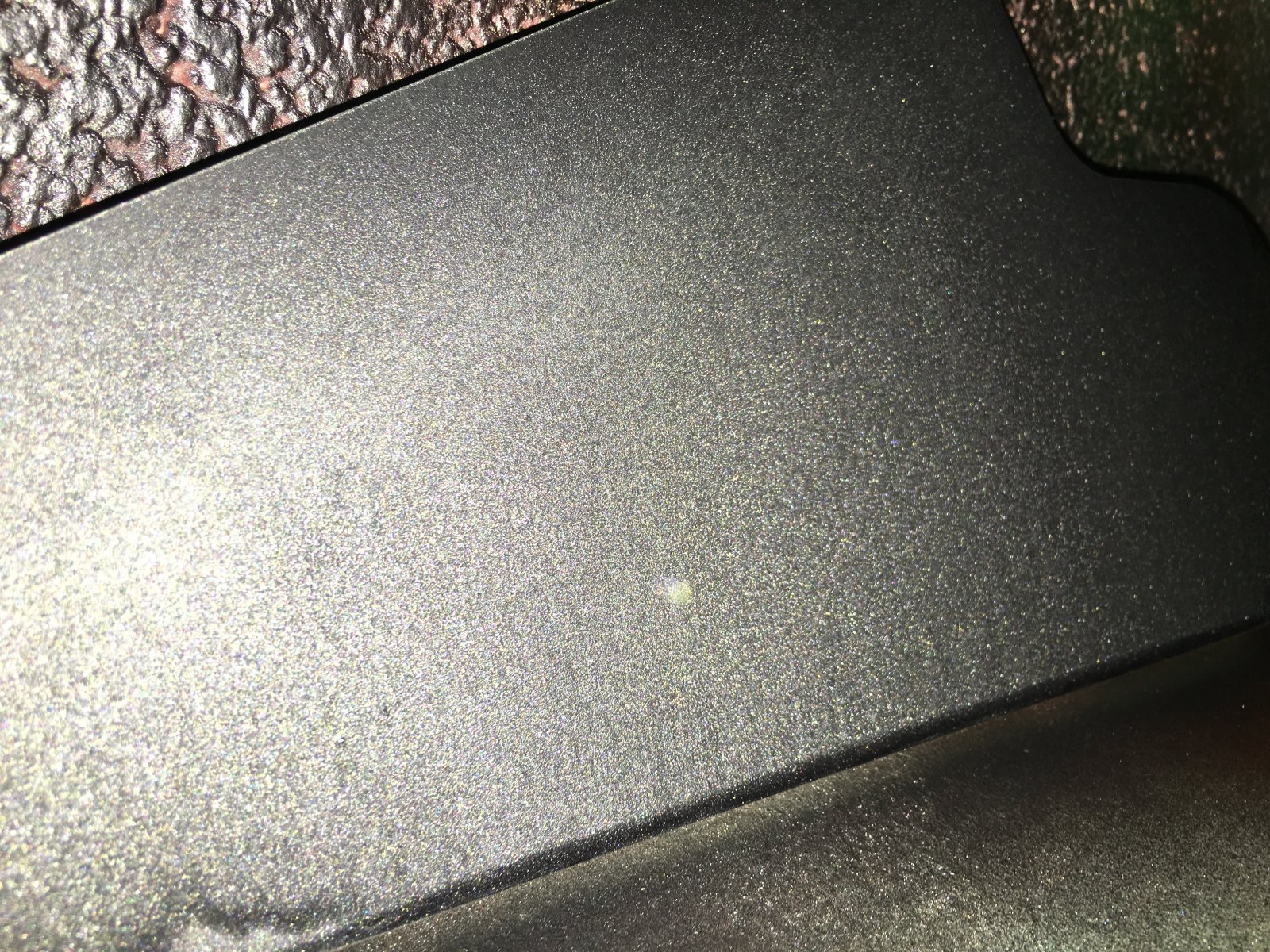

They'll be going bmw space grey as soon as I'm happy with how I spray it lol
Today's test piece with horribly wrong gun settings

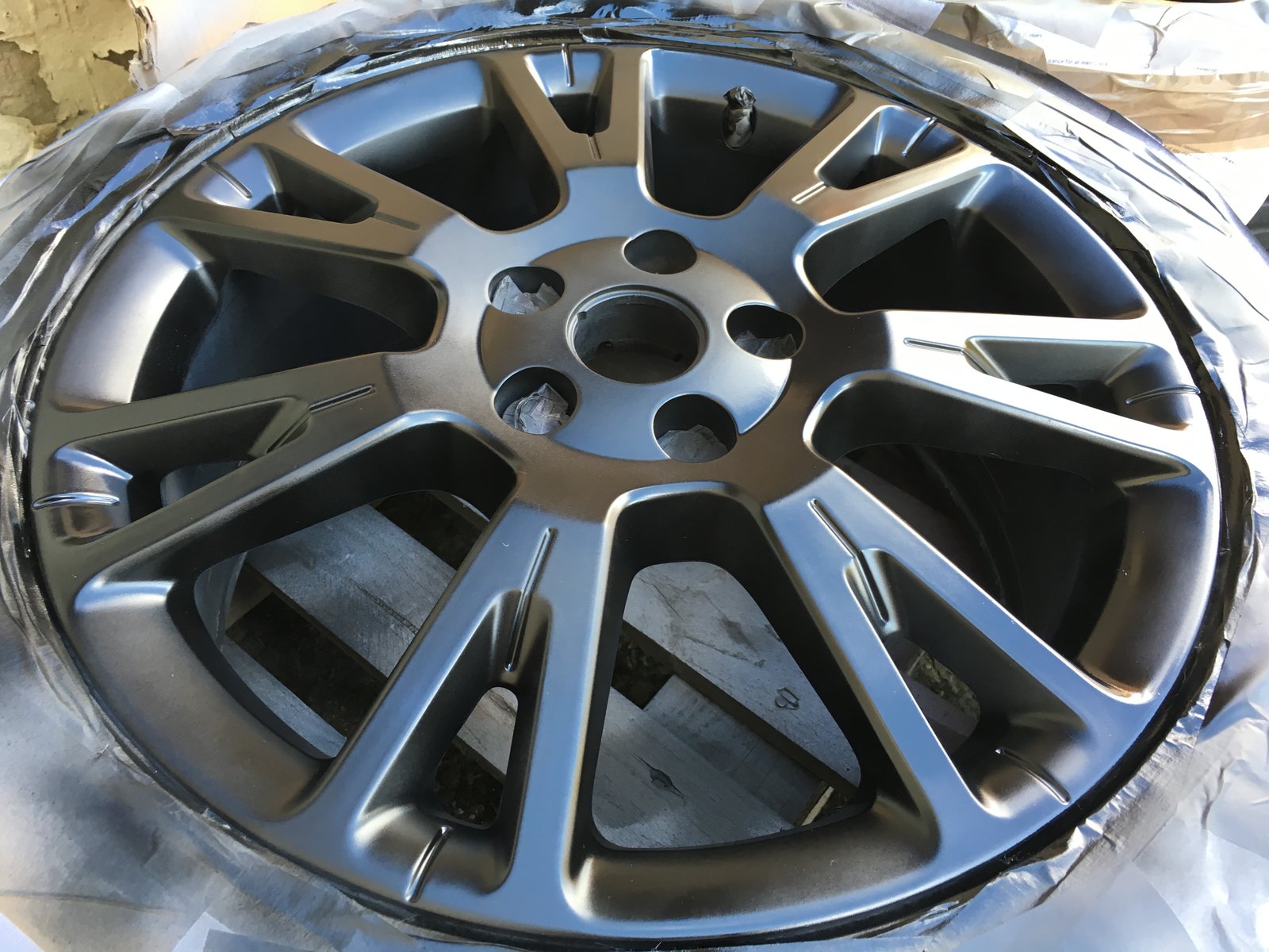

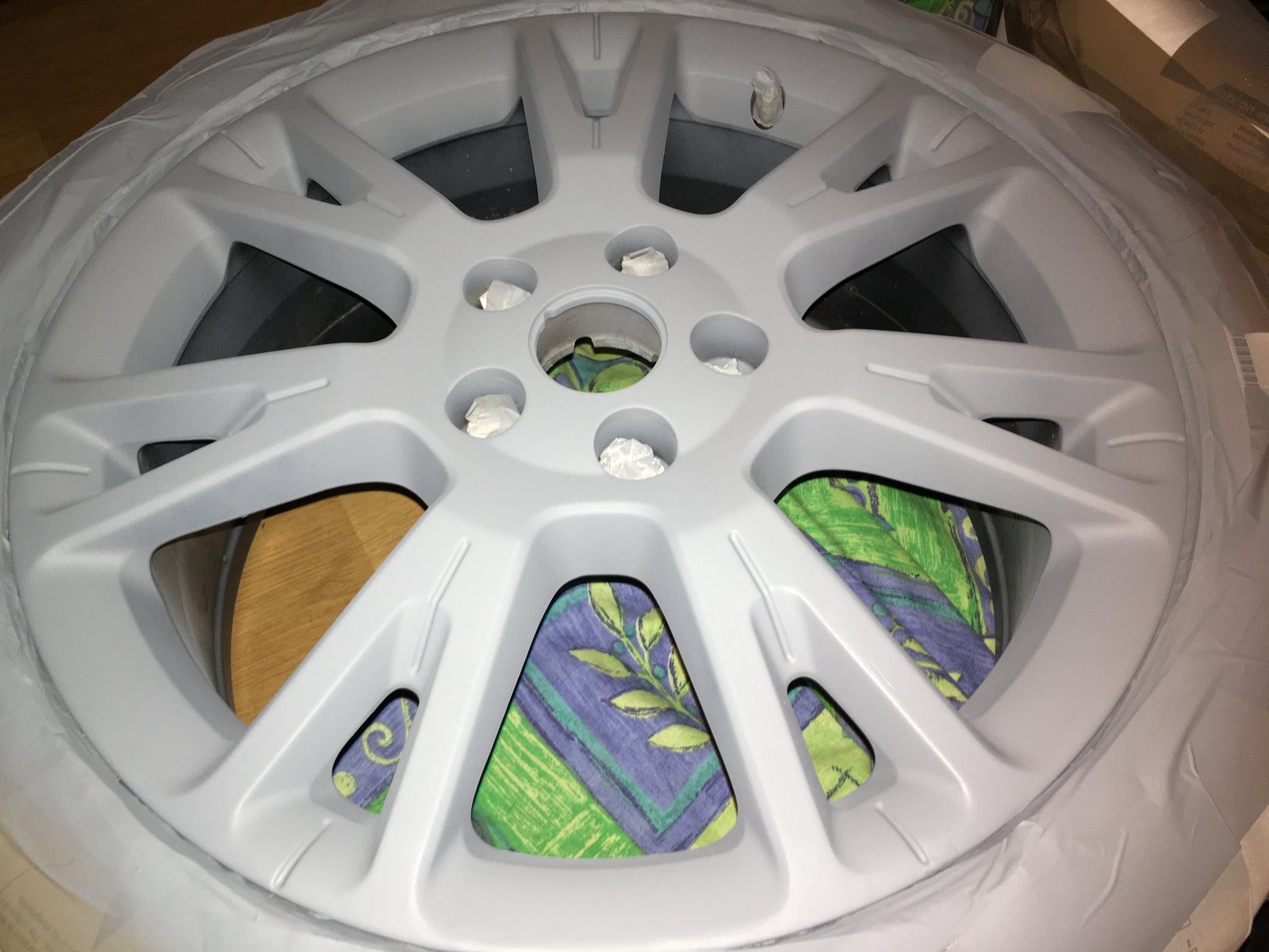

I used one 750ml primer tin borrowed from work then two satin black tins iirc for all four wheels
The filler was less than a tenner I think but obviously I've got that for the future now.
The invoice for the Beamer paint, thinner, hardener, and clear coat came to £95! So it gets fairly expensive the more 'professional' you go

@MRBILLYUK did you paint the centre caps too, what did you do about the chrome diamond, just mask it ?
The centre cap was pretty much mint so It didn't need painting . I made a template out of cardboard so I didn't spray inside the wheel where the bolts go ( as you can see in one of the pics).
