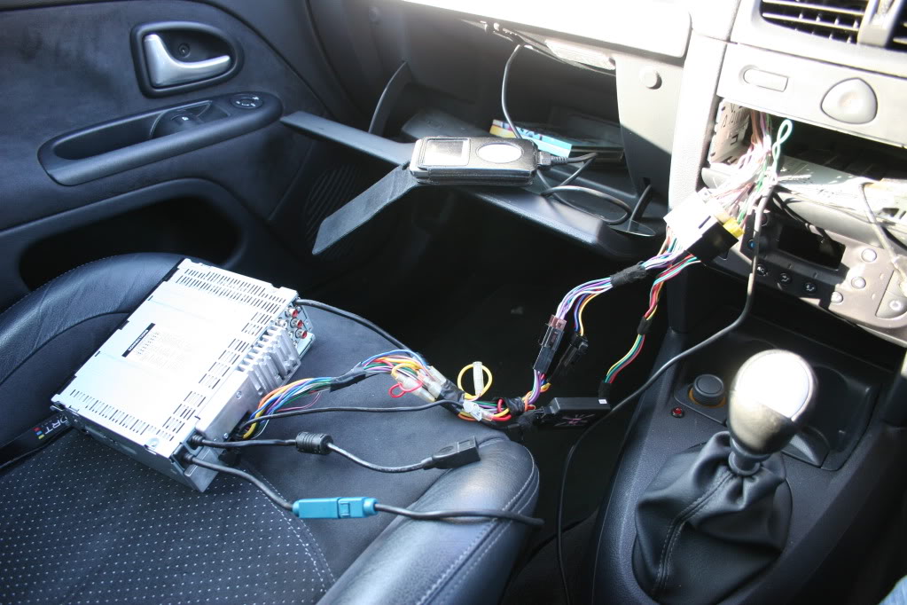

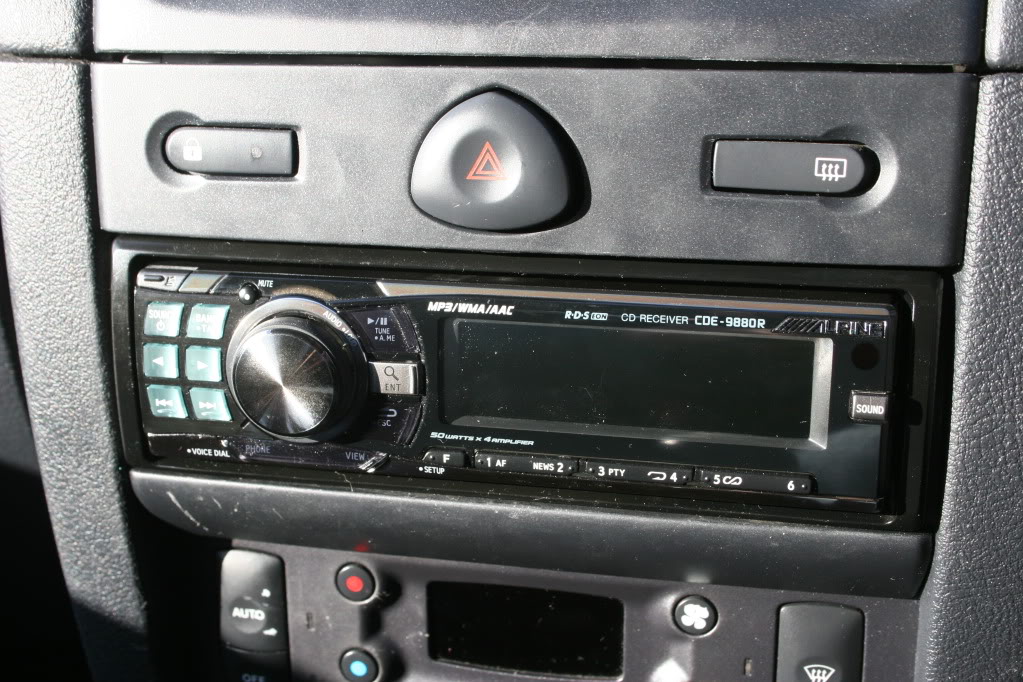

Well ive finally made the jump from my 1.2 to a 182 and I'm loving it! I have an Alpine CDE-9880R headunit. In my Clio 1.2 I used to have it wired up into the stalk controls with my ipod in the glovebox. It work perfectly.
Anyway, before I sold it I took the alphine out will all of the wiring needed to re-install into my 182. So today ive come round to getting it fitted, it all works fine but the stalks don't work? It all looks exactly the same! The only thing I can see that may be different is the pin arrangement on a yellow (female) connector to its male part? If anyone has any idea on how I can get my stalks working with the 182 that would be great.

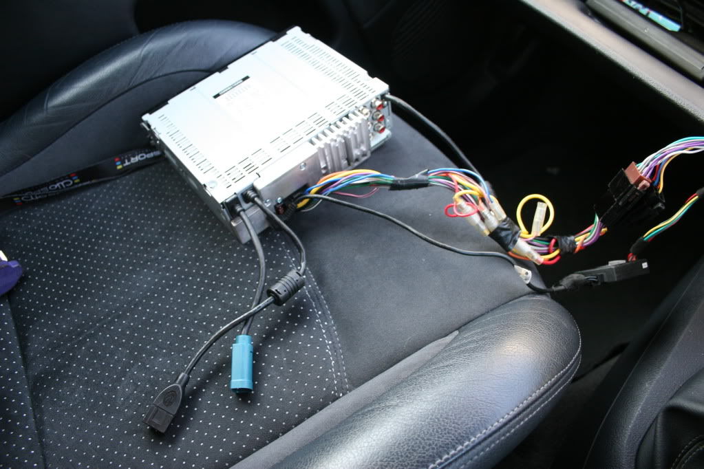

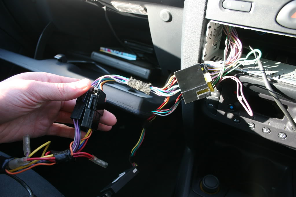

Wires from 1.2 and the adapter unit end:

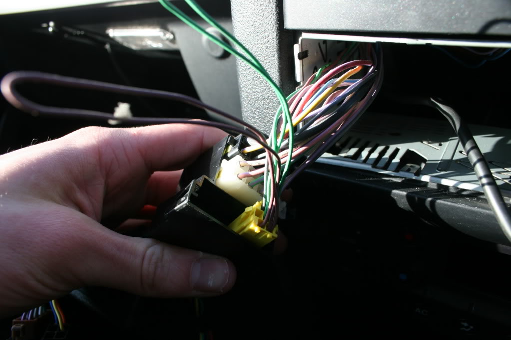

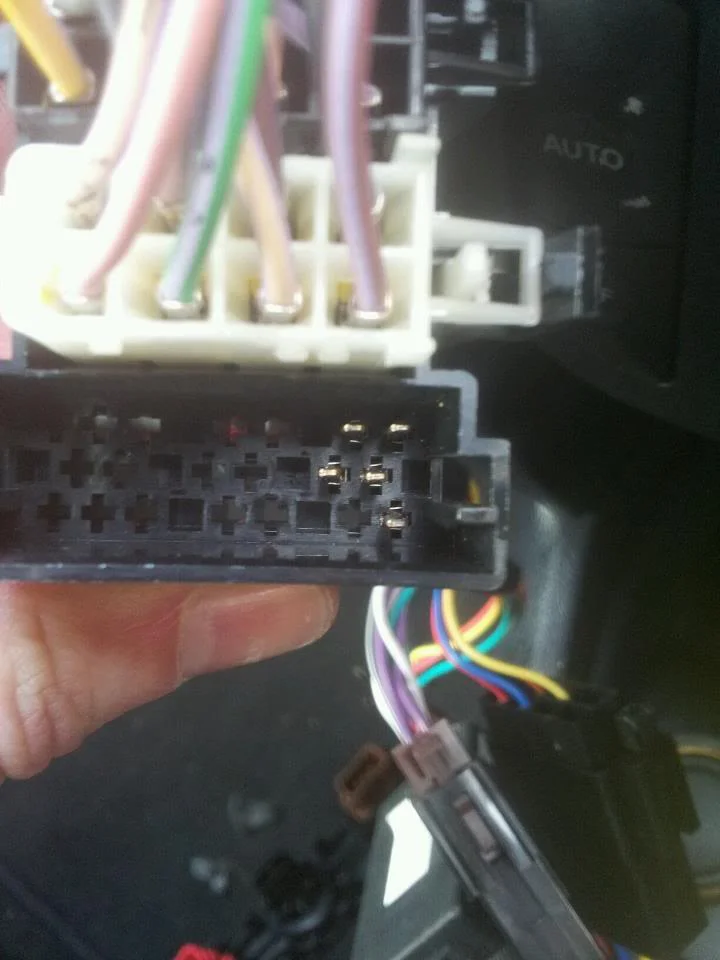

182:

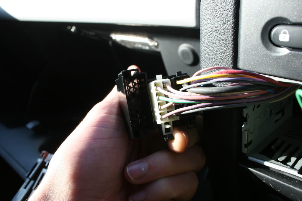

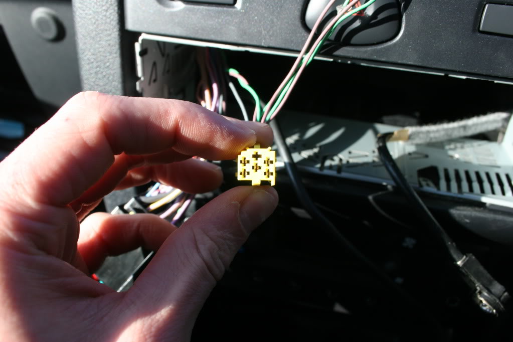

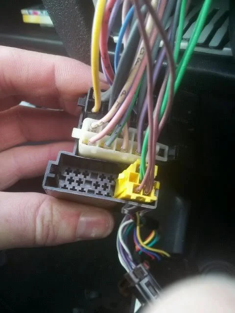

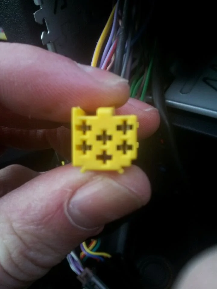

Female yellow:

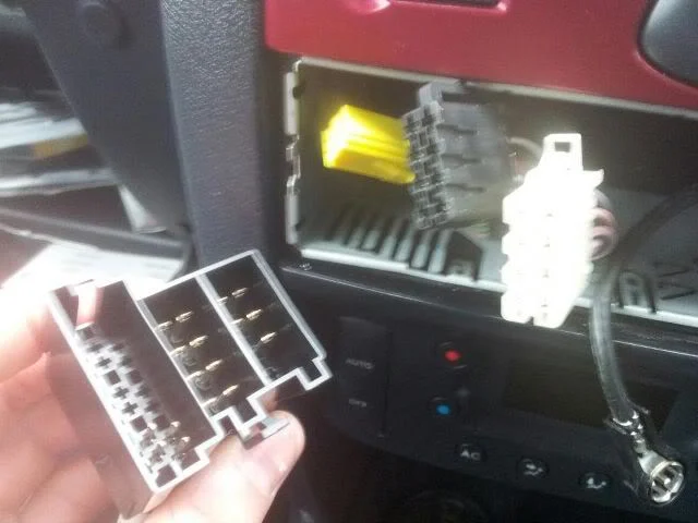

Male part:

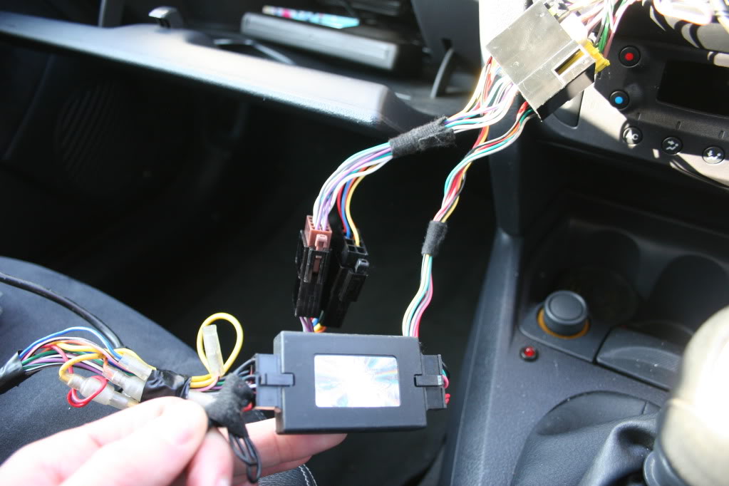

And how it 'should' be connected, this is how it looked on my 1.2 and it work fine (photo from 182):
I know the stalks work and I also know that the headunit and adapters all work so I'm scratching my head over what is different? :S

From memory (however i used the official alpine stalk and display adapter) the yellow plug plugged directly into the stalk adapter itself and not the main HU loom
Also 182's after a certain year use a different setup so be wary of that.

i tried this when i moved from a 1.2 to a 182 and the stalk adapter that worked in my 1.2 wasn't compatible, where it plugs into the back of the screen was different, and supposedly I had to buy a £90 adapter (if this is true or not, i have no idea) I just run without them, would like them to work but not worth £90
  172
If you had a 1.2 prior to 04/05 and the 182 is 05 then it wont be compatible. You have an update list unit fitted to your 182 as standard yes? Stalks arent £90 but they arent as cheap as the tuner list as its a can bus system. They come in at £40.

I used a KCE-940b and KWE-942 on my 182 (2004). However that may not work.
Cost £60 for both (you need them both, and the display works). I doubt they are cheaper or more expensive now.

Reckon it could be a tuner/update list incompatability issue. MT will know

If the new car had a different headunit to your old one (one had "tuner list", the other an "update list")
Then the leads you already have wont work.
