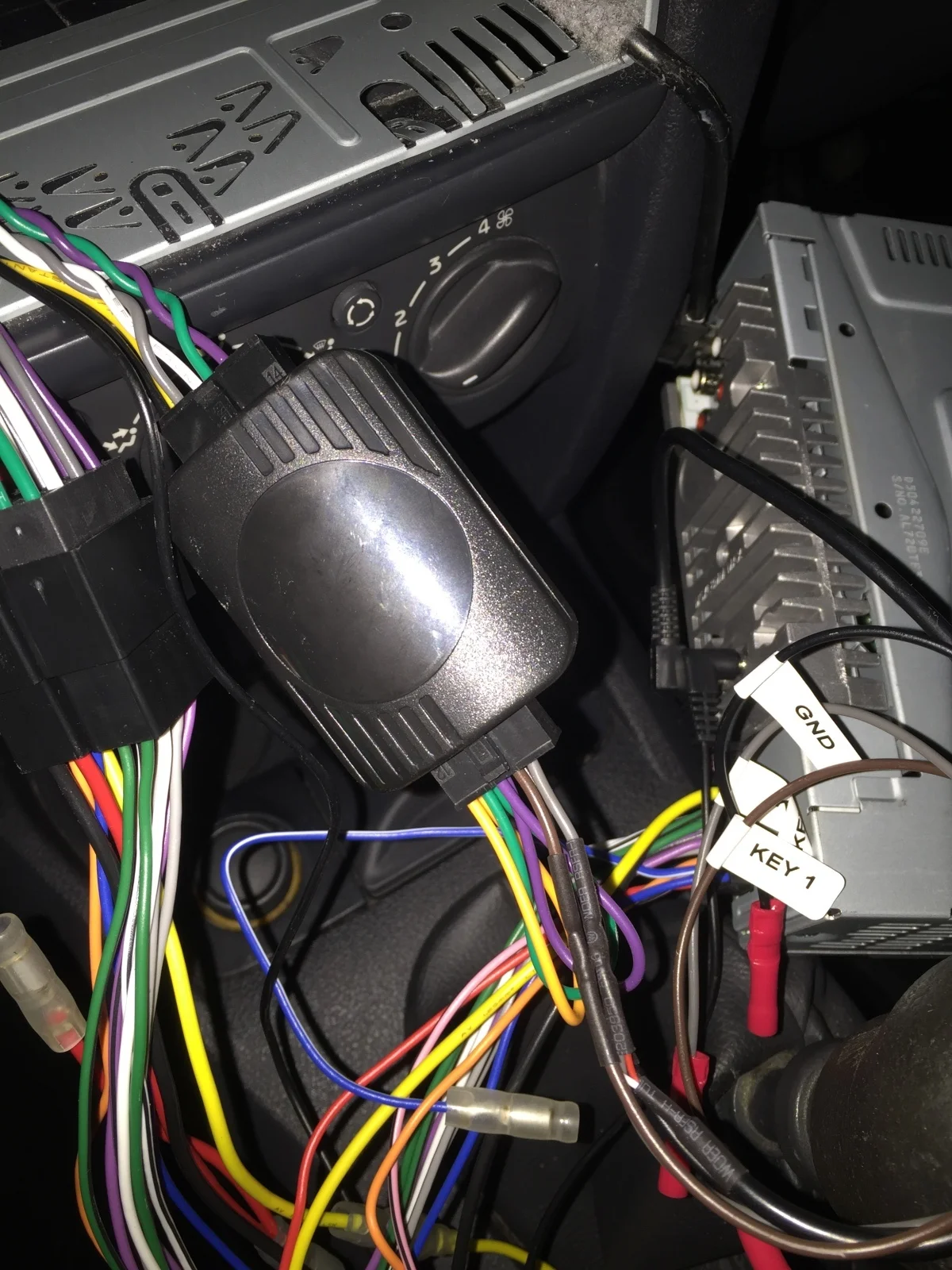

This is my adapter, with the patch lead connected.
The configuration assignments state that Link J2 needs to be disconnected and on my picture it looks like it's still attatched. Does anyone know if I need to disconnect it or if it will have already been done? I've put everything in the car now and can't remember what it looked like.

Apologies guys, I've just read that the supplied lead is a CTMULTILEAD.2 and isn't Alpine specific (obviously it is multi) and that the green wire needs removing (or cut) so I'll try this tomorrow when it's light again (and I can be bothered to take the dash off again) and let you know if it works.

Absolutely right, I bought this exact same lead a month ago and I cut the green lead and it worked first time.
There is still a small chance that your car didnt have an update list originally or a tuner list. Annoyingly both tuner and update list had their own steering control.

I just assumed it was Alpine specific since DynamicSounds asked me to specify which patch lead I required, if only I'd read the instructions properly first.
And I was too impatient to wait until tomorrow, so I went out and cut the wire, and all is working!
