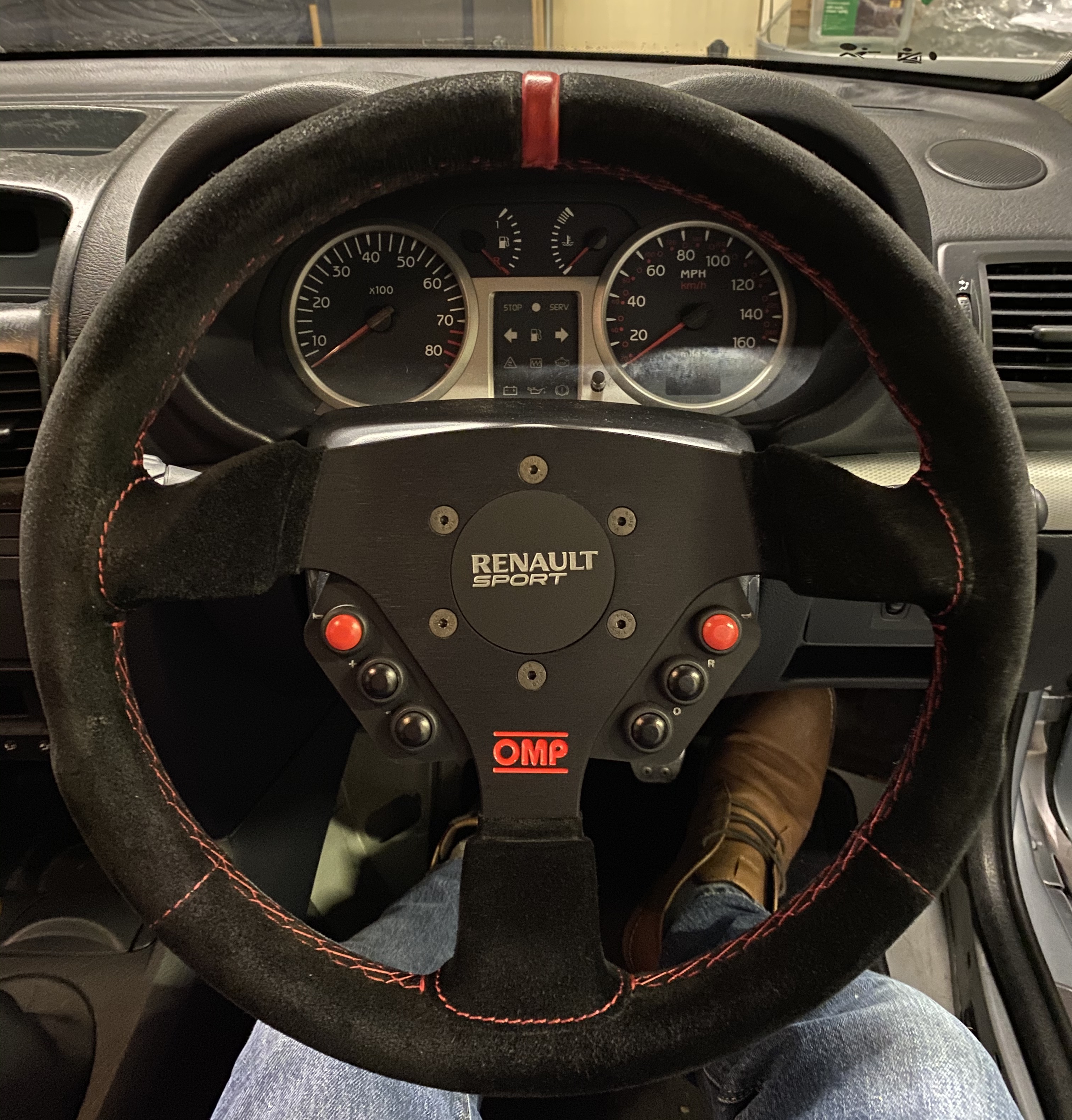

Out of interest, what do each of the 6 buttons do? Top 2 horn? Mid/bottom right cruise on/off, and mid/bottom left speed up/down?
Andy P
  Clio 172, Clio 220 T
Regarding the buttons that’s correct.
Basically top two are horn and the other 4 replicate the standard buttons for cruise/limiter and position they are on the standard wheel.
Andy P
This is my wheel and panel, you should be able to see the markings for each button.
