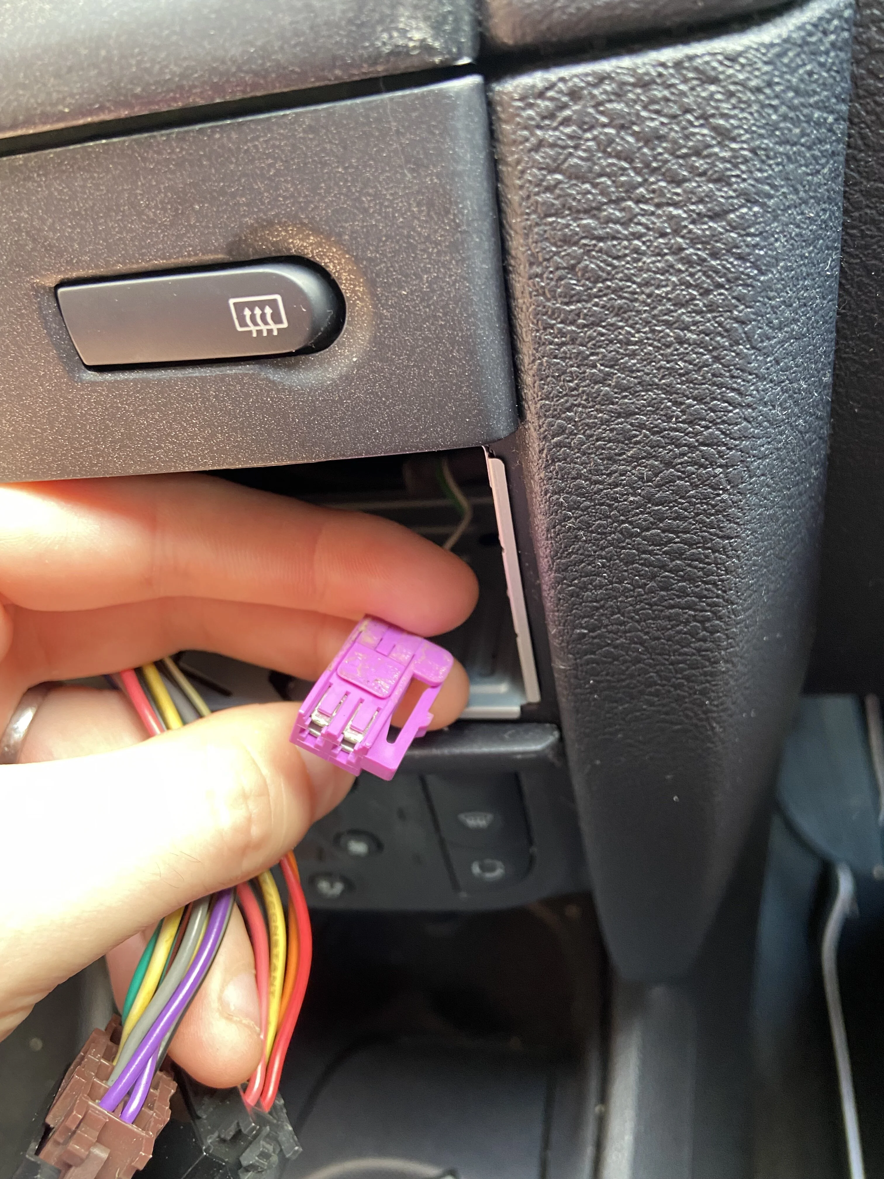

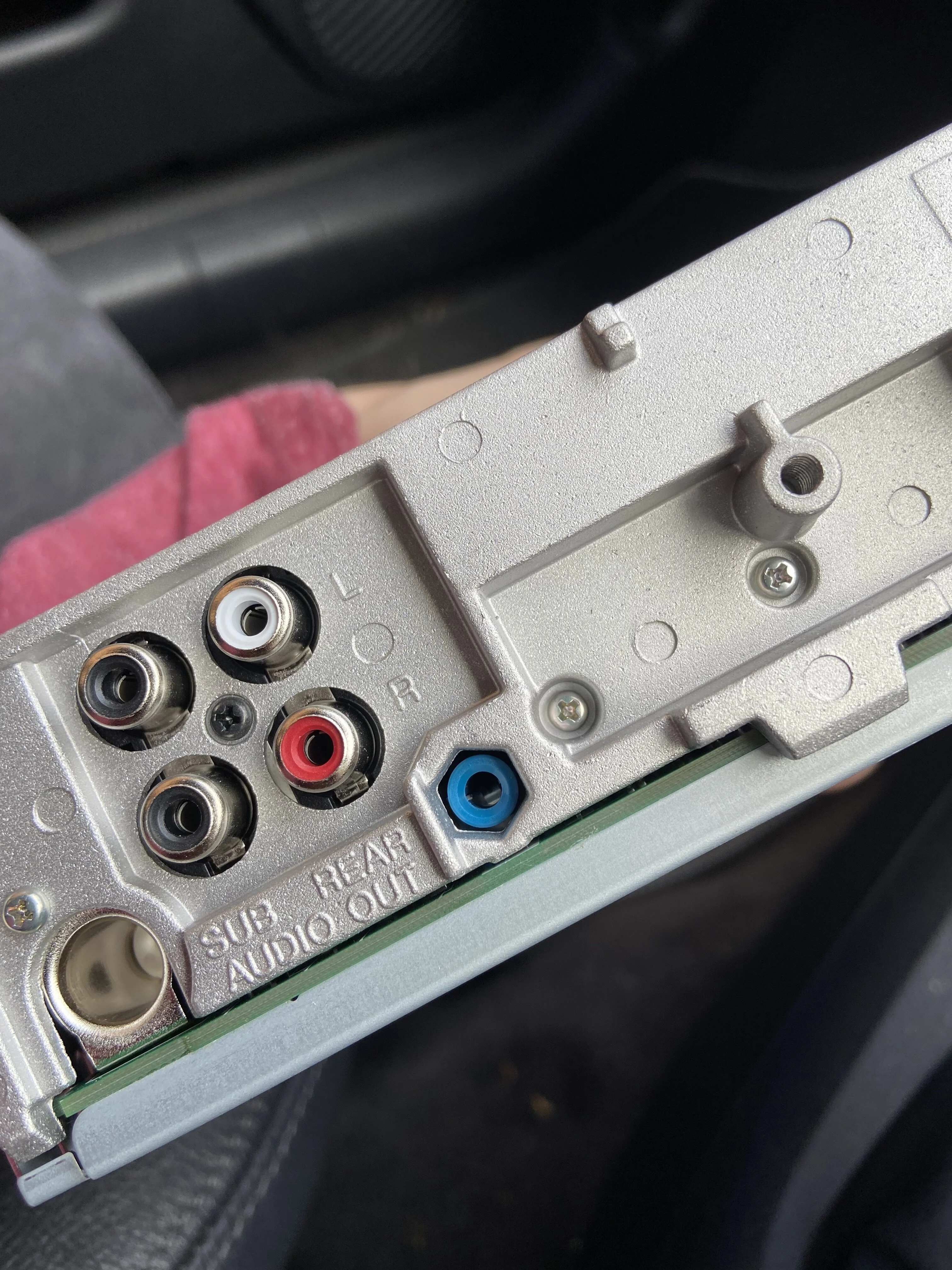

I'm connecting a new stereo (a Sony DSX-A410BT) to my Clio 182. So far, so good. All seems to work except the steering wheel controls.
I believe I need to buy an adaptor to connect the steering wheel controls to the stereo (the blue socket below).
My question is, is this purple connector the wire which goes to the steering wheel controls? I.e. is this the connector which the adaptor will need to fit to? I can't see any other connectors behind the stereo, but some of the adapters I've seen look a little different and I want to make sure I buy the right thing.

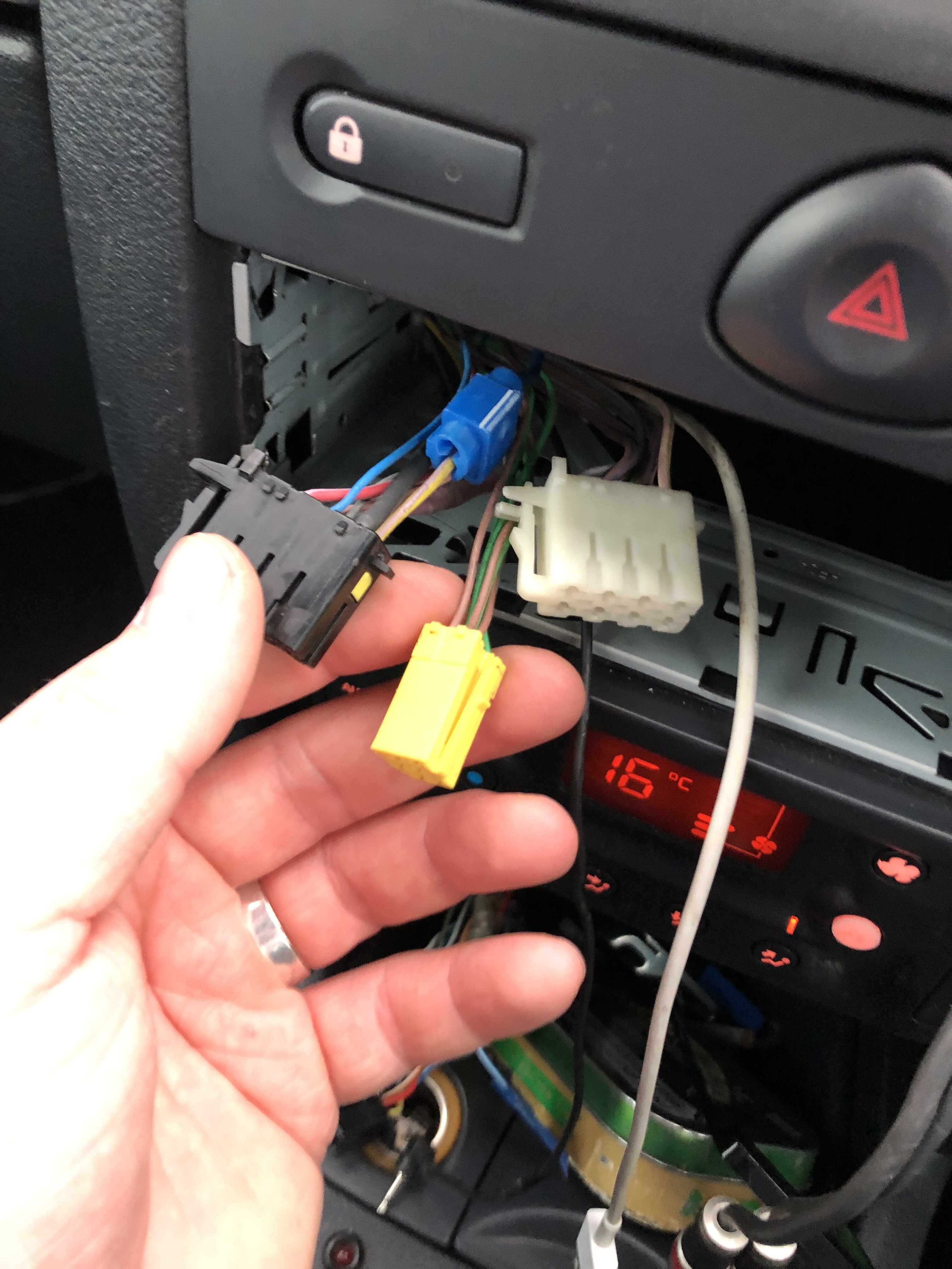

I have sorted the the above with correct connect2 box an headunit specific patch lead. I’m unsure as to what your purple lead is though as mine is yellow and 5 pin not 2 like yours looks.
Below is the correct interface for a 54 plate 182 with the correct headunit lead.

Sorry, only just saw this message. Basically, the purple connector turned out to be a red herring (purple herring?). I think it might have been a connector for a disconnected aftermarket stereo perhaps.

Did you need this patch lead as well as the connects CTSRN500.2? I sent a message to caraudiodirect and they said I need this patch lead but didn't mention the connects2 lead in your pic. My original 182 head unit is the update list version.

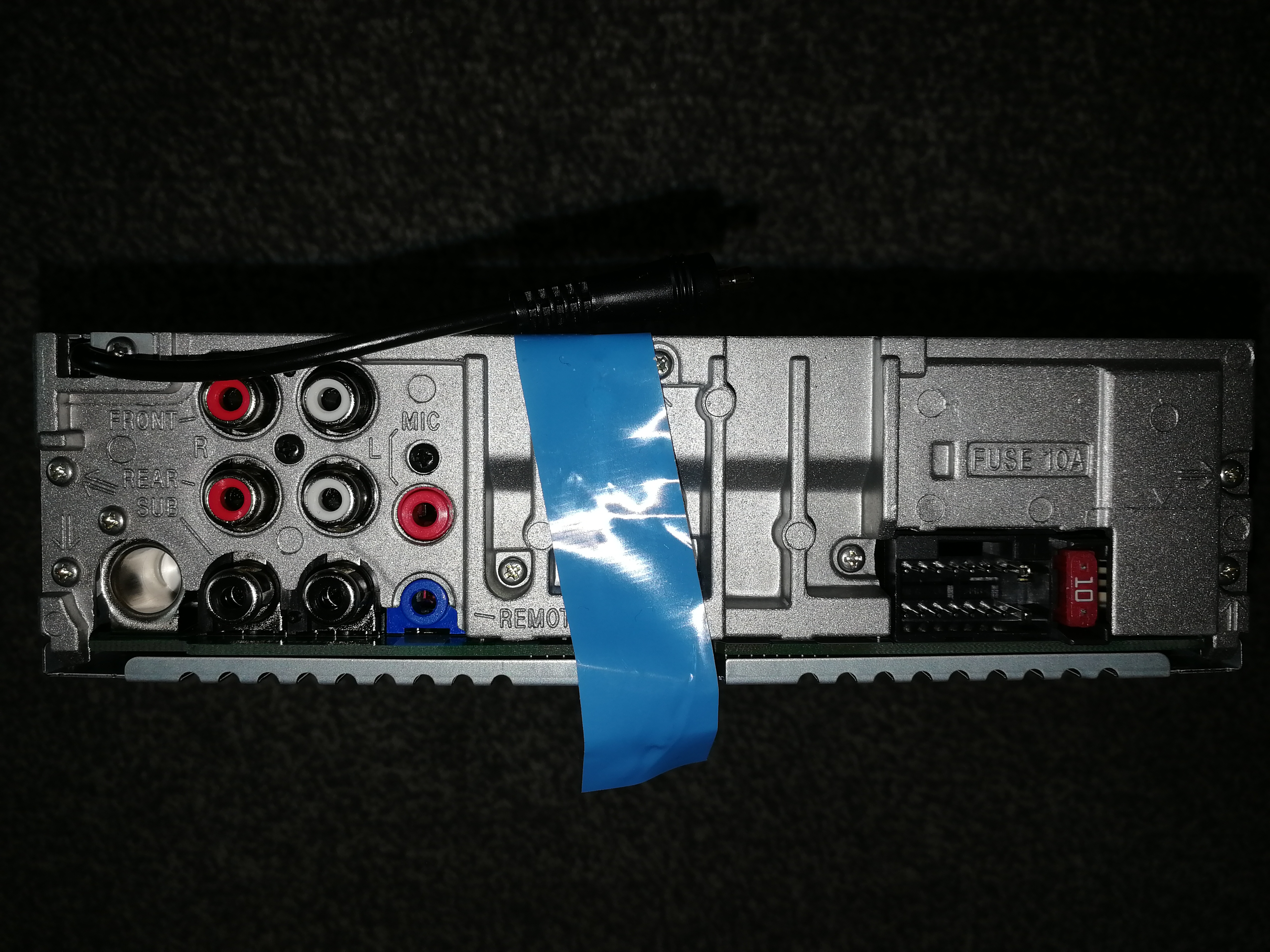

This is the rear of my new Sony MEX n7300bd.
All I want to do is keep the steering wheel control. I'm not really bothered about the dash display.
