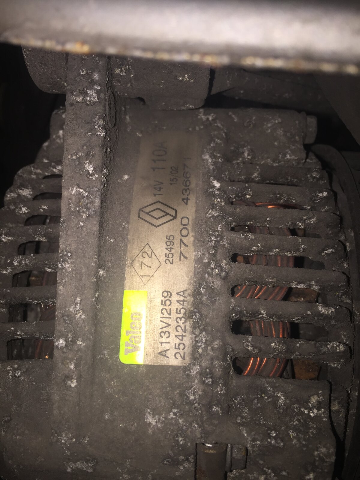

Put it back on today and smelt something funny, so pulled the terminals off again. Had a look, nowt obvious. Put them back on and all was fine for about 30 seconds until i walked round to go start the car, all I saw was a small stream of smoke coming up from the alternator area. Whipped terminals off and the bumper.
Alternator was warm to the touch, nothing major.
Question is, is it now dead? Or is it just because it’s been stood? Will actually starting the car clear any crust that’s built up on the casing?

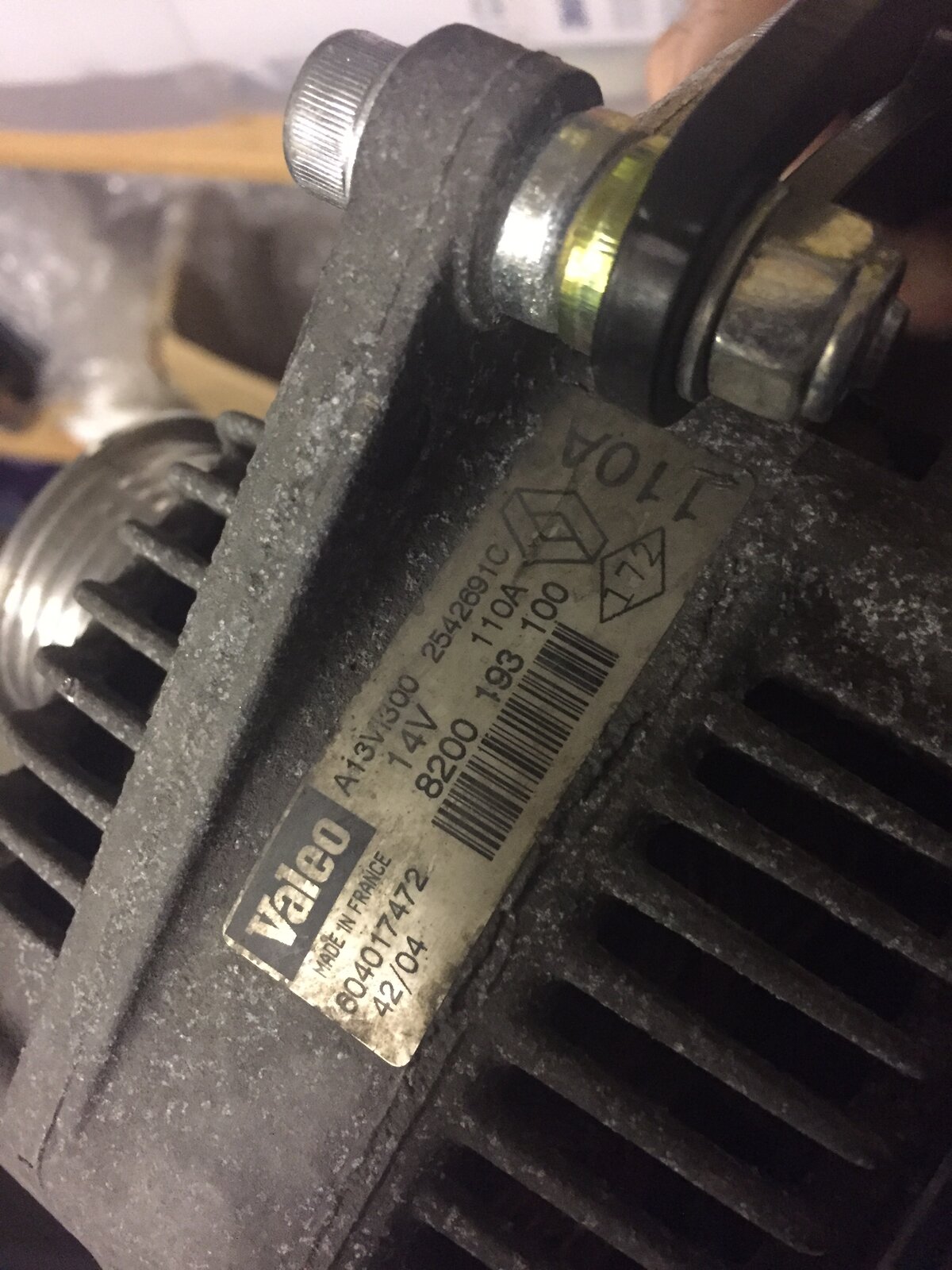

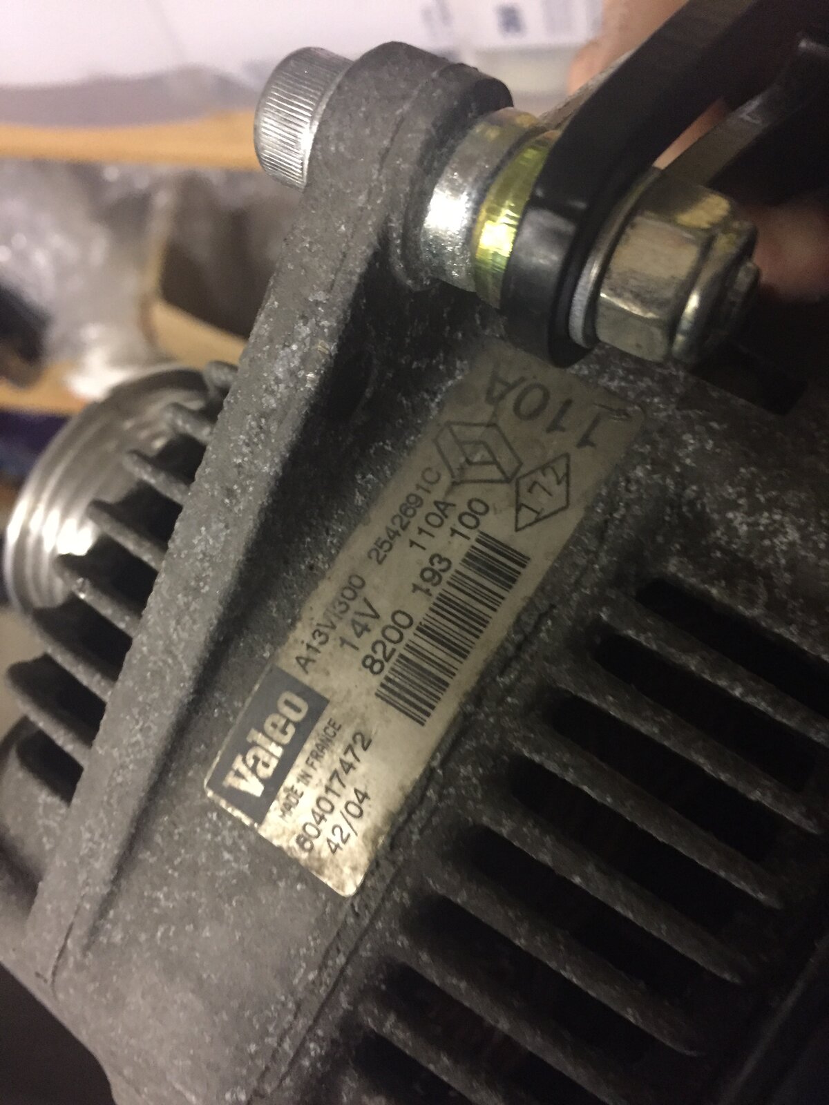

I do have another one that came with a PMS ac delete kit. Not sure if it’ll be ok to use part number wise? It’s been in a box for over a year and looks in good nick
(First pic is the one on the car, second is the additional one I have in a box)

As long as you have the AC delete kit fitted you can use a Cup 75A alternator yeah.
So is this alternator a cup version?

No that's a 110A one.
Do you have the AC delete kit fitted?
No the pms ac delete kit (and the above alternator, can see the pms bracket still attached) are in a box waiting for me to get around to it. AC is still on the car (even though it doesn’t work).
