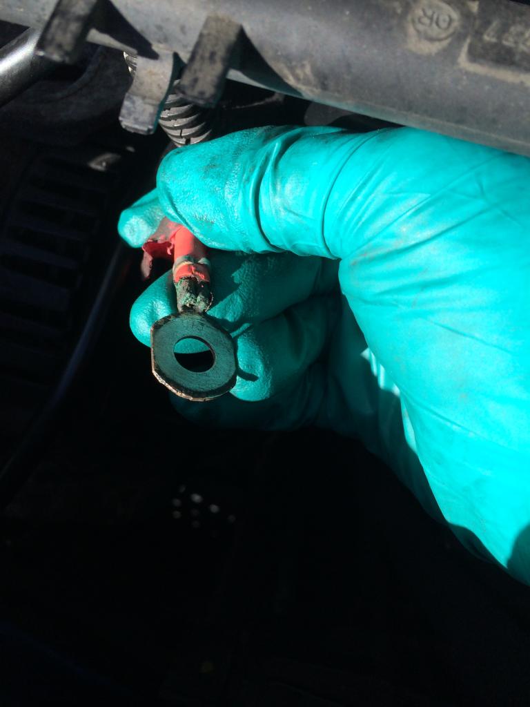

Took the live off the alternator and wire brushed it all and cleaned with WD-40. Still nothing.

check the earths are OK. ie put jump lead from neg to engine hoist hook. your positive looks fairly fucked. could always connect a wire from there to your + terminal also if you want to 100% eliminate wiring.
