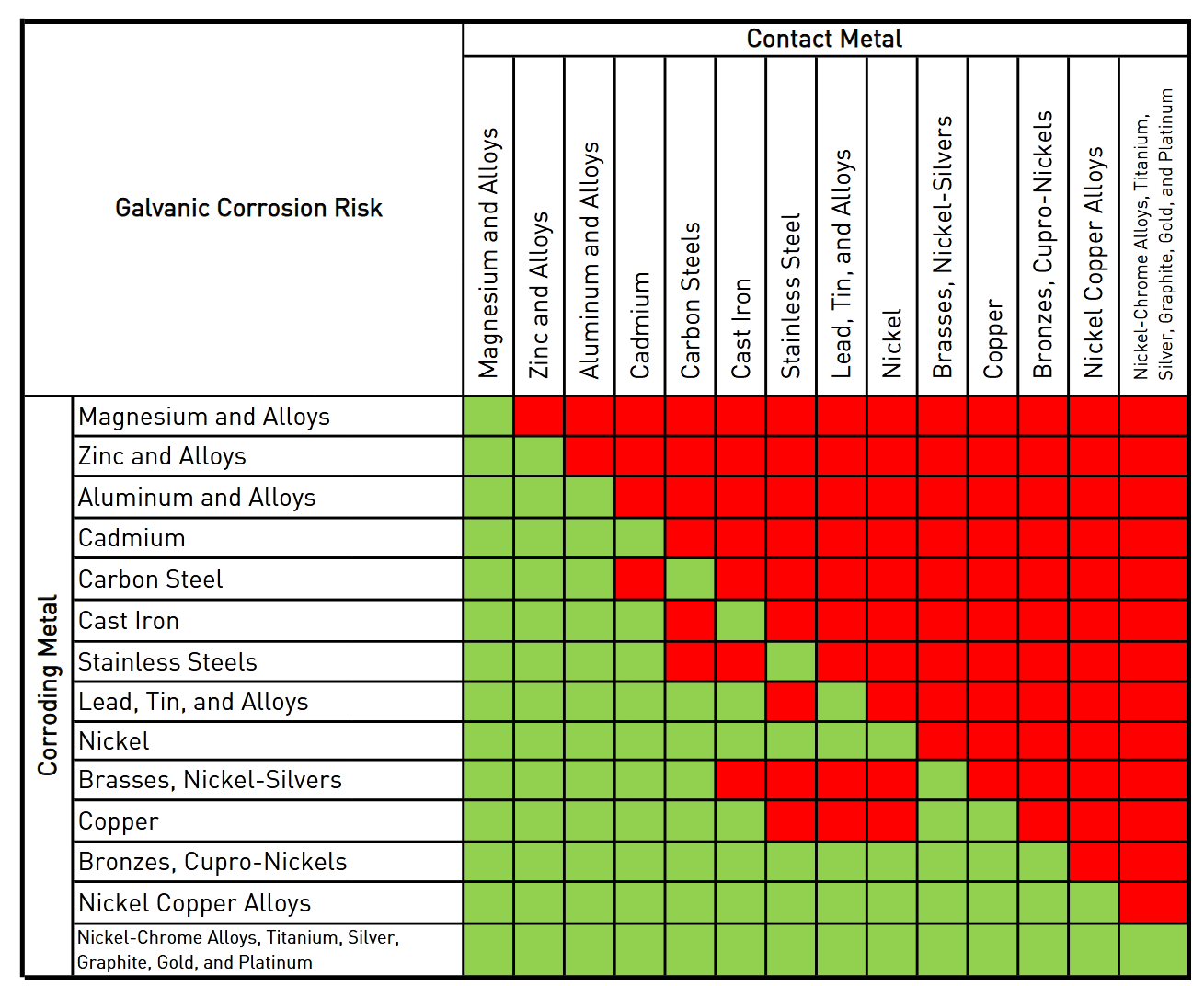

Aluminium can corrode very quickly, it grows a layer of aluminium oxide over its surface which stops further corrosion, but when you use it in an application like this that oxide layer is constantly being damaged which lets it corrode far more quickly. Its also galvanically quite unhappy with its life. Some grades don't play nice with carbon steel while brass is often ok.
Your bushes will likely work fine but may have a short service life and might not be happy with the carbon steel shaft.
