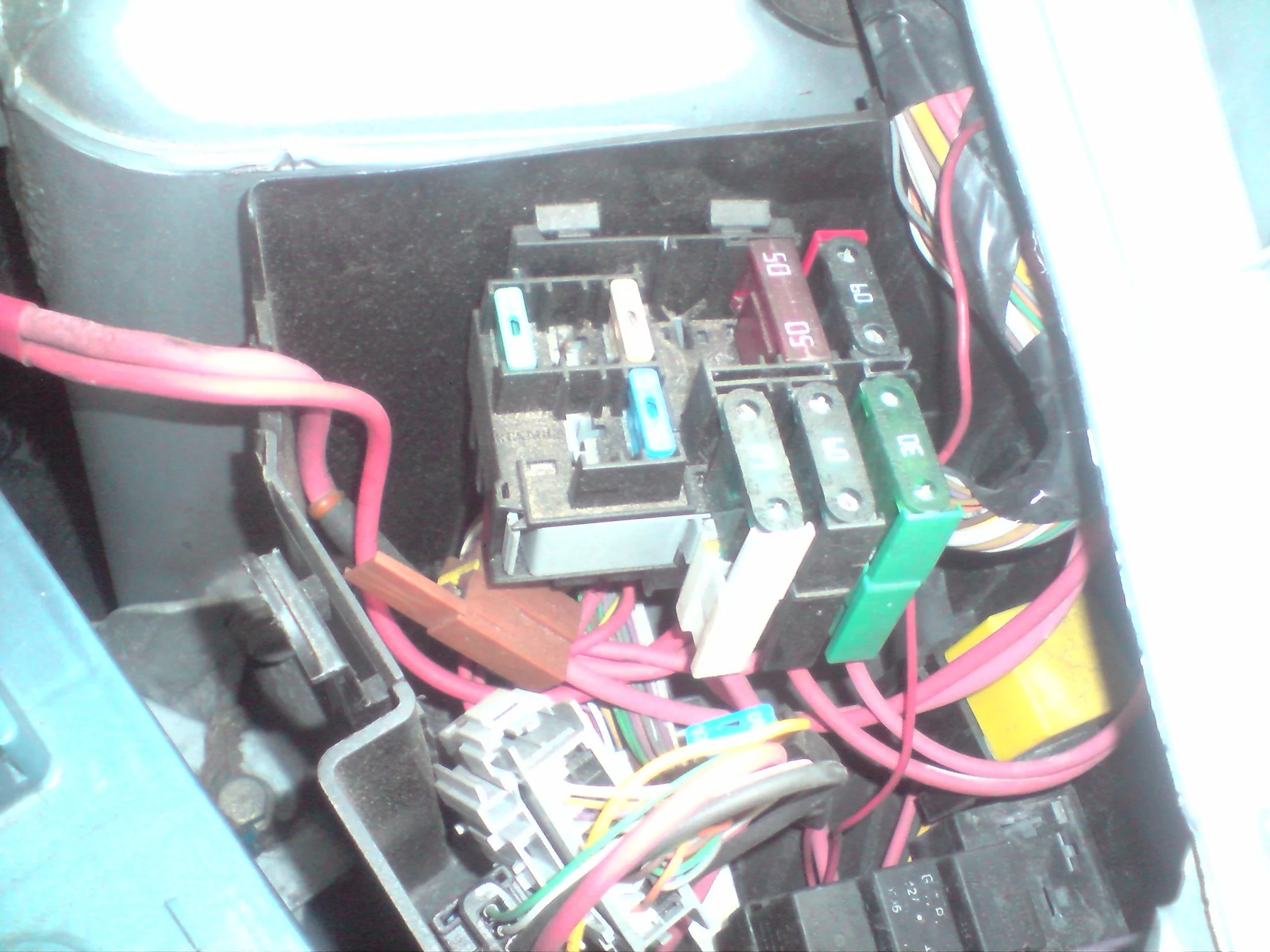

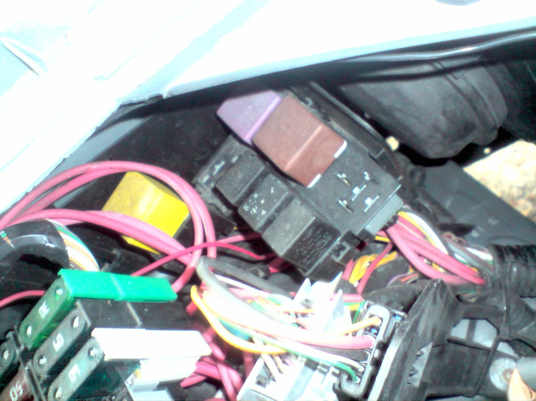

right im not sure as i havn't seen any other clio relay box's before and with a distinct lack of information when it comes to relays and electrical,
i have taken a few pics of the only relay box i can find, i need to know if im missing anything... or if anything is out of place...
im mainly looking for the aircon clutch relay, so please guys point me in the right direction and piont out if anything is wrong or missing

ill get you a pic when i get chance mate but it looks ok to me but let me get a pic for you first
I'll just have a dig through the wiring diagrams, give me a minute i'm sure they're labeled in there.
Its either the purple or brown one, which ever one is a 40A the other is the fuel pump so you'll be able to tell easily enough.
