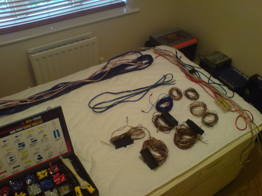

Christopher sold me all his ICE gear last week and was kind enough to include all the cabling and wiring he had.
I've recreated the Krypton factor in my spare bedroom and finally managed to untangle everything and lay it out ready for the weekend.
Going on the basis I'm fitting 2 * Amps, 4 * 13cm speakers and 1 * Sub can you see if anything obvious is missing?
(You may haver to click on the image to expand it)
ymm, i wouldnt use all of them, id probably just use the Wires thats there for the 13cm speaker, then fit the amp(Earth, Live, Remote, + Cable to Sub) and connect it up and should work,
It says QX Connect 10 AWG on it.
Looking on Car Audio Direct that's thicker than most they sell !?!?!
If your running two amps then that power cable is no good. couldnt power a pocket torch!
How can you make such a sweeping statement?
If they are 2 50w amps I'm sure that would be fine. If they were 2 1000w amps then I'd agree a thicker gauge would be required.
what power amps are you using? most amps have bullshit power figures on them so tell us what size fuses it has in it as this is usually a better way of telling what power cheaper amps actually are.
we'll then be able to reccomend a power wire that u'll need.
also we'd need to know if it was 2 subs on 2 amps or 1 sub on one amp components on the 2nd etc
