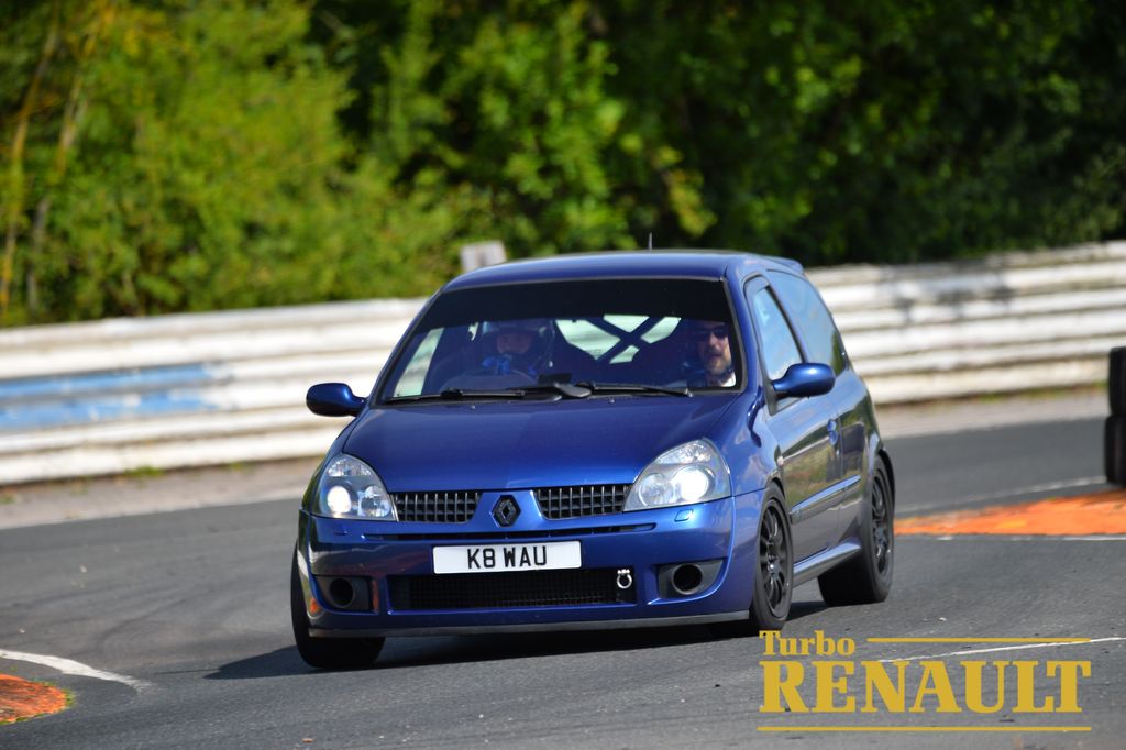

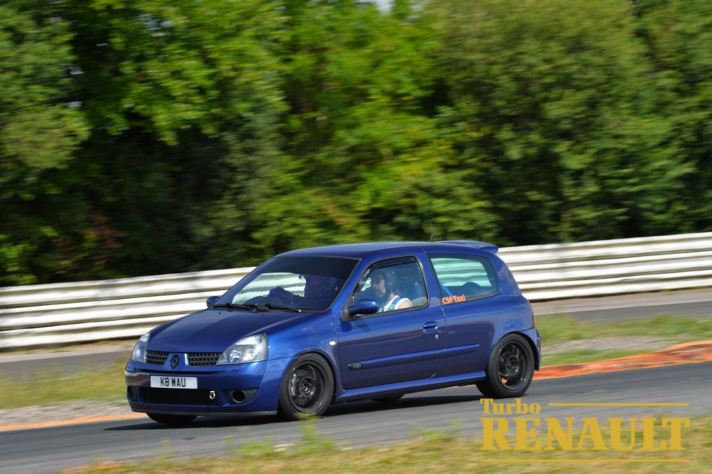

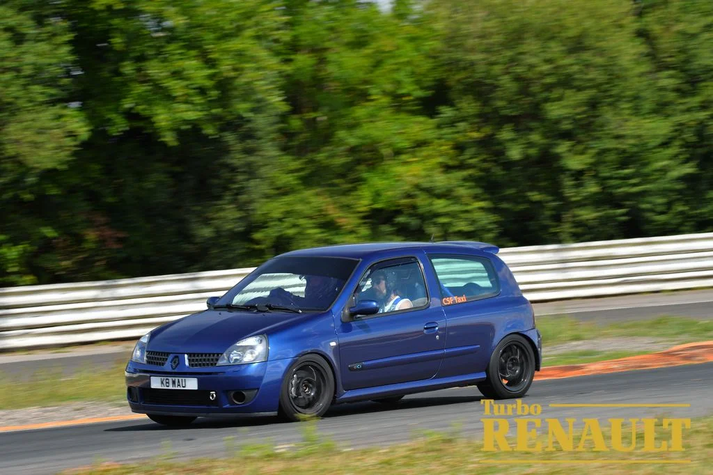

My track car has Grams springs (I previously had Cookspoet which were slightly crashy and also snapped) and cup shocks, black polybushes, solid top mounts with a brace, quaife diff, roll centre hubs and a rear ARB
It's immense. Yeah I could put some ASTs on there at like £1500 but tbh the shocks and springs are spot on

How was the car without the roll center hubs?
What rubber are you running on those OZ F1's? (I'm trying to decide between AR-1's and PS3's for my use)

The Cooksport were only harsh on the road, on track they were fine. The grams are just ever so slightly better
I upgraded a lot of stuff at once this summer so before the car was pretty okay with just cup shocks, grams springs and upgraded bushes and mounts, it was fine on track. But adding roll centre hubs really transforms the car, you can really really push it into corners without having to correct the steering every single millisecond and the car doesn't want to throw you into the nearest ditch. Add on top the Quaife LSD and its just a totally different car. It just depends how long your arms are and how deep your pockets go🤣
Track wheels I have 205/50/15 AR-1 and then I have some 2118 with 195/50/15 PS3 on
