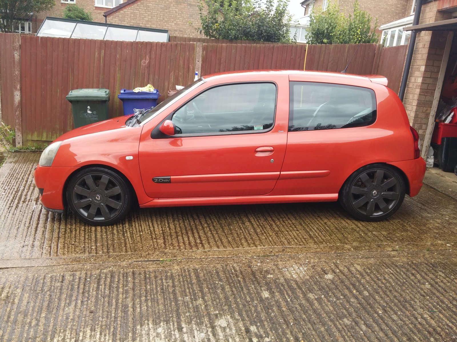

All fitted and......not impressed lol
Not as low as I'd hoped, fairly sure Apex gives more of a drop from photos I've seen? Guess they may settle a bit

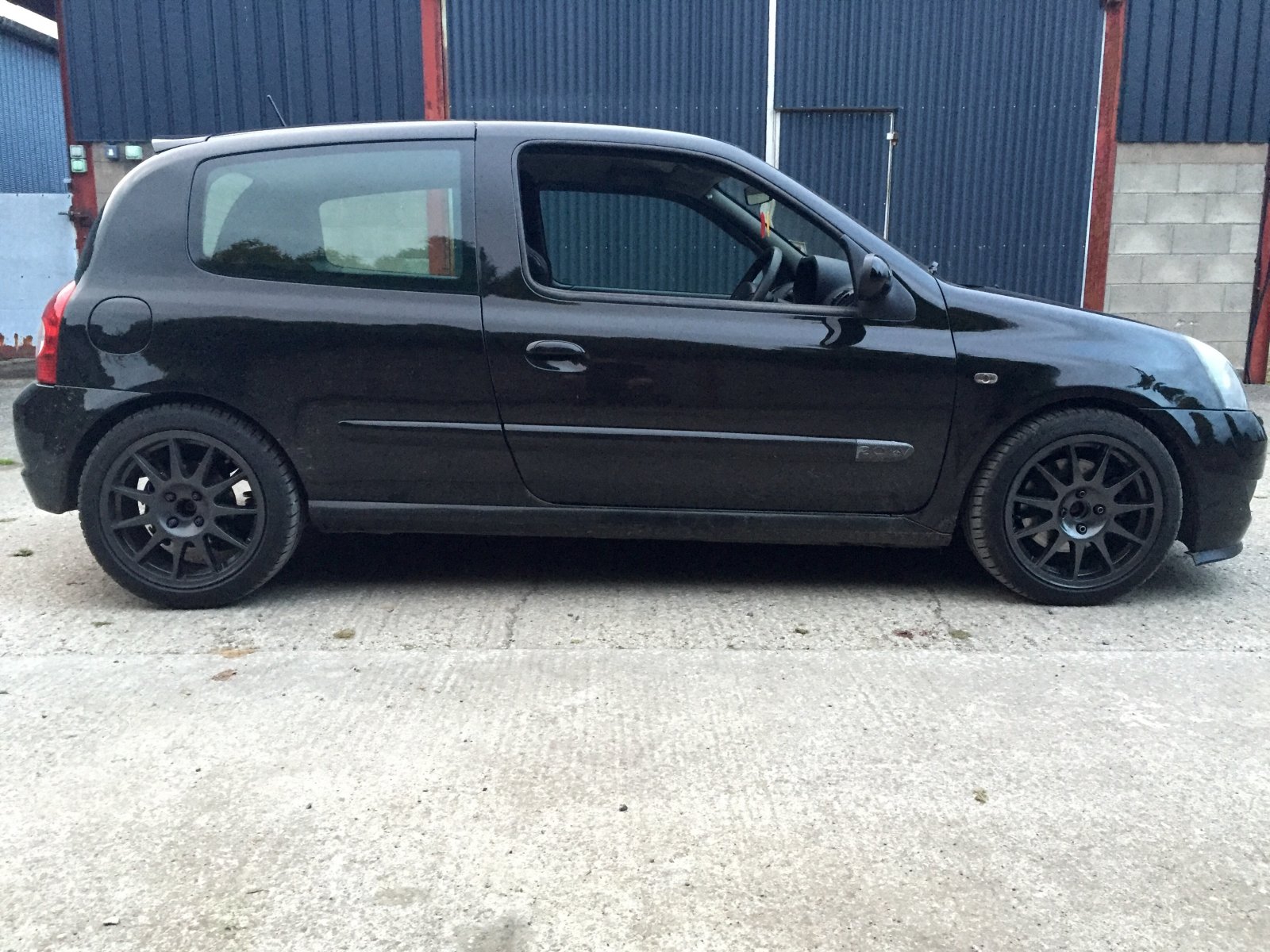

Disappointingly I think my Cooksports give the same drop, but then they have had plenty of time to settle
(Don't have an actual side on photo with Cooksports to compare which is a tad annoying)

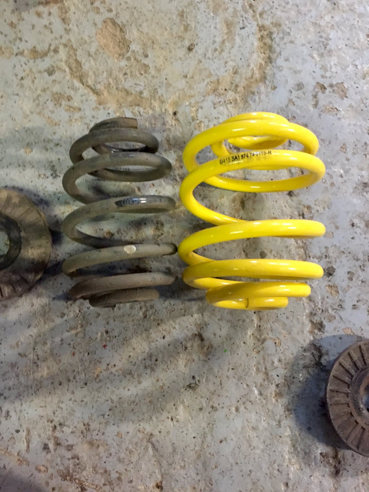

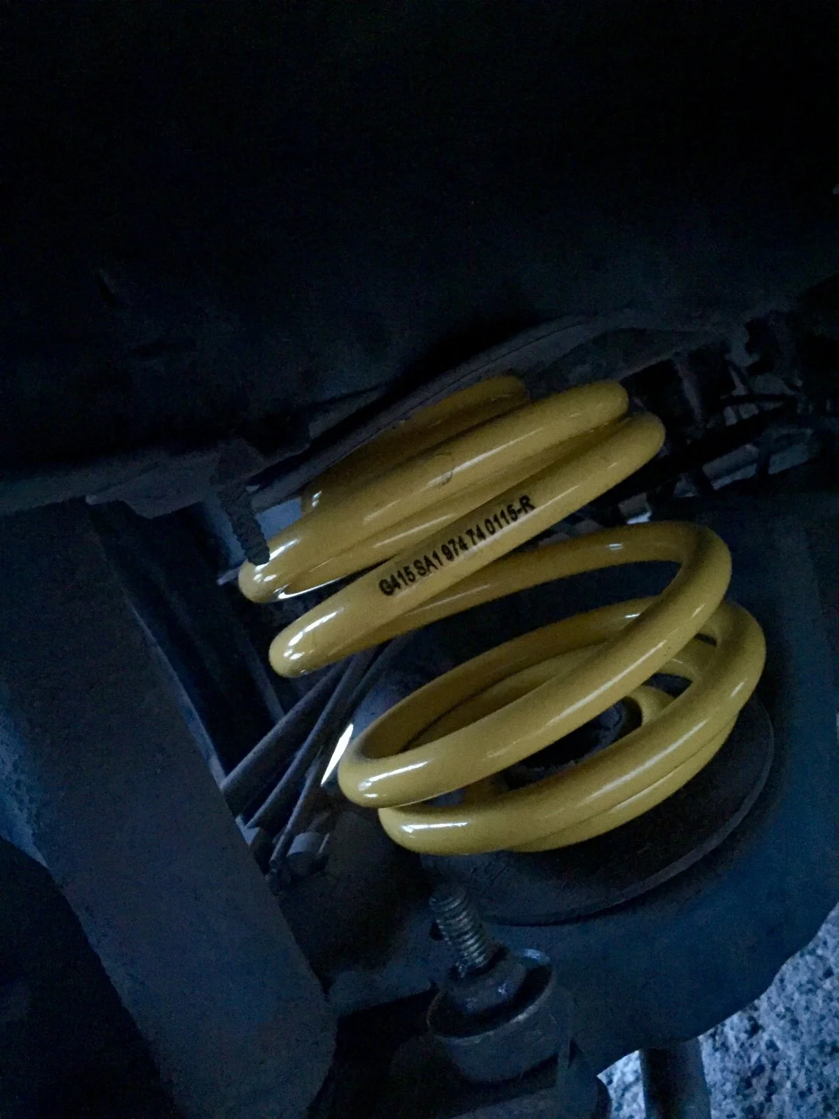

So had a look underneath and...
I'm fairly sure a couple of the coils are hitting each other...not good at all! Would explain the noise I'm getting
I actually went to the effort of taking them back off and fitting them the other way around (text upside down) and went for another quick little drive (couple of miles) and it does seem a lot better (although it did do it once)

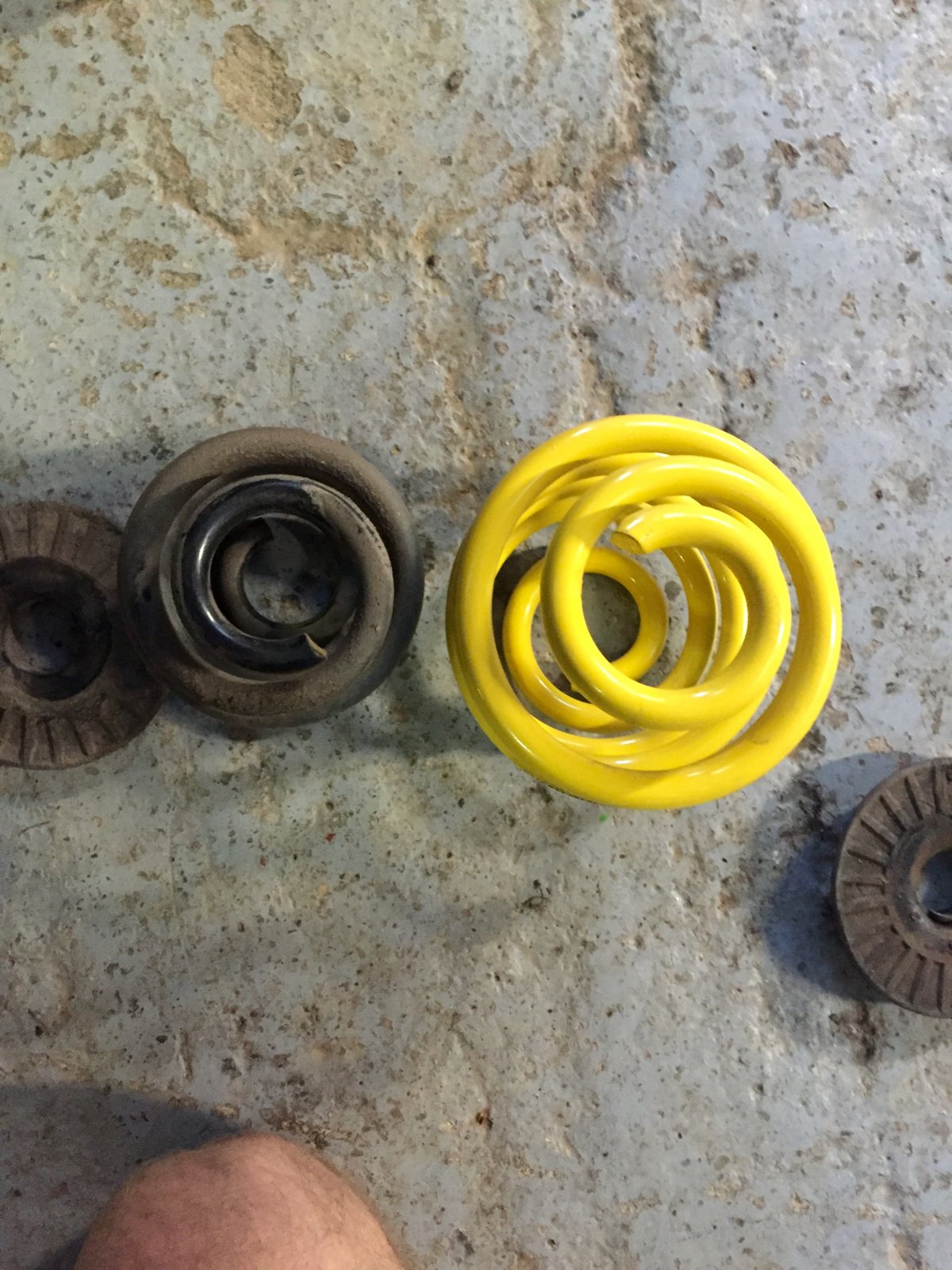

Compared to my Cooksports, the read springs are massive!

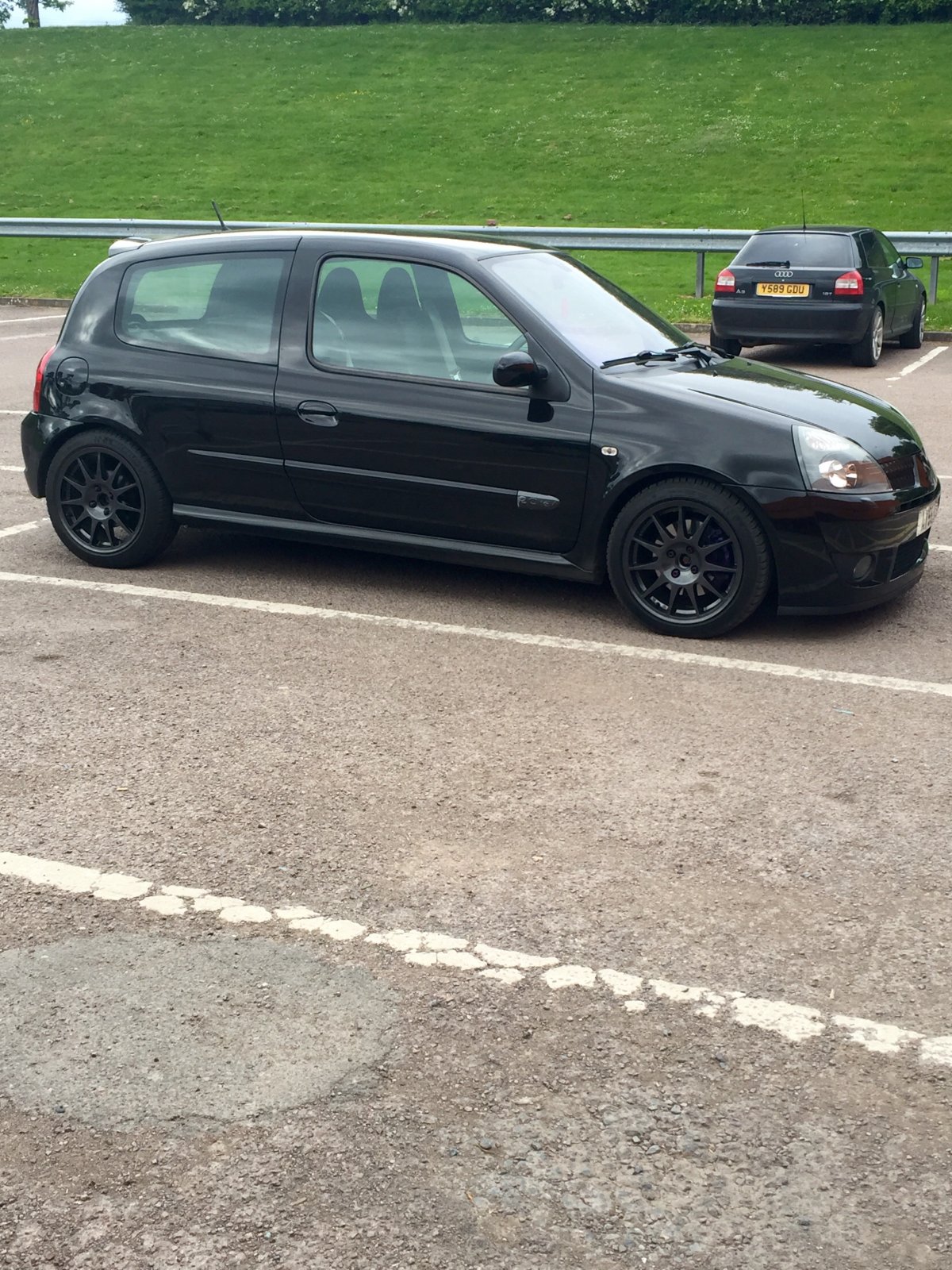

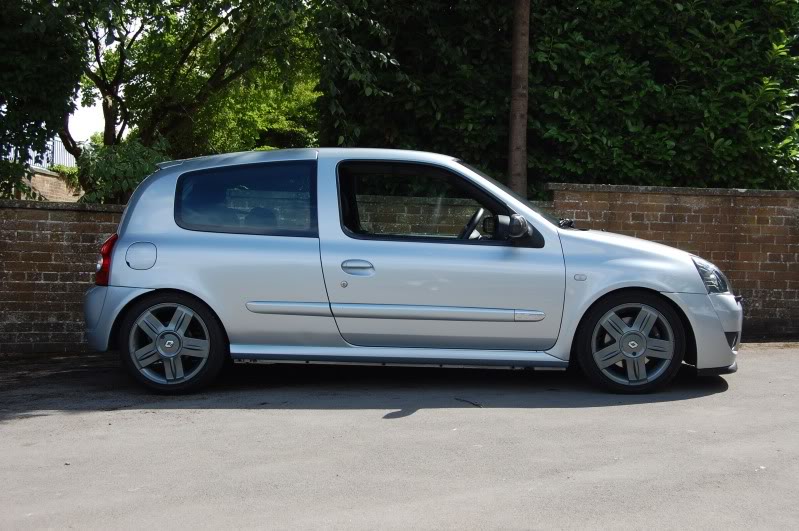

And in comparison, these are all on Apex Springs I grabbed off Google :
Virtually no arch gap at all! If you look at mine on the rear in comparison there's a huge difference....and I can't see it settling that much (especially as I can see me taking them off in 24 hours)

On the plus side, they do seem to have of settled a little bit and do look lower than my Cooksports - stance/height does look good actually!

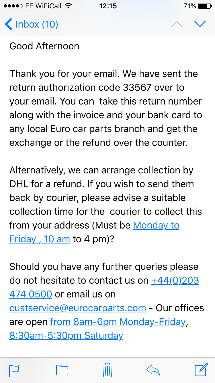

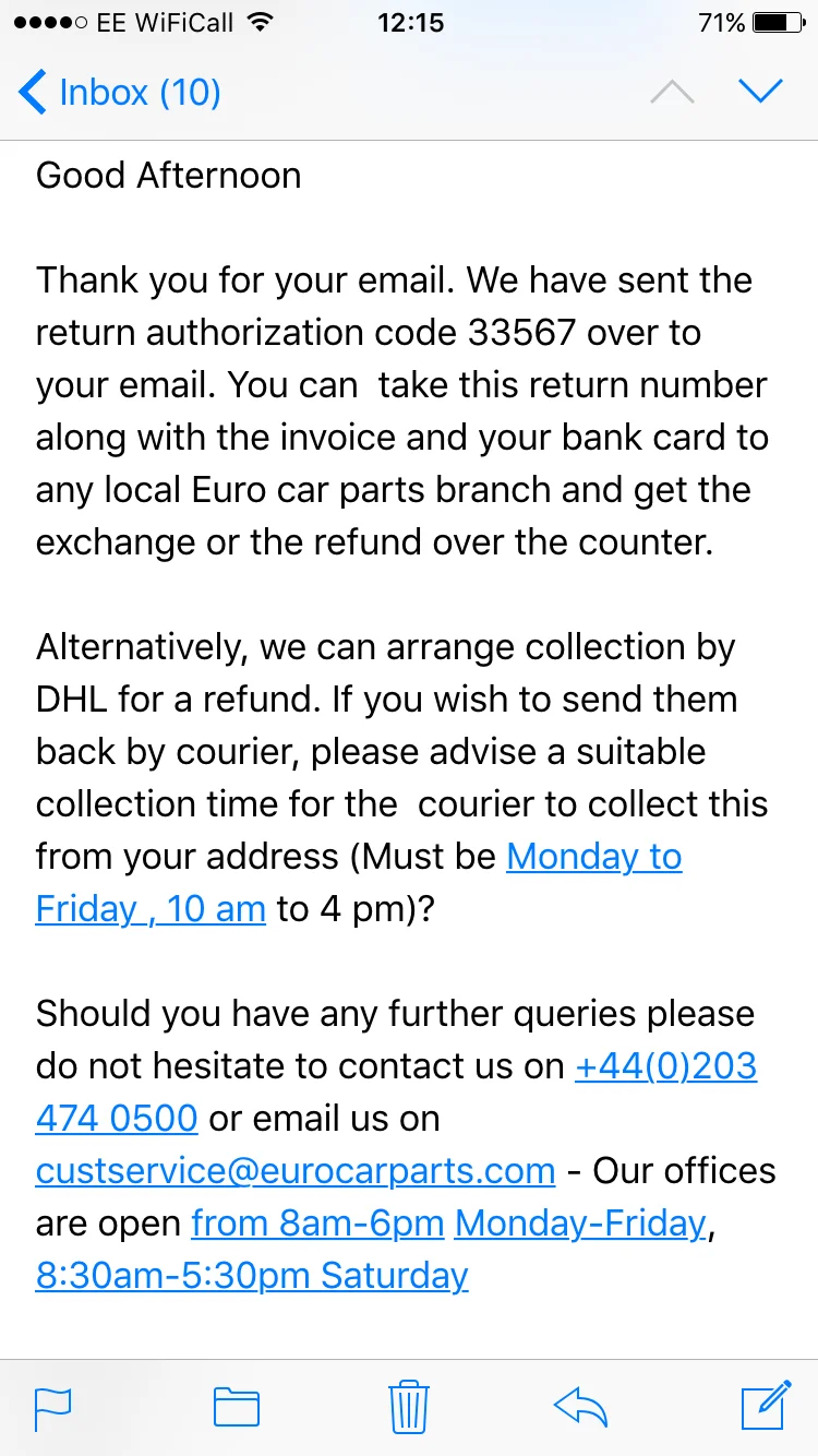

Sent them an email this morning saying how I thought they were unsafe, with the faults and a couple of images
Had a reply half an hour later saying they'll either send a courier to pick them up, or if I drop them at my local branch, they'll give me a full refund
So hats off to ECP for their service, just a shame the springs are rubbish lol
