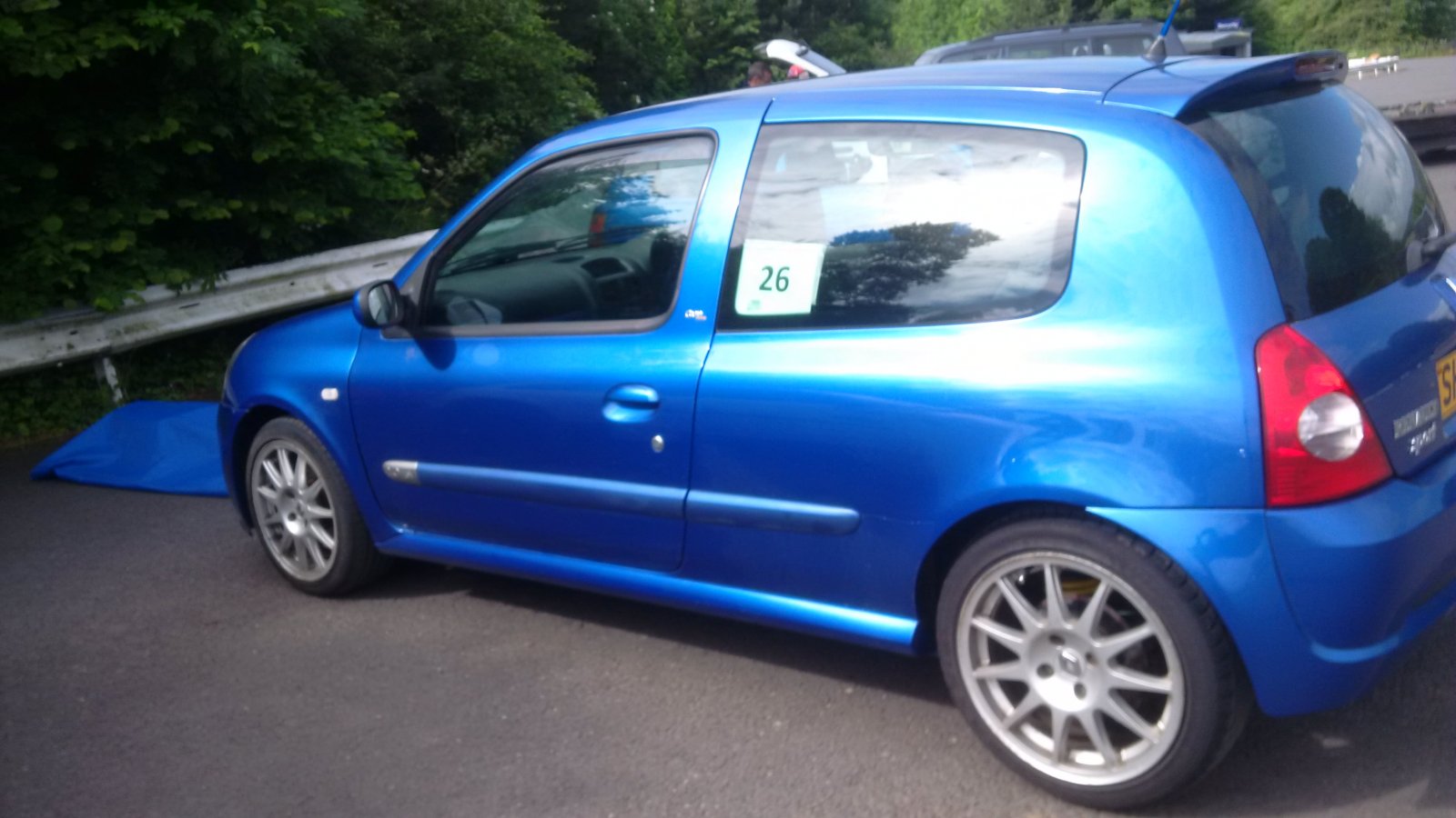

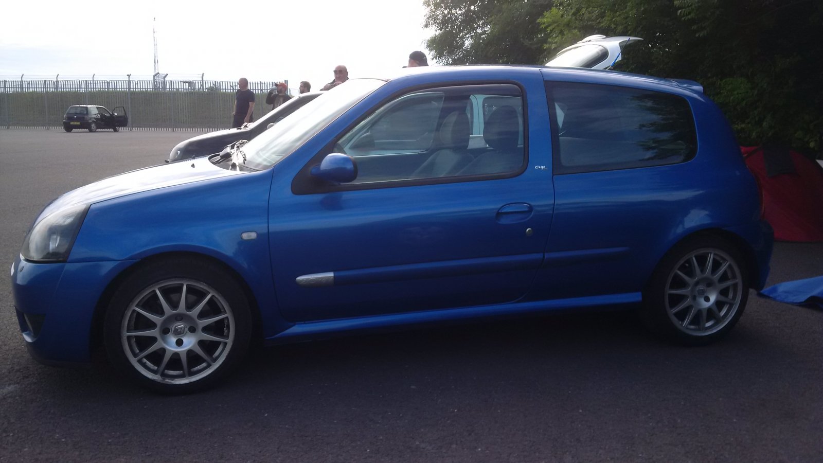

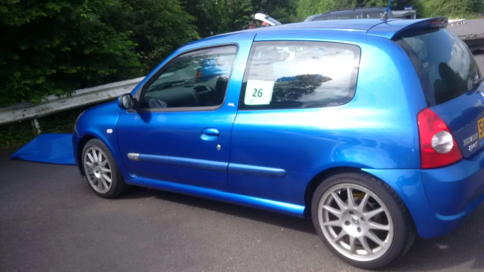

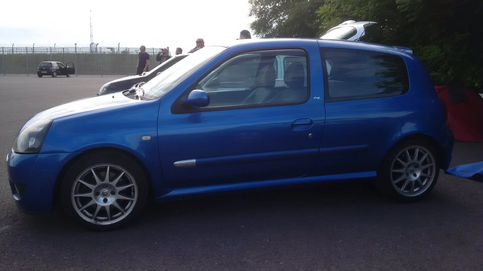

Right I have now down 250 miles of part motorway,part town including many speed bumps,a lot of motorway, and an Autosolo event .The arch gaps are about the same as a fellow autosoloer,s.172 on Eibach Prolines. I have no complaints so far concerning ride or handling.

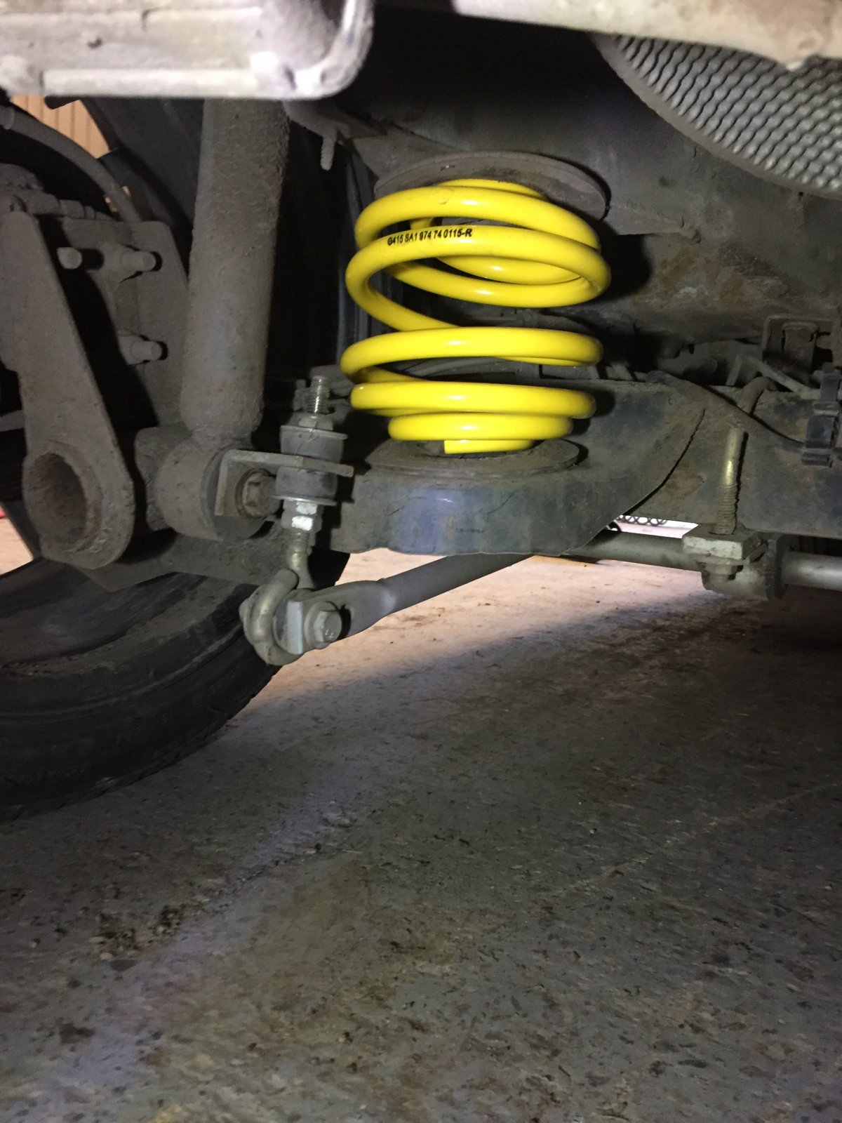

My car on A-max springs
What did you have before as a handling comparison?

  Cio 172 Cup,Porsche
I was comparing the A-Max to the standard Cup springs, and I have Cup shockers. My Clio is an occasional use toy, not my DD.
