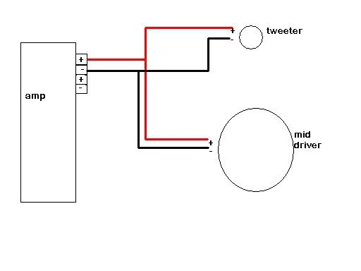

Given that the tweeters have built in crossovers how exactly would I go about amping them and the mids? I currently have a 4 channel amp to power both the fronts and the rears. The rear coaxials are no problem to amp but the front compenents I have no idea about?!
You simply connect both tweeter & mid driver in parallel from each side to one amplifier channel, so the right amp channel drives the right mid driver & right tweeter....
Each side should look something like this;
