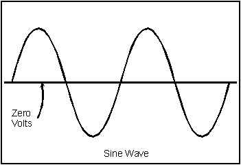

the maximum power an amplifier can make with very little distortion is dependant on the voltage rails, if the gain i set incorrectly (read - too high for the input voltage) then the amp will try to make a sine wave beyone the capabilitys of the max voltage that the rails can produce
for example, the voltage rails are +16v and -16v, so giving 32v, if you then turn up the amp gain past the point where 32v is made, then it will still try to make the sinewave, it will just look like a wave with a flat top, and the power of the sinewave will be greater than that of a clean signal, ie the area under the wave will be larger
the above is a clean sinewave

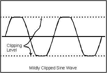

mild clipping, even this would raise power by a good chunk (the dots would represent the voltage i described of the power rails in the amp
