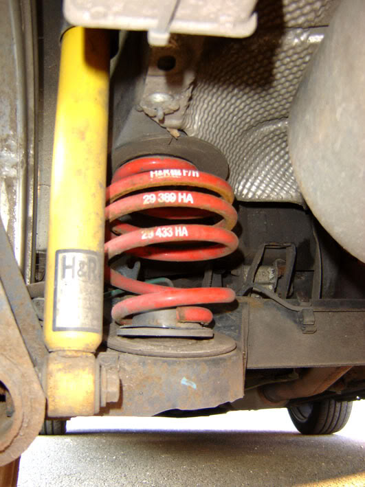

I want to get some slightly stiffer rear springs for my cup, sat on H&R coilovers. I don;t want uber stiff but something stiffer than what I have would be fine.
Took a pic of the exsisting ones but it's all chinese to me :S
Anyone know what they are, and obviously what would be a good rate to go for for a stiffer setup?

your platform looks wonky.

There the H and R part numbers not poundage.
Take a spring off and ask Demon Tweeks if they'll put it on there machine and tell you how hard they are.
like edde said, H&R part numbers on the back
fronts are 70N/mm or 400lbs/inch
I was looking at Dacia Logan Cup setup which uses 60N/mm front and 100N/mm rear and probably fits our clios
