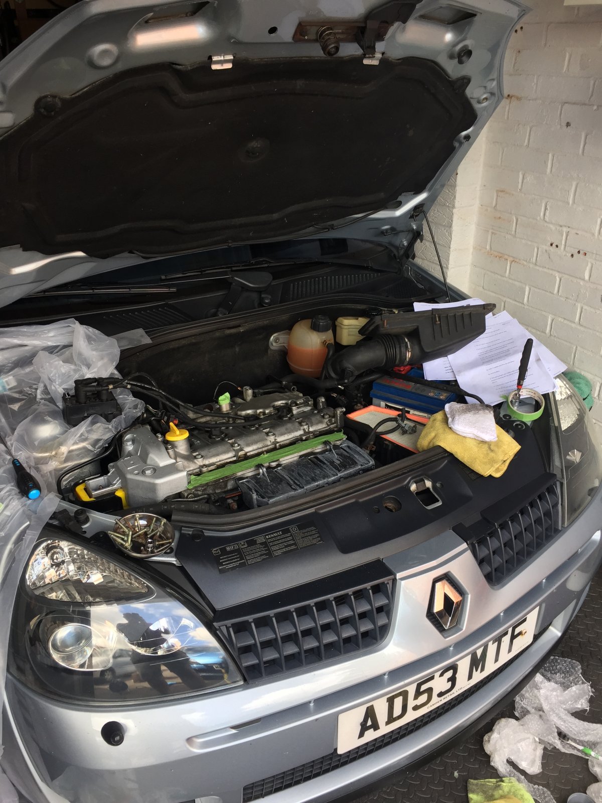

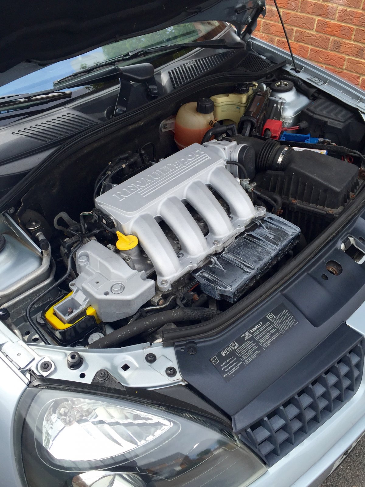

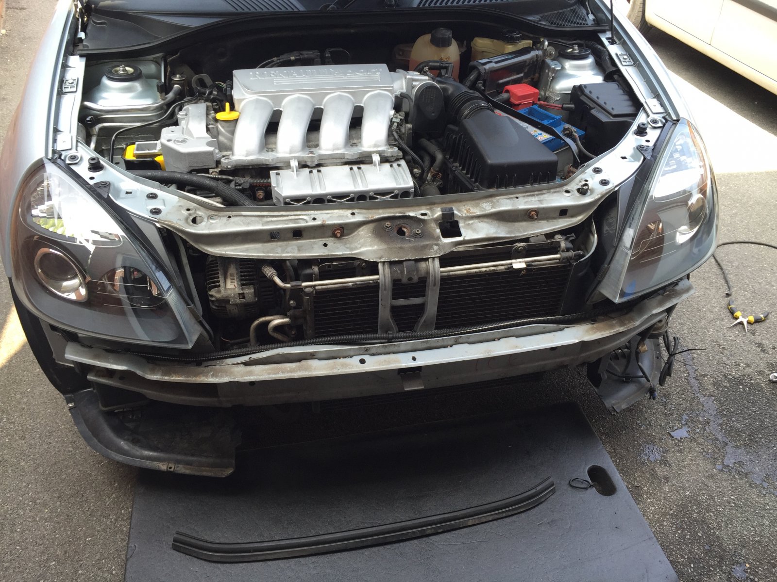

Do u mind me asking what methods u used to prep and paint the inlet manifold?
Cleaned with brake cleaner and a brush, left to air dry and then painted straight on with VHT aluminium. Mist coat then 2 wet coats. Lettering was done with Humbrol enamel and it'll get a couple of coats of VHT clear.

Small steps. Nasty yellow inlet manifold is gone. Tit of a job after the replacement manifold was missing the connector for the servo vacuum hose.

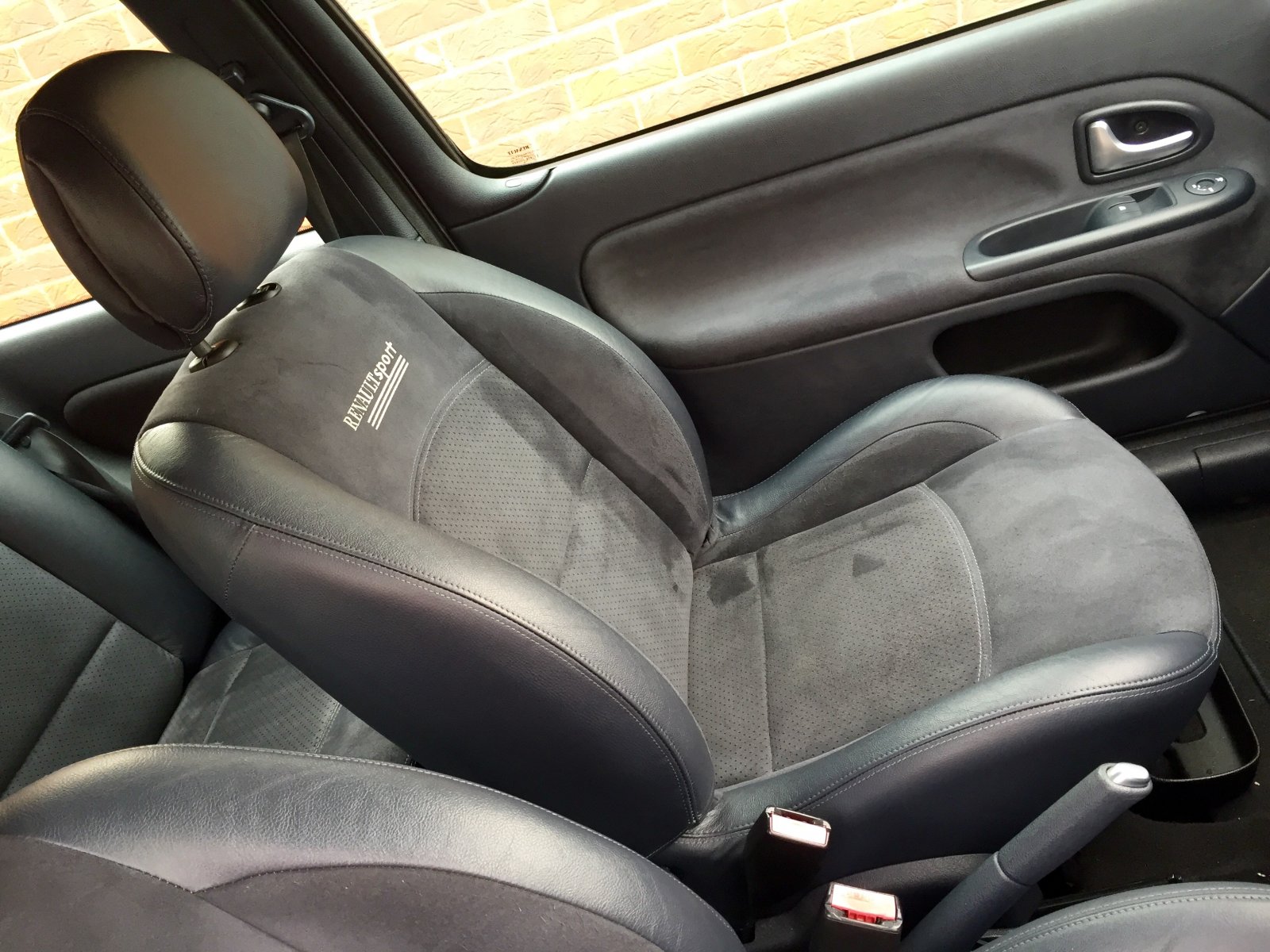

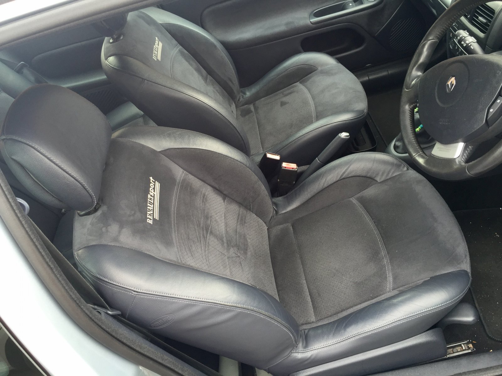

Gave the Colourlock products a run out too on my seats and finished with a quick wash and Zaino Z8.
Still a long way to go!

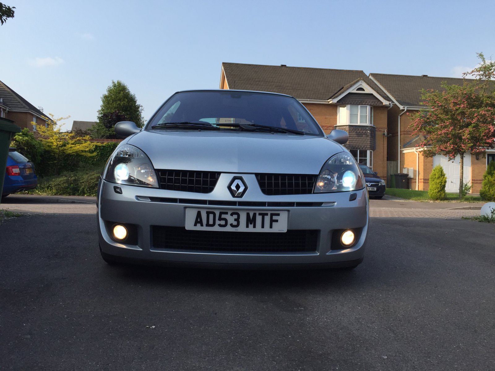

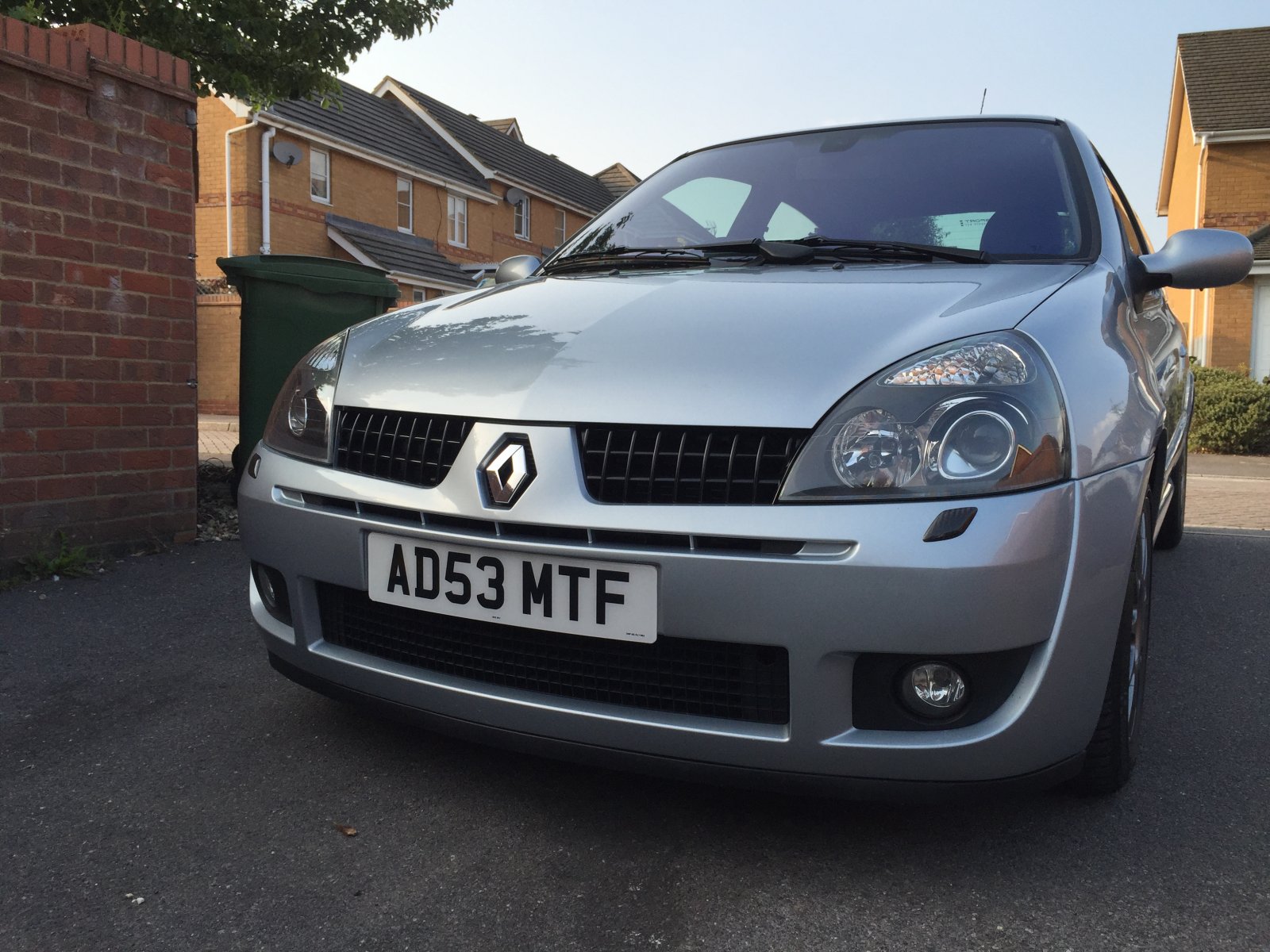

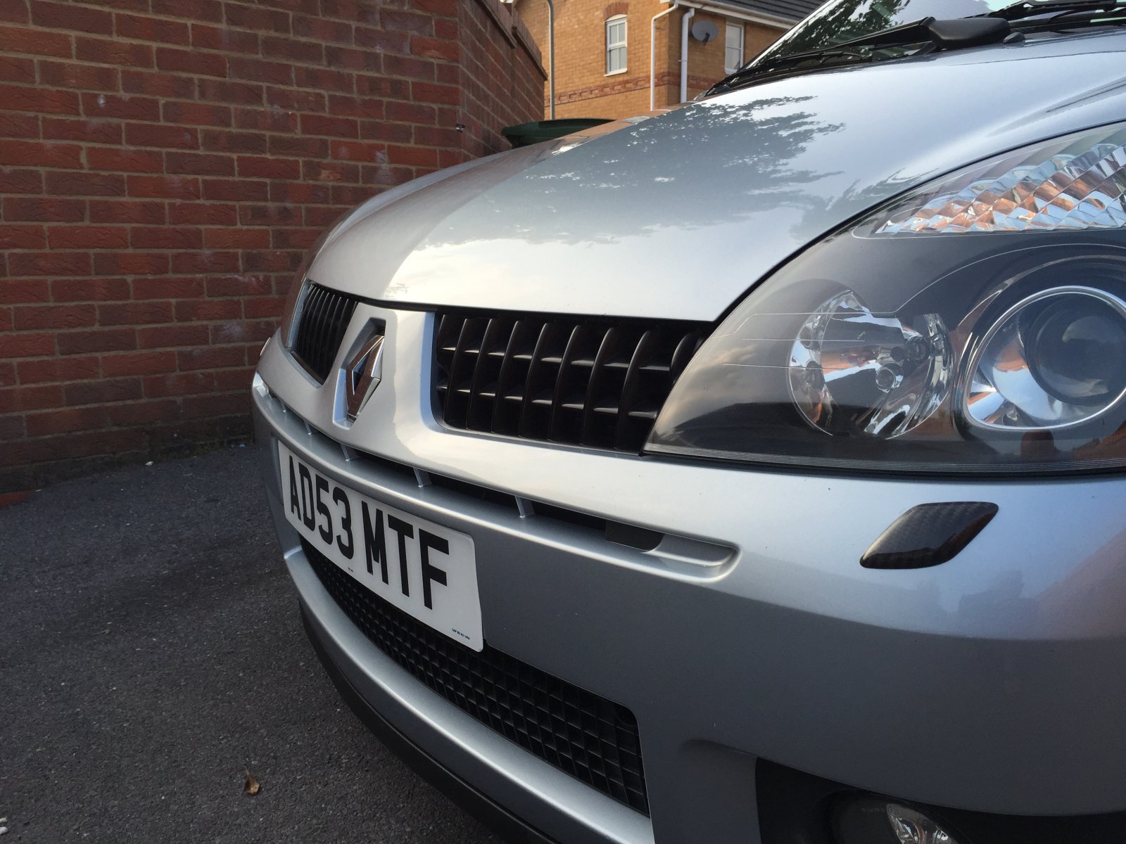

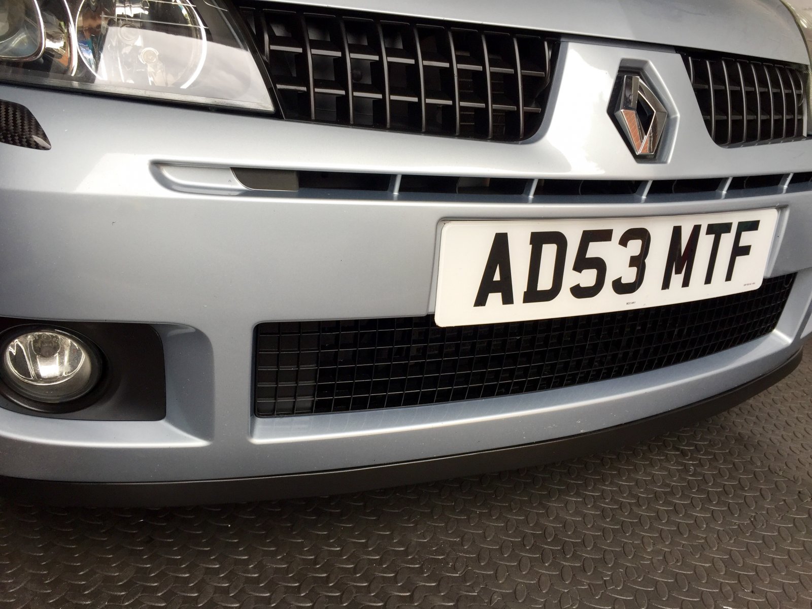

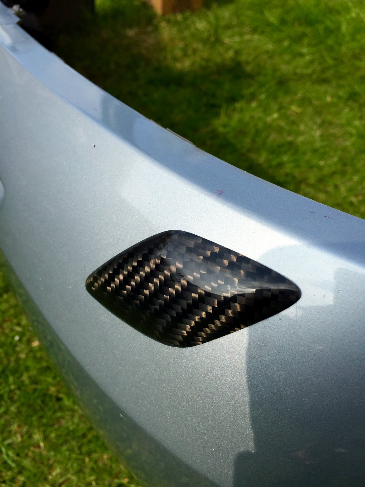

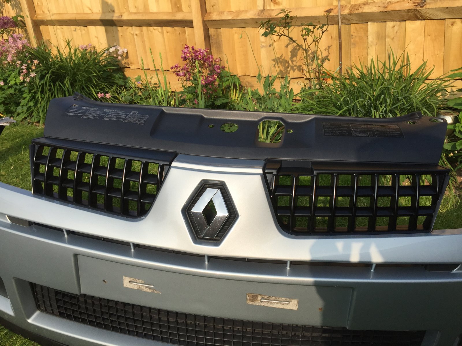

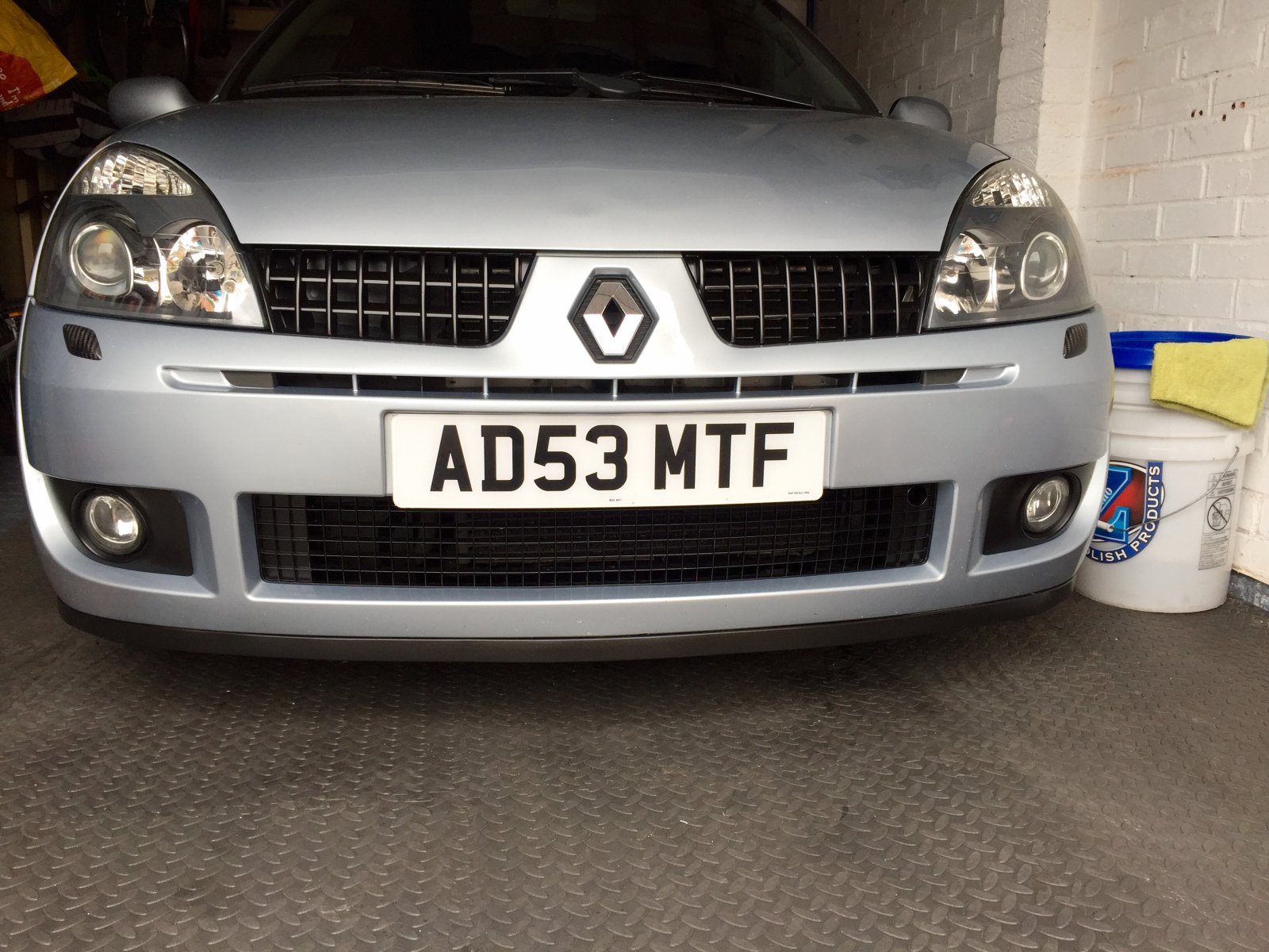

More little steps. CF blanks on and upper grille painted satin black. New front plate on too. Calipers next.
And foglights reconnected - they hadn't worked since I got the car. Simple (and free!) fixes make me a happy boy.

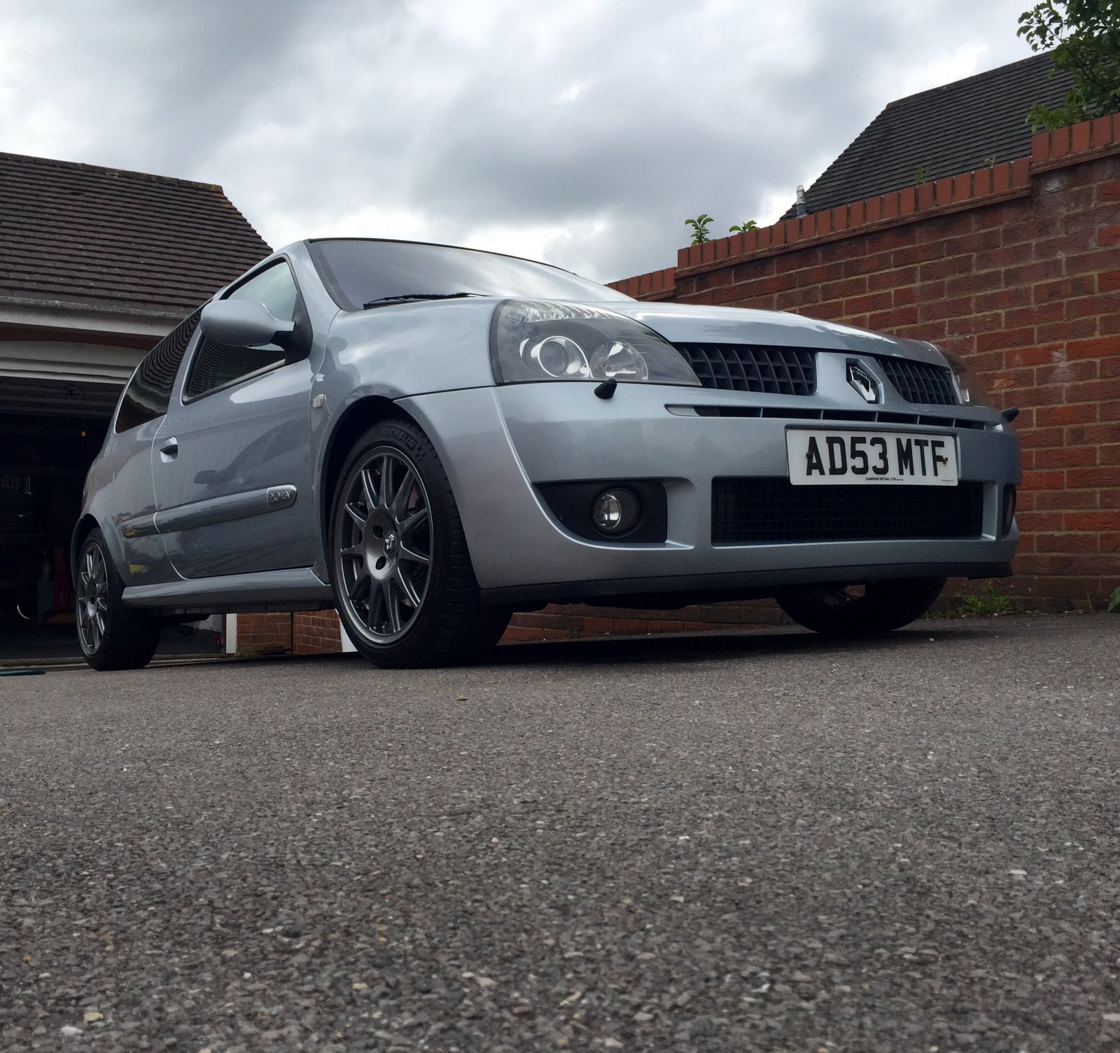

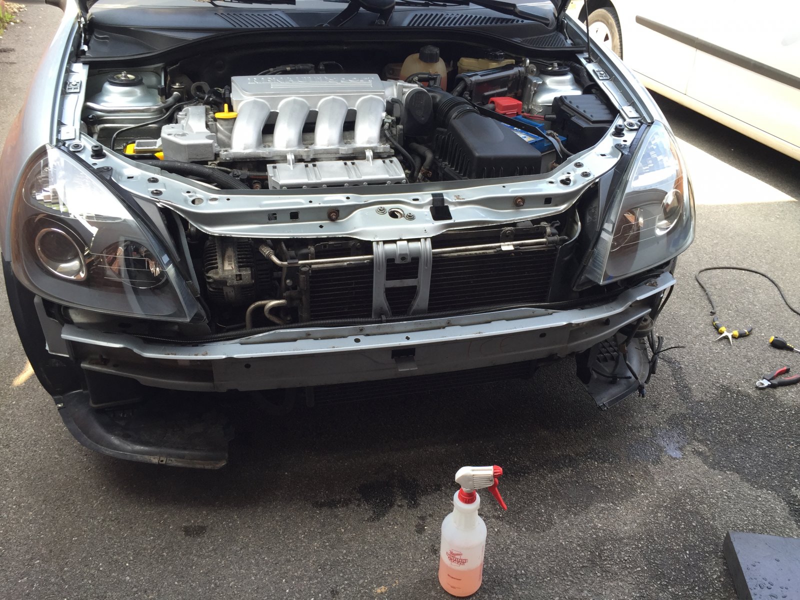

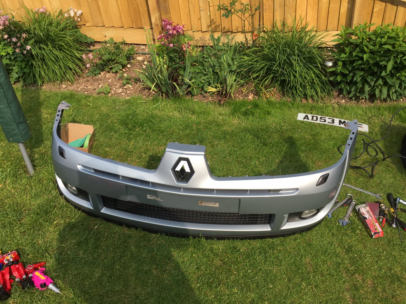

Lower grille and fog surrounds given a lock of paint today. Trim dressing was never going to match lol.
And here's a question - I snipped a pair of cables ties when I took the bumper off. They were in the middle and securing the bumper onto (I think) the subframe. Should there be a more permanent and proper fixing point? There's holes in the bumper at the back which seem to pair up to holes in the subframe.
andy_coops
  172, VRS, Clio 5
Pretty easy TBH - hardest part was removal without breaking any clips etc.
Thoroughly cleaned using an APC. Then a light key with wet & dry. Then a degreaser (I used a cleaner I use after polishing - seems to work).
Mist coat of either plastic primer or in my case bumper paint as more flexible I've found.
Allow to dry then a mist coat of satin black followed by 2-3 heavier coats but still light to avoid runs etc.
Leave to dry, refit and job done.

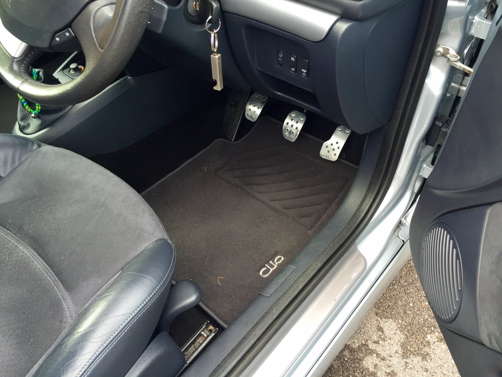

Few small updates today. Oil and filter change , powerflex dog bone mount fitted and expression mats, um, installed lol.

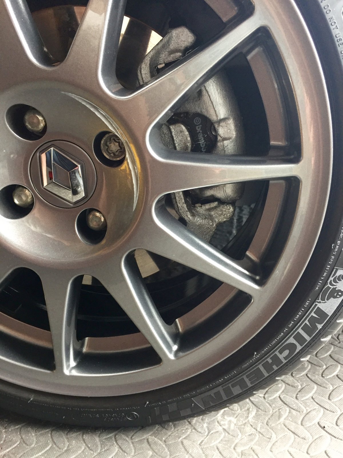

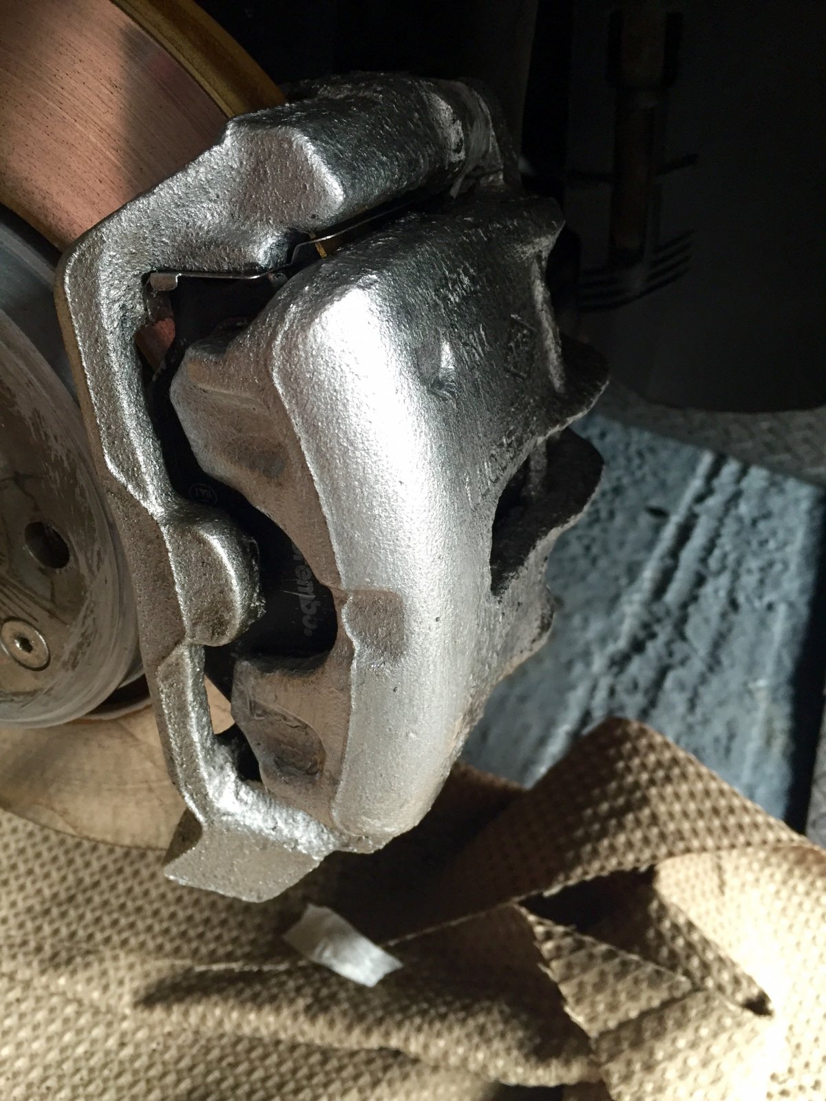

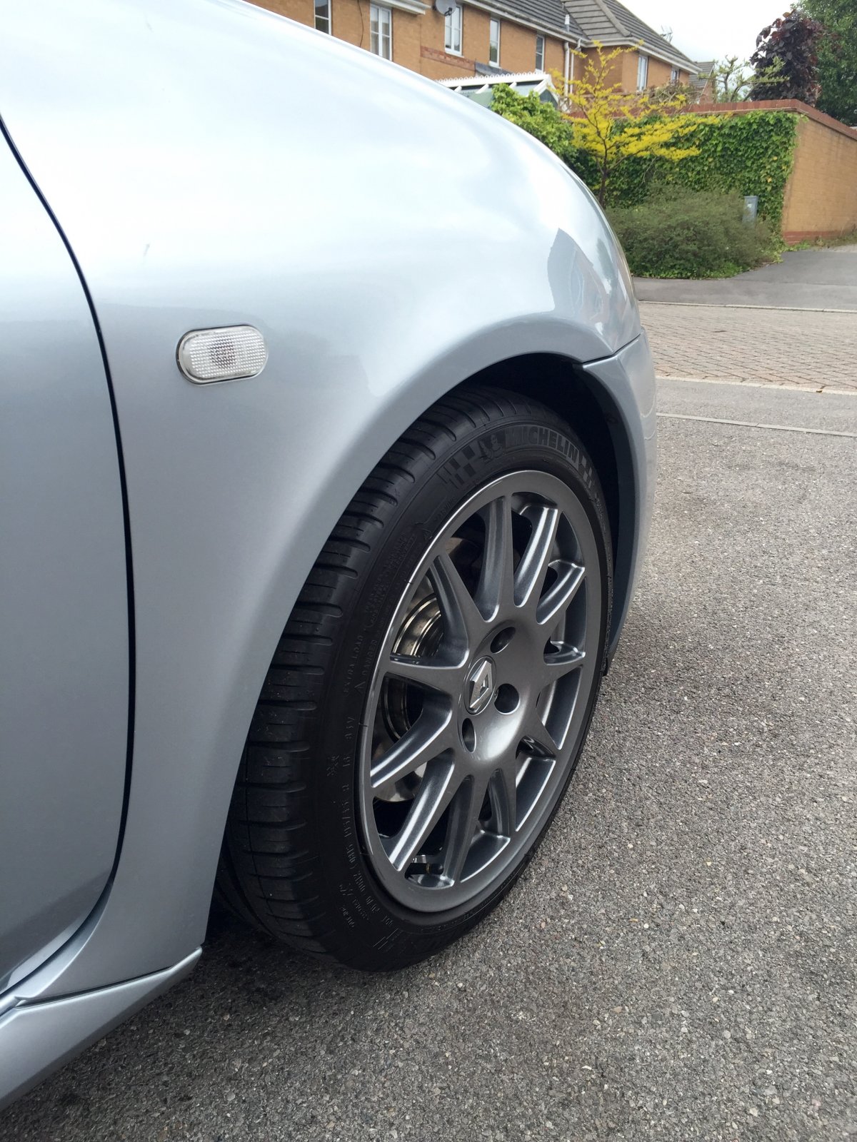

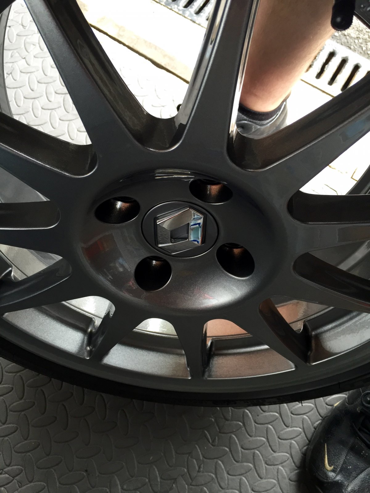

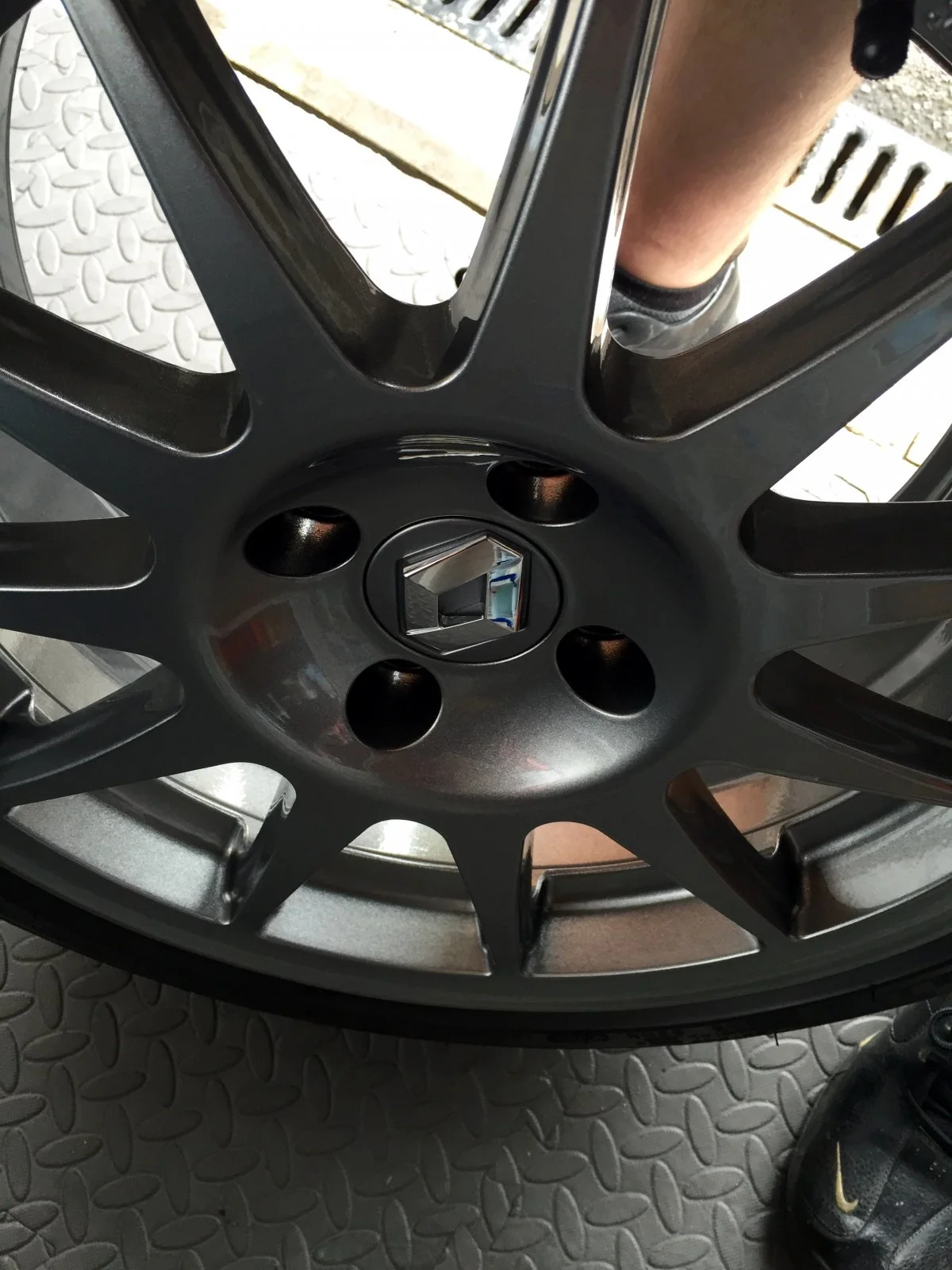

Calipers and hubs painted and all bumper screws replaced with new. Have the wheels their 4th coat of Exo too - only mint paint on the car so they're getting protected lol.
Had expert help too so all torqued up properly etc ;)

VERY interested to see the silver painted callipers as half thinking of doing mine the same colour. We shall see!

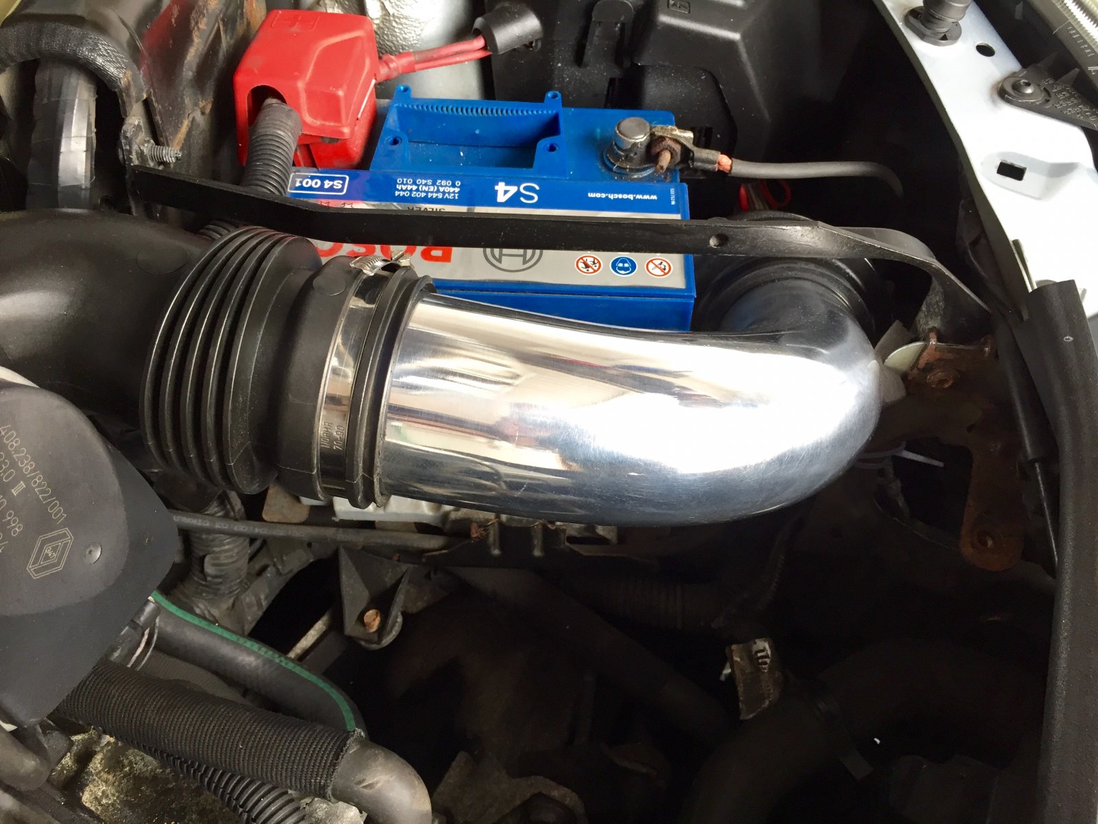

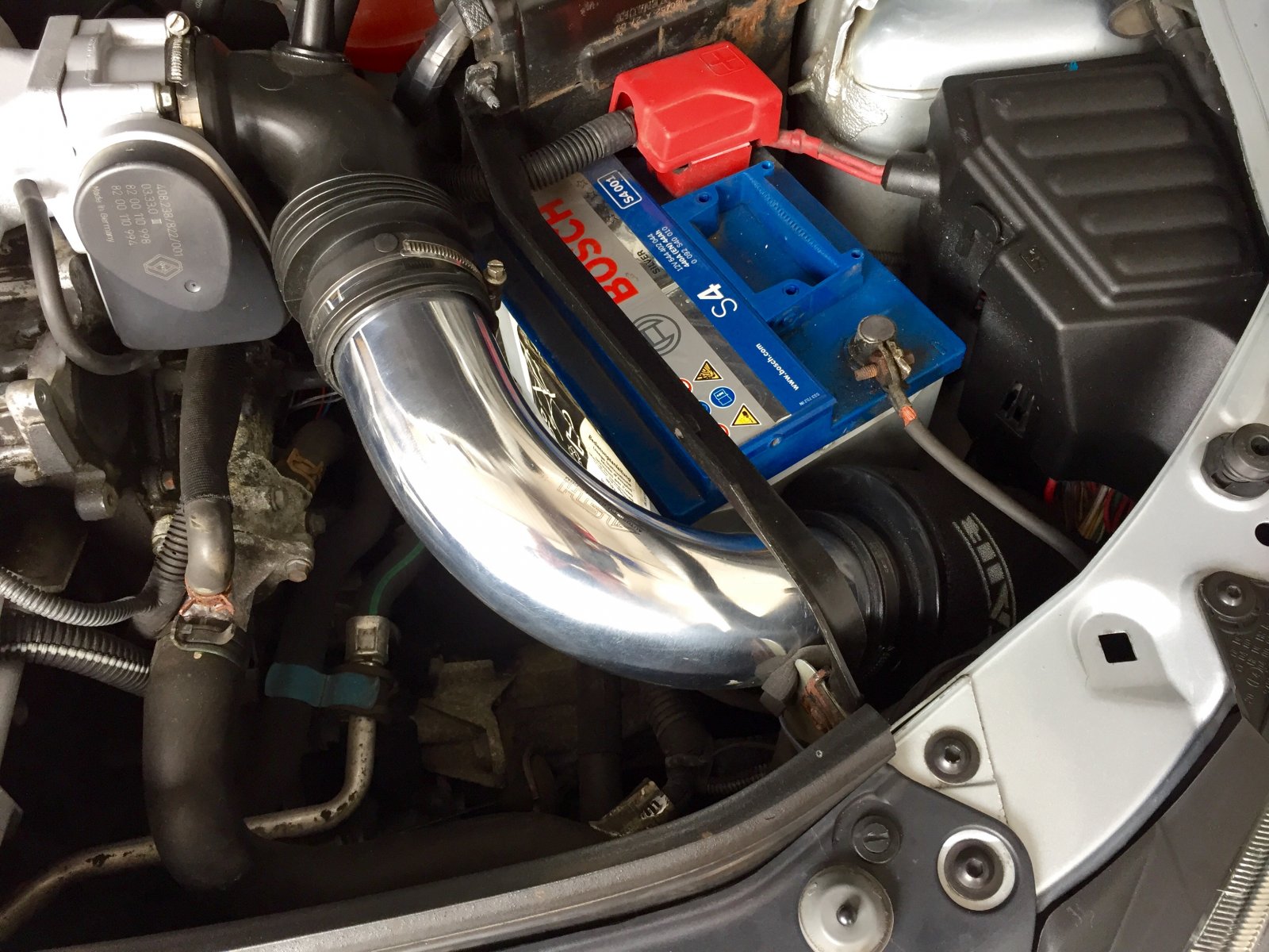

Fatty kit fitted. Genuinely no idea whether this adds or loses any bhp's but I don't care. It sounds bloody lovely.
Lots of cleaning to be done to tidy up that area previously hidden under the airbox.

That looks a tidy install :up: I've just bought a black Samco induction hose for mine, one would finish the fatty off nicely on yours *imo* :blush:
I'm debating painting my elbow pipe black - I'm going to see if I can live with the bling first lol.

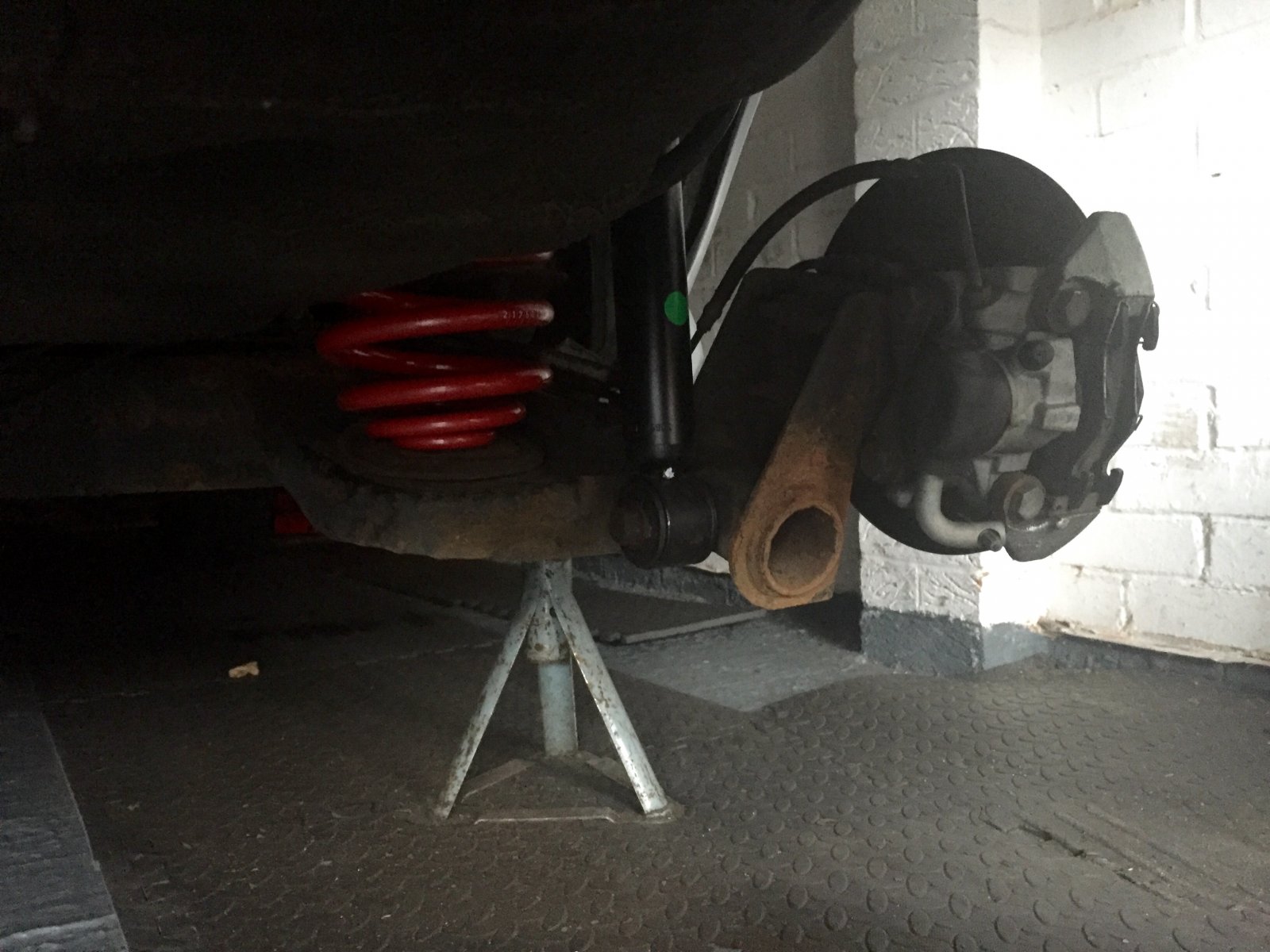

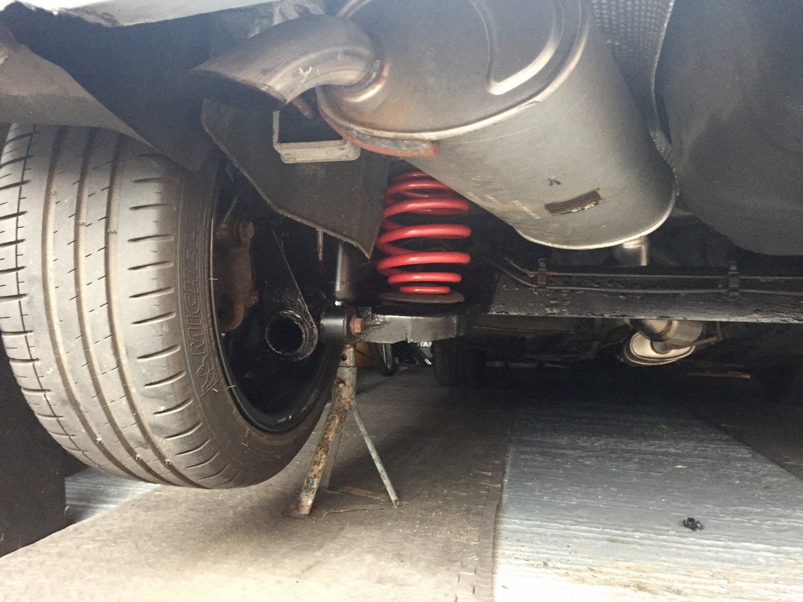

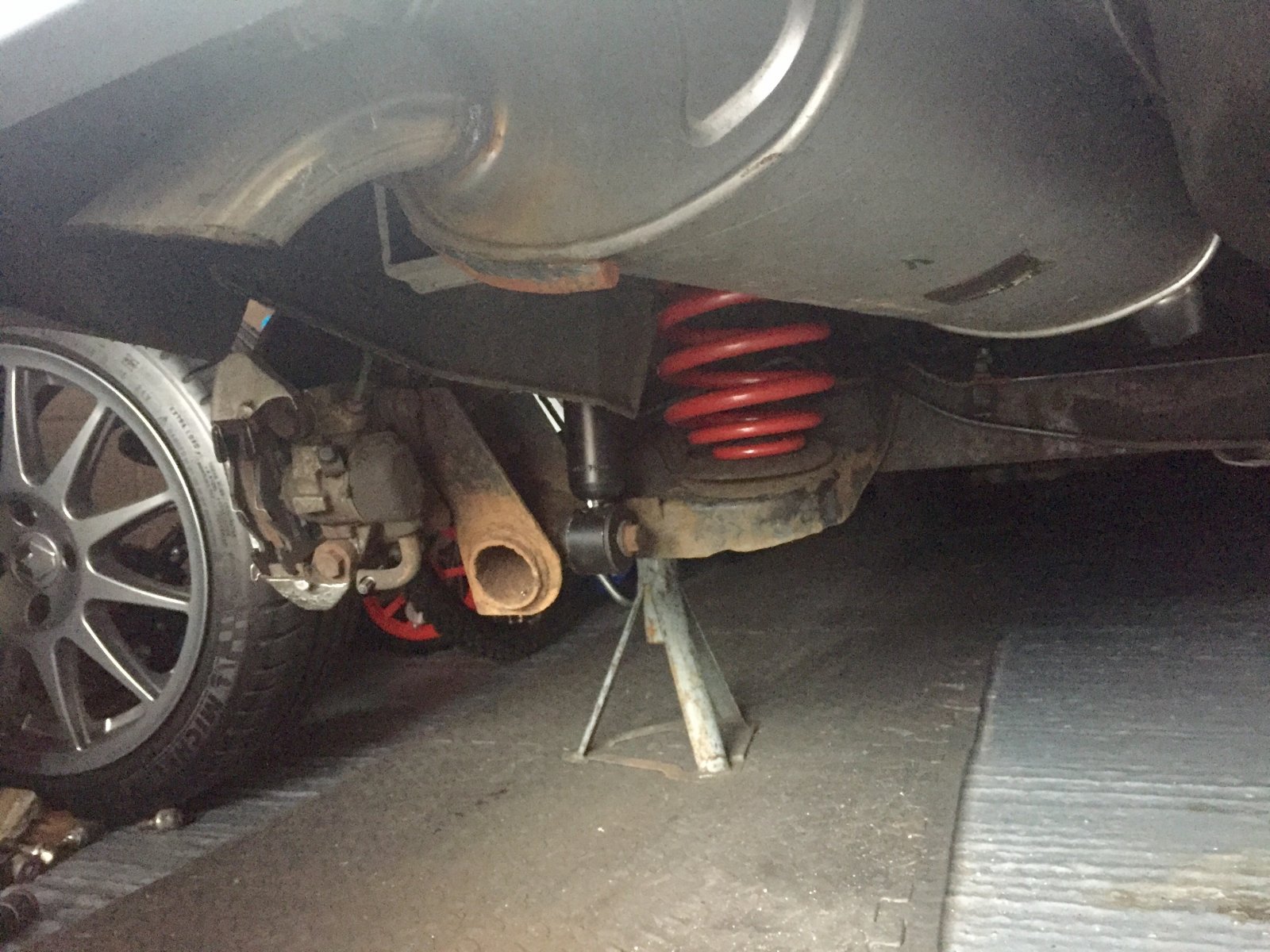

Not much done recently - just enjoying the car.

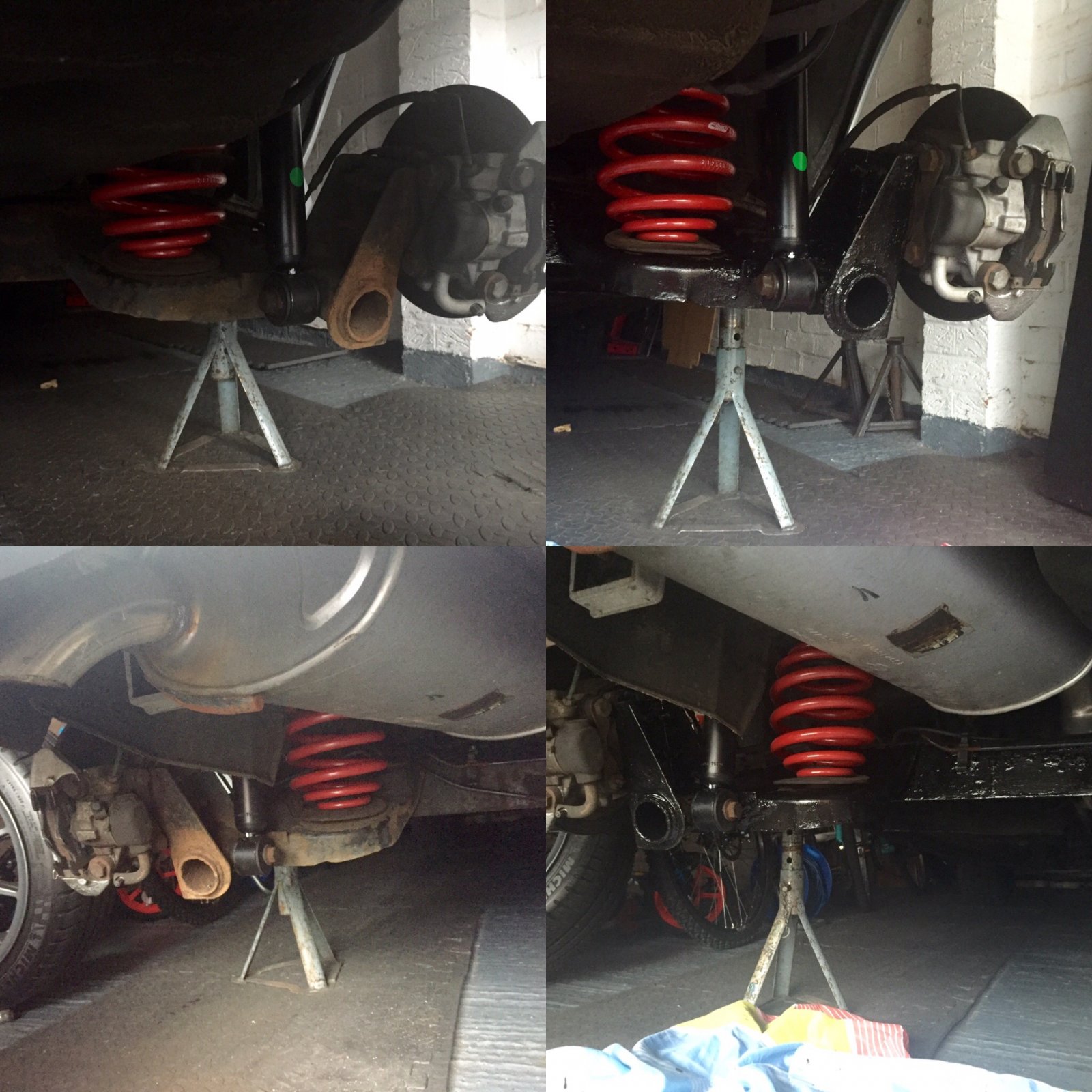

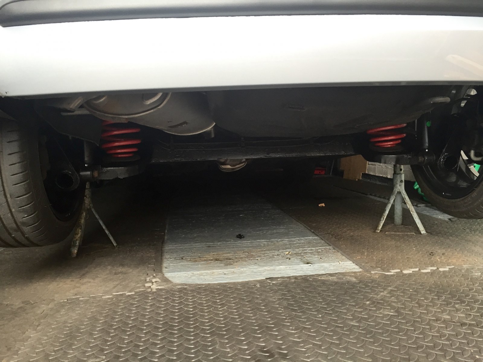

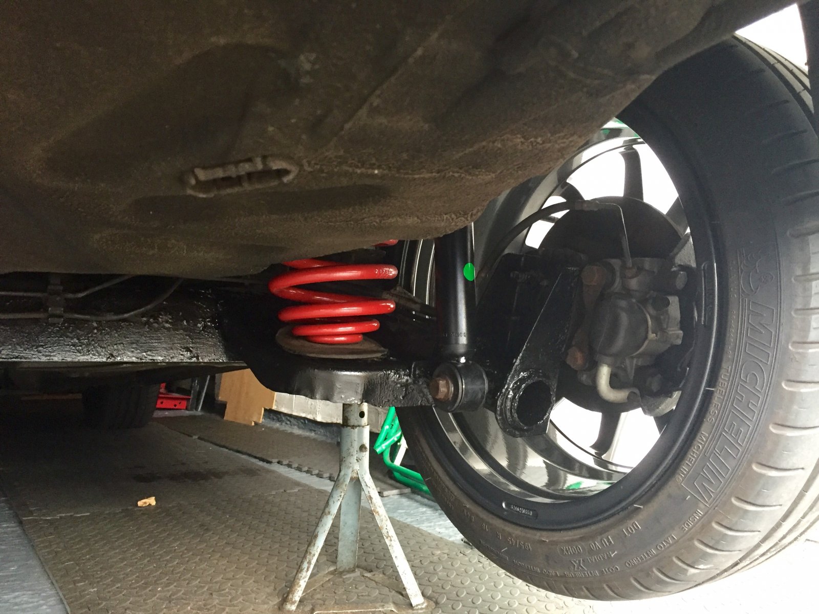

The rear axle and suspension was bugging me as it was rusty and scruffy. Nobody sees it but that isn't the point lol.
Quick wire brush, degrease and black satin Hammerite sorted it.

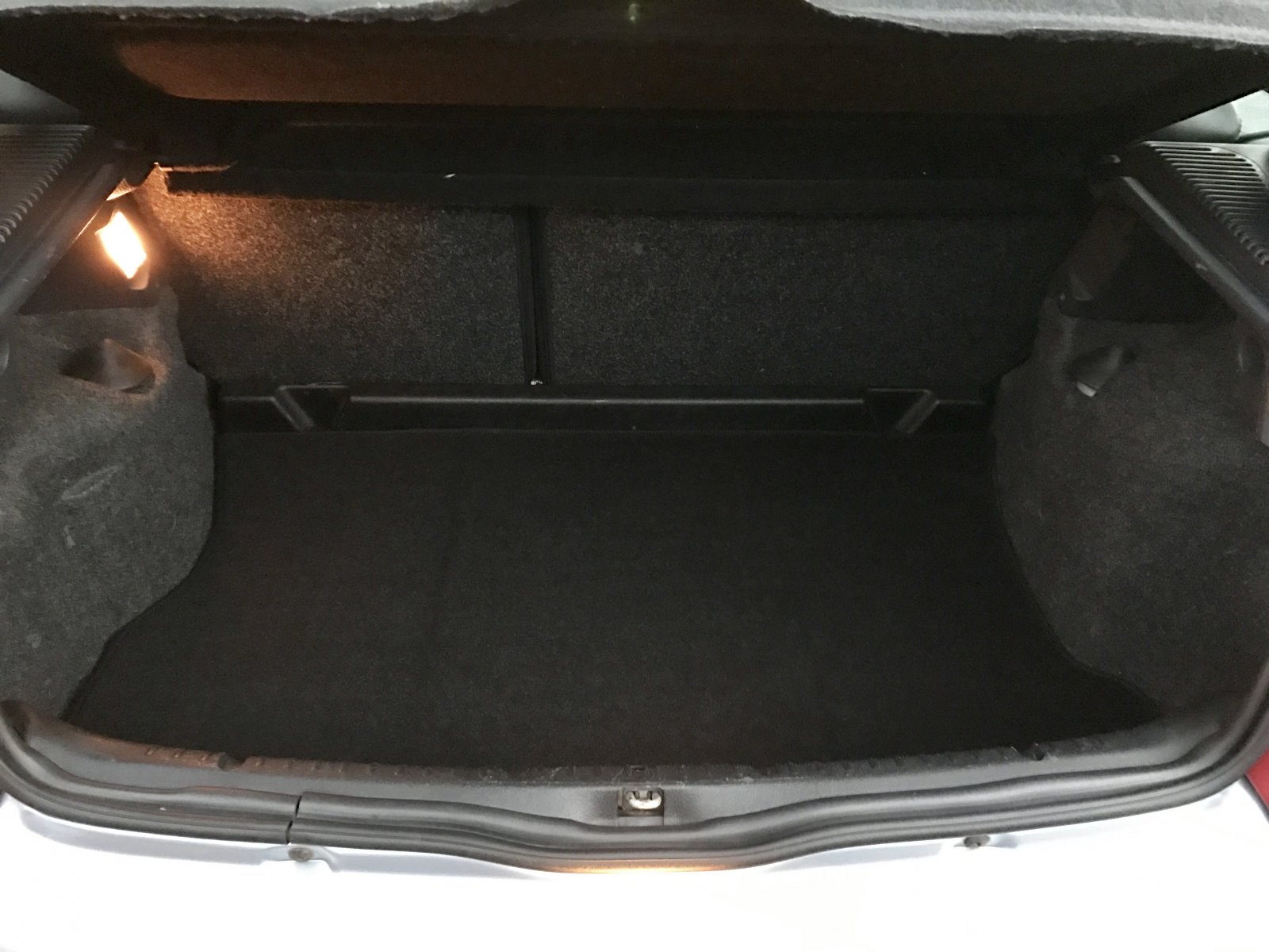

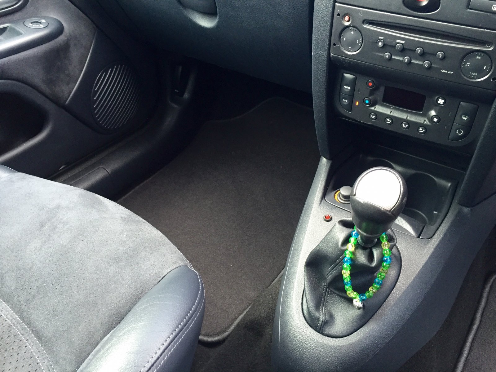

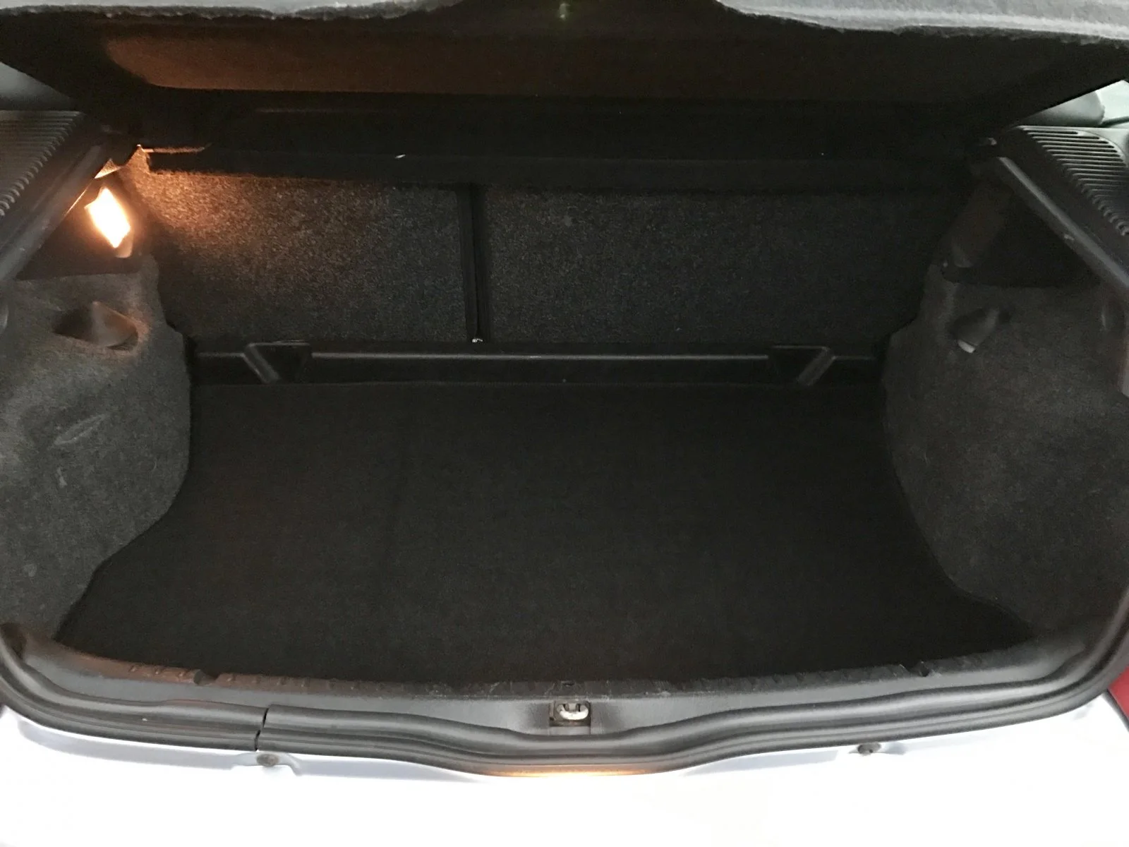

- new boot carpet

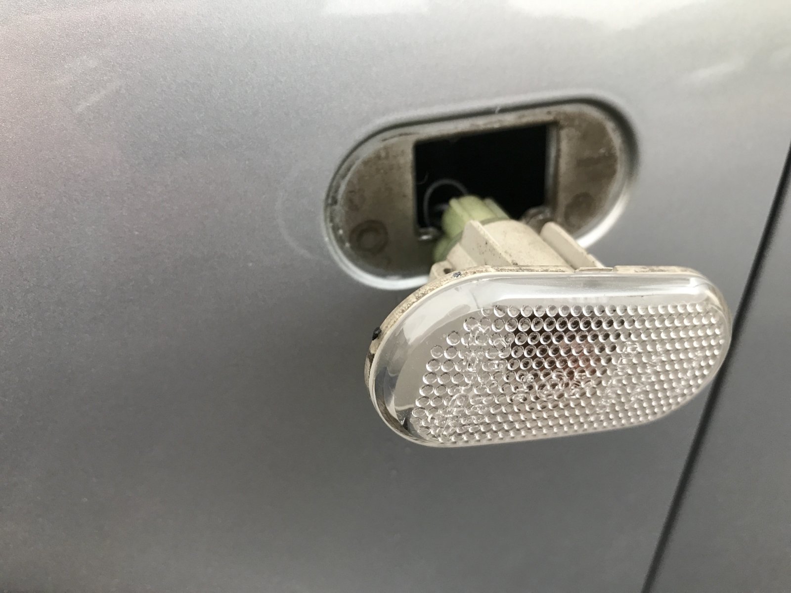

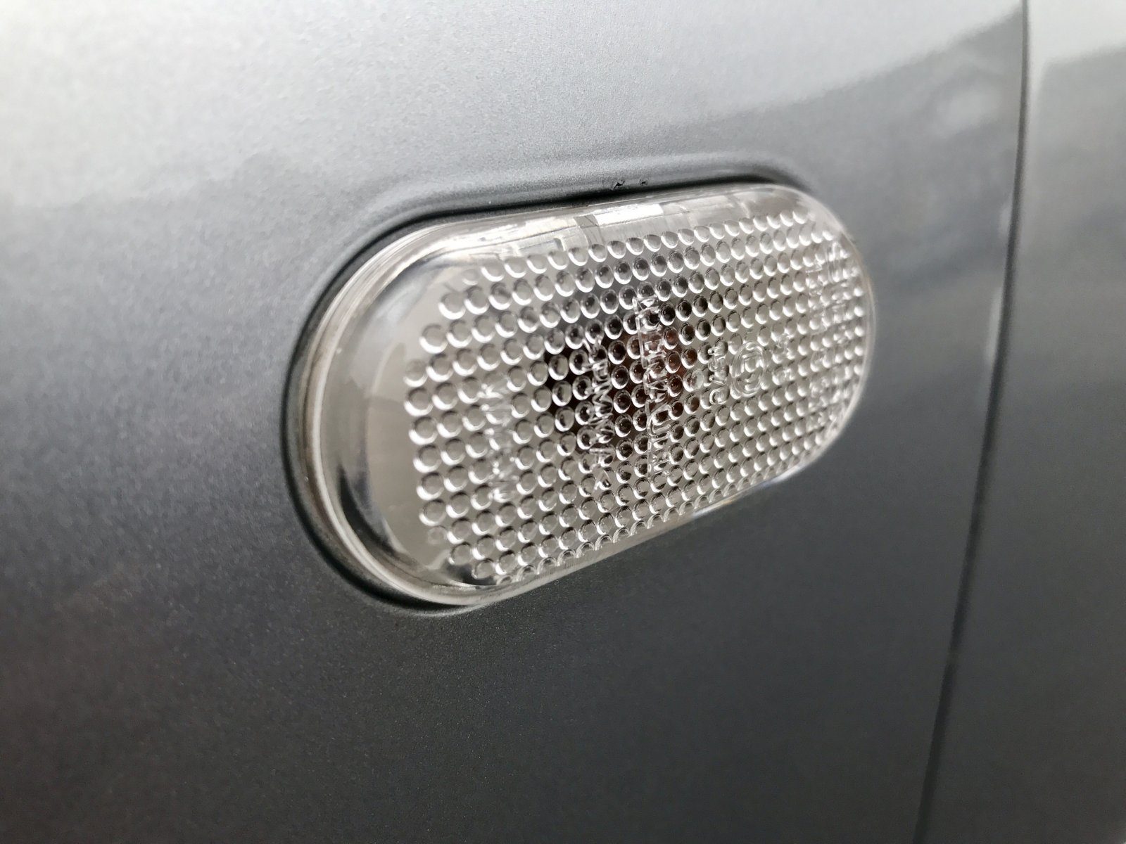

- replaced side lights and mains with led and rainbow bulbs (not sure about the mains but at least the nasty yellow bulbs are in the bin)

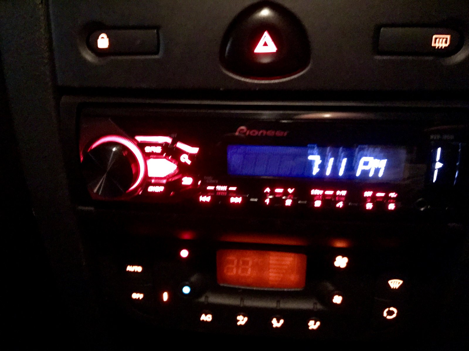

- replaced head unit with a £37 Pioneer and while basic it works fine and I can listen to my old fart music.

Steve, the head unit is radio and iPod/phone only, no cd function. Works fine for me and sound quality is night and day better too.
