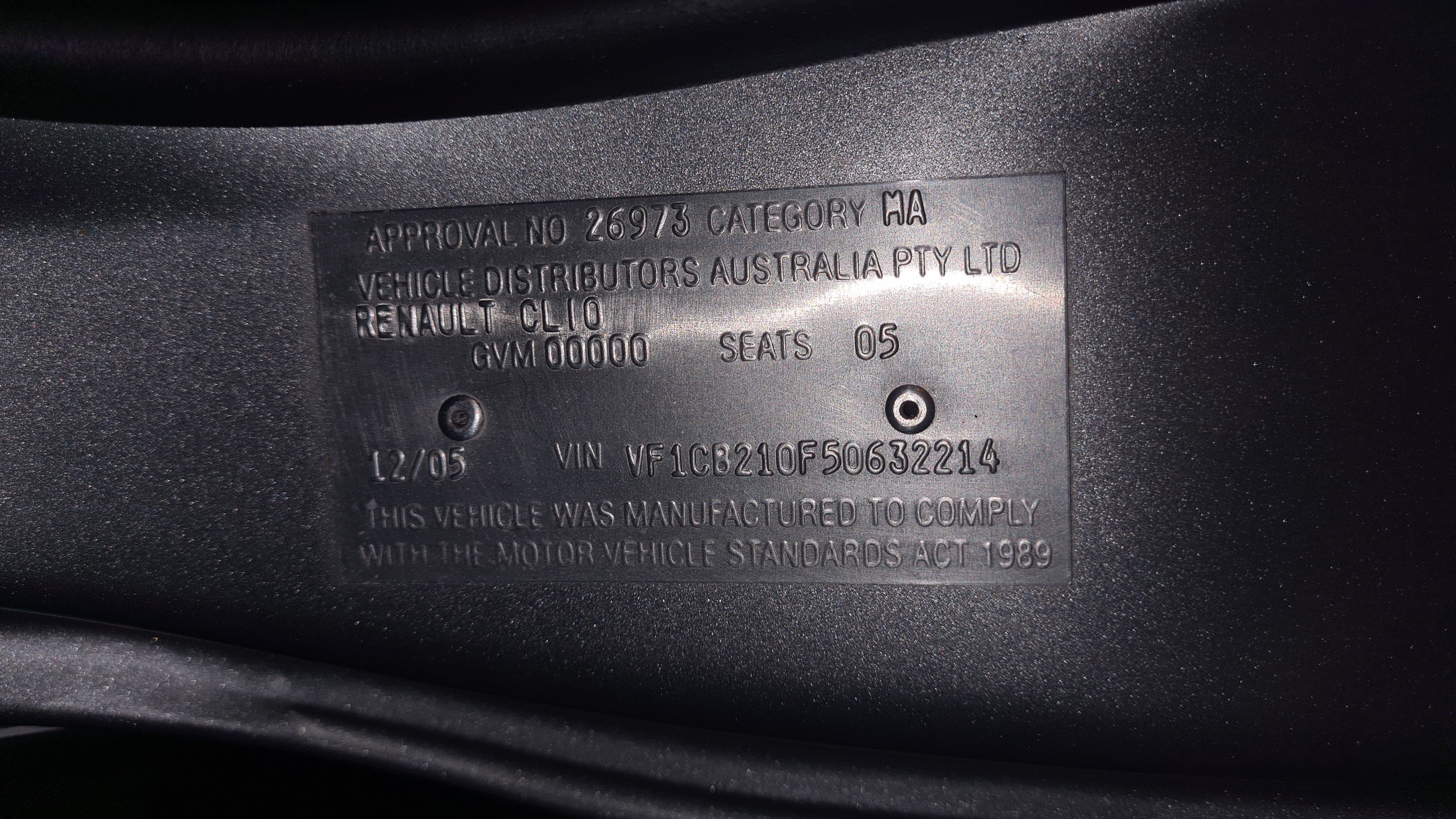

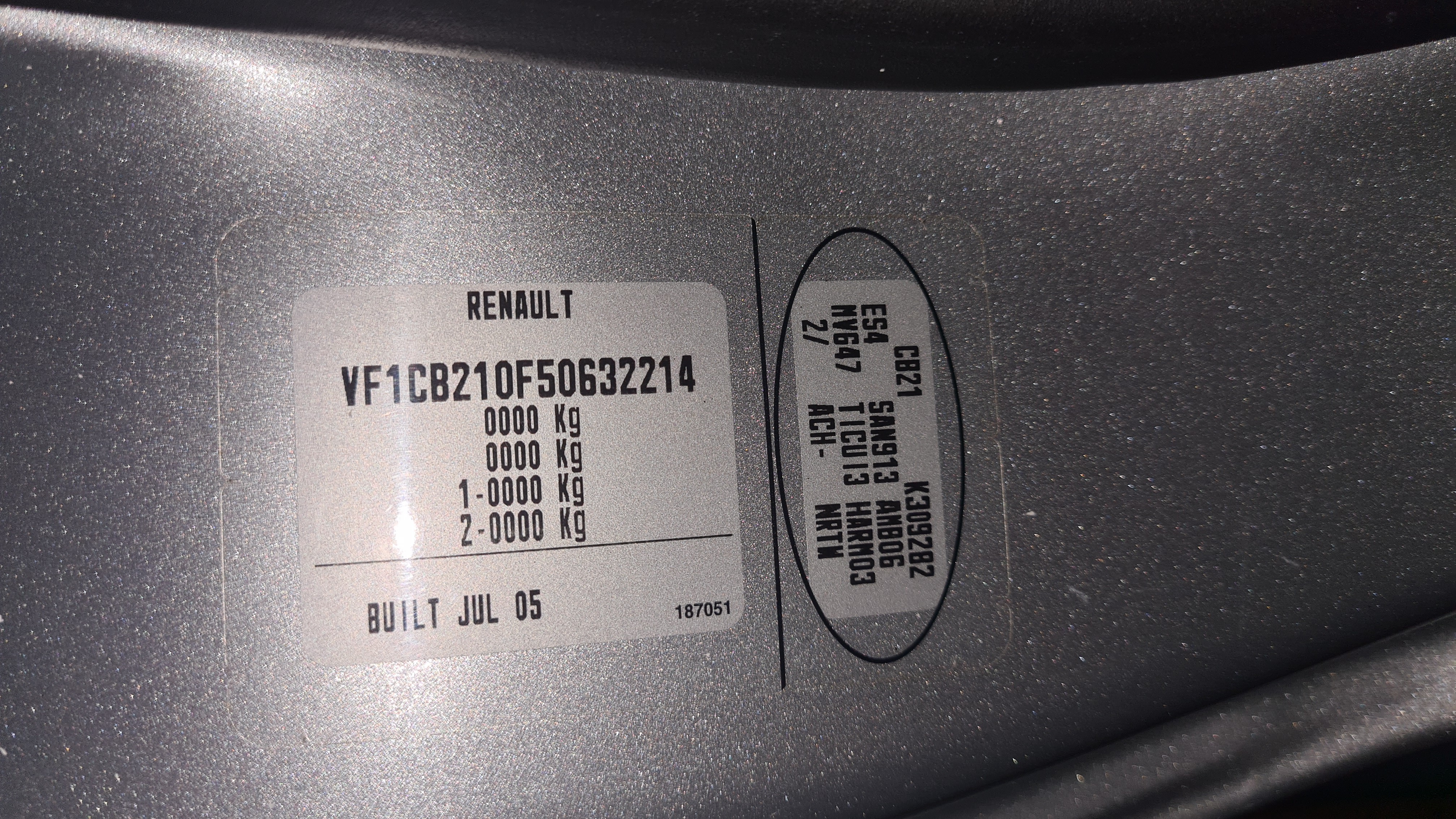

Not sure if European/UK cars got this.
But Aus delivered vehicles seem to have a sticker on the B pillar showing the month and year of production.
In my case July 2005.

Wow! quite the conundrum!
Can’t find a production sticker on my b pillar.

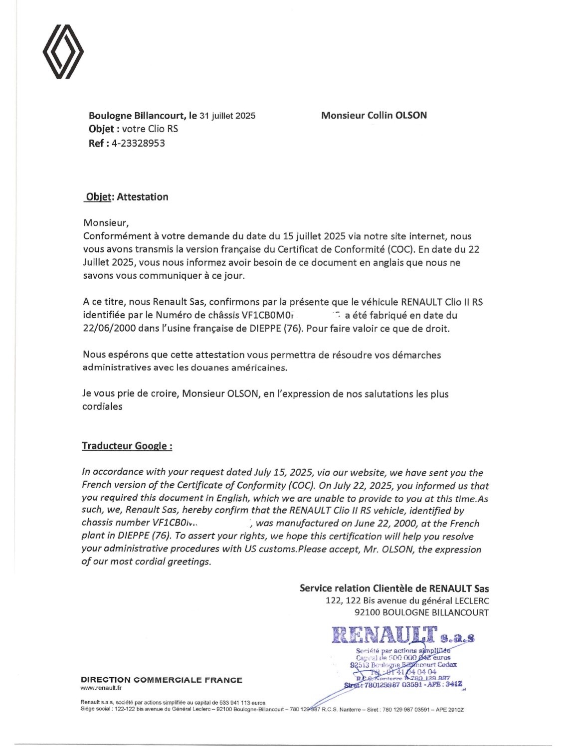

Amazing news! I just received an email from Renault with a letter signed and stamped stating the manufacture date of my Clio is 22 June 2000 along with a vehicle data sheet stating the same. I just forwarded it to my on base vehicle processing officer to send to his contact at US Customs to verify it is good enough. It's exactly what they had asked for so I'm sure it will be accepted. Due to time zone differences between Greece and the East Coast of the US, I will unfortunately not know if they accept it until tomorrow afternoon at the very earliest.
This is honestly the best news I could have gotten today and soon enough I will have the car in the US with me.
Manufacture sticker on the drivers side b-pillar (RHD).
Aus compliance plate on passenger side (took 6 months to get here it seems 😅).

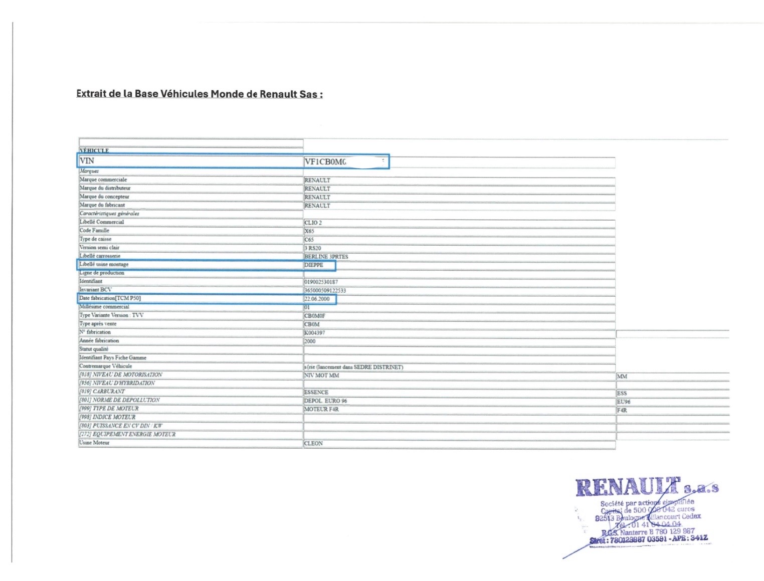

As promised, here are the documents I got from Renault. The first is the signed letter and the second is a printout showing date of manufacture. They also sent me a signed and stamped COC. Maybe I should get them framed to put in my garage!
It's evidently clear Renault don't have these kind of requests often!
The stamp is using their 1992-2004 branding font 😅

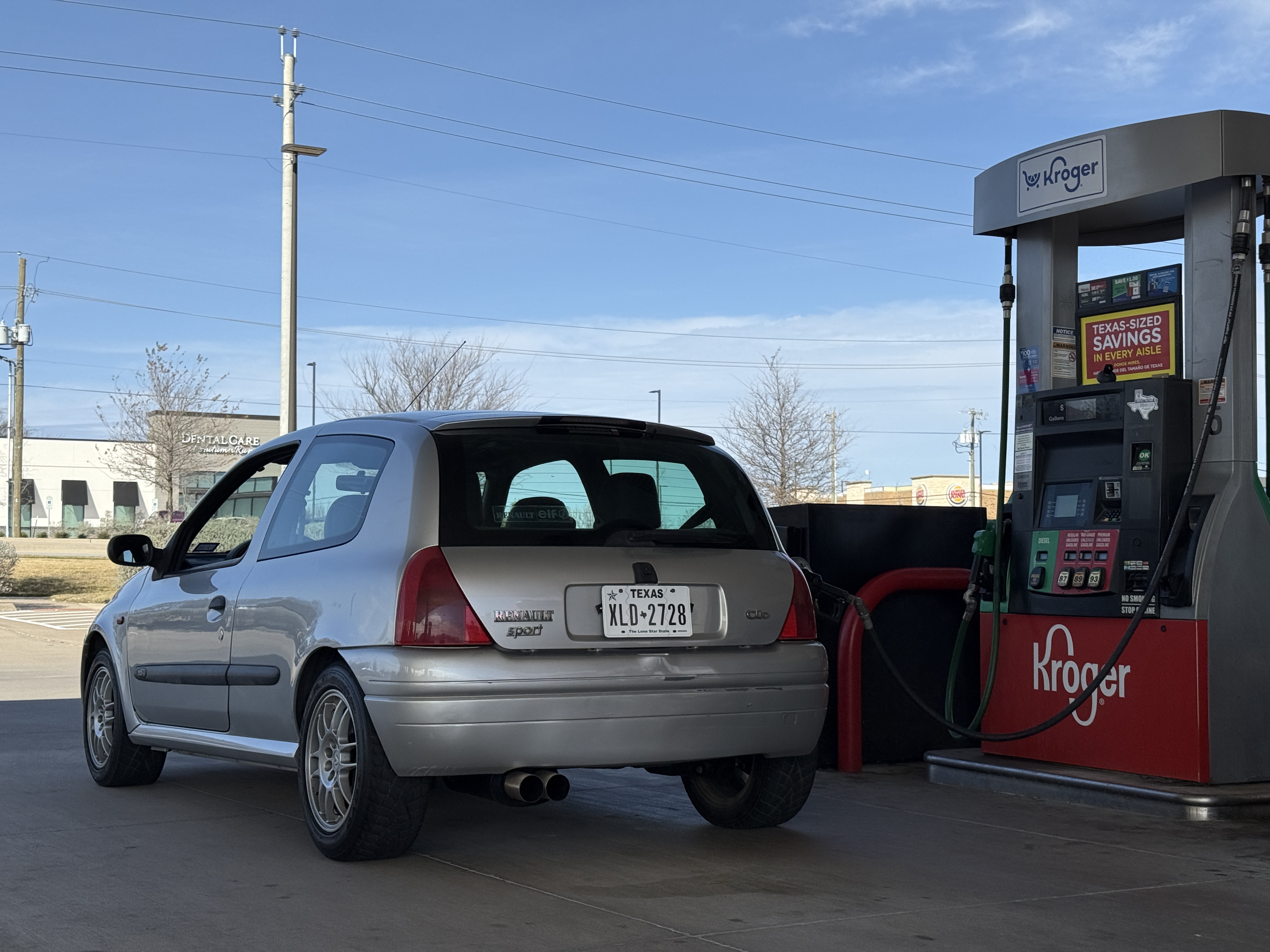

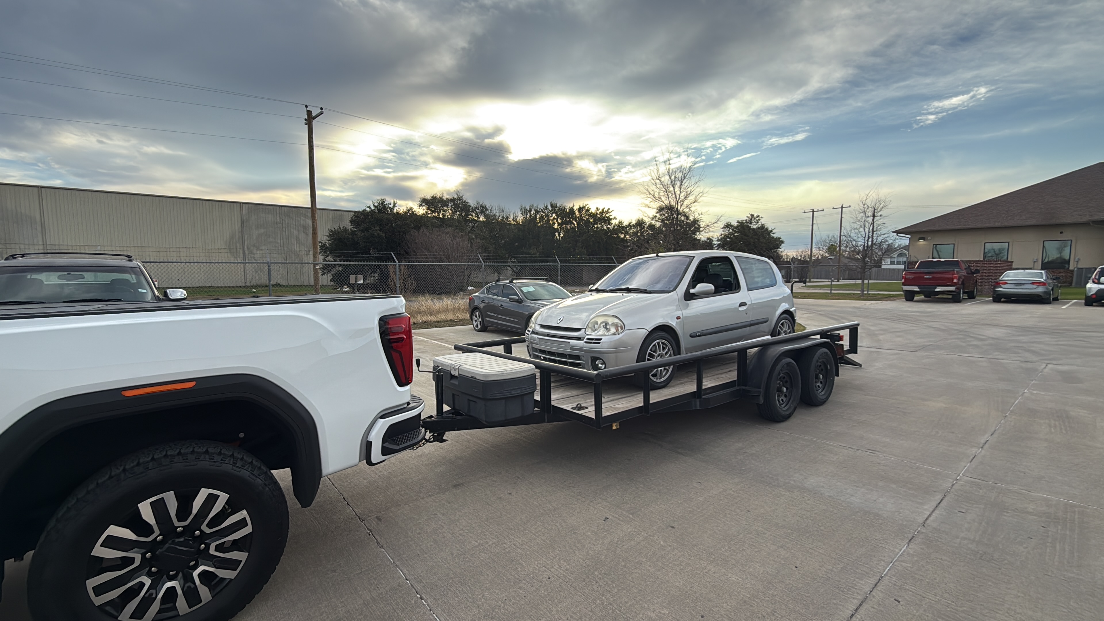

The Clio has finally made its way to me! I got the email this morning that it was ready for pick up. I took my truck and my trailer, picked it up, got it registered, and had it all done before 11 am.
My first view of the Clio since leaving Greece at the Vehicle Processing Center in Dallas.
Loaded up on the trailer ready to bring it home.
The first (of many) photos with the Texas registration plate. I had to rig up a mounting bracket for the plate until I can find a better solution to fit the USDM plates on the EUDM mount.

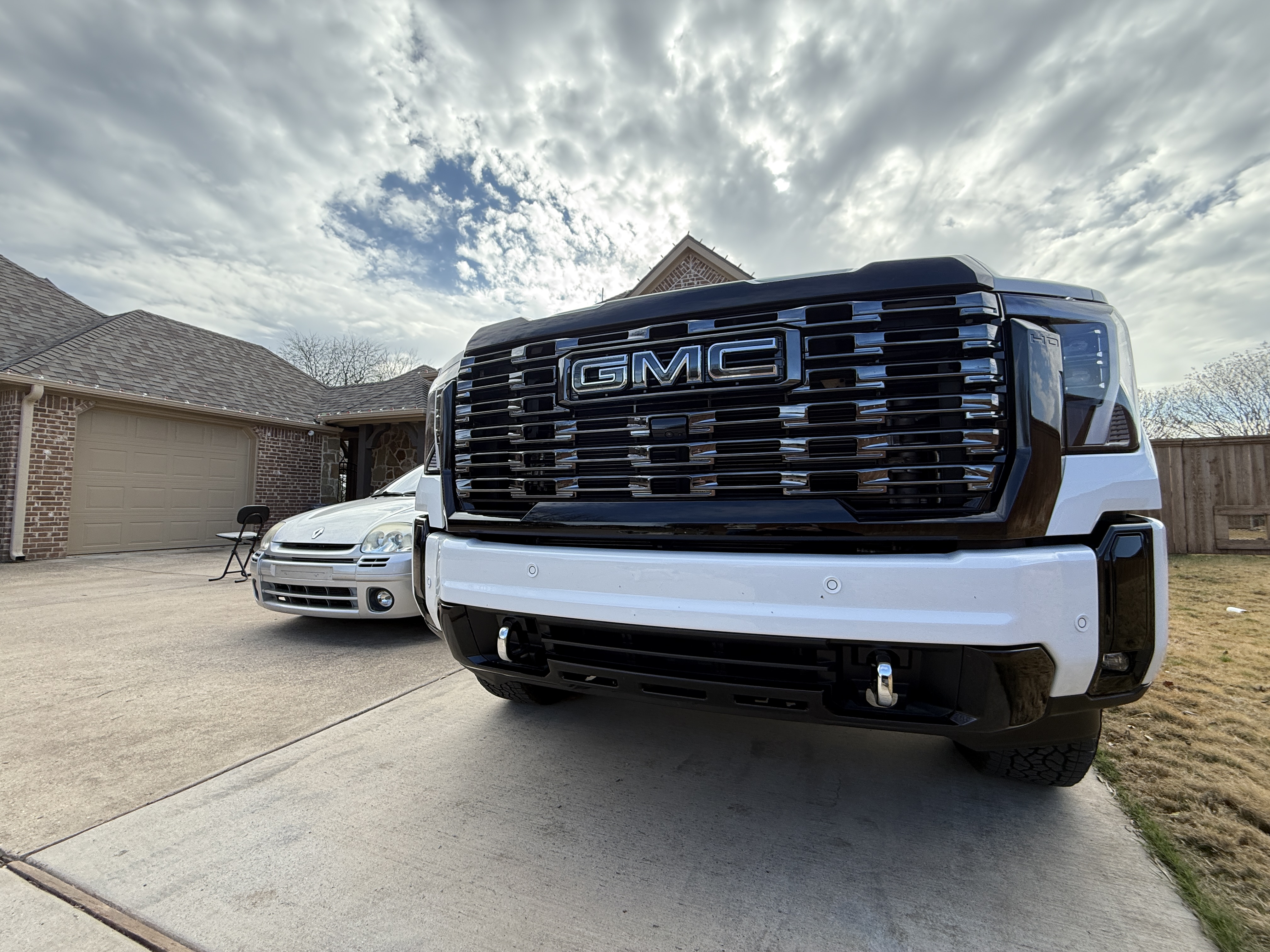

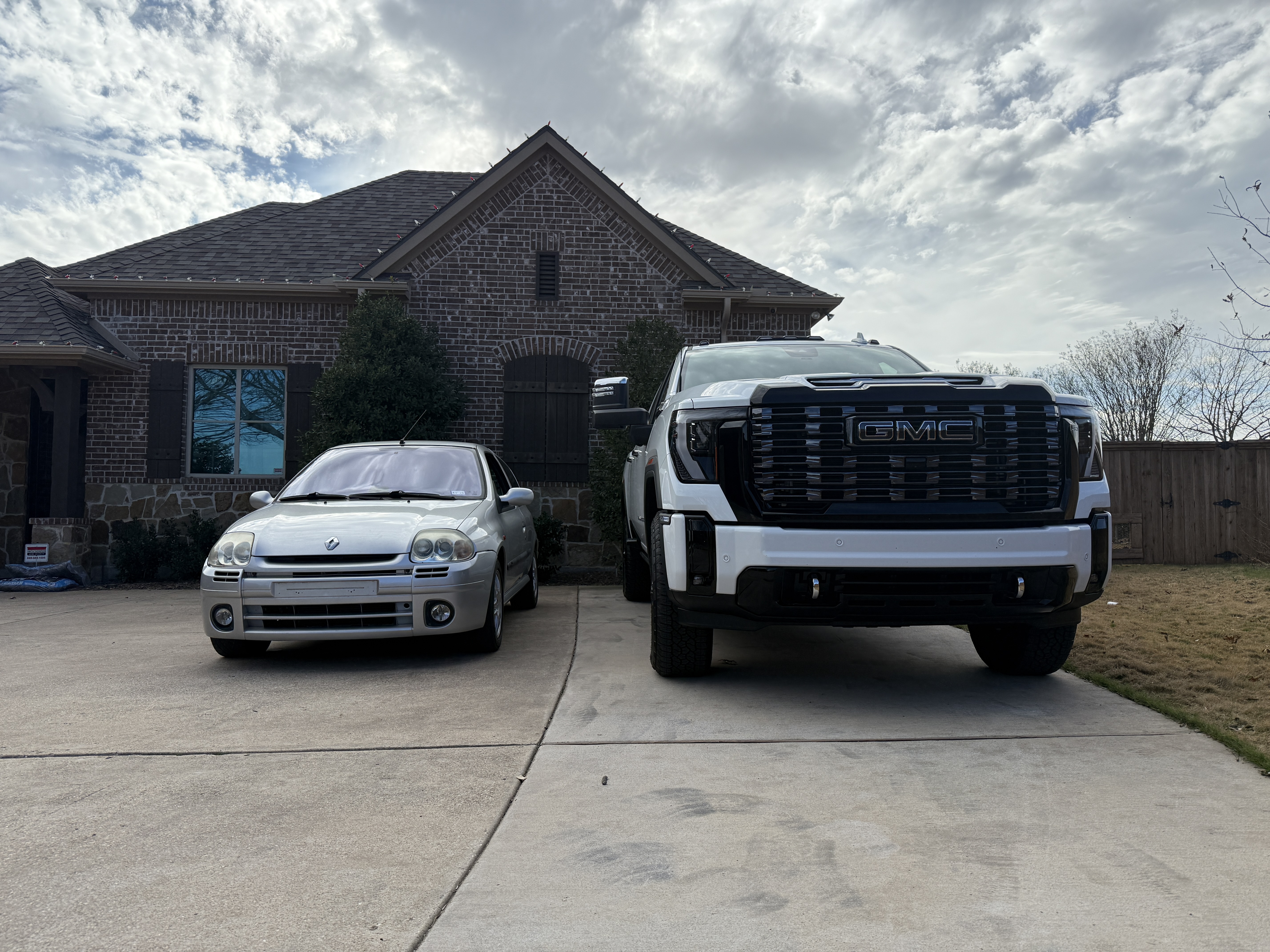

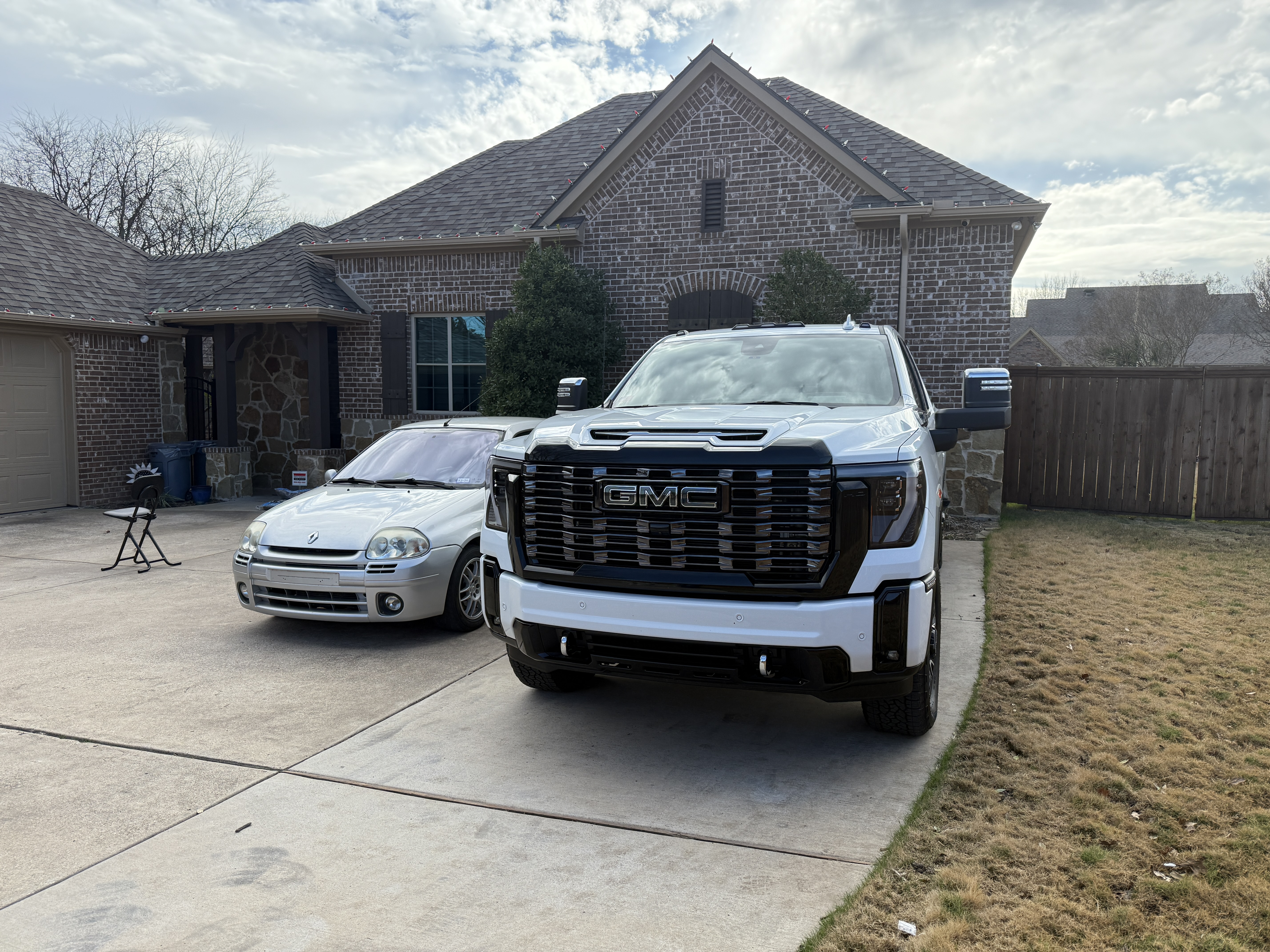

I can’t wait for the pics of it parked next to hucking fuge trucks and SUV’s 😂
The following is just for you, the Clio next to the truck that brought it home:
