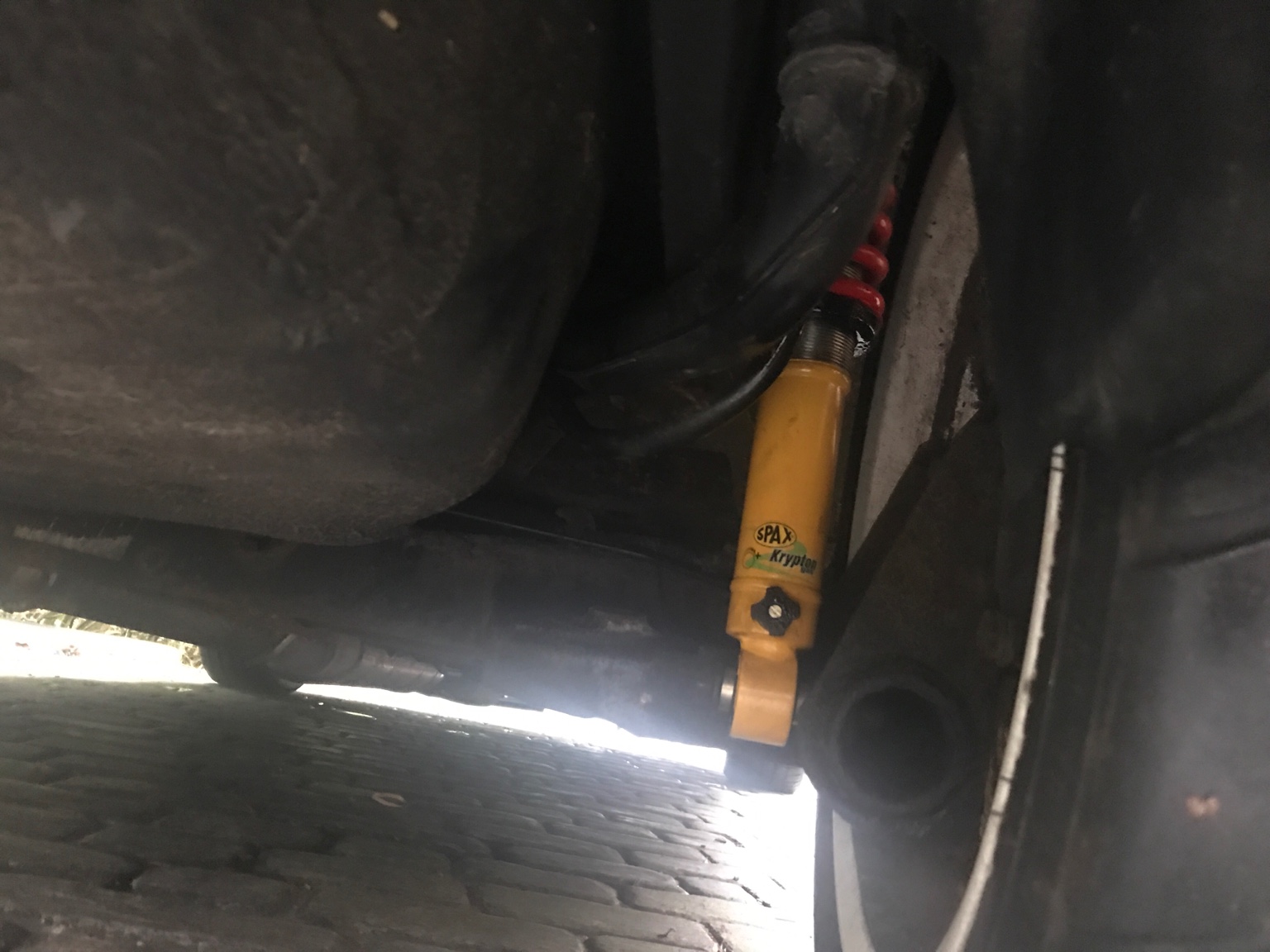

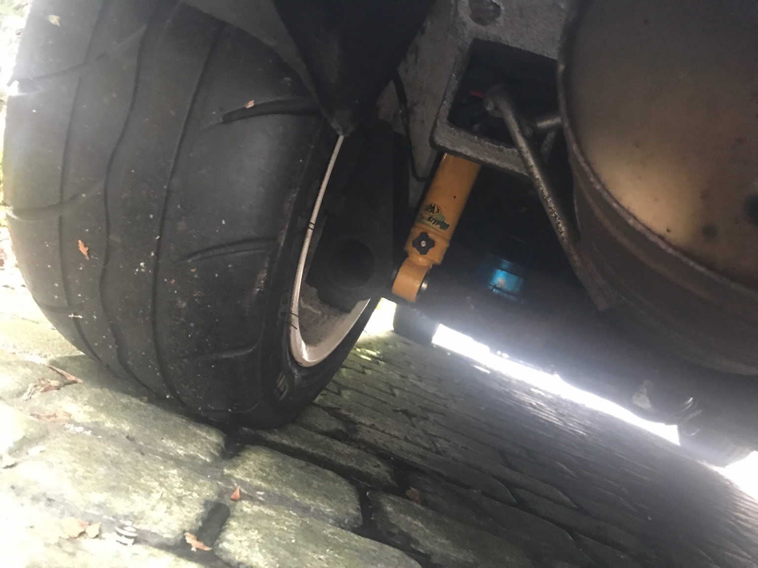

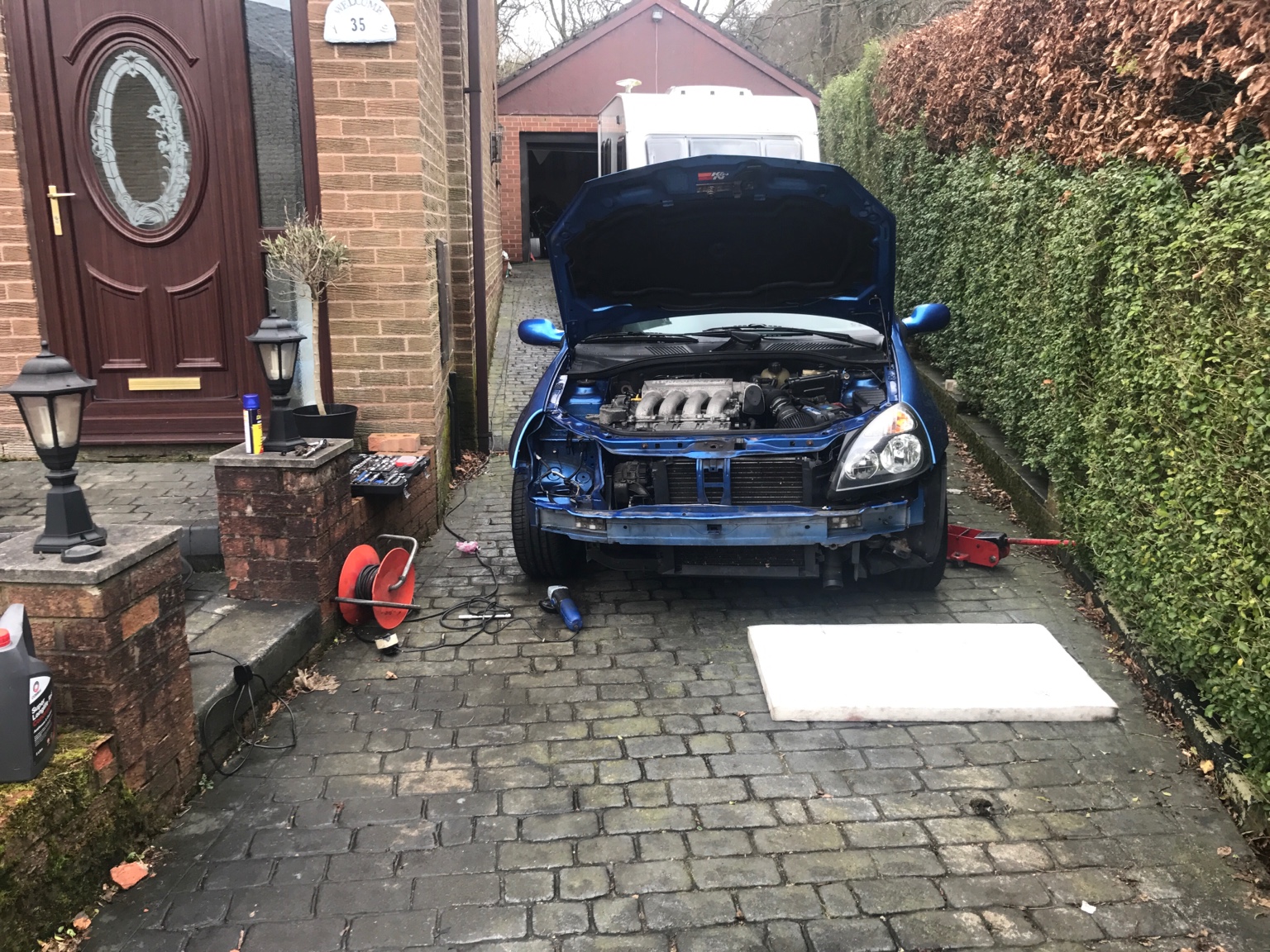

More progress yesterday, fitted the coilovers to the car, rear went without a hitch, set 20mm up from bottom thread each side.

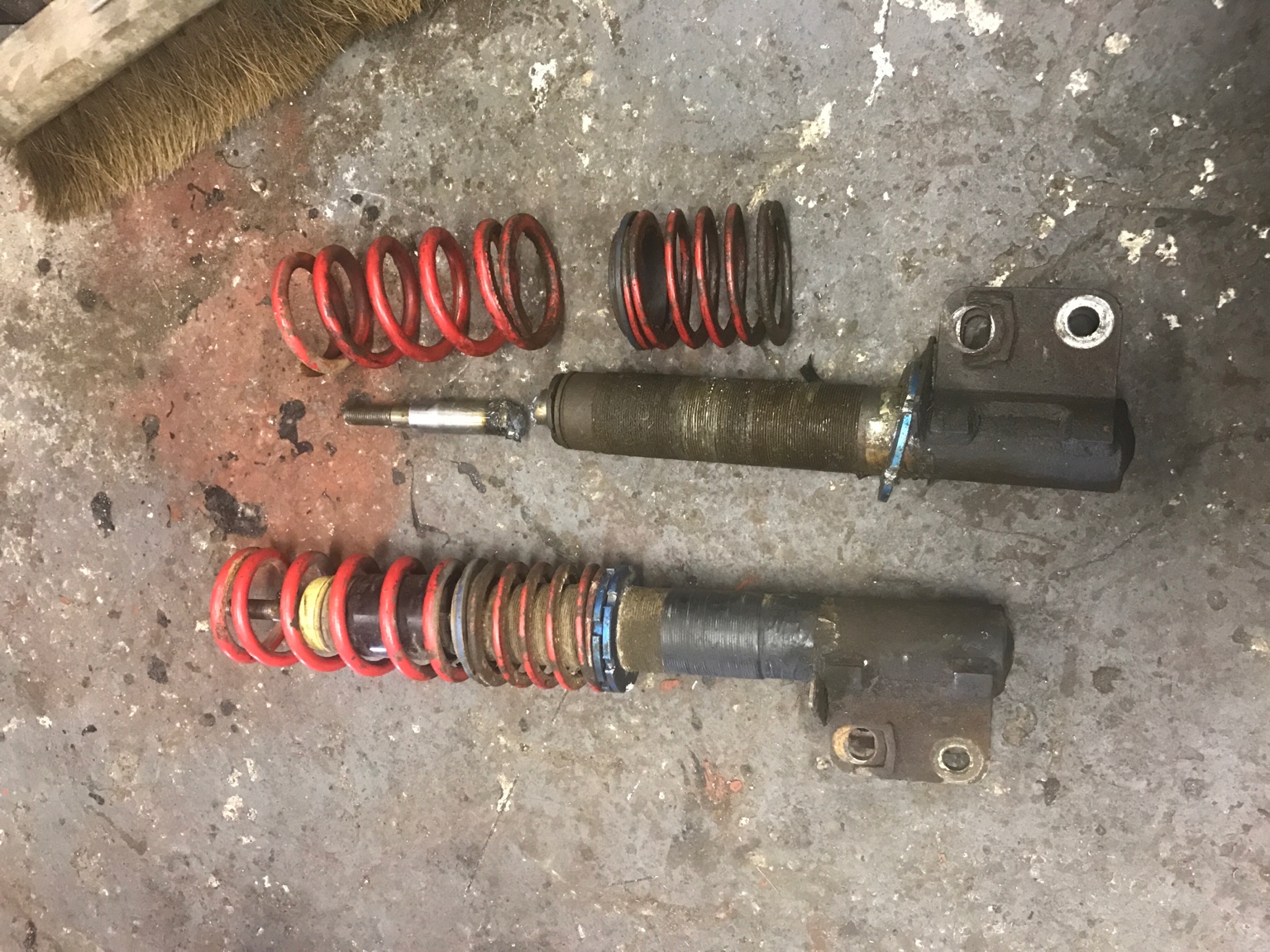

The fronts were a nightmare. Had to get the plasma cutter out and chop the drivers coilover in half that was on the car lol it was seized solid, luckily the heat expansion helped with undoing the top mount nut, hard to explain but either way it worked, people overtightening bolts and cheap coilovers rotting to bits is all I will say..
Either way the car is on spax rsx full coilovers front and rear and is absolutely transformed [emoji108] but coming from budget coilovers with one dead rear shock and one absolutely goosed front coilover explains that.
Unfortunately me being me set the car to full hero spec, 5 clicks off hard...
This resulted in me going round the first roundabout backwards lol 2 degrees and wet roads with hard semi slicks would have also contributed but front and rear are now near enough middle setting on stiffness now and seems a lot more usable on roads. Comfortable enough for me anyhow.

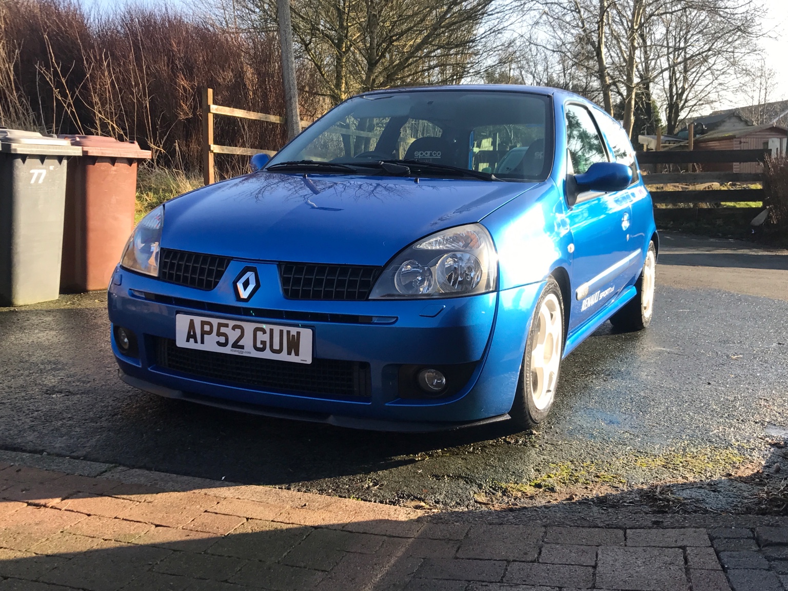

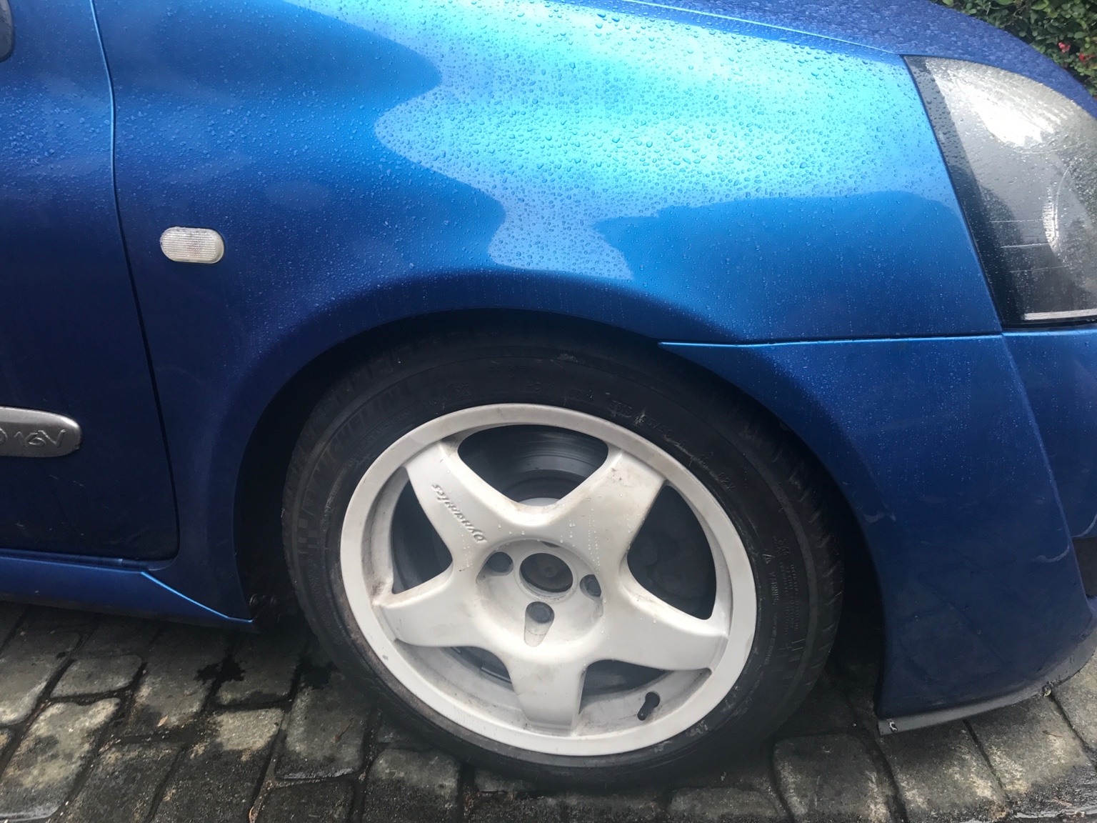

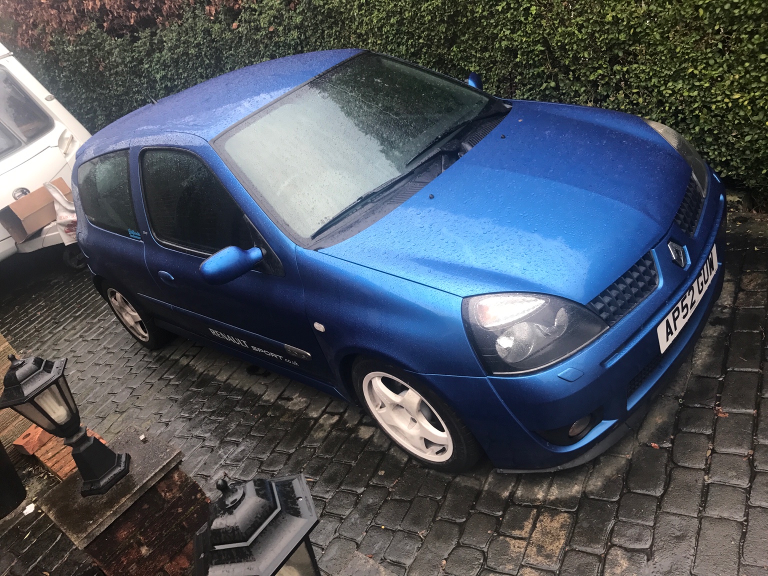

Couple of quick pics, didn't get any while fitting due to being stressed with fronts. Will get some better pics when set up and aligned by a proper place..
Cars getting better and better [emoji108] still got a few things to do before end of march, brakes and allignment next.
Just thought I'd update with a pic of the offending articles I removed from the fronts, for sale if anyone fancies em

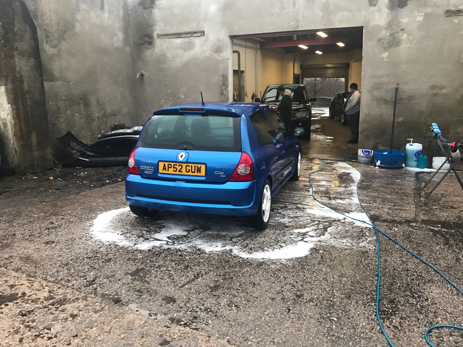

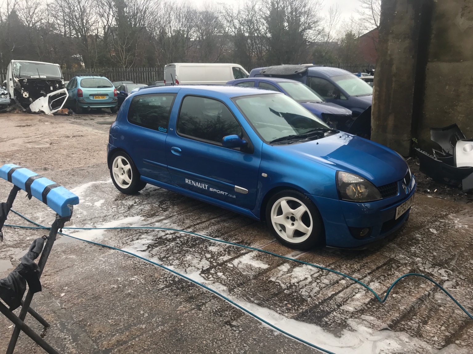

Unusually today I actually cleaned the car! [emoji15]

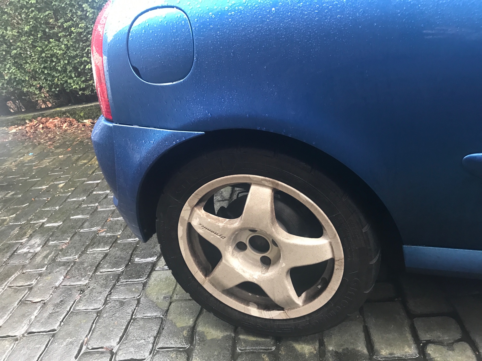

Very strange for me but the power washer and cleaning products at my mates works are s**t hot so thought why not, car still comes up great, it's the cleanest one I've owned, only thing is the wheels are discolouring already so thinking back to anthracite or possibly flat black next? Hmm

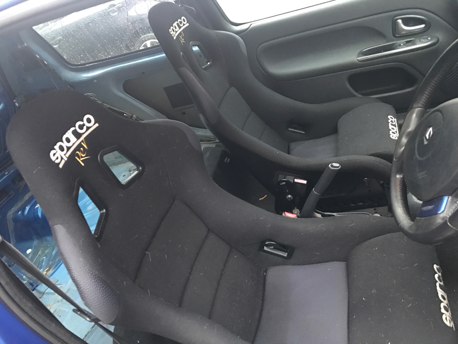

Still need to get the passenger bucket seat in, but I'm on nights this weekend so won't be getting done till next week as I'm too lazy [emoji42]

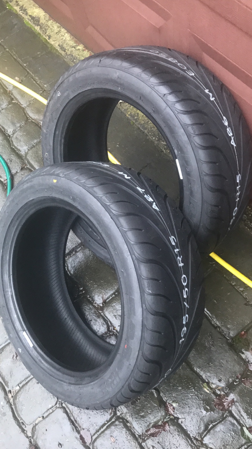

Just need some Brembo HC discs for them now so I can fit [emoji108] also just ordered some 595 RSR tyres, come highly rated And for price they're peanuts so worth a shot

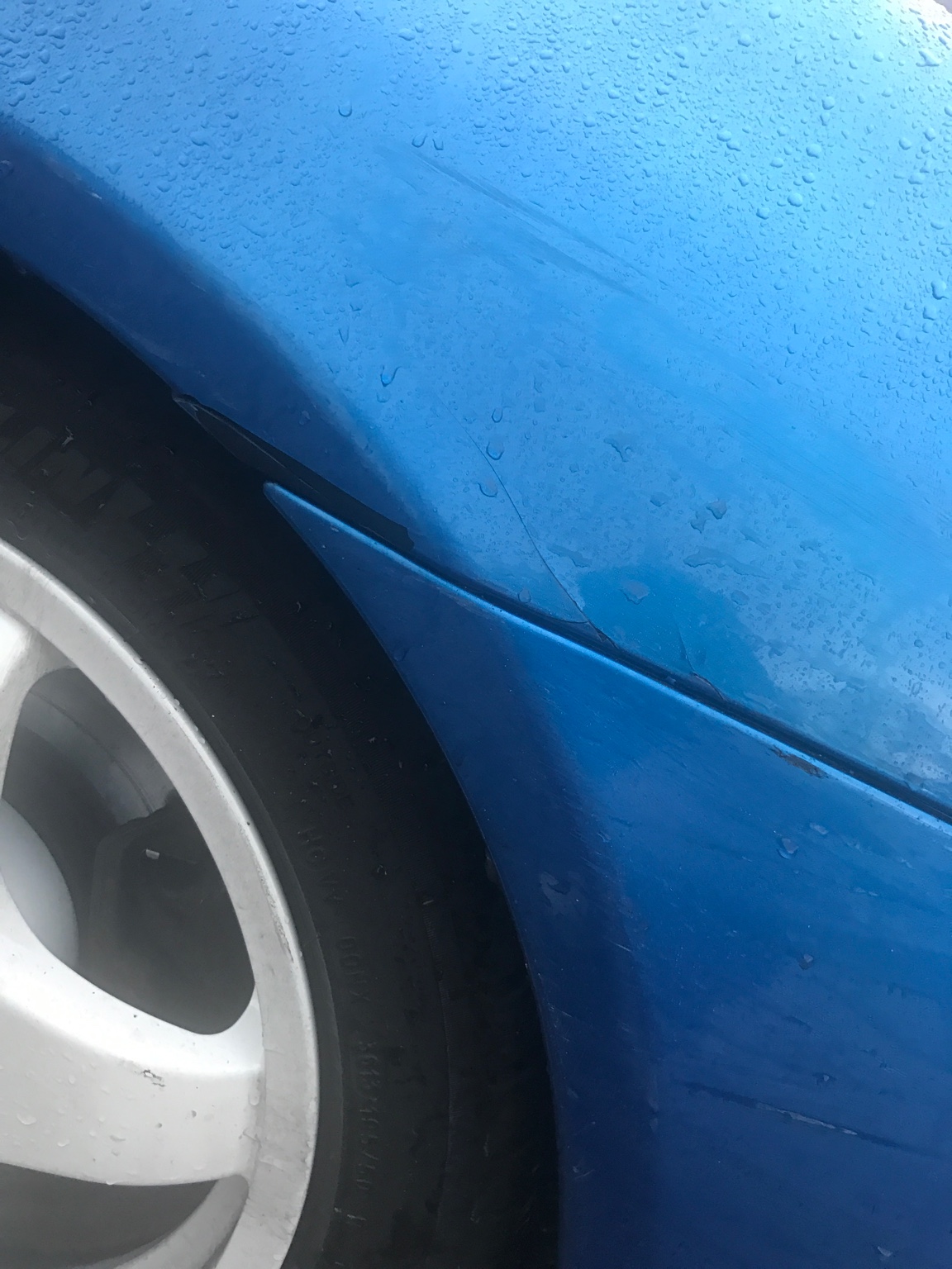

Neighbour from over road has not seen my car some how And backed into it, bright blue car you'd think would he noticeable but oh well, hopefully pick up a second hand mondial wing cheaply..
But this has made the day slightly better, would recommend camskill to anyone, price and next day delivery for £6 is a winner [emoji108]

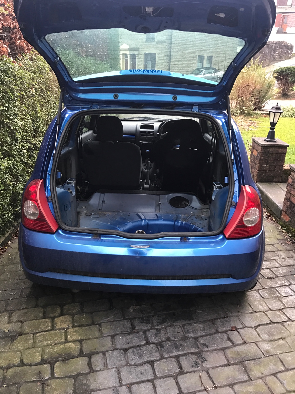

No money ATM so started with free mods, got the car stripped out in the rear, then took it to scrap yard down road and it weighed in at 960kg as it is, with 1/4 tank and still on standard passenger seat, so still loads too lose yet!

Finally pulled my finger out and fitted the passenger seat, should be a bit lighter now, please excuse dog hairs car needs a good valet

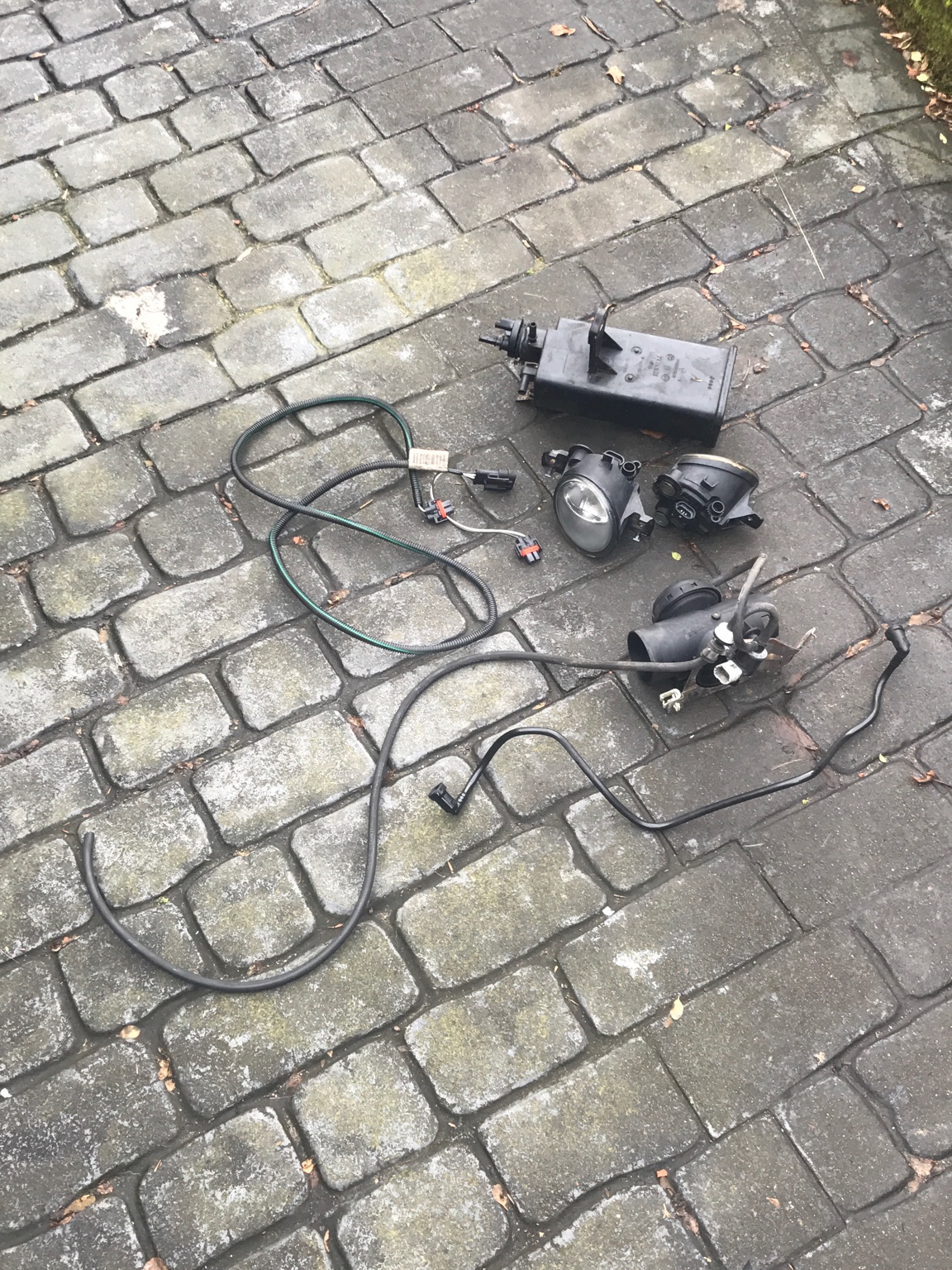

More free mods today ie more weight reduction.
-Fog lights and loom, -carbon canister, -acoustic valve and bumper backing

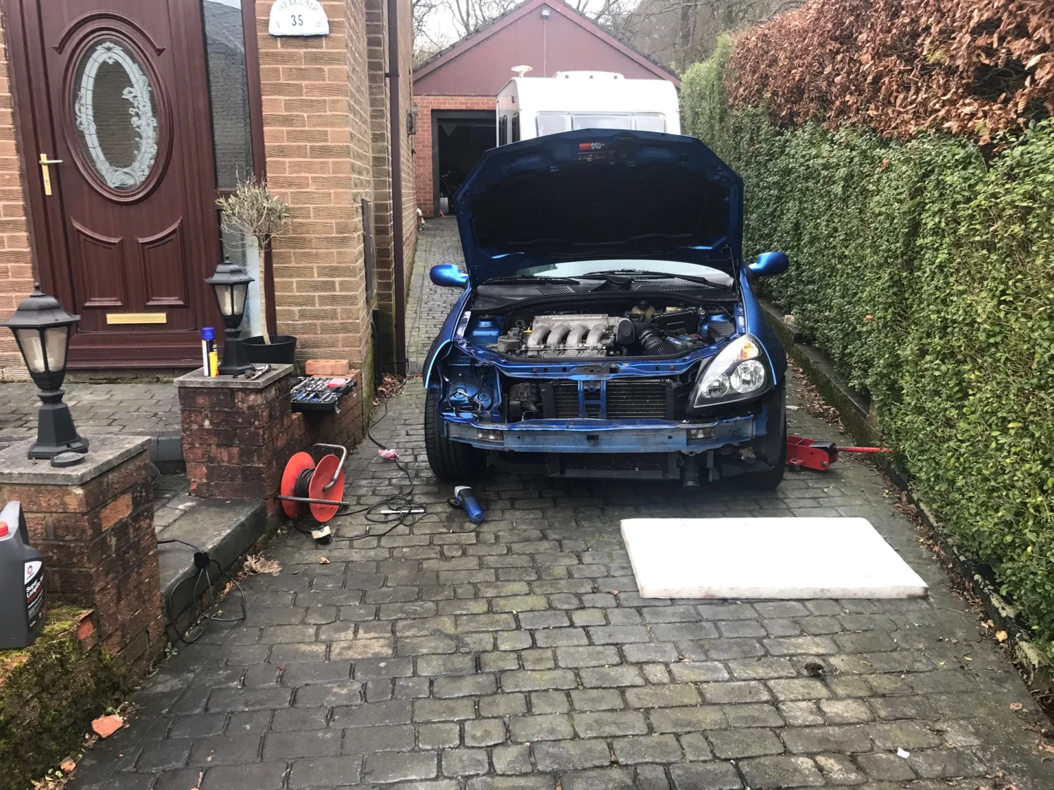

Bit of a car day..

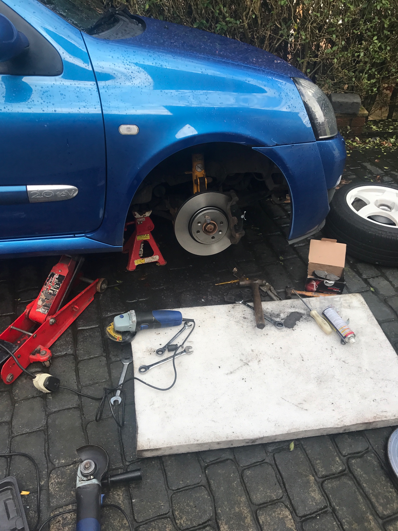

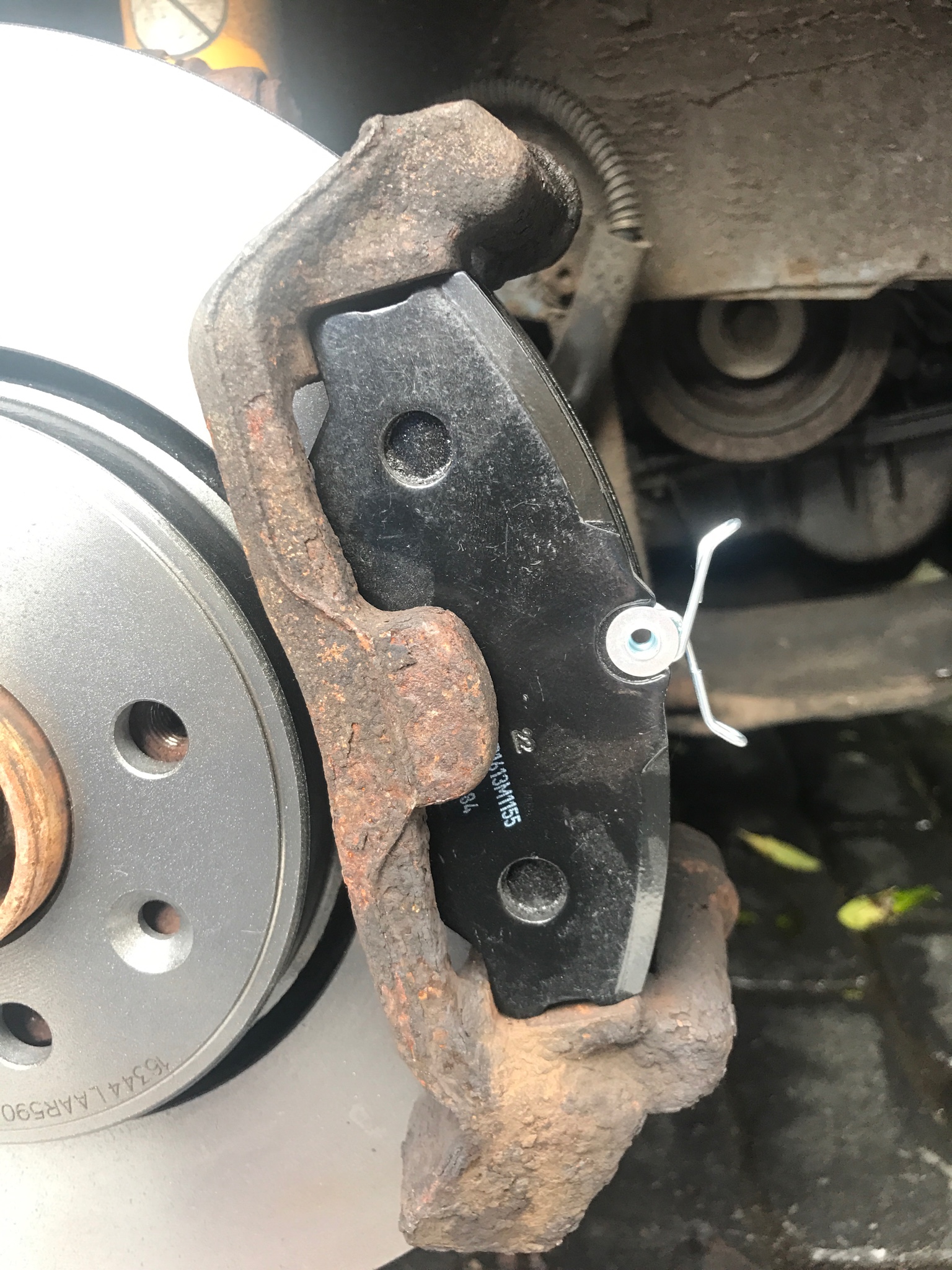

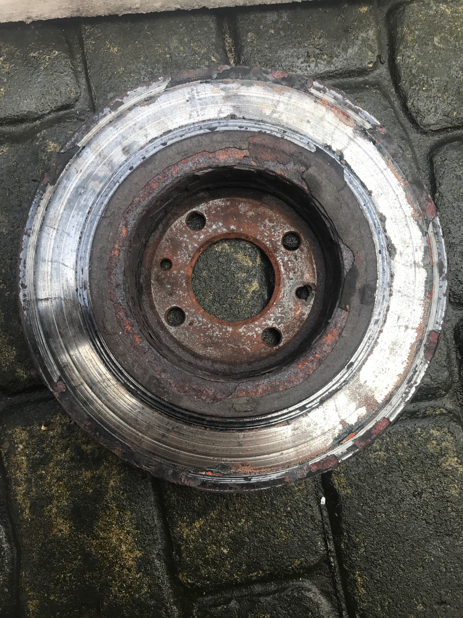

Had mates round today and got a few bits sorted on them, jobs for mine were Discs and Pads and Spark plugs.

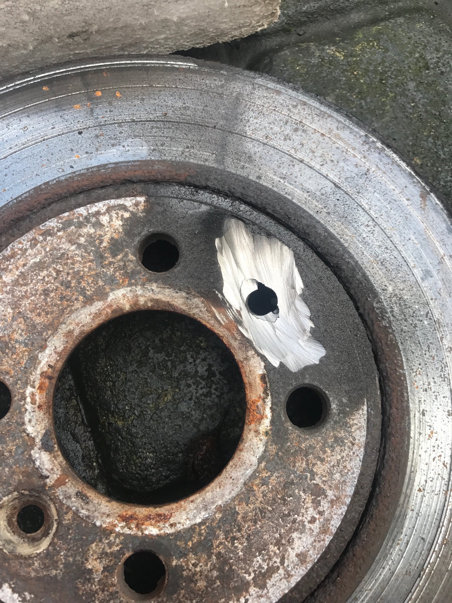

Day started in typical fashion with rounded disc retainer screws so had to grind them out as couldn't find a chisel..
Think they needed changing???

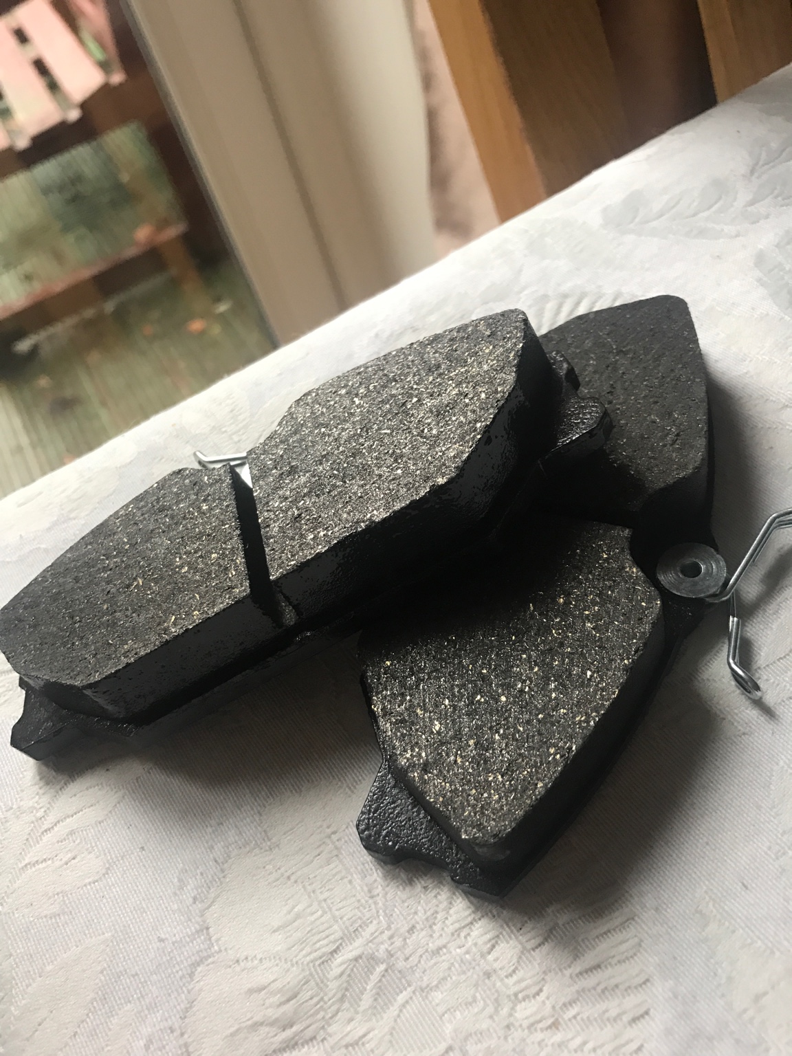

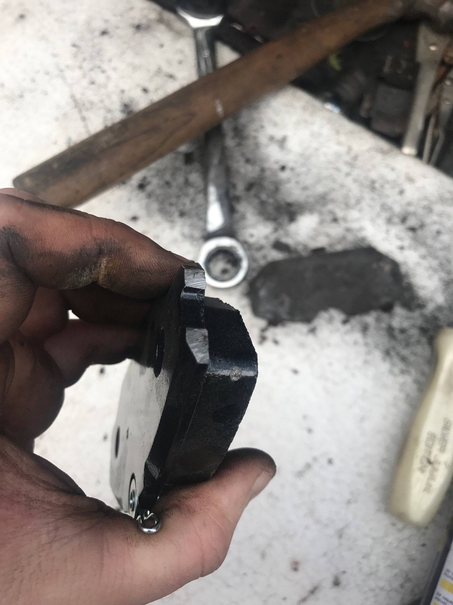

Next the mintex 1155 pads which just needed a mill or two grinding off the edges to fit nice.

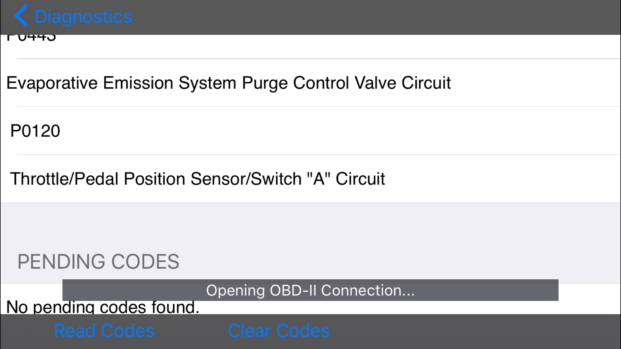

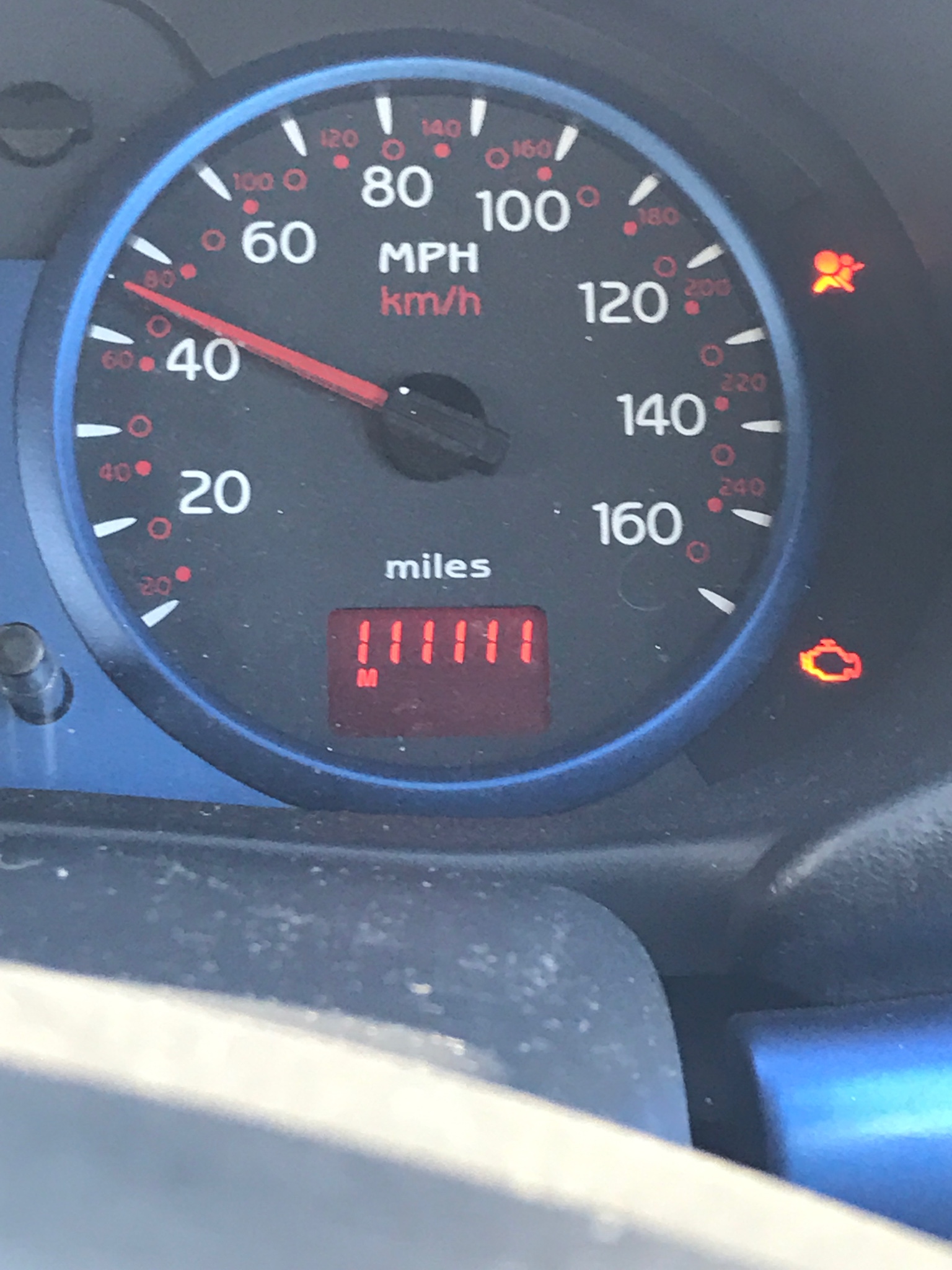

Got this trouble code up intermittently though which is frustrating? Think I've caught a wire for the throttle body or something need to investigate it.
