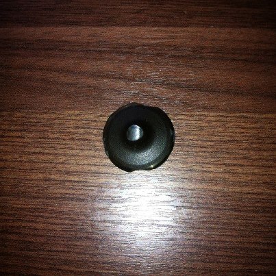

So finally got my car to the local garage yesterday, after work I popped down to see him to discover he'd stripped the engine to find this ....
Think he said it was one of the inlet valves that had snapped !!! WTF really ? anyone got any thoughts on how this can happen..
Its a 172 on a 2001 plate with 50k on the clock, full service with belts changed back in 2010..
