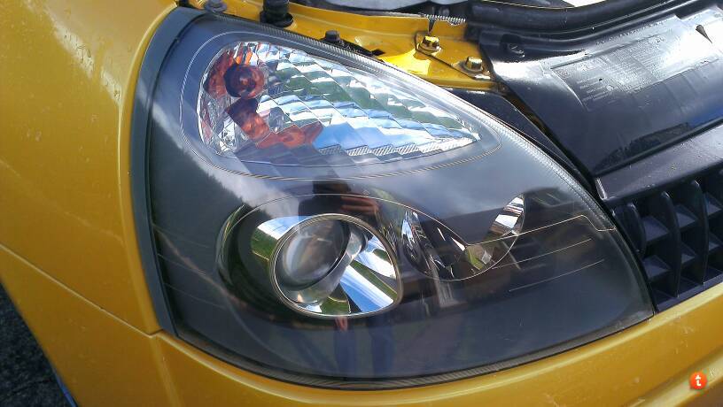

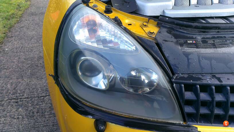

My headlights were terrible and have bugged me since buying the car so finally got around to fixing it.
As you can see their awful!!
Was going to buy meguiars headlight kit but thought I'd give the wet n dry a go seen as I already had everything needed.
All done by hand. I did 1200, then 2500, then g3 scratch remover, then bit of mer polish. Took just over an hour on drivers side. Passengers side I cut down to around 45 due to time constraints.
Spent the longest time on 1200 stage.

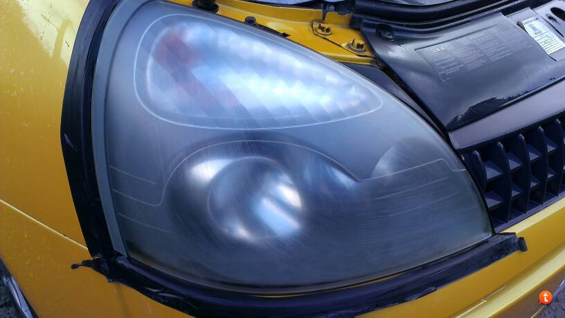

This is after sanding. As it's still wet it looks brilliant and as good as new.....
Until you dry it off......

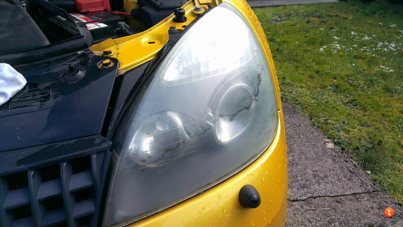

Big panic. Lol. Looks worse than before.... But once started to use g3 panic over.

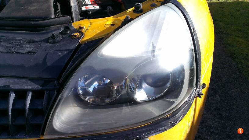

That's after g3 and a quick polish. Very happy now. They ruined the look of the car before.
One here of top half after sanding and bottom half after sanding and g3. G3 really finishes it.
May do them again in future but for now I'm more than happy.

They came out ok and to be fair have remained good. Been around a year and 22k miles, still look well.
Was going to lacquer them as some did, but I didn't bother.
After the g3 stage I used normal polish. And have probably polished them with standard polish once since.
