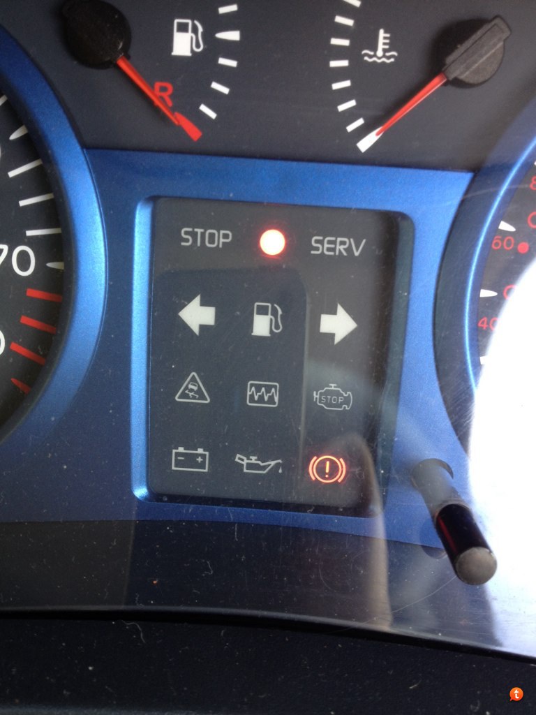

Before i changed my gearbox the immobiliser light would sometimes flash fast but not often, i've now changed me gearbox went to start it and the light will either flash fast or stay solid every time now. I've pulled out all the fuses and put them back in, i've checked the white and purple twisted cable and that all seems fine. I had a new battery back in november put my multi meter on it 12v so everything is ok with that, i've only got one key so can't try another. Not sure what to try next?

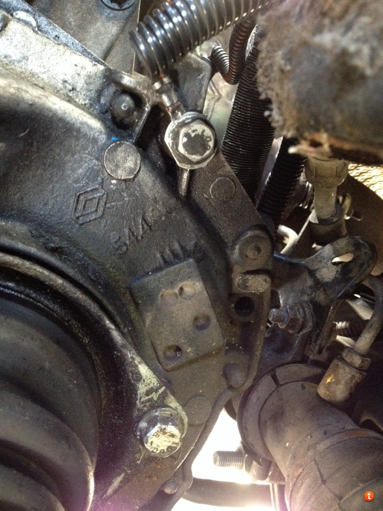

Check the earth to the back of the gearbox and the main earth strap between the gearbox and chassis rail is all I have. Other than that, I need to see it i'm afraid.
Mick

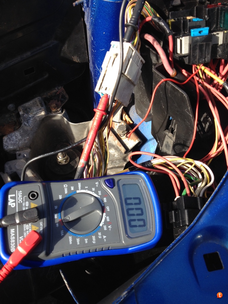

Ok cheers mick, they're both on I'll upload a picture where they are. When I was doing a search you said to do a continuity test on the purple and white twisted cable. My multi metre didn't change it said saying 1.
Not sure if I done that right but I put one on the purple in the white connect then the same for the other white connector
The light no longer flashes now just stays solid

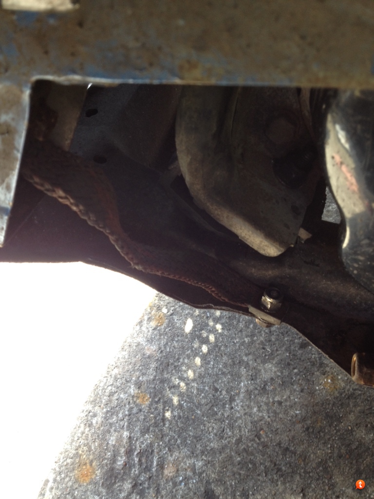

i've just realised looking at my photo, i've got the earth strap wrong, it's needs to go on the gearbox right?

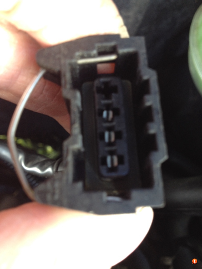

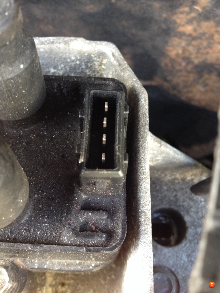

One of the wires that I wiggled was the one that goes to the coil pack so I took it off and this is what it looks like.
Is that right?
